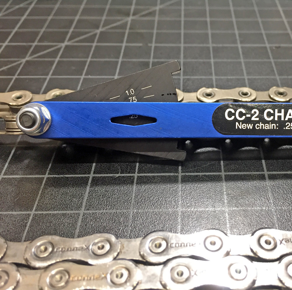

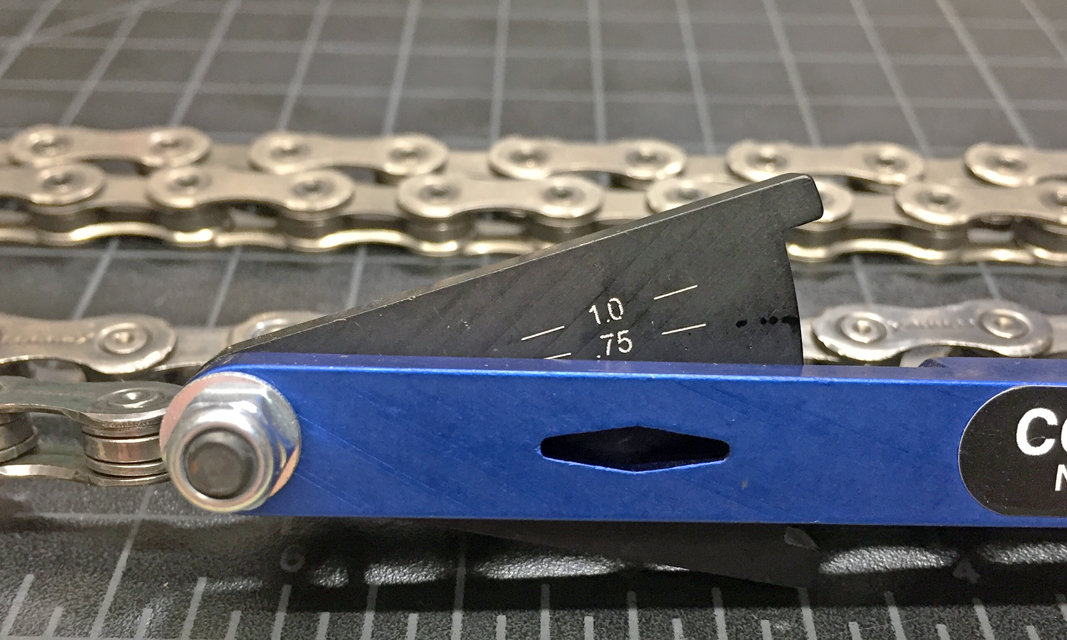

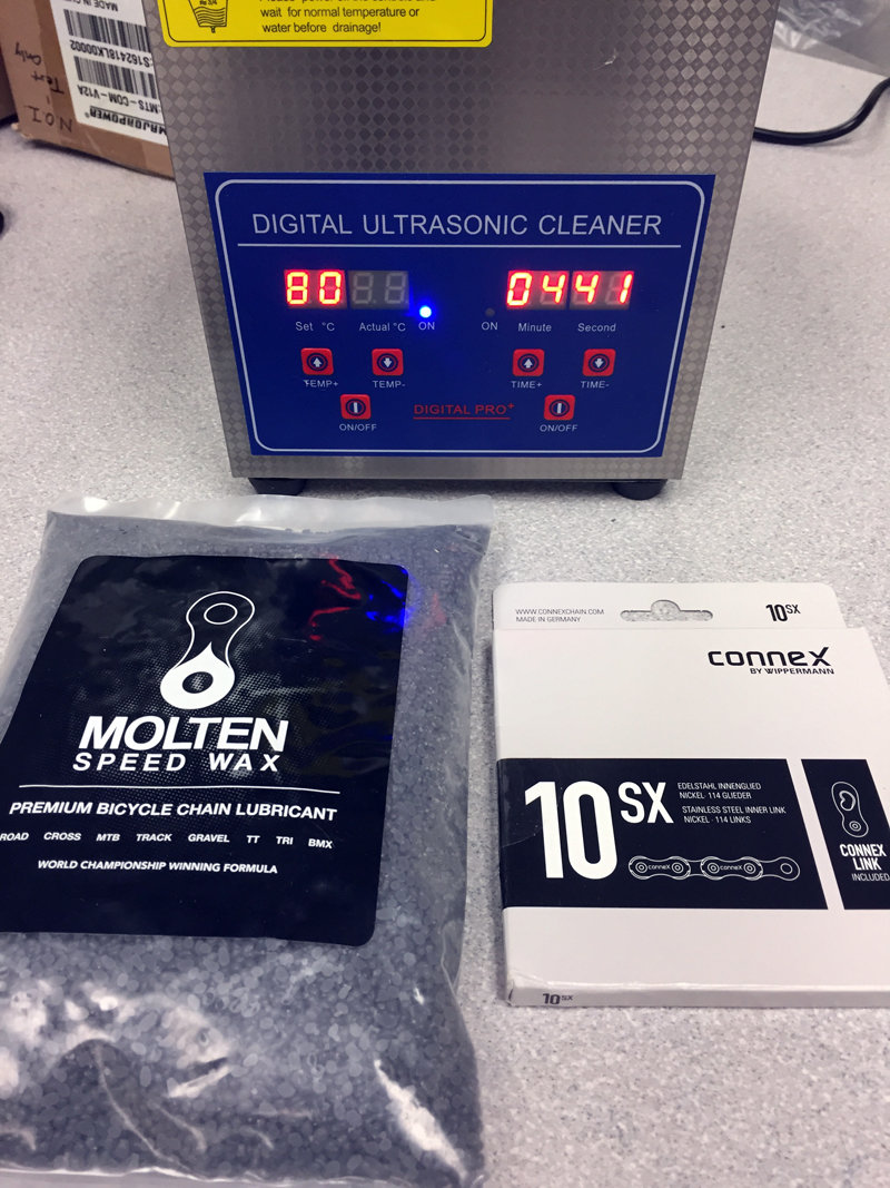

    Alright... but you asked for it. :evil:
    This is very much a "Buy once; cry once" setup.
    1. If you're not a "regular" maintenance scheduler and tend to do maintenance items ad hoc or when there's absolutely no other option and you NEED to ride; I strongly recommend purchasing two chains of equal length/type if you're thinking of using a this method. In my experience, if you're short on time and the chain has been left too long without a cleaning/waxing; you can then just take off the old one, throw it into a solution of mineral spirits (or your degreaser of choice) and let it marinate while you install the 2nd chain to use immediately. It's still imperative that you'll need to address the original chain at some point before chain 2 loses protection... The upside to this is that you are extending the life of the drive train significantly by always running a clean chain and getting double life out of the two... it's a more costly purchase up front but that's negated and recouped over time since chains are a wear item anyway.
    2. Setting a repeatable procedure and system helps, a lot!(I cannot stress this enough; find a process that works to your liking and stick with it. This takes a little time and patience to set, but once done; it becomes easy and nearly without thought)
    After purchasing the chain(s), the ultrasonic cleaner, the wax, and setting my mind to it; I quickly found out that I needed a repeatable process. I went to Home Depot, into the paint department and purchased 4 of the 1qt paint containers with lids, 1 can of mineral spirits, 1 can of denatured alcohol, and another bag-o-rags (I always have one of my toolbox drawers stuffed full of these). I then went back to Amazon and purchased a hot wax warmer (like for removing body hair) as they're designed to hold wax at melting temperature and come with a removable container to swap out wax. Bonus that it was supplied with a pack of those tongue depressors to stir and agitate the wax with the chain in it.
    Cleaning the old chains that were already crudded and dirty with wet lube were actually the longest piece of the process... I mean REALLY trying to get them clean and free of debris from in-between all the links. The ultrasonic cleaner definitely helps but is not perfect. I've been using carburetor cleaner (does anyone under the age of 40 even know what a carburetor is?) in the ultrasonic but may try something stronger a bit later. The solution seems to work fine when heated to about 60C, and I run the ultrasonic part for 10 minutes.
    So, the process thus far is:
    1. Remove chain and place in preheated ultrasonic cleaner (if you want to go this route), I heat mine at 150F (67C) and run the ultrasonic for 10 minutes, then assess and maybe brush while it's in there.
    2. Remove chain, dry with compressed air or clean towel, and place in a container of CLEAN denatured alcohol, agitate well and look for any debris/residue to release and fall to the bottom. If no debris/residue, remove, allow to dry completely before applying wax.
    3. While doing all of the above, the wax should be preheating and melted (I set at 185F). Agitate the wax with a stir stick to move the Moly and Graphite around back into solution, then coil/dump the dry chain in while keeping the twisted wire keeper visible for grabbing. Agitate the chain well throughout the wax until no bubbles visible, then grab by wire and remove (taking care to not let it fling hot wax on you or your shop) THE CHAIN IS HOT (DAMHIK) and should be hung somewhere it won't be in the way or bumped and can drip hot wax without worry. (I hang mine from my vise initially and it drips on my mat)
    4. Once cool and dry, the chain will be completely stiff and will hold that shape until each link is broken loose from its waxy coating. Breaking each link is necessary before installation, but the bonus is that the chain being already coated can be hung and ready for use without worry of being exposed to corrosion/oxidation.
    All total, it takes me about an hour per, but most of that time is in the pre-heating of the ultrasonic and wax pot. As the chains are cleaned/waxed going forward, I can get that time down to about 15 minutes once the cleaner and wax are pre-heated (that part takes longer than the cleaning/waxing process. It really works better to have a chain already clean, waxed and hanging ready to use when you're removing the old one. Coil and ump the dirty one in one of the containers w/ spirits, agitate and let it sit for a few hours or overnight. Batching multiple chains per cleaning/waxing session is highly recommended.
    Tangential items that I adapted to make the process easier:
    • Motorcycle safety wire and wire twisting pliers. (I cut a 3-4" section of wire, feed the master links on it, then run the ends through the holes in the chain ends and twist it all together to act as a hook and grab out of the solutions and so the links stay with the chain at all times.)
    • Pegboard hooks to hang the chains as they cool and for future use.
    • Labels for designated chain use (road, mtb, single speed gear combo)
    • Extra 1qt containers with lids to transfer the previously dirty Min Spirits and Den Alcohol that has settled into those designated containers, then wiping the collected residue in the bottom out with a paper towel.
    • I break the links loose by rolling the chain over the tightening handle of my vise. It breaks the larger wax chunks off, while freeing each link on the rivets.
    • Coiling the chain into a tight "beehive" that fits in the palm of your hand will also fit in the plastic containers, in the wax pot, and in the ultrasonic cleaner pot without having to uncoil.
    • When blowing the old wax and residue through the chain with the compressor, I hang it by the safety wire on a hook, hold a clean-ish rag behind it, and blow through the chain on to the rag. This method lets me see how clean the residue is blowing through the links.
    One of these chains is brand new and the other has 2500 miles on it. Can you tell which is which?
