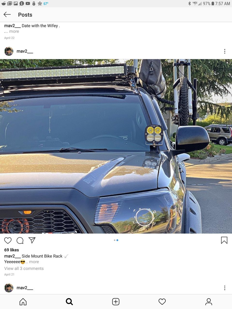

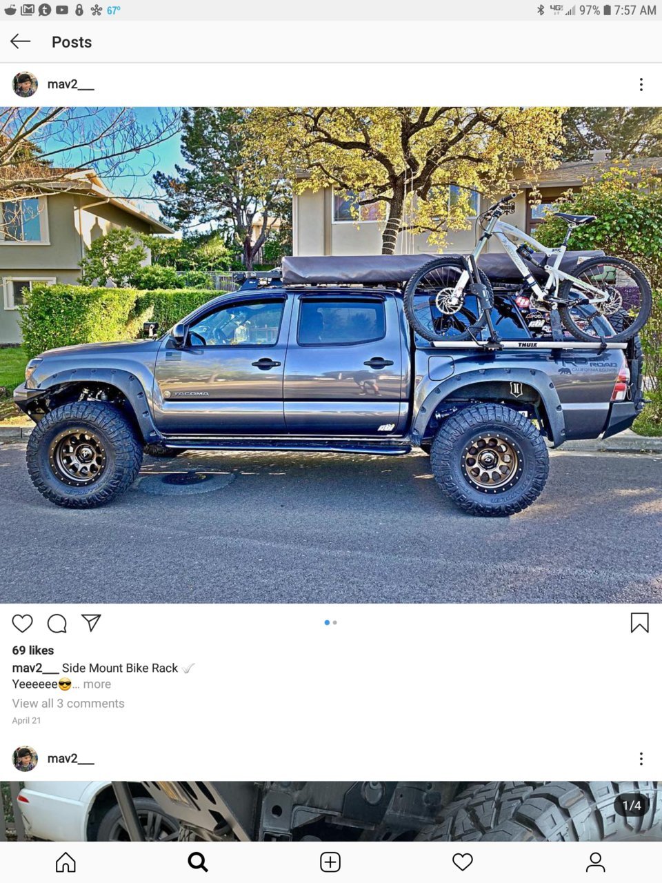

    Yeah, me too. I spoke with them a while back, and the rack can be ordered without powdercoat, so, mounts, or brackets could be added by me. I bet if you know the specifics, they would add them for you.
    And this. Those are FrontRunnerOffroad tracks, above and below the window. And it looks like with traction board mounts, and the bike rack is mounted to that.
    Screenshot_20190806-075749_Instagram.jpg Screenshot_20190806-075755_Instagram.jpg

    FRO = FrontRunner :facepalm: Gotcha.
    Is that a new part for them? I don't see it on the website and I've looked for something similar before as I've considered making my own as an alternative to a hitch rack.
    Designing around the 'lip' of the topper was the biggest hiccup for me and what ultimately made me scrap the idea.

    That lip was my hiccup as well.
    https://www.frontrunneroutfitters.com/en/us/front-runner-universal-track-1800mm.html
    Those are the starting pointl. I can come up with something from there.....
    Now, to find a cheap enough cap to experiment with.....(yes, I have been looking).

    Wait a tick. I think we may be referring to the same thing, but thinking we are talking about different things?? :annoyed:
    I don't think I looked at that picture close enough. Guess they are running parallel tracks with a vertical piece tying them together to share the load of the bike.

    Pretty much. But, in my snooping through the IG, dude said FRO stuff. Not sure if its stronger?
    My only caveat, would be... I would add a higher attachment point, for highside stability, to prevent/minimize stress at the lower joint.

    Any clue where that vertical piece that the bike rack is mounted to is from? Pre-made or garage fab?

    Nope. But, I have a few ideas. Need to have it in front of me, to mock something up

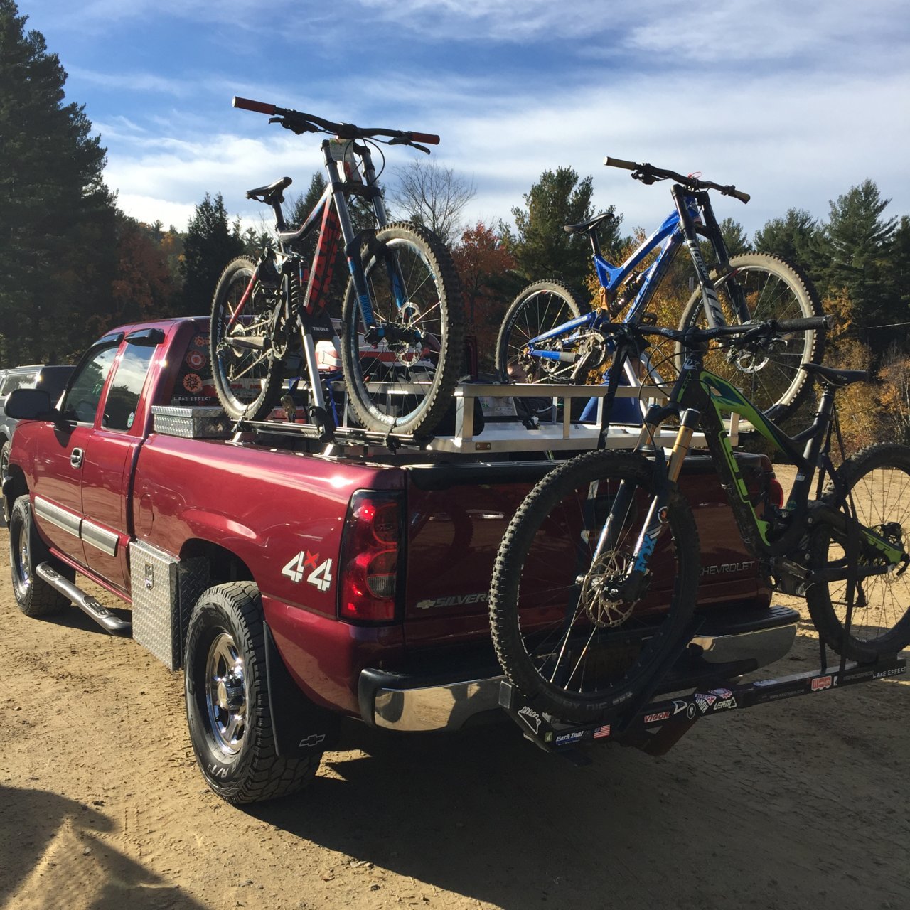

    I welded the brackets to attach mine a similar way a few months ago even though I don’t have a cap. There are two issues that I would see with a cap and mounting a bike outboard. “Sway” side to side at the top, especially since the inner bed is reinforced plastic (which would be amplified by having to move the mounts even further to the side in order to clear the cap). That could simply be solved by some type of stabilization mount on the cap to the seat post or stem etc. The other issue is width..... gas pumps, drive through ATM’s, road signs and tractor trailer mirrors have to always be in the back of your head. Again, this would be amplified by having to move the mounts further outboard to clear the cap. For a long distance trip you could simply spin the stem so the handlebars are parallel to the top tube.

    Good feedback thanks. I may be wrong but I think the weight and pressure of the cap being clamped down over the brackets might reduce some of the "sway" forces being transferred into the bed rail. Agreed 100% that an upper bike stabilizer would be beneficial.
    Got any close up photos of your handiwork? Also, what kind of hitch rack setup do you have going? Looks like a mix of 1up stuff and something else. Curious if my eyes are deceiving me or if you've some other MacGyvery stuff happening.

    Very true about the cap helping with rigidity. I didn’t give that much thought but it would essentially tie both sides of the bed together. The rack that the 1up is in, I built 5 or 6 years ago. It has been hit twice from people not paying attention and opened the side of a car like a can opener when someone decided it was a good idea to drive behind me while I backed into a parking space. Still going strong.

    I dig it! From the looks of how your previous vehicle was equipped I'd say you've got some useful skills. Good on ya! I'm still in the infantile stages of teaching myself to weld.
    Really like the utilization of the flatbed wheelwell storage box on your longbed bowtie too :thumbsup:
