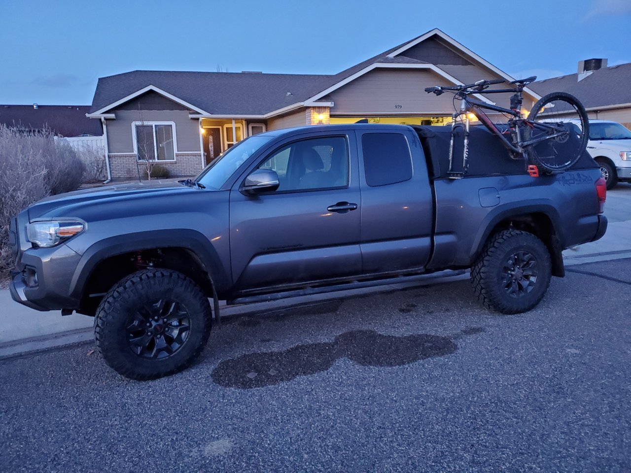

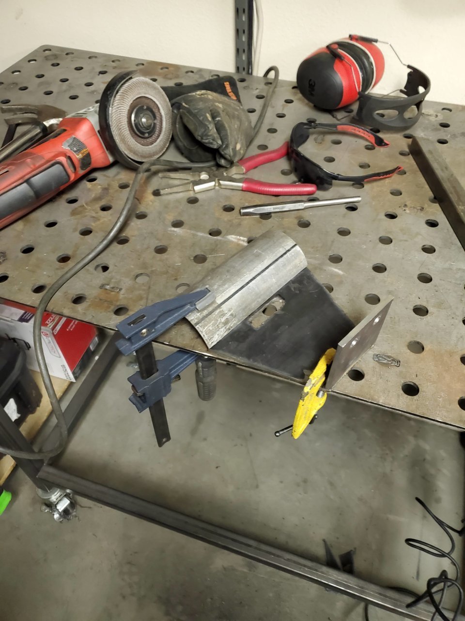

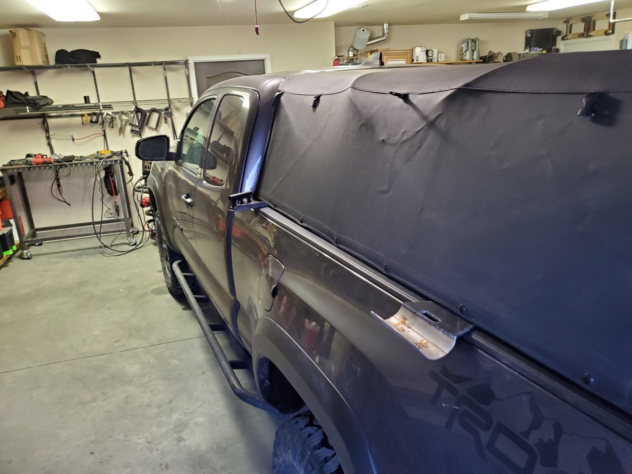

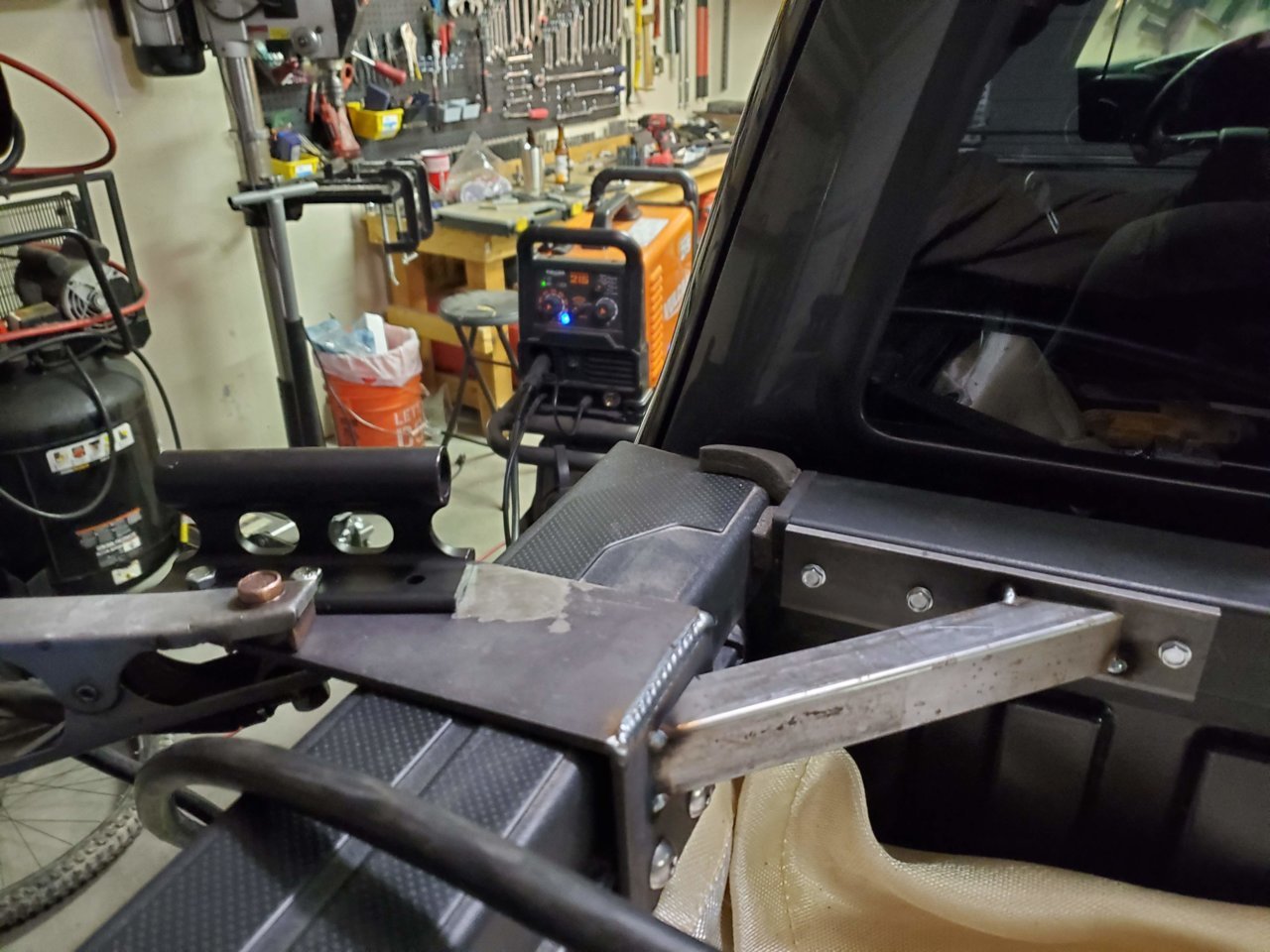

    This weekend my buddy and I made a custom side rail bike mount for the softopper. I was inspired by the KB Voodoo Outboard Mount that they stopped selling. We used 3/8" plate steel for most of it with a 2.5" tube cut in half for the rear wheel. We noticed a lot of side to side flex when just mounting into the side bed rail so we added a reinforcement tube to the front rail as well. Screwed directly into the front rail with self tapping screws. Drove on the interstate for 4 hours with the bike mounted and it barely moved. It's ready for some trails!

    That is Awesome!
    RAD!

    That is an awesome setup. Want...

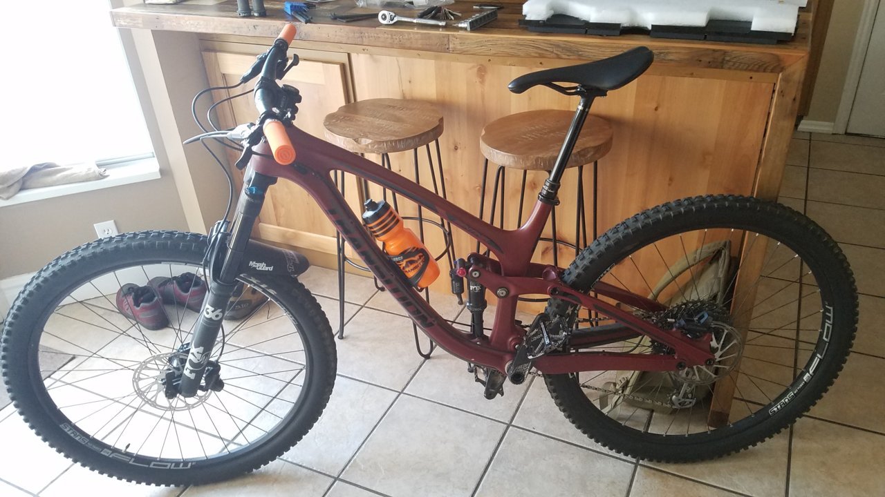

    Perk of bachelor life. Just doing some bike maintenance in the kitchen. No biggie.
