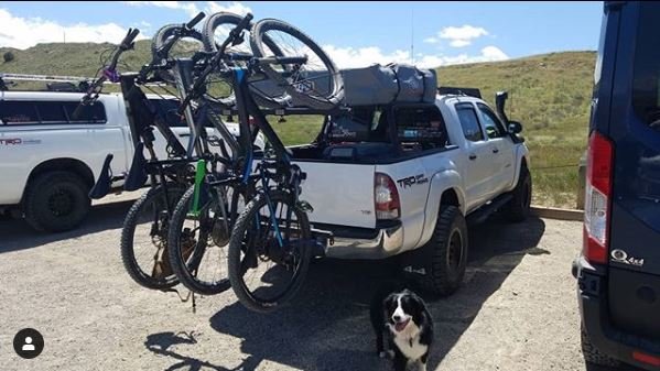

    I'm in the same boat as you. I currently have the Yakima Hold-up 2 and was just going to add the additional hold-up 2 add on because I saw a deal on marketplace. However, after watching Yakima's own video on their Hangover 4 I decided to go that route. I drive a DCLB and with the Hold-up w/ the add-on I would be looking at a limousine length truck. The hangover also clears the tailgate when it is down which the hold-up does not. Check out the youtube video on it: https://www.youtube.com/watch?v=10j0NJDkdCc
    The only down side I see is that the rack is specifically only for mountain bikes. Not a problem for my family but it may be for yours.

    I have an Alta Rack, which is a very similar design. I really like it. Upside is it is easier to load bikes vs a tray and handlebar clearance is less of an issue. My only complaint about any of the "shuttle rack" style mount is be prepared to lose 10-30 sq ft of your garage any time you don't have it mounted to your truck. Its one of those points that marketing conveniently "forgets".
