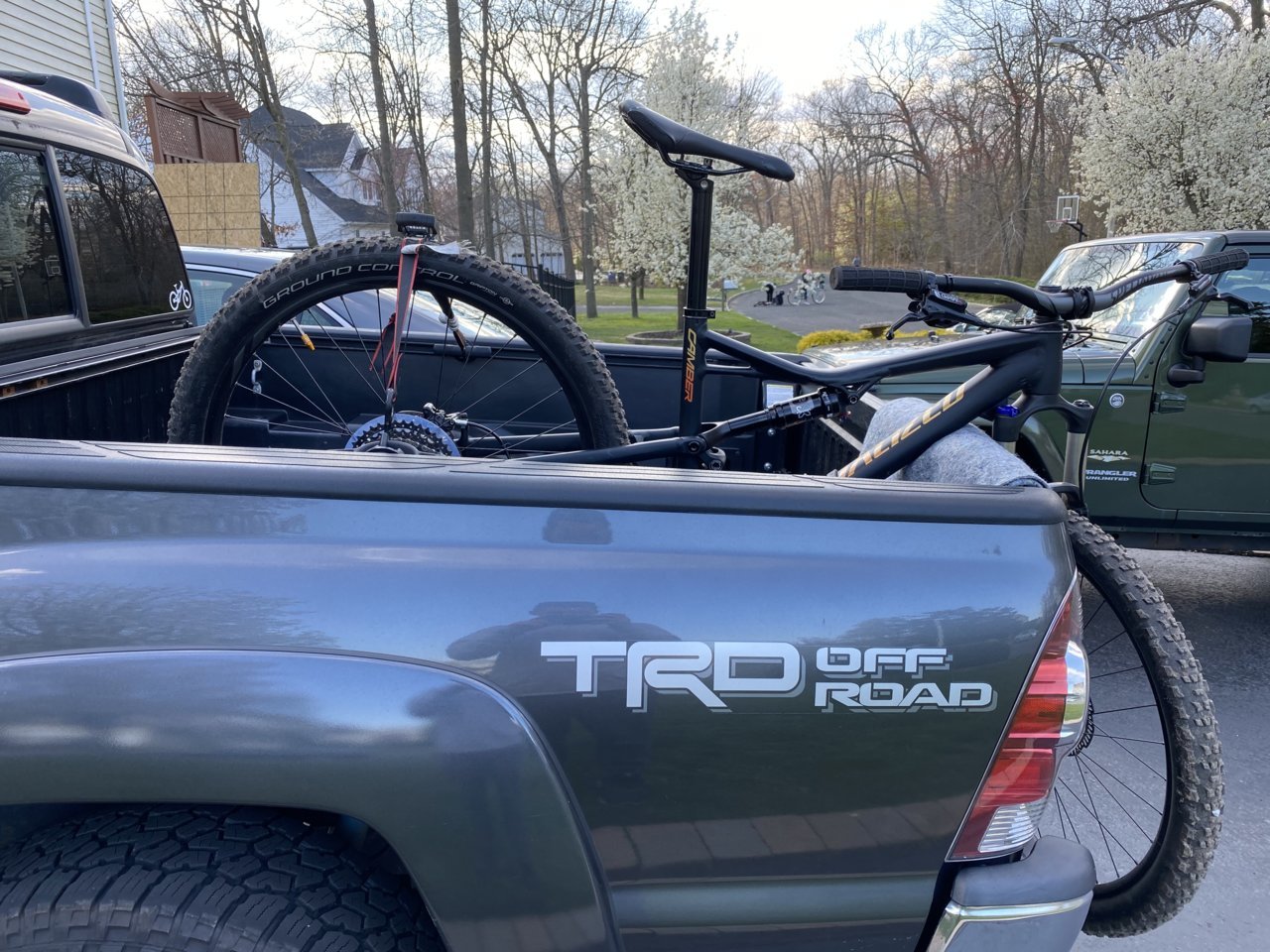

    Dropper on the way! Can’t wait for it.
    Think I’m just gonna beat this bike to death for the next year or two. My biggest gripe about my Camber though and why I don’t know if I should upgrade my bike altogether is I don’t think I can switch out this rear XFusion shock without losing some travel. And this shock sucks, the dials don’t change the ride, and the “lockout” feature doesn’t do much when switched. Guess that’s what I get for a budget entry level spec camber though. My research has led me to find a custom bike yoke I can buy for $130 that will allow a Fox or Rockshox shock, but I will lose almost 10mm of travel i believe which I don’t want to do.
    The Standard XFusion is 205x53mm and this Fox FloatxCTD or Rockshox shock would be 190mmx51mm.
    Thoughts?

    You will not notice 10mm less suspension travel. Especially with an upgraded shock

    Yeah, their "proprietary" suspension systems lol. The camber comp in that same year came with a Fox Float for the rear suspension same 205x53mm as my X-Fusion. I should be able to just swap out for that shock right if i can find one right?

    I second that! Better suspension >>> more travel

    Yes, that would be doable.
