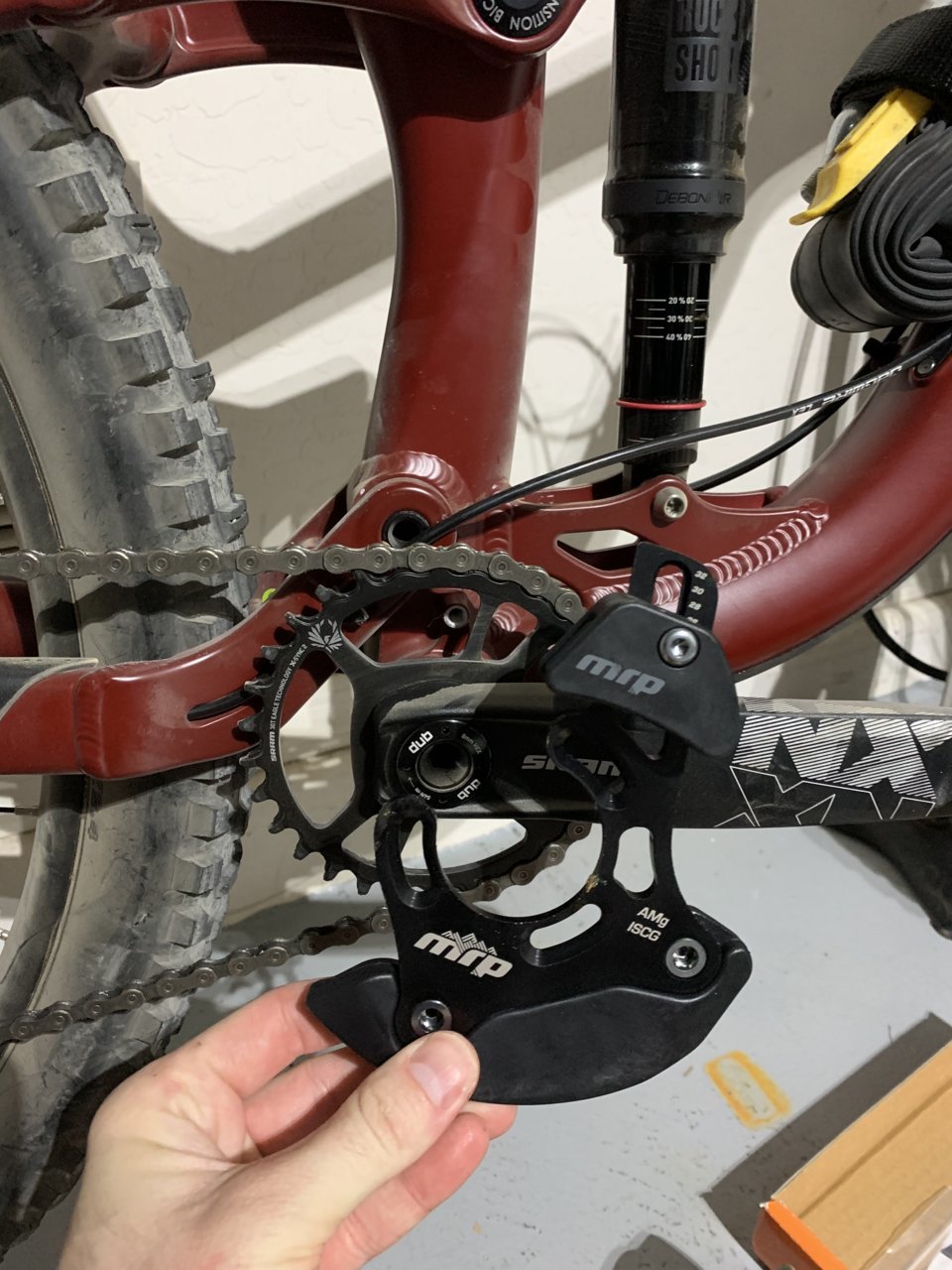

    what’s not lining up? Need spacers?

    The bash guard says Iscg and the bike has iscg-05 mounting. That might be the issue. It looks like that bash guard is offered in both sizes so that could be it.

    There are 2 different ISCG mounts, my bike is the other mount than this MRP guide

    Yup I figured that out eventually hahaha. Thanks man

    There might be adapters out there. I’ve never run a bash guard so don’t know too much about them haha

    I bought mine second hand and it was already installed. I have the V2 of that bash guard as well

    I figured it out I ordered the same MRP again but this time with ISCG05 instead of ISCG
