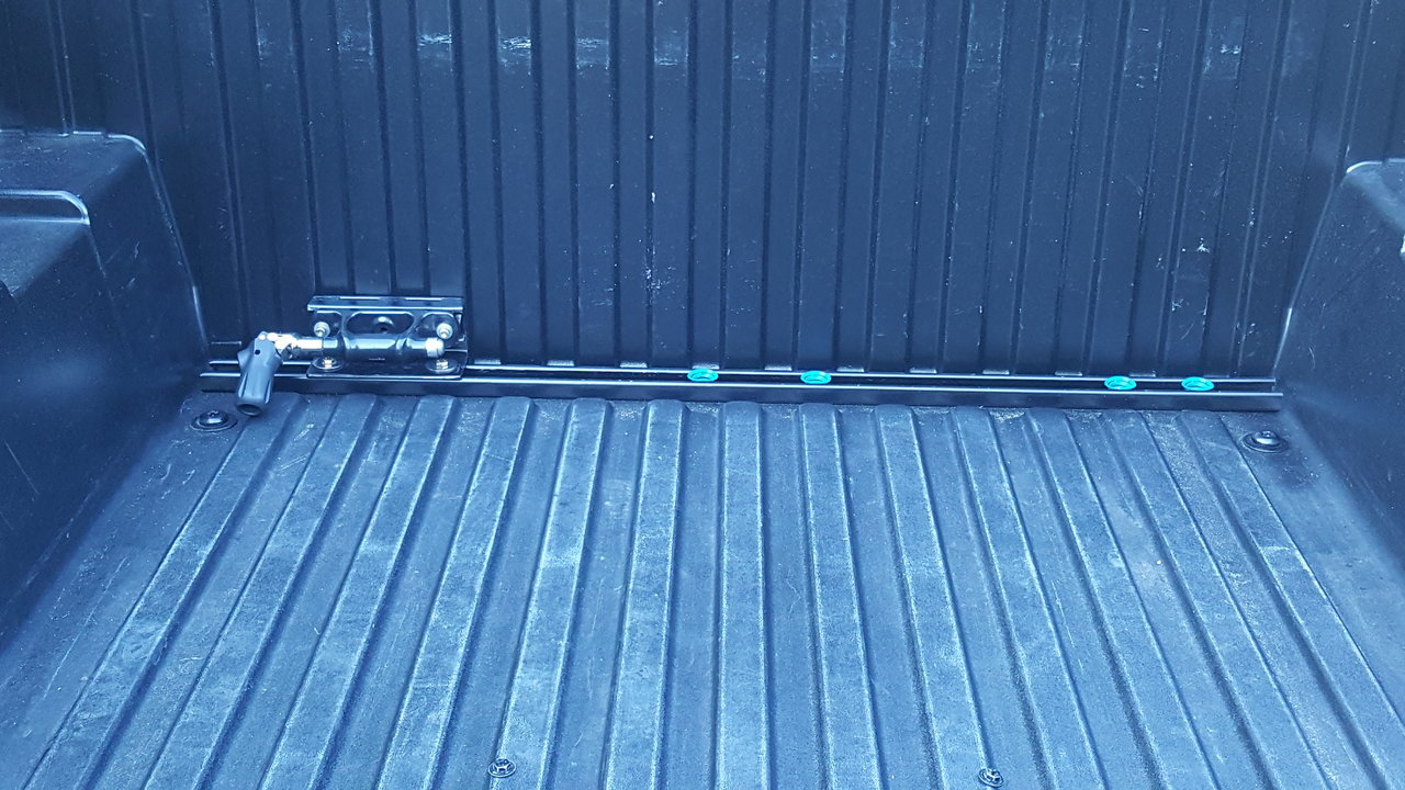

    When I mounted the mount directly to the unistrut it pushed the mat back too far to close the tailgate, I made a couple of these and my mat fits. The unistrut is bolted in the 3 drain holes with stainless 1/4-20 hardware.

    Any more pics of your sourcery?

    Cut 2.5" angle and unistrut 6.5" long and weld them together, be careful it's plated. Drill holes in angle to bolt to the unistrut that you bolted in your drain holes.

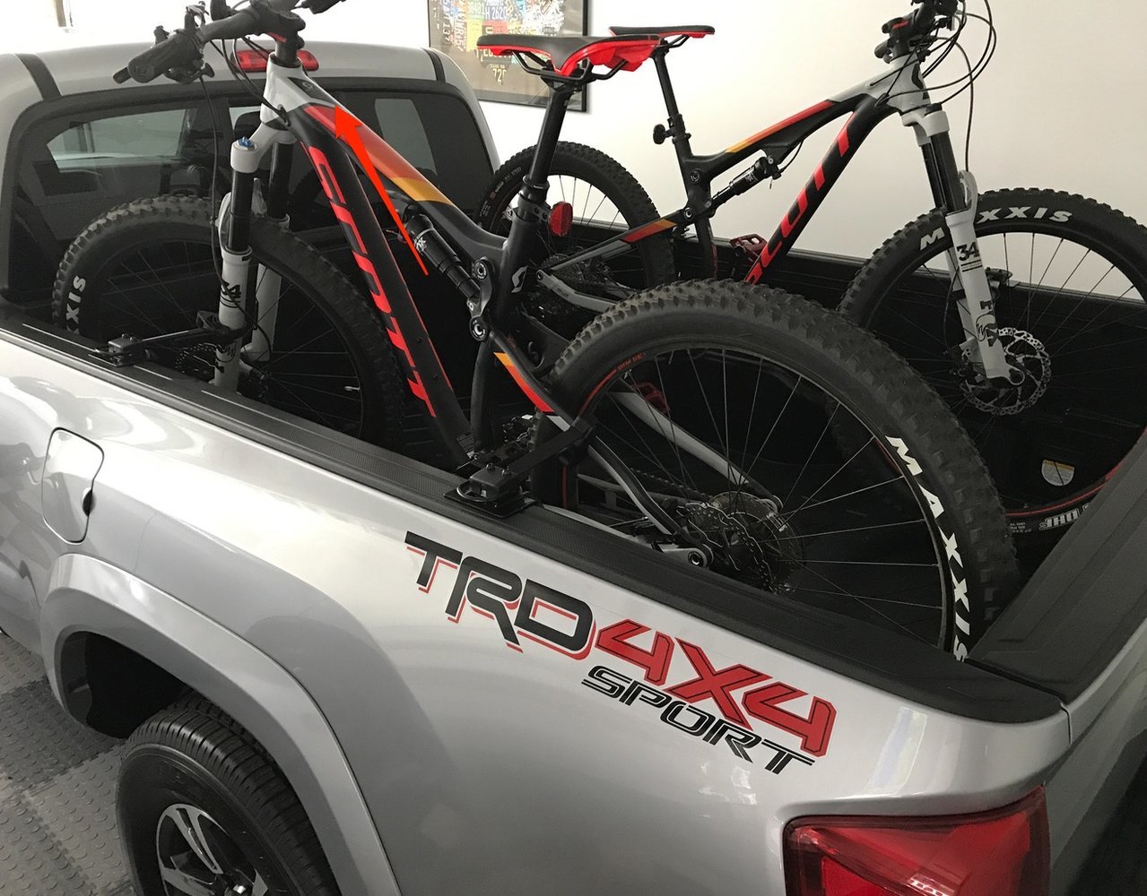

    My Bike rack set up- holds the bikes -- solid ! easy on and easy off.
