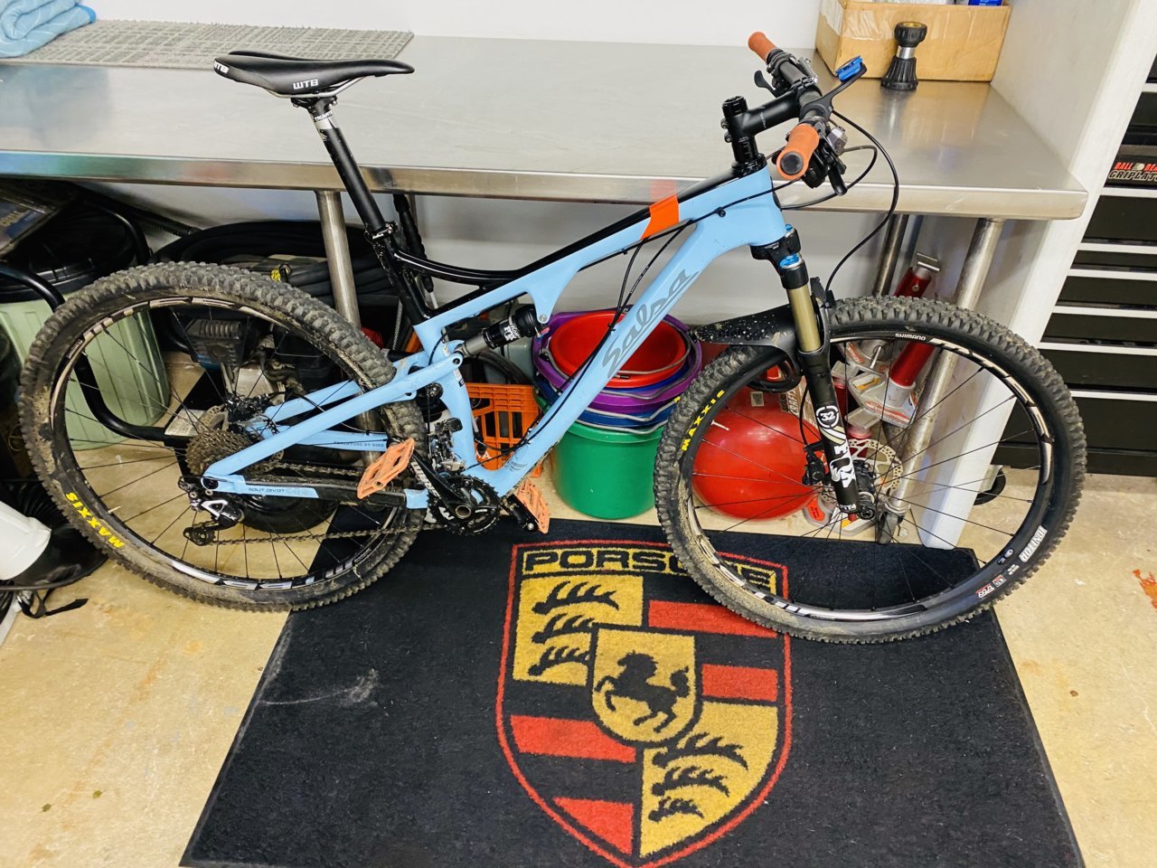

    Anyone experiences wobbling when hard braking going downhill or just normal?
    I cannot figure out why mine is wobbling at the front?

    That is not something I have ever experienced. Can you give a better description?

    What kind of wobbling? Like is the fork moving/vibrating or does it feel more like the speed wobble in the handlebars?

    Let's say, when I brake hard, it wobbles like the wheel is gonna come off! I was going downhill too fast. It would do that after I go through the puddle or mud.

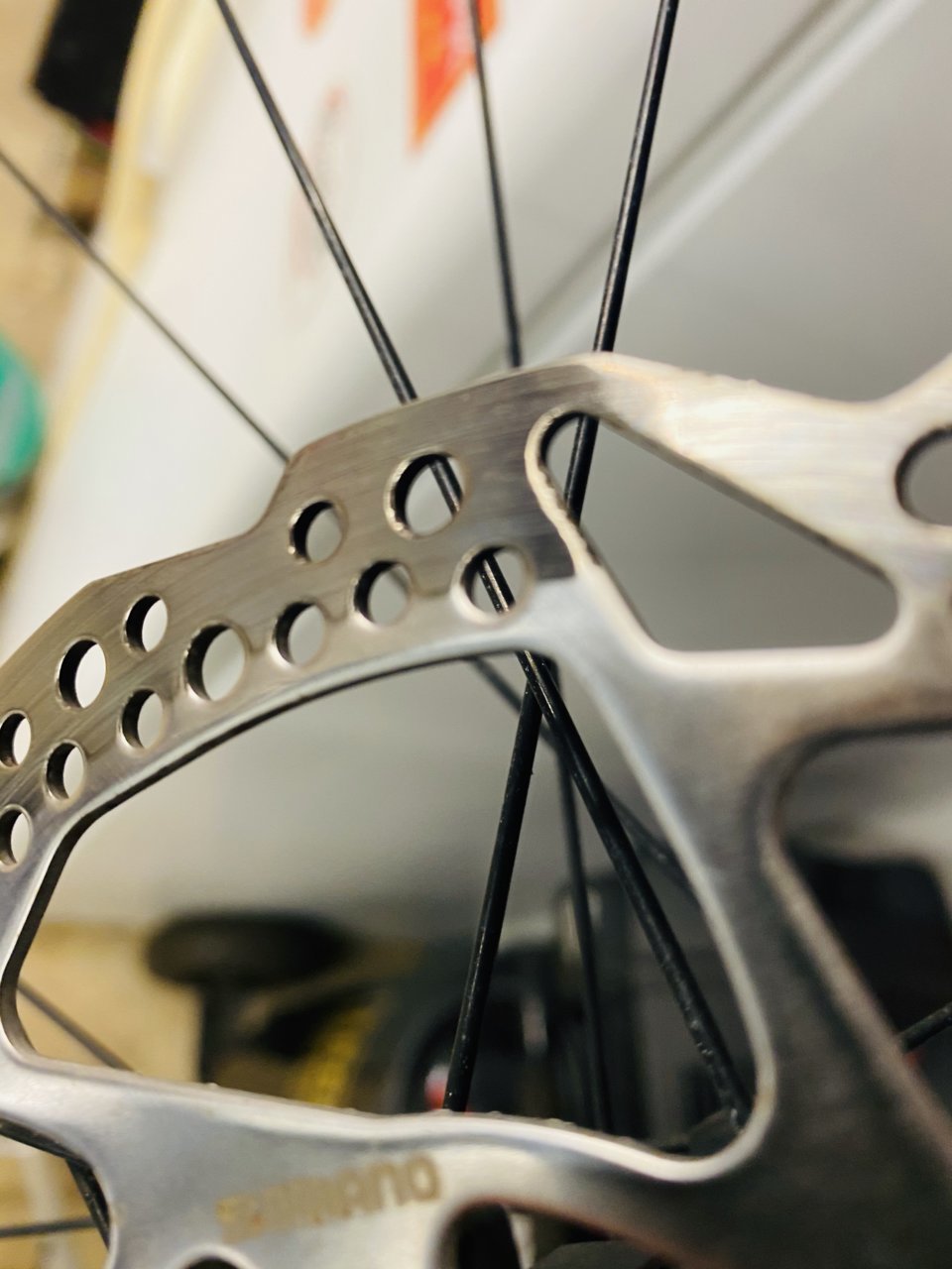

    usually has something to do with the rotor or pads (I'm assuming disc brakes), either the rotor is warped, or the pads are unevenly worn, which will most likely eventually cause the rotor to warp.
    best bet may be to replace the rotor and the pads and see if that solves it.

    What wobbles? The wheel? At the headset? Are the wheels true? Any noise coming from the front hub?

    Any details on the bike? Disk brakes?

    It could have to do with the rotors or pads like @DarthPow said. It probably wouldn’t hurt to check for play in the hub and headset.

    true, make sure your thru-axle (? looks like you have a thru axle) is tight.
