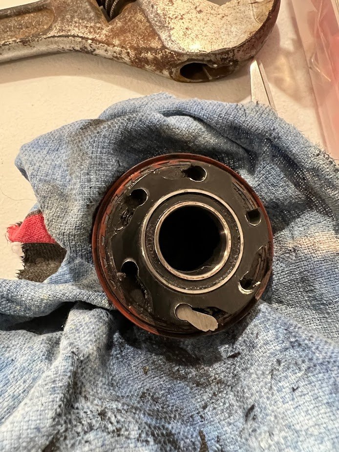

    Anybody ever rebuilt a free hub? Was riding this weekend and my rear axle came loose, which was noticed by skipping gears and general slop in the drive train. Pulled off the rear wheel and 4 pawls fell out of the free hub (i9 torch). I am going to fully take it apart to see the extent of the damage, but I am guessing the springs for the pawls are long gone. I compressed everything back together on the trail and had enough engagement points to ride back to the parking lot, but cut the ride short as I knew I was on borrowed time.
    Once I see whats going on, I have three options:
    1. Have the local bike shop rebuild
    2. I try and rebuild
    3. Get a new free hub and be done with it.
    Hoping the internal threads on the hub shell are fine, but time will tell.
    From what I can see, it looks like dealing with those little springs and the pawls is going to be a major PITA, but I might be making it out to be more than it is in my own head.

    It's pretty simple to put in new springs and pawls. Cheap too.
    I haven't looked at an i9 hub lately. Do they have a removable ratchet ring? Good to replace that too if it's damaged.
    Ultimately you'll want to figure out why it came loose. Pawls don't usually just fall out.

    Agreed that pawls don’t just fall out. My hunch is that hub or freehub (maybe both?) bearings are shot. If those have too much play or are bad it can cause weird loading on the ratchet mech and then bam. Could also be grease/gunk causing the pawls to stick or not return.

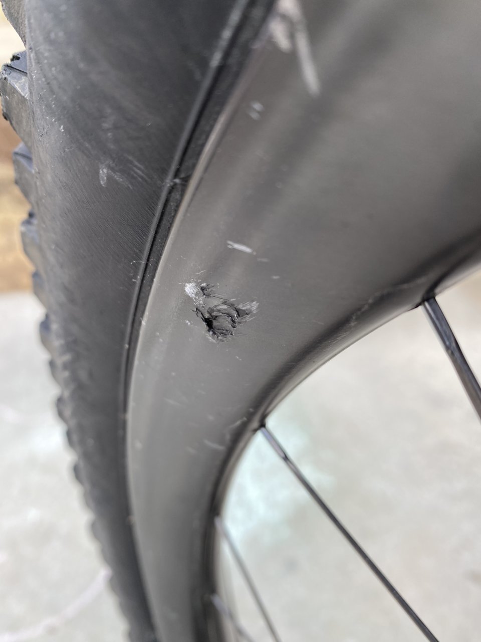

    Woof. Didn’t even notice this until I washed my bike but must have kicked up or caught a rock just right.
    Enve M630 rim.

    Side hits are the worst. I'd email Enve to see if they think its still good to ride but I bet it is. Bet they'd hook it up with a good crash replacement price if it needed to be fixed.

    Honestly, I don’t know when it happened so I may have been riding on it for a while. It’s through the sidewall and a decent sized soft spot but in between spokes so it may be ok for a bit.
    I emailed Enve and we will see what they say.

    Well took the freehub out and was impressed I made it out in limp mode with only one pawl working - the ratchet gear is still in good shape to boot! I am assuming with the rear axle being loose and the torque during a climb allowed the freehub to separate just enough from the hub to allow the pawls to drop out. I am now debating getting new pawls and springs, or just getting a new freehub and not worrying about it again.

    Shit…. If you have a soft spot ditch it. Structural integrity is compromised.
