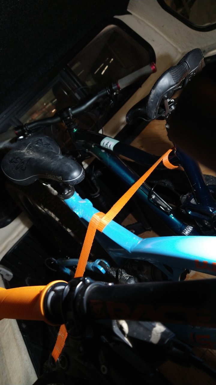

    The fork mounts don't hold the bikes as securely as i would have hoped, but one ratchet strap wrapped around them like this gets the job done. I just have to make sure to keep it clean to avoid scratching them too much.

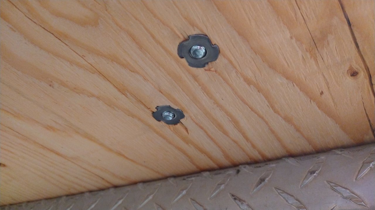

    I used lag bolts originally but they were not going to last. These nuts that suck into the plywood work amazingly, and don't hang below and get in the way like a regular nut does.

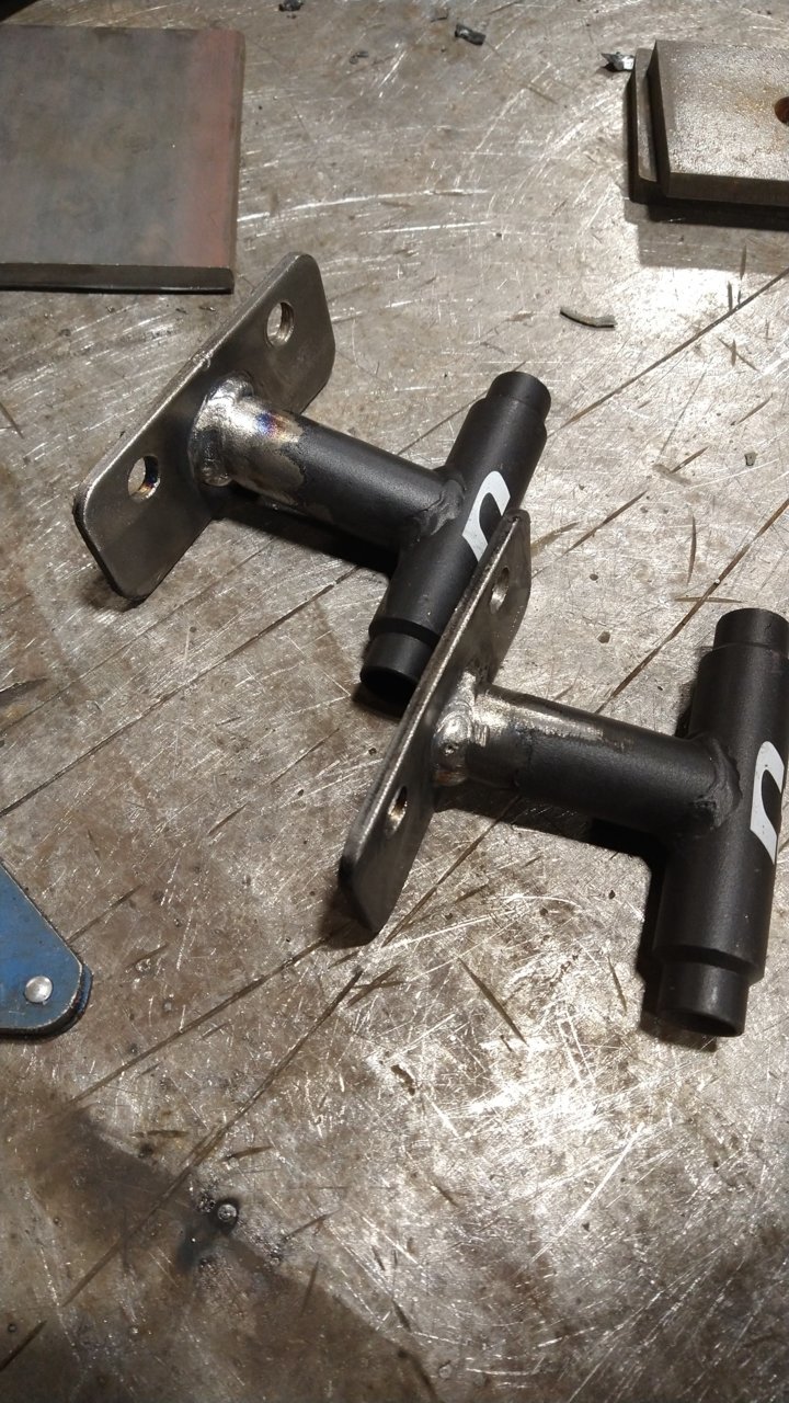

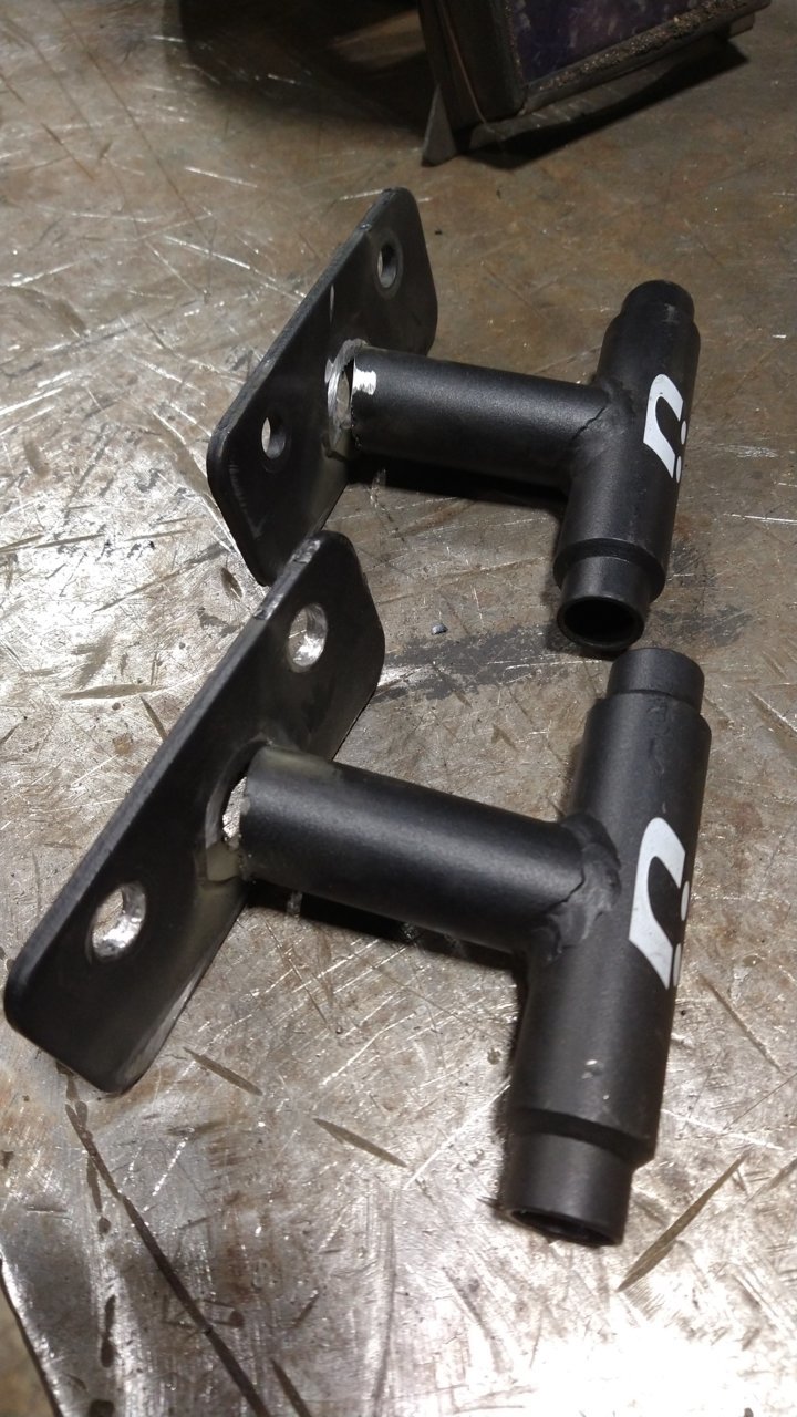

    I didnt like how leaned over the bike was on these (due to the steep head tube angle) so I cut and re-welded them at a more appropriate angle. Now the bike sits more upright.

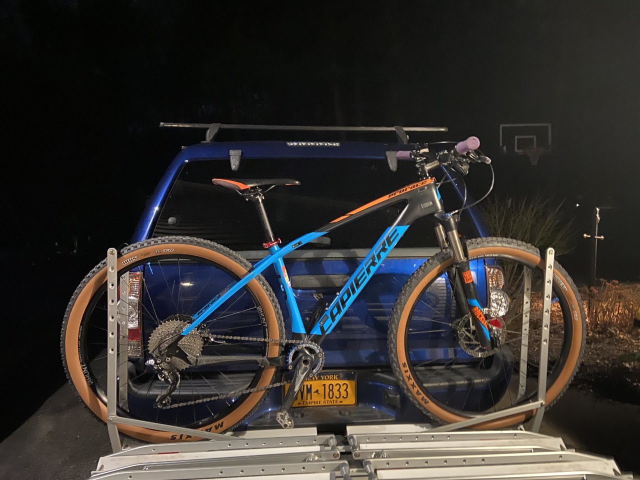

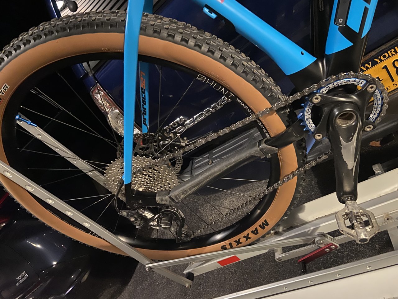

    Just finished a full refresh of my daughters NICA race bike. It would have taken me all night,but our bike mechanic friend knocked it out in short order…:bowdown:
    -Hunt wheels
    -fresh Ardent and Ikon (tubeless)
    -1x set up
    -full clean and tune
    We’ve been trying to get her a Canyon since November, dates get pushed out every week. Once we get that settled, this LaPierre will go to her little sister who starts racing next year but is already hot on her sisters tail!F124DA77-D59B-4A15-84AF-0F0F495A6460.jpg C34EE786-AE26-4297-AAFD-48E75BA525BD.jpg
