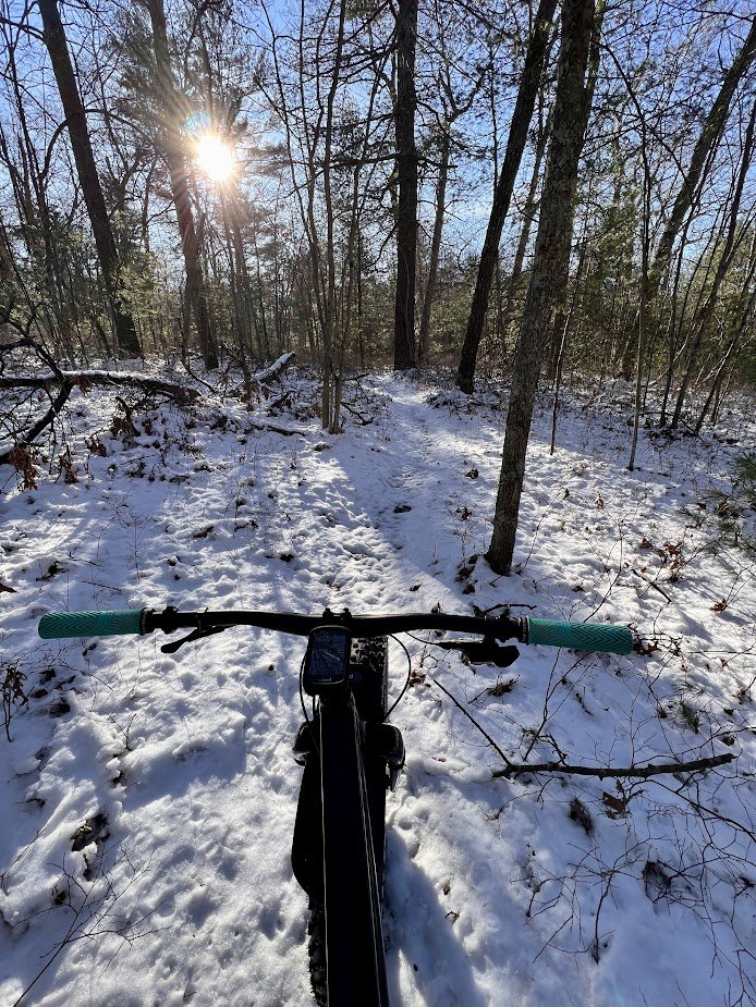

    Finally got a chance to ride the fat bike on some snowier trails (had +/- 2-3" of untouched snow on certain trails) - curious to see how it will do with a larger snowfall event. Have not put any studded tires on yet so was a bit concerned on traction, but the bike had substantial grip and it was awesome to blaze my own little trail. A few of the more accessible trails had fat tire marks from a few days ago that have iced up - was neat to see other people's line choices. Other than a few warm up rides on clean trails and one fat bike race on the beach, this was the first test of the bike in conditions it was made for.
    Going to be an awesome option to help relieve the basement trainer rides this winter.

    You’ll be pleasantly surprised, just air down the tires and you’ll have traction for miles! Studs are great for very specific conditions but rarely necessary if there is any actual snow on the ground. Fat biking is also great for practicing trail design, if you don’t like the line try a new one next time it snows!

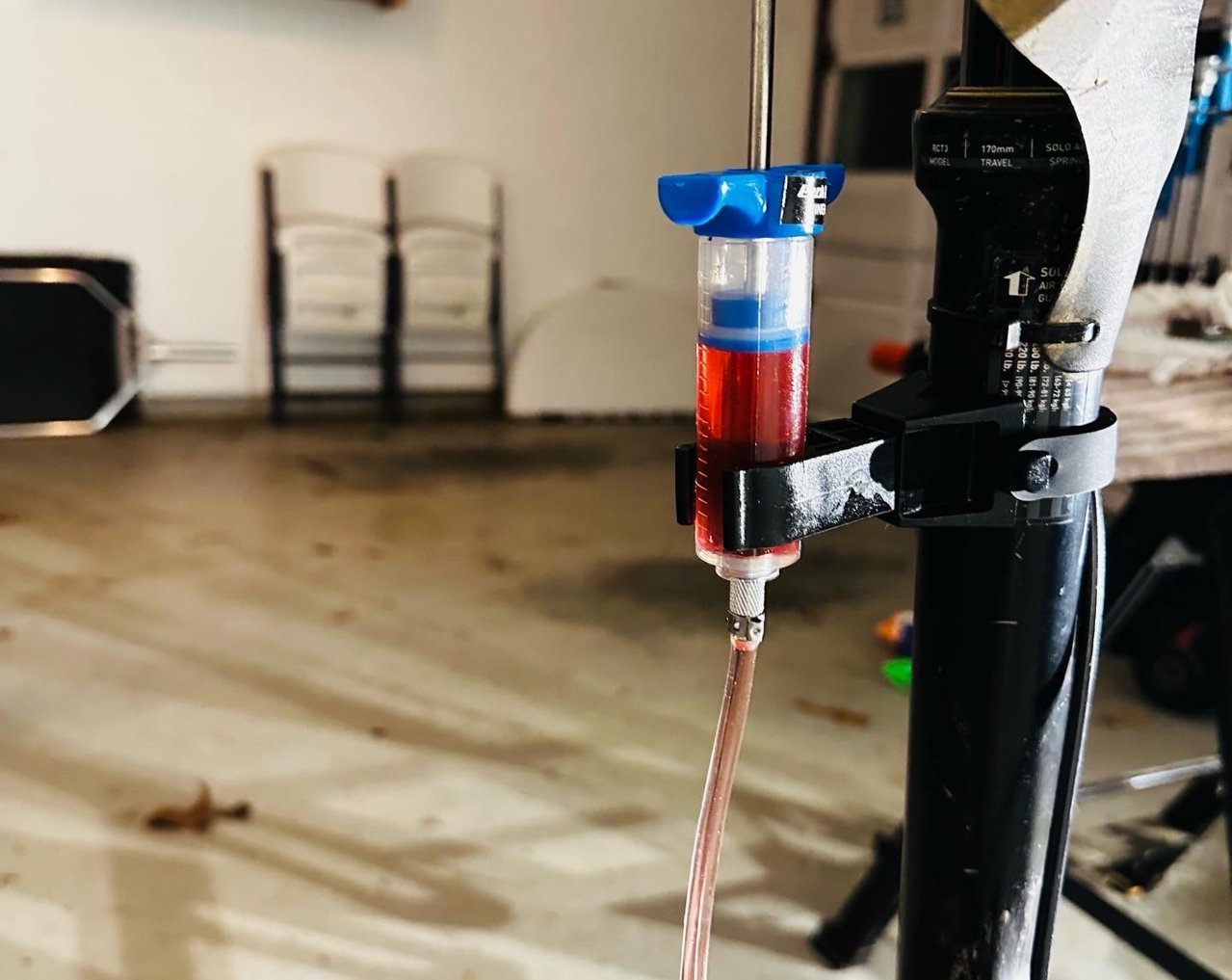

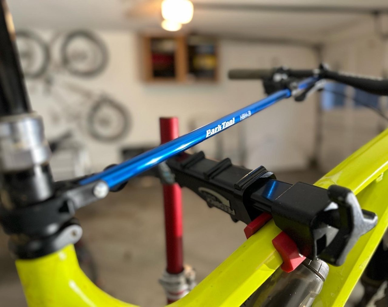

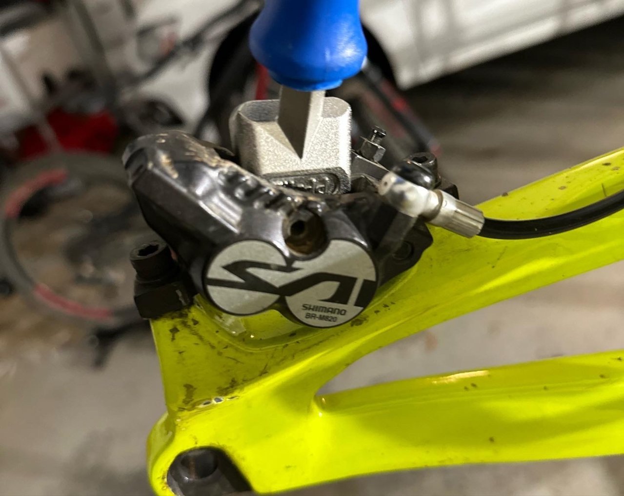

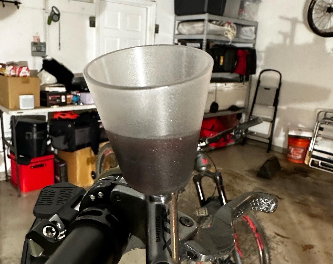

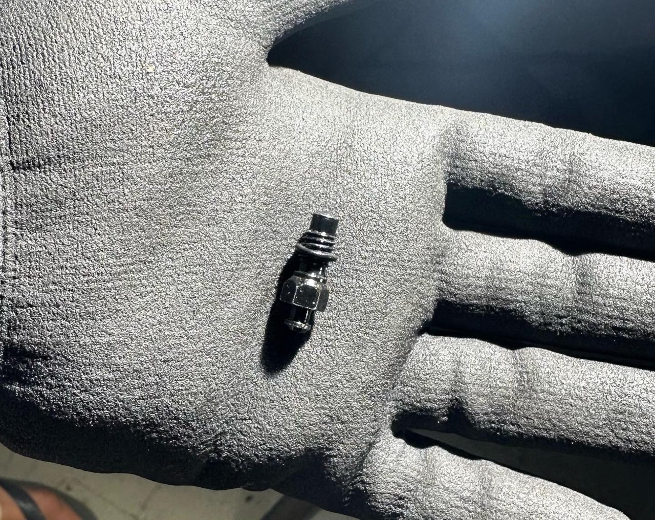

    Rainy days = trying out some new tools. Park Mineral Oil Bleed Kit plus some piston spreaders and a handlebar holder. All did great and made a full bleed a lot easier. This is my first Evil Insurgent and is about 7 years old and have not had a full bleed. The front brake alone took about 4 cups until it came out red. The rear brake fluid was so gunked up that I had to remove the bleed nipple and clean the the orifice using a fine wire.
