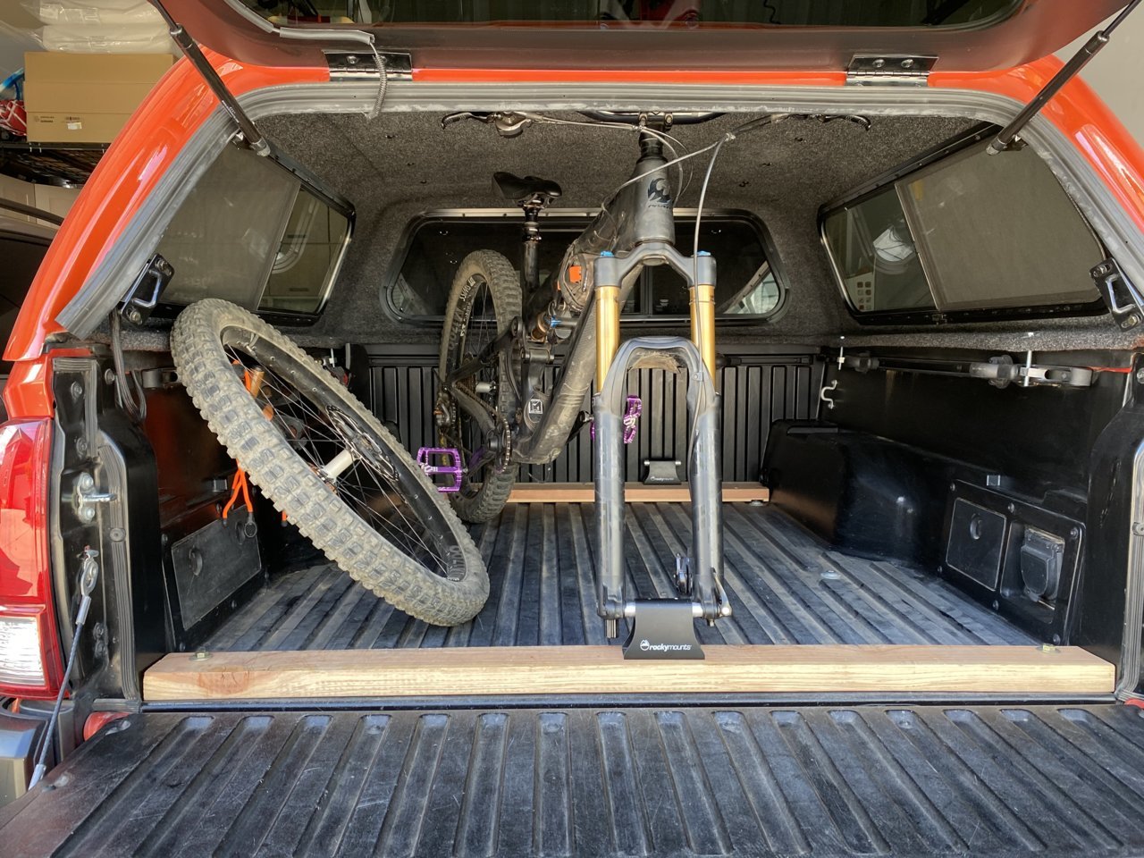

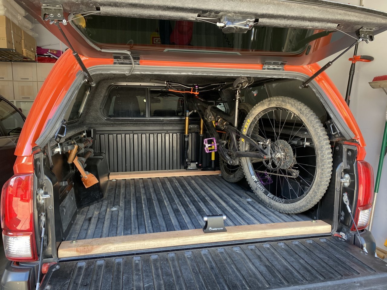

    I have fabbed up an easy way to carry one bike and a PITA way to carry two bikes...

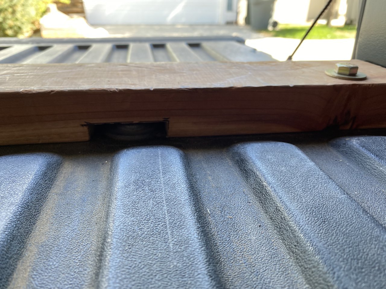

    Easy way: I removed the two tie-downs at the rear of the bed (the 2 that are threaded in the truck frame). I cut a piece of redwood 2x4 to fit across the rear of the bed. I notched out two places in the 2x4 so that it would sit flush over the two silver bed bolts (see below).
    I marked the threaded hole location from underneath and drilled two holes for carriage bolts (I used a Grade 8, 7/8" bolt (if I remember correctly)). Lined things up, threaded the two carriage bolts and then mounted a RockyMounts HotRod.
    This is my size LARGE Pivot Mach 5.5 mounted in a SHORT BED with a cab-height Leer 100 shell. It was tricky to figure out the process of getting the bike in there and lining up the forks, but now, it takes about 10 seconds. I would say a dropper is a must-have with this set-up.
    The PITA Way:
    You can see in the photo above that there is another mount at the front of the bed. That is a 2x6 that I mounted in the bed using one of the drain holes as a carriage bolt-hole. Same idea, but with the fork mount at the front of the bed. This saves quite a bit of space...the bike hugs the side of the bed.
    In this configuration, I can carry two bikes, both mounted at the front of the bed. This is the PITA part...getting up there to mount the thru-axles through the HotRod. It's not terrible with two people, but much tougher than the one-bike-back-in-method. There is also much more usable space in the middle of the bed for luggage, gear, etc. when mounted at the front.
    I mainly use these mounts for long-distance travel. 90% of the time I'm using a hitch rack. It's nice to have the bed mounts if I want to stop for some errands after a ride...everything is locked up and out of sight.
    So there you go - mountain bikes in a short bed Tacoma with a cab-height shell. I don't think you'll have trouble if it's just your XL 29er. It can go diagonally across the entire bed and have plenty of space. Length is not your problem, but depending on your stem/bar height, it could be close. Nose-in might be your only option. Good luck!

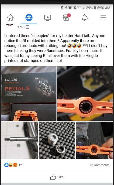

    This sucks. Don't buy offbrand shit

    Seths bike hacks did a video on some knockoffs, at least the ones he found had different branding haha. Those guys didn’t even try

    I used to haul my mtb ariund like that. You’re doing it backwards. I mounted tge fork mounts on the back side of the bed. The area closer to the number for lack of a description, far less hassle dealing with the
    Years ago I has a 1988 4-Runner that had the removable top. Basically the same as a short bed pickup with a topper when the back seat was folded down. I never removed the top, I did however haul my mountain bike around identical to this. The fork mount was on the end near the tailgate. This was before droppers hit the market. I simply pulled the seat off via a quick release seatpost collar. Worked great, and as you said tricky at first figuring out how to get the bike in but once figured out it only takes a few seconds to do it. I didn’t even mount the board in the truck. I cut a 1x12 the length to fit the width with very little clearance. The bike sat stable on the board and it never moved because of the wider platform of the board. And the bike is the length of the bed so it had nowhere to forward or backward. And if you remember those old 4-Runners they had a roll bar in the back. I simply bungee corded the bike up close to it through the roll bar.
