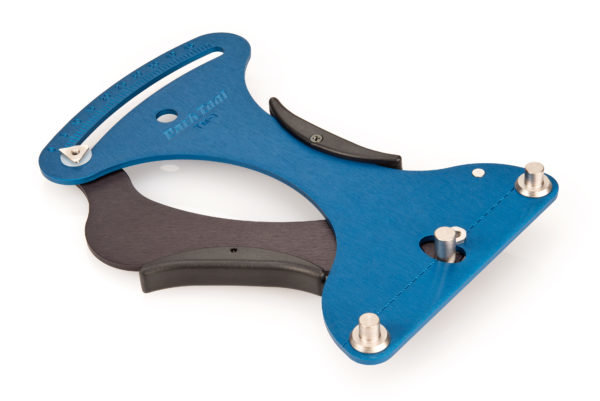

    Tension is arguably more important than true. Set tension first then true the wheel, you risk catastrophic failure is tension is out of whack. Grab a cheap(ish) tension meter from Park, it becomes incredibly useful and you find yourself checking tension regularly. You can then true the wheel on the bike using zip-ties in just a few minutes.
    Park TM-1
