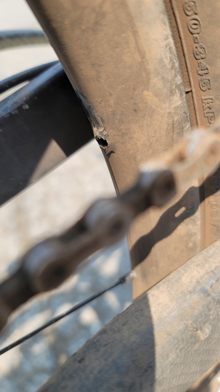

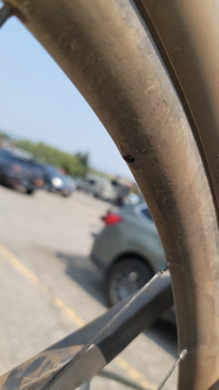

    Pulled a couple spokes out of these Mavic XA Pro Carbon 29ers.
    A little disappointed to say the least, the hoops have been slightly noisy but very responsive.
    Hoping that I get a reply from my email to Mavic to see what they could do.

    How old and what are the nipples made of?

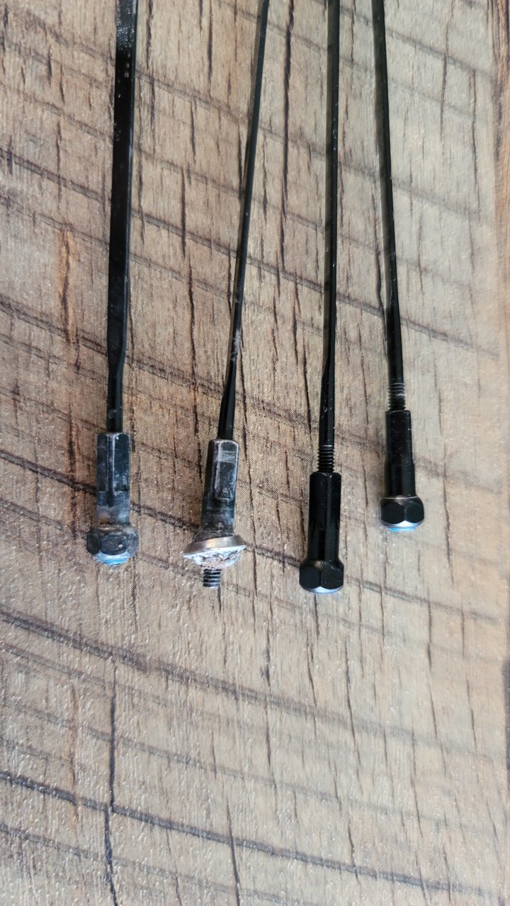

    Purch Aug 2018 and steel nipples.
    Why, what are you thinking?
    The two broken and two new nipples.

    I was wondering if aluminum and if corrosion..........brass should be choice with carbon, IMHO. I don't know about steel actually. Stainless?

    I don't know, they are painted.
    Started a warranty claim with Mavic and Backcountry (purchased there), let's see what happens.

    I'm no bike expert - only been reading - and my previous life I know alloys (not so much interaction with carbon fiber composites)
    Anyway, yes raw aluminum is bad, but hard anodized should work. Many carbon wheels have lube coated hard anodized nipples and seem to work fine.
    Stainless steel no good because galling and work hardening
    Tool and other steels, carbon steels, corrosion
    Titanium, galling
    Other exotic alloys, maybe
    Brass seems to be tried and true but of course is not light
