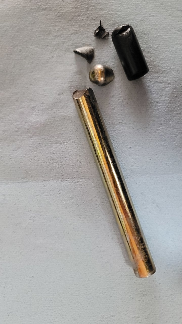

    Re-attached my 1UP for the biking season here in UT.
    The ball bearing on my 1UP won't protrude from the hitch bar anymore to secure the rack to the truck.
    The stock security bolt is screwed all the way in to the stop but the rack flops around because the ball bearing doesn't jam itself to the inside of the hitch rack.
    First time this has happened in a few years of removal/replacement.
    Pulling out the bolt and pushing a hex wrench down the slot against the plunger (?) pushes the ball bearing out as normal. Hex wrench goes deeper than the bolt is able to due to a flange inside that stops the bolt head at a certain point.
    The hitch rack looks normal, ball bearing looks normal, bolt looks normal, just not seeing what's going on inside the 1UP hitch bar below the bolt.
    Is there possibly a short plunger section in front of the bolt that mistakenly fell out that's part of the system?
    Any ideas?
    edit - contacted 1up by email. phone lines are busy.
    edit2 - 1up CS said there should be a 'bullet' spacer in front of the bolt. Off to check rack.
    edit3 - bullet was broken at the tip, replacement part ordered.
    https://www.1up-usa.com/product/bullet/
    The presence of support and 'reasonably' priced replacement parts for every bit of the 1UP rack system continues to amaze me. Stellar product.
