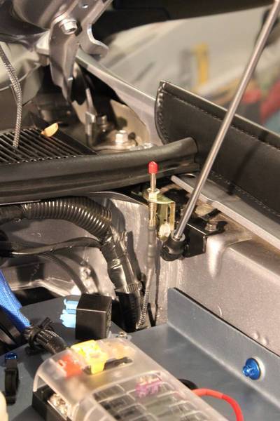

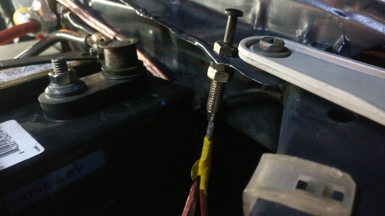

    I used 2 oznium LED "spot" lights and a mercury switch. The spot lights are really bright.. just the 2 mounted to the underside of the hood are bright enough to light the engine bay enough to do just about anything.
    Mercury switches work when they are tilted, the mercury slides to the end with the contacts, closing the circuit. I decided this would be a much better option than a pin switch after reading about alot of people having trouble with their pin switches.
    I couldnt be happier with this mod.. total cost was about $60.
    oznium LED spot lights - $20 each
    mercury switch (from Amazon.com) -$10 with shipping
    a fuse and wire- +/- $10

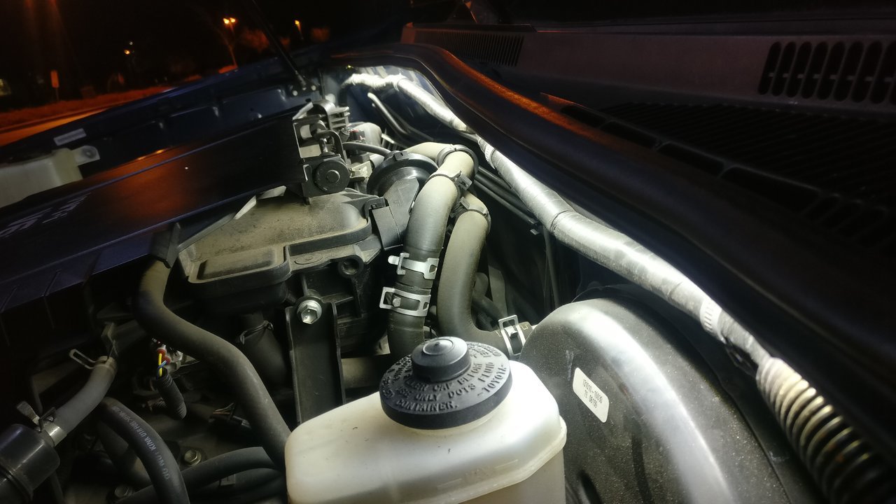

    subd for pin switch location

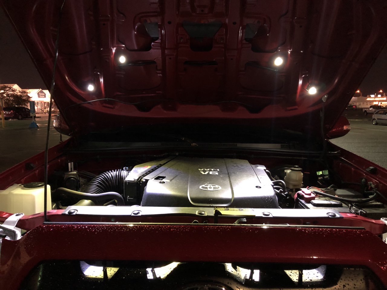

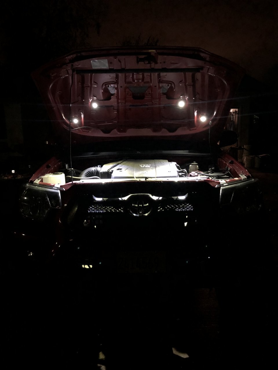

    I have two eagle eyes and a rigid LED strip on the hood. Ran all wiring within existing holes in hood and pin switched to come on when the hood opens.
    Pics

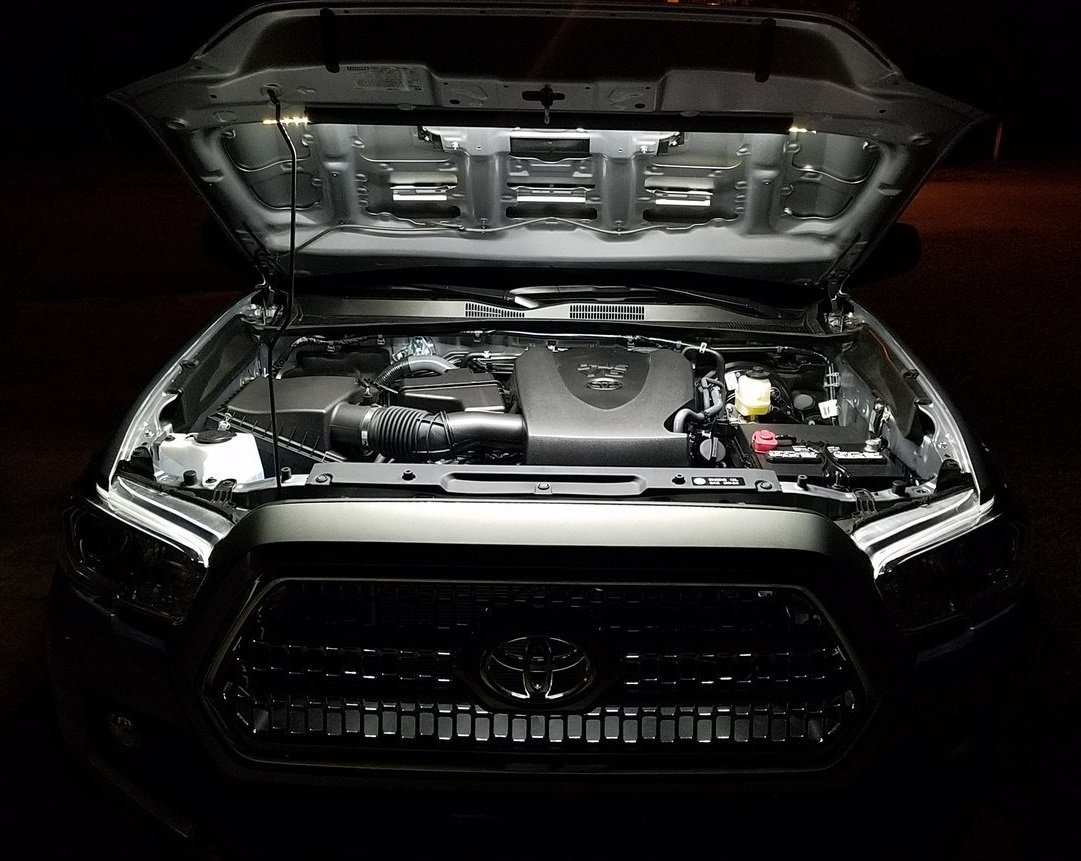

    Fantastic idea! I love it.

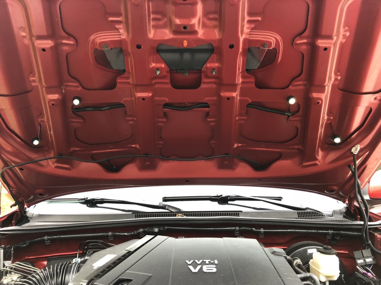

    Implemented this idea in my own little way.

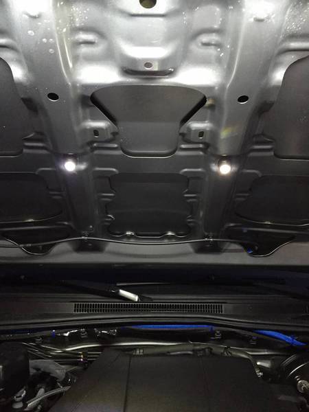

    Menards has some cheap globe led weather resistant bulbs that are about the size of a quarter for around 10 bucks that I installed and work/look great.
