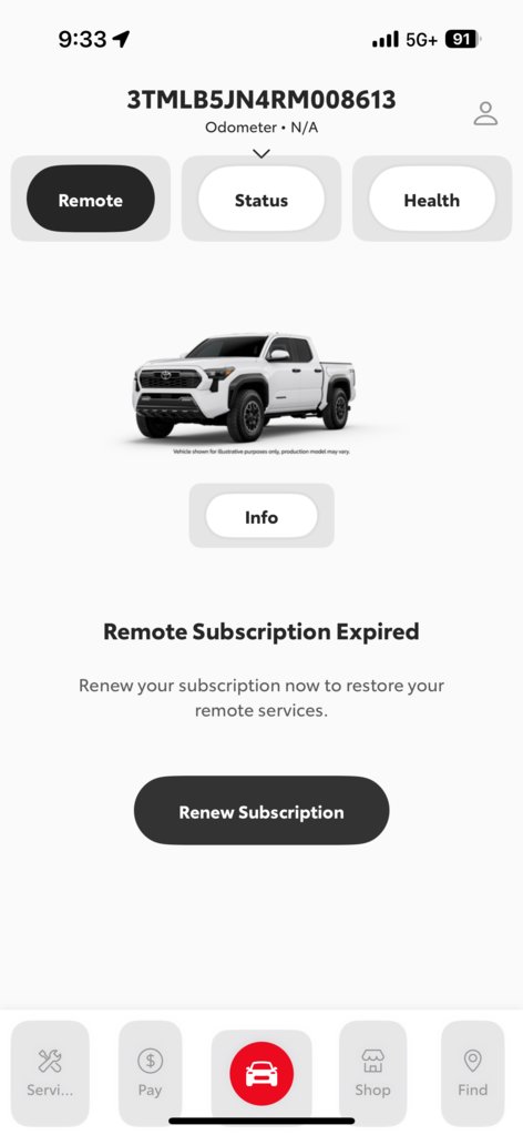

    not sure how long you've had your truck, did your toyota app trials run out? It only happened to me once and it was when those free trial ran out

    Interesting… I’ve had my truck since mid May. How long do they last ? I haven’t used the Toyota app at all

    Got in truck this morning and my HU screen reverted back to bright white. Have had it on dark mode since I changed it when I bought the truck.

    You may be onto something. Hopefully it won’t keep messing with things going forward

    If thats what it was, say goodbye to your TPMS screen lol, thats when mine stopped saving on my DIC as well.

    Yup. It didn’t save the TPMS screen. Only thought it did because I fueled up and truck was off for a minute or two. I was hopeful though.

    technically no, but for some reason it will not stay saved to one of the 3-main dash screens. In my case I think it has to with one of the remote connections in the toyota app. You can still go into the settings and see it and set it to the home screens, it will just disappear when you turn your truck off.

    A few others on Tacoma4G are also saying immediately following the app expiration it’s also resetting everything. Sounds like incentive to keep paying Toyota for the connected services. Jerks
