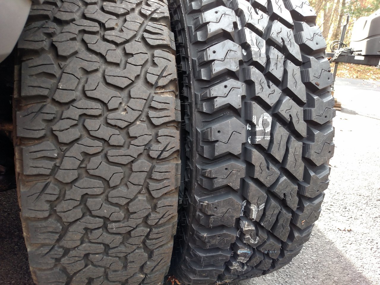

    While I have NEVER run a K02 it doesn’t take a rocket scientist to realize they are horrible in winter / snow. Look at how poor the siping is.
    Now the original BFG all terrains are a solid winter tire. They are not as good as a full on snow. But for an all season I have used them in all sorts of snow conditions and been very happy. Check out the siping on the AT vs the K02.

    I have run a similarly chunky low siping tire and couldn’t climb my the slight incline on my driveway with them. Needed 4wd just to move from the street into my driveway with 1/4” of snow. Now with 12”+ of snow I could go anywhere with them but not once they dug to the road. Same experience between Bridgestone Dueller and Michelin MTR’s. I dug through a 8’ drift with MTR’s and a winch. Once clear and on hard pack I had to winch onto deeper snow to be able to move on my own even with 4wd.
    So do I have experience with K02’s? NO. Do I have experience with similarly patterned low siping tires? Yeah I have a ton of experience. So unless we are talking trail rigs and deep snow I consider a KO2 a poor choice over the original BFG AT. The AT KO will kick the KO2’s ass all day long in ON ROAD performance in winter snow, slush and icy conditions but still falls short of a true snow tire.
