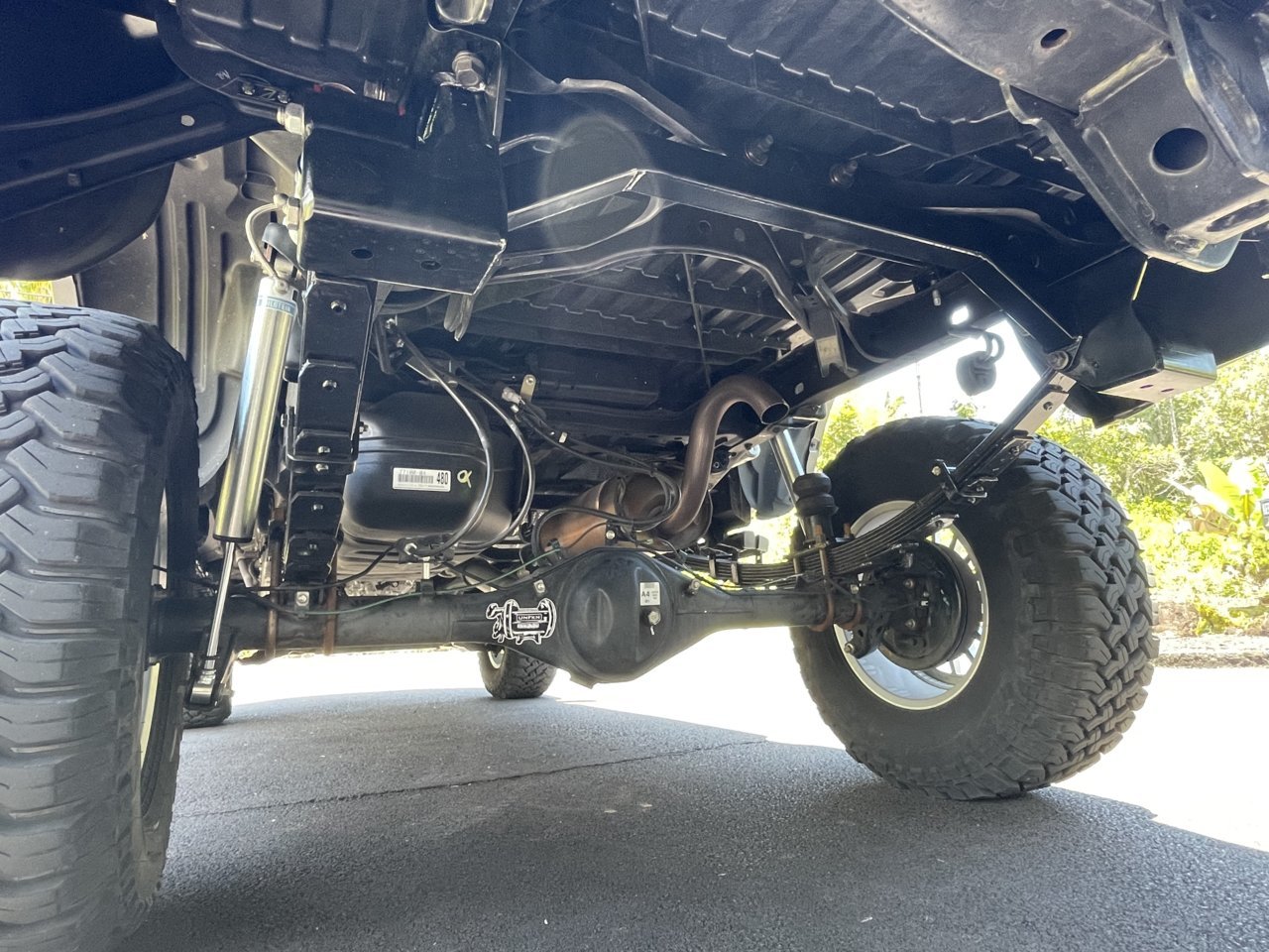

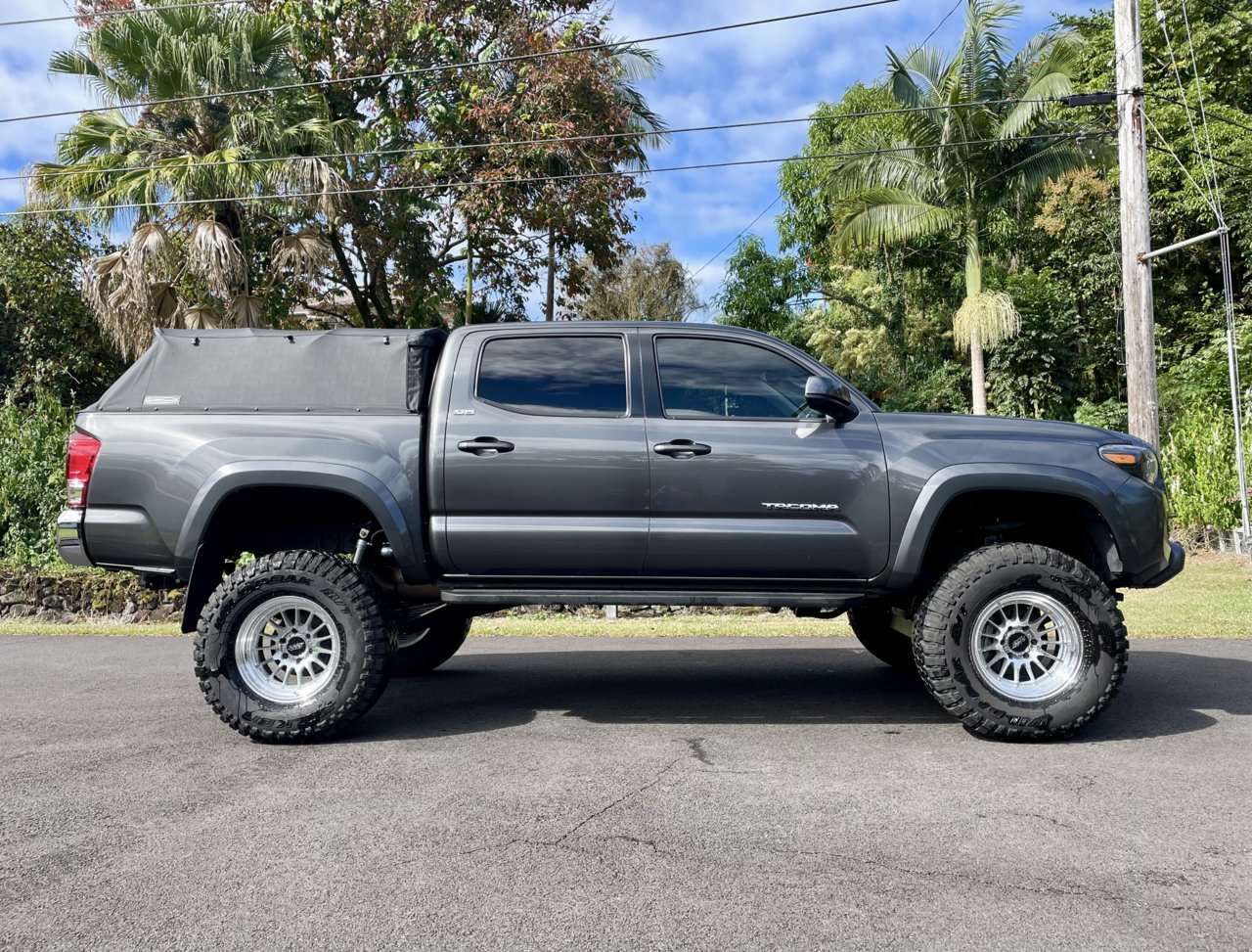

    Pro Comp 6", full length 5100's with OME 888 w/ taco lean spacer, 5160s w/ Alcan custom pack, HS extended brake lines, Summit offroad Dakar 17x9, 315/70/17 Falken Wildpeak MT, Nitro 4.88 regear
    No cv issues.
    get a full leaf pack to eliminate blocks. my custom Alcan pack didn’t require any shimming either - no driveline vibes

    That’s a clean looking truck my guy! I was actually looking in to getting custom alcan springs as well happy that they aren’t gonna break the bank either. Are you running bilstiens? Didn’t know they made them shocks for 6” lifts?

    Yeah, the Bilstein full length front strut part number is F4-BE5-E122-T0. I saved the part number cause I get asked quite often haha
    The rear is a 5160s with 12” travel
