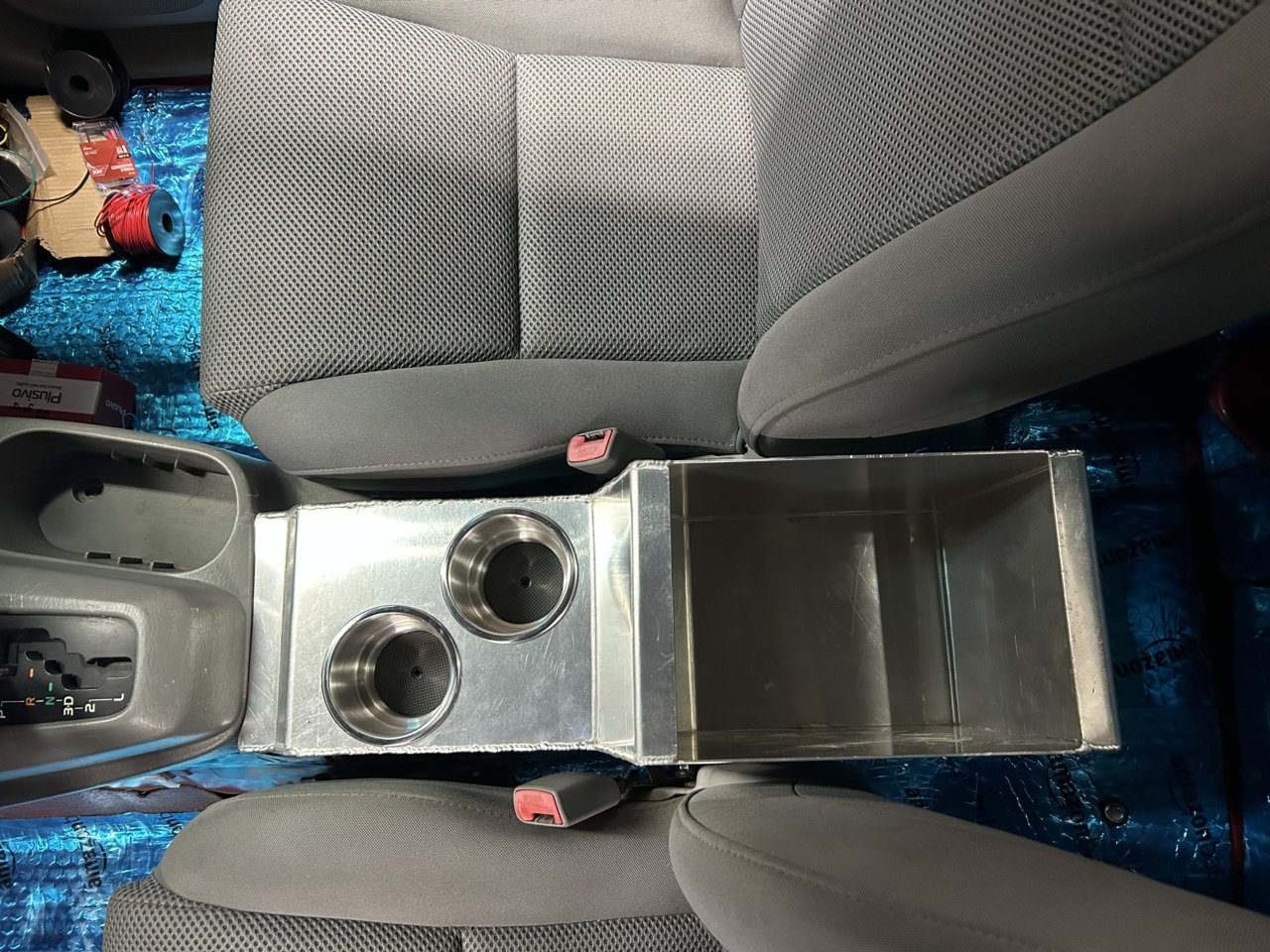

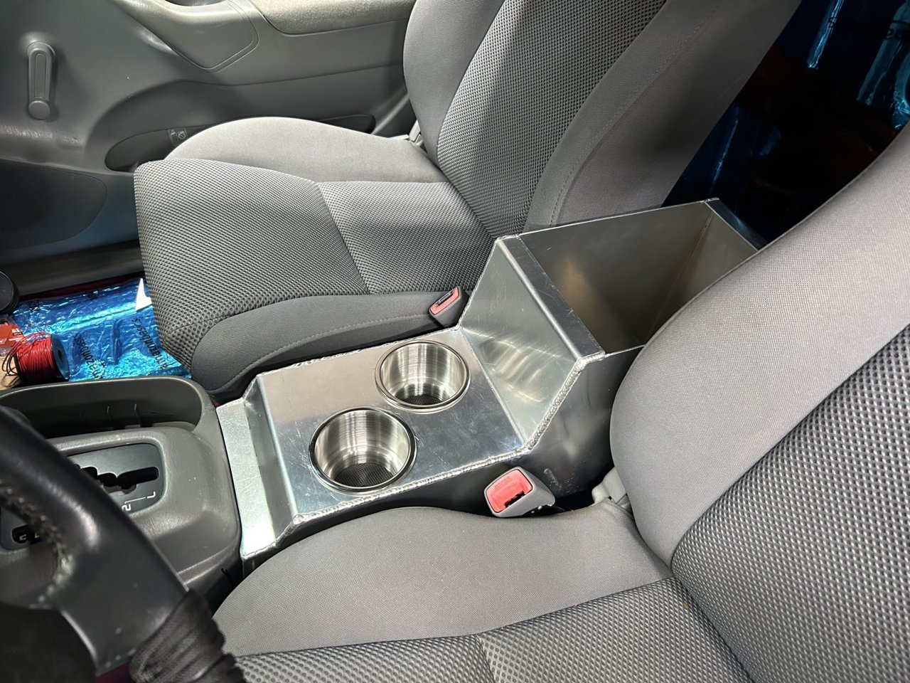

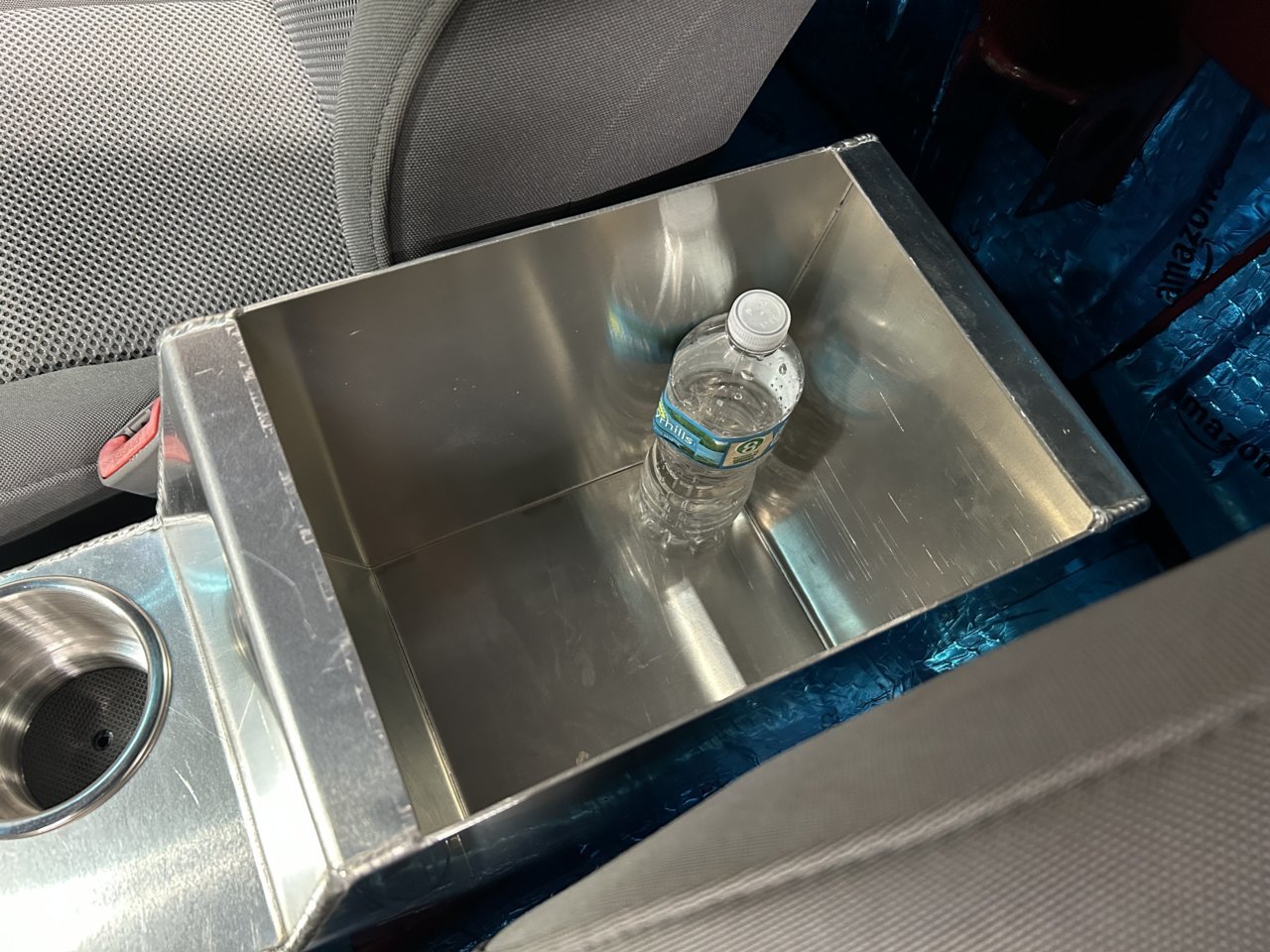

    snatched up some more aluminum for the center console. water bottle for interior space comparison. Might make lid padded if it feels like shit while resting my elbow on it, but we shall see. This is also getting the welds polished down and powder coated when done.

    For crawling not hauling
    Nice! Good stuff!

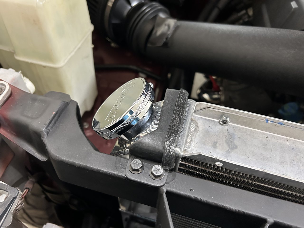

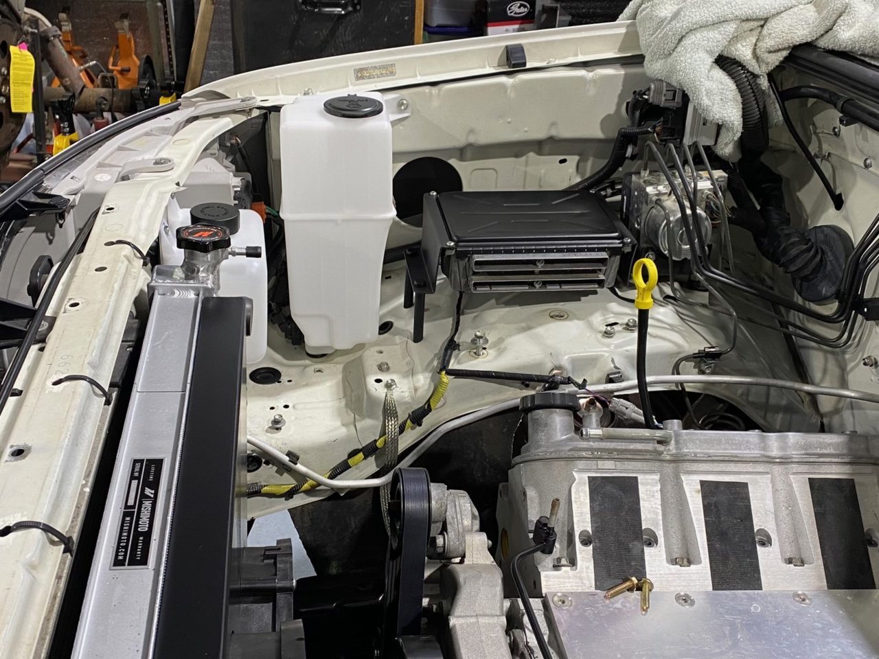

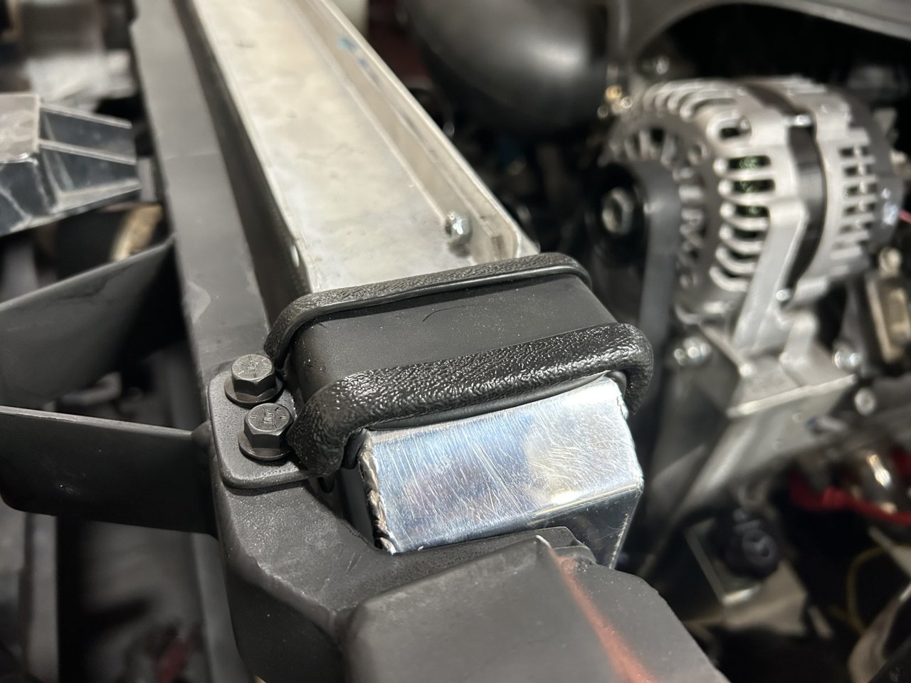

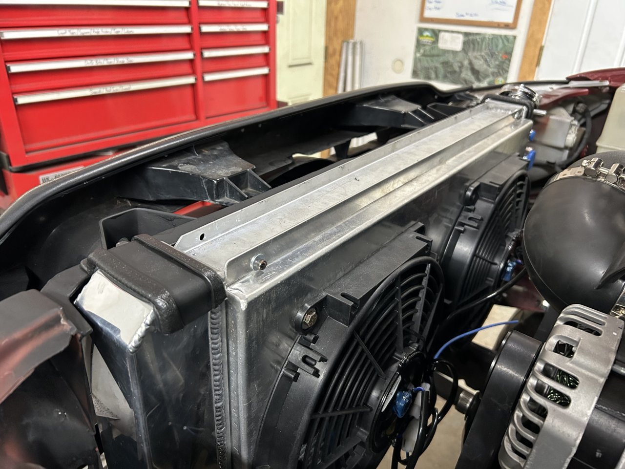

    Radiator mount DONE
    I’m going to get some new rubber/foam later on for these top mounts. The edge trim rubber is just something I had laying around. It works, but it’s a little ugly

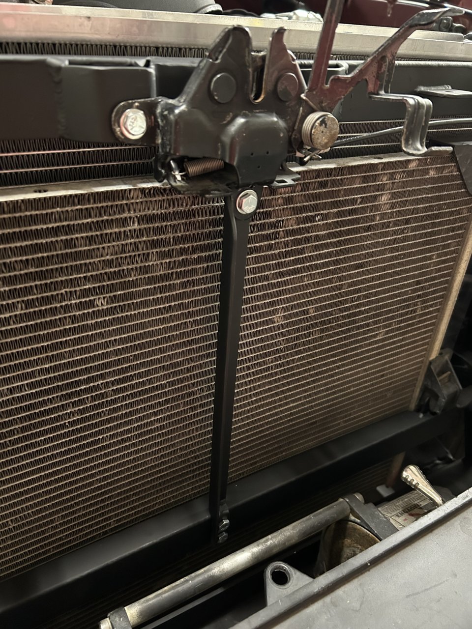

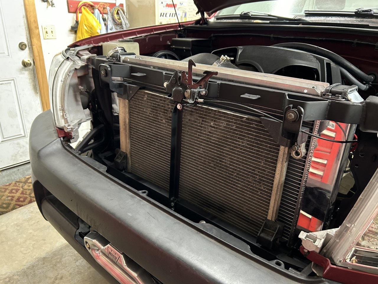

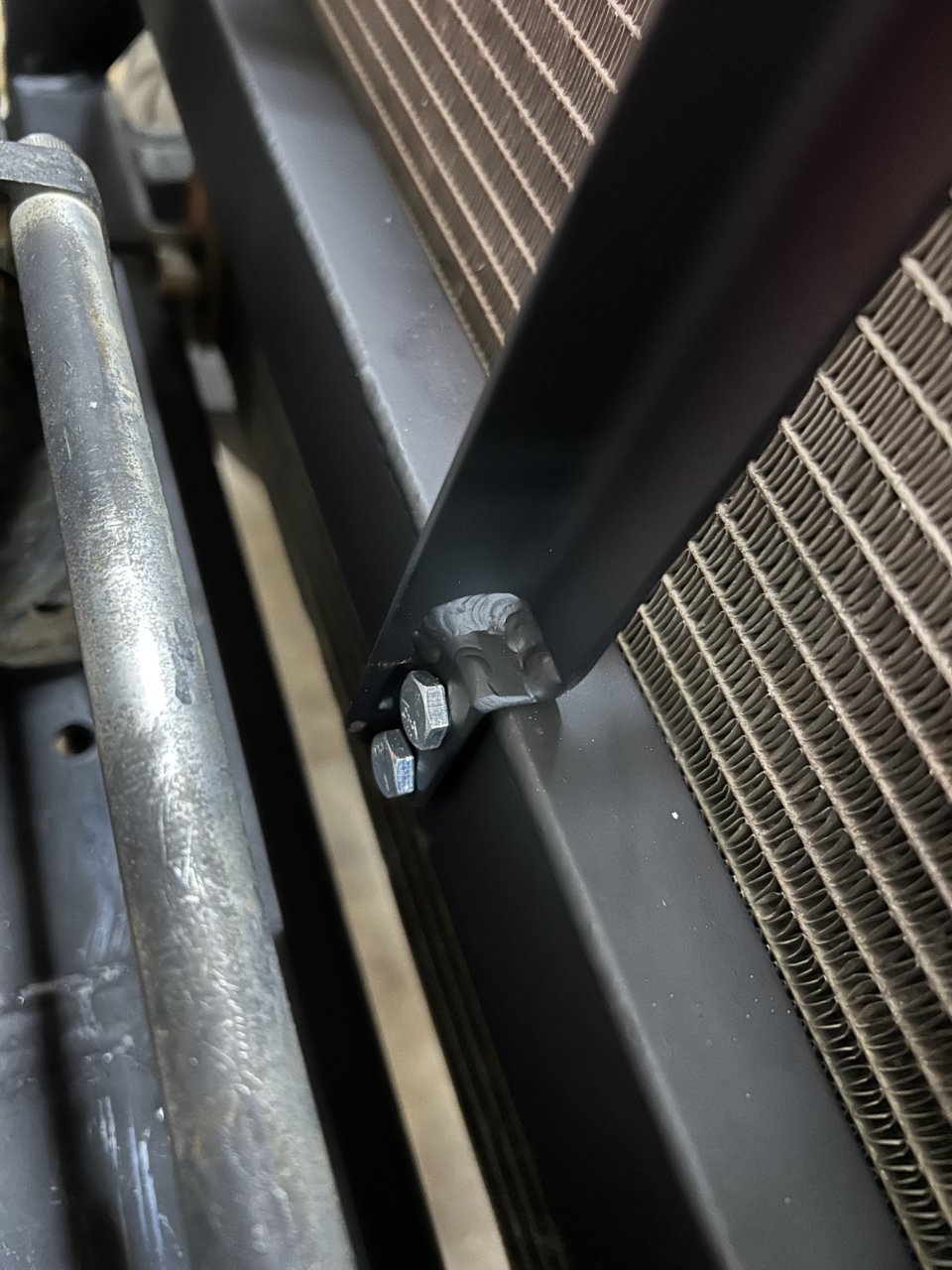

    Core support 100% done, and I’m glad
    I’ll have to add another removable support at some point when I decide to buy the trans cooler (needs to be sooner than later) because it will have to have something to mount to. I’ll cross that bridge later…
    Anyhow, I had to space the latch out some and then bent up some flat bar to make the bolt-in vertical support. Nutserts make life much easier doing bolt on shit like this

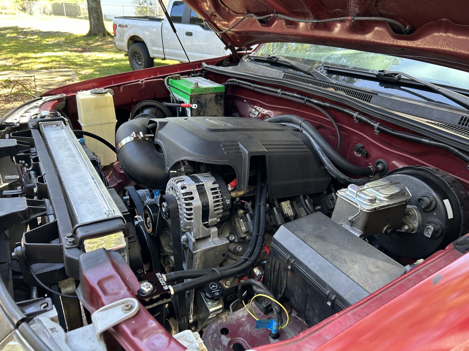

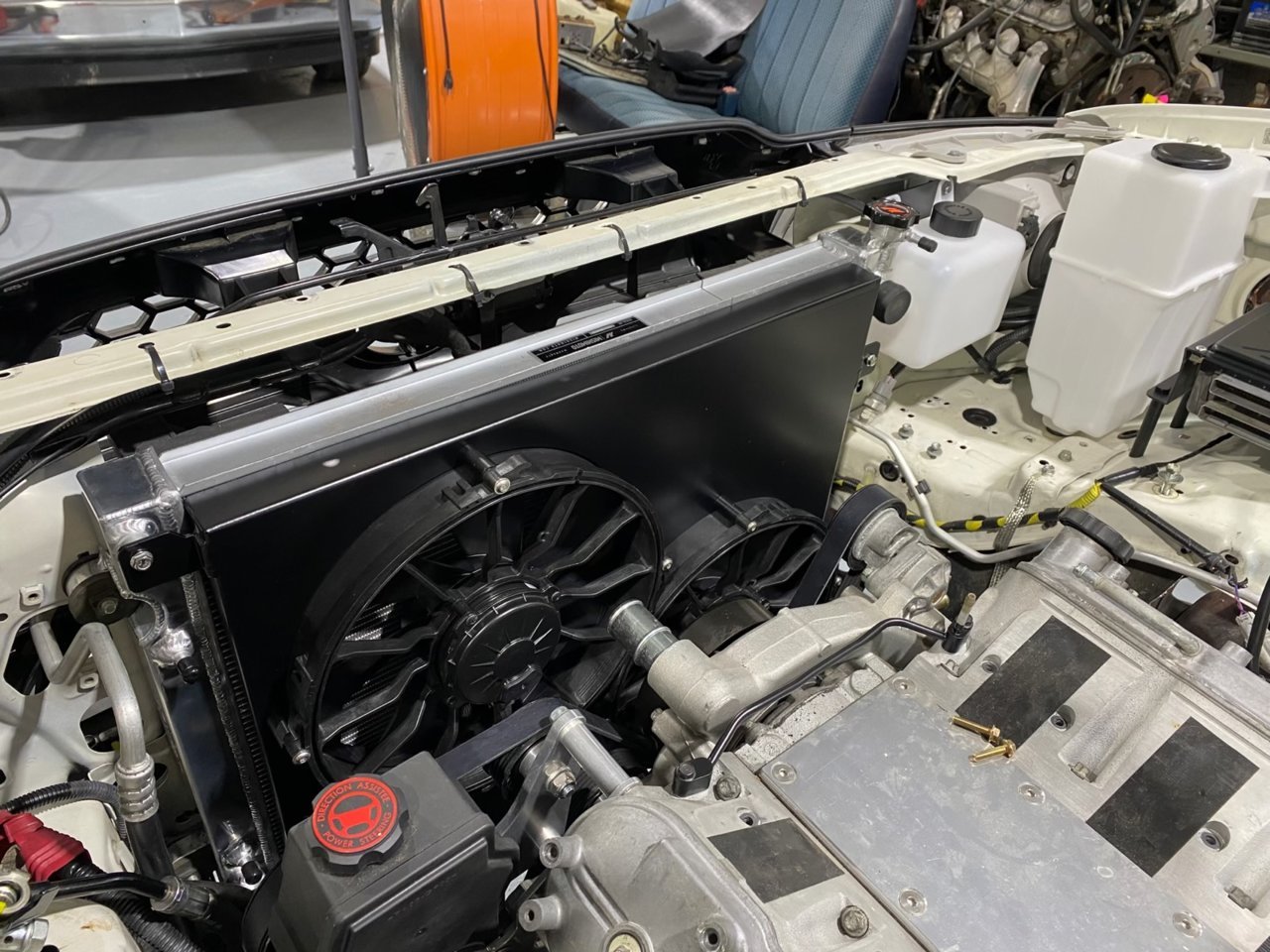

    You know us who can’t fabricate & weld like a machine hate you. :rolleyes: The fan shroud cost me more than the radiator did! Then Andy wanted it powder coated. These are Vette accessories I.e. closest to the engine block.
    Oh, I had to purchase another water pump with the outlet farther to the right.

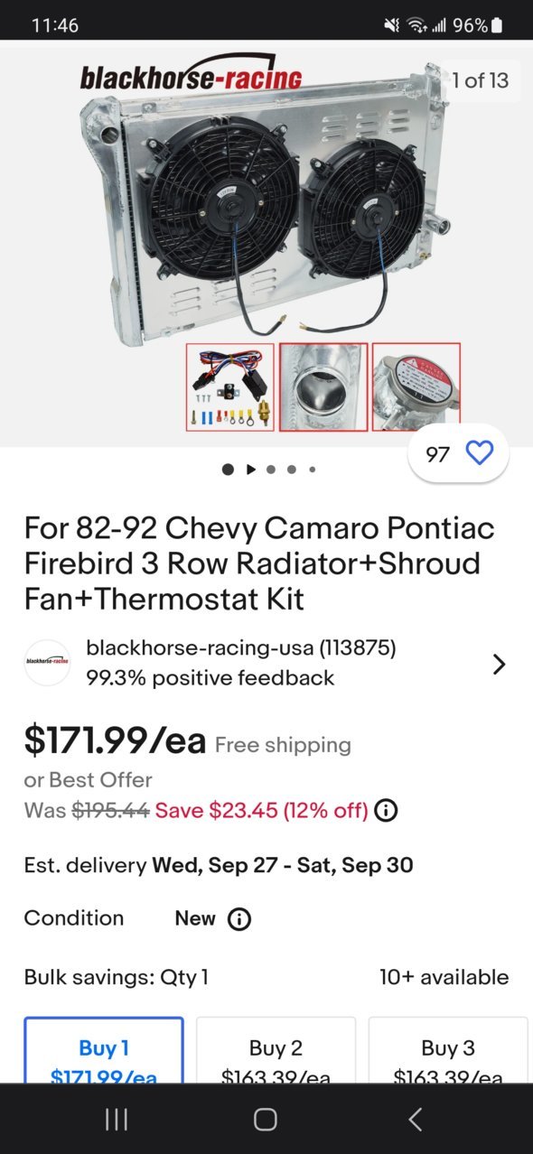

    I guess I need to get into the fan shroud business. I have a grand total of around $62 in mine and that cost was just the material, which I overpaid for by about 30%. I’m still deciding whether or not to powder mine. Might do it along with the air air box and radiator overflow tank that I still have to build

    I bought something like this and made it fit

    Oh yeah, the company that built mine had me go purchase the aluminum sheet from industrial metals other wise they would have to charge me for a full sheet of aluminum. They would pay wholesale and I have to pay them retail and not get the leftover aluminum. They quoted me $200 to $250 max. They called me to tell me it was finished over almost two weeks late I walked in to see what they had done and I must admit it was beautifully made. They then gave me the total price! I said wait a minute you told me $250 max. Oh, that was just to cut the two 12” holes on their CNC machine. I paid just under $574. I would have just turned around and walked out but they had my new Mishimoto and I had just under $70 for the aluminum. So yeah I say you’re missing out. Look at the prices KSR in FL gets for fabrication.

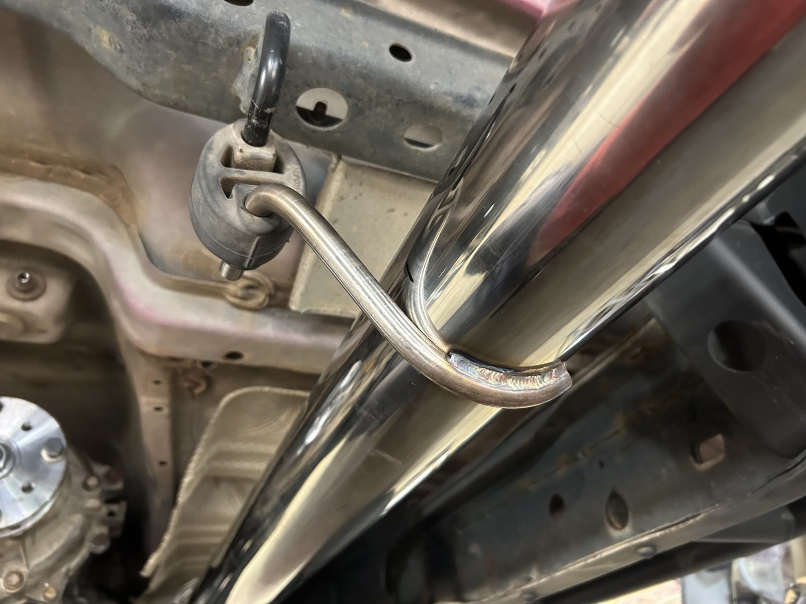

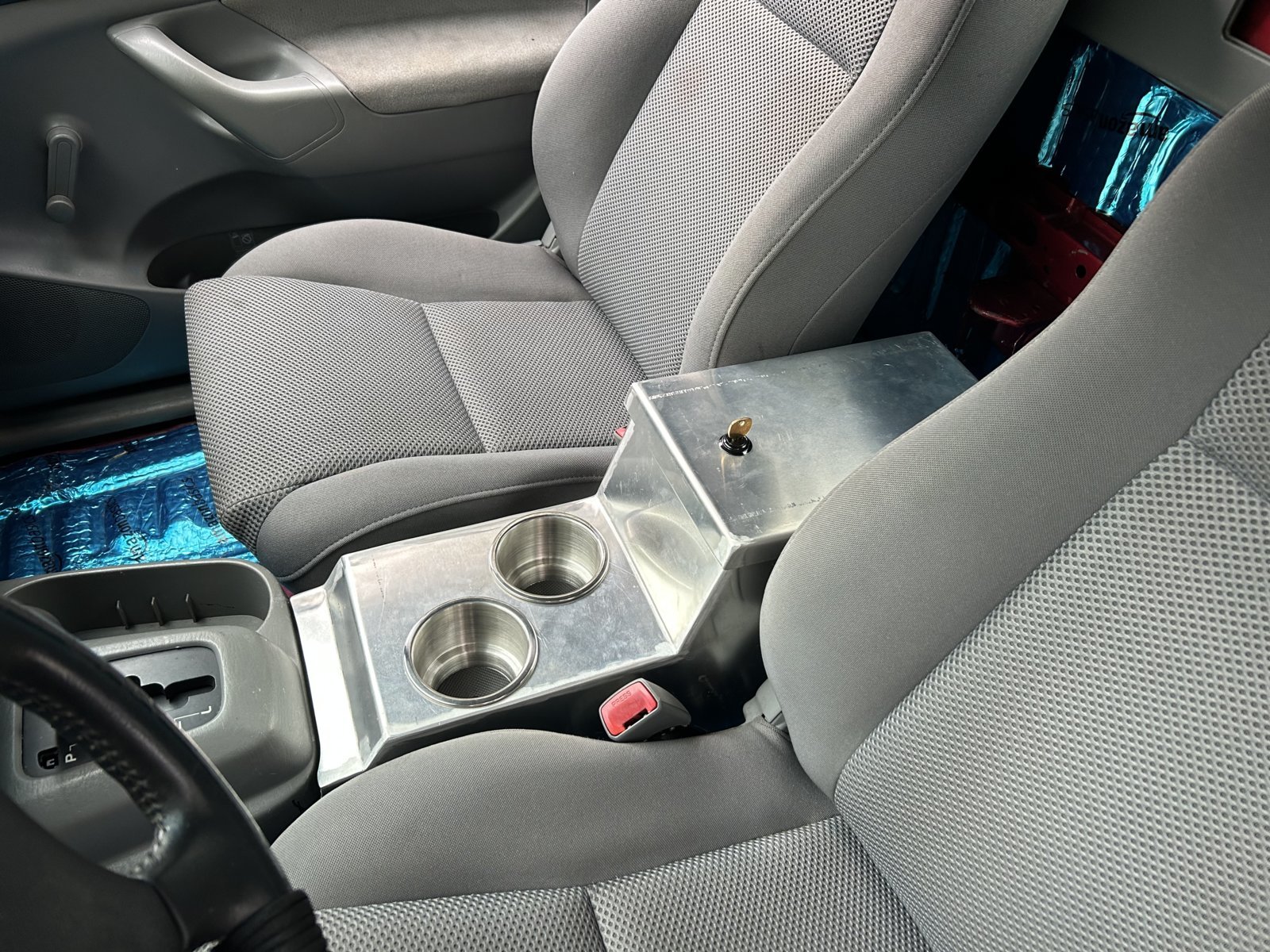

    Been lacking lately, but some things that I have managed to accomplish since the last post:
    - sound deadener in both doors
    - center console done (until the point of coating, then have to add a couple small things)
    - mounted/ran oil catch can
    - Ran 2awg cable from alternator to new battery location
    - installed AN to radiator hose adapters on radiator

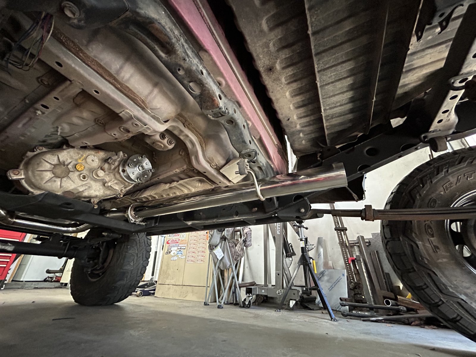

    - welded 3.5" exhaust pipe from collector to just after the first hanger. I'll cut what I need off the end when I figure out what muffler to get

    God you are an incredible welder! :welder: :bowdown: Do you give lessons? :boink:
    And *I* would buy the largest 3.5” muffler you can get in there! When my 2.7L, 2TR was supercharged with the LCE header. I paid an arm and leg to someone to build a 304 SS, TiG, butt welded 2.5”, exhaust system. I supplied everything but the 2.5” pipe and labor. So using an expensive high flow cat I purchased from PPE, a 5x8x14 and a 5x11x22 Magnaflow then out the back with a hidden turndown it DRONES like an SOB!!
    I found another Stainless welder but they don’t build exhaust systems, they make commercial vents, tables for restaurants & etc… But they said if I fit the pipe and mark where I wanted to join the pipe together they would weld everything. So I found what they call “Tack Clamps”. It’s nothing but an exhaust clamp with 3 or 4 holes cut in the center so the pipe can be tacked together. It’s time for taller jack stands and a creeper w/ bigger wheels. Our garage floor has wide seams in the floor and I’m always getting stuck! :frusty:
    Anyway here’s a link to the overpriced clamps. I wish I knew someone with water or laser cutter.
    https://sscustoms.com.au/collections/all-products/products/tacking-band

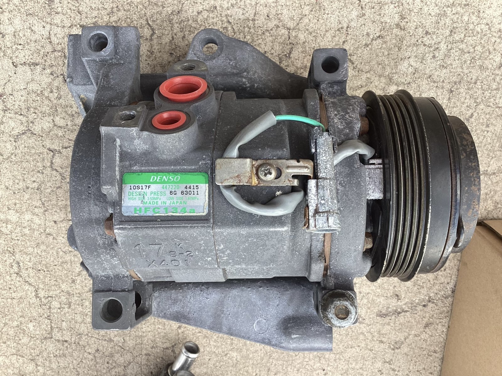

    Oh, Being you’re running the truck accessories and I don’t know if you were going to run AC I have a AC compressor and bracket there’s yours if you cover the shipping?

    I actually snagged a compressor not long ago but I appreciate the offer.
