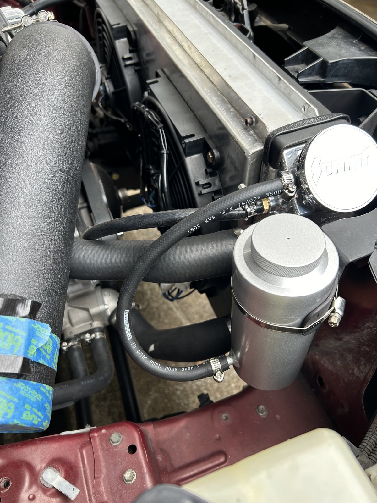

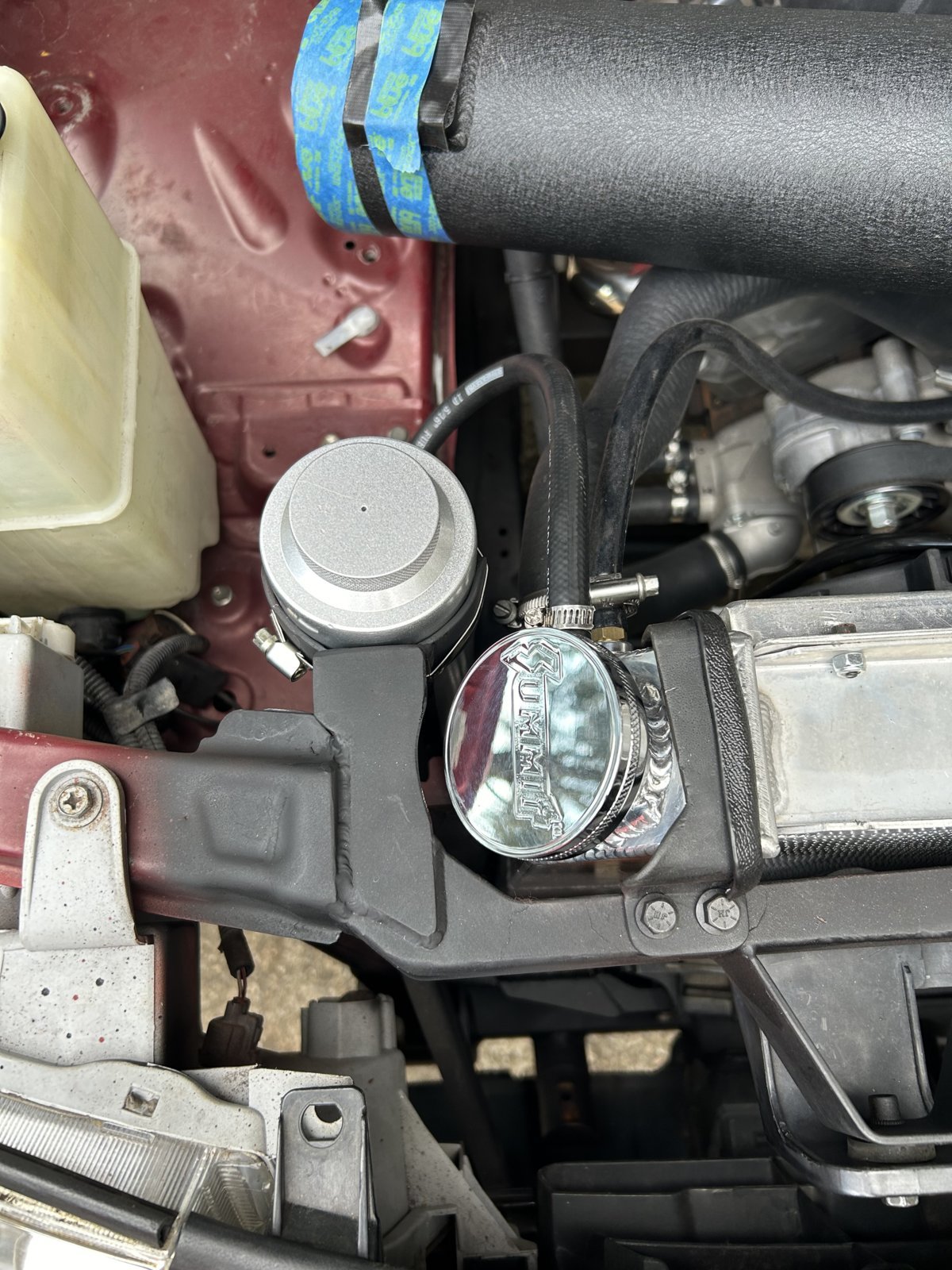

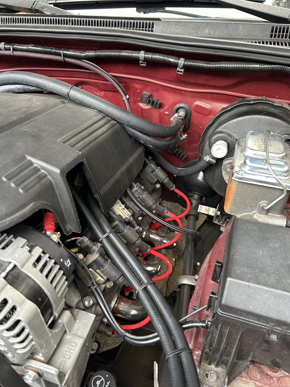

    So I haven’t done shit or spent any money on this thing barely since the last update. I started working for myself back in September so I’ve been focusing and dedicating more money to that so I can get it going more.

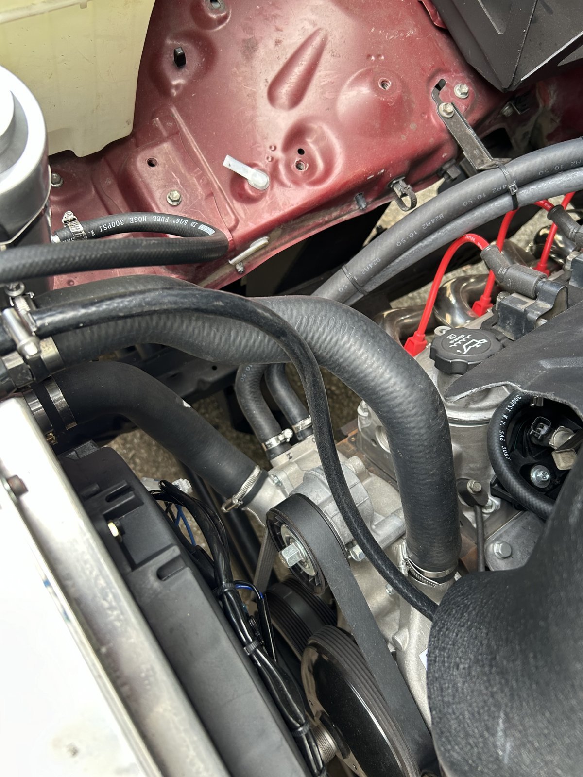

    But, the few things I have done have been cheap. I bought a cheap coolant resi on Amazon so I welded up a little mount for that which welds to the new core support, right next to the radiator. Also found some perfect radiator hoses at the local parts store, so those will be available anywhere, anytime if needed. So outside of 4 bolts I’ve yet to buy for the cooling fans, the cooling system is DONE.
    I also got what I think is the last of the factory wiring done. And in cheap fashion, I repurposed an unused cable from a winch for the factory fuse box to the alternator (which has a new cable running from it, to the new battery location) so that will have constant power. I also reused some wire for the starter solenoid trigger wire that runs from the fuse box, along the power cables to the passenger side. I’ll finish that cable once I get a starter.
    Oh and the brake booster is now connected to the manifold. I had to get a GM 90° check valve to fit the booster and have a barbed fitting for a 1/2” hose.

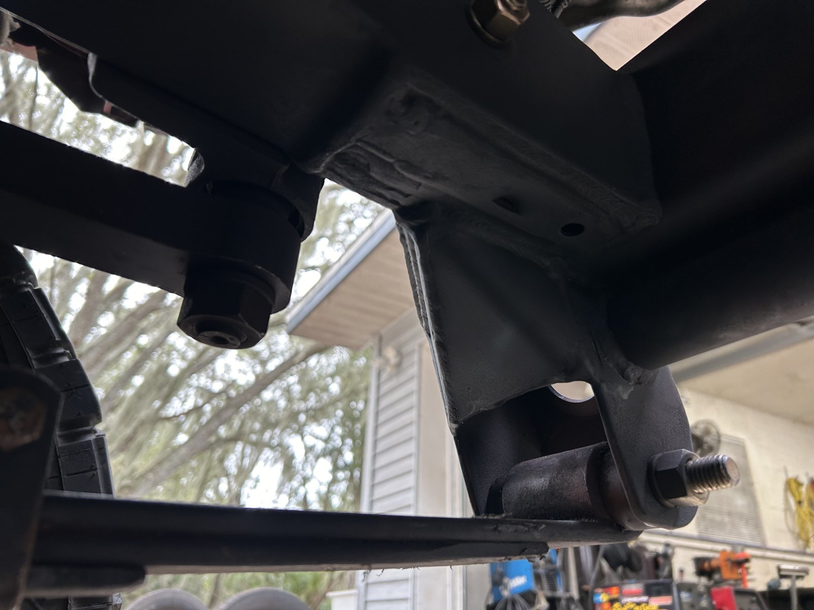

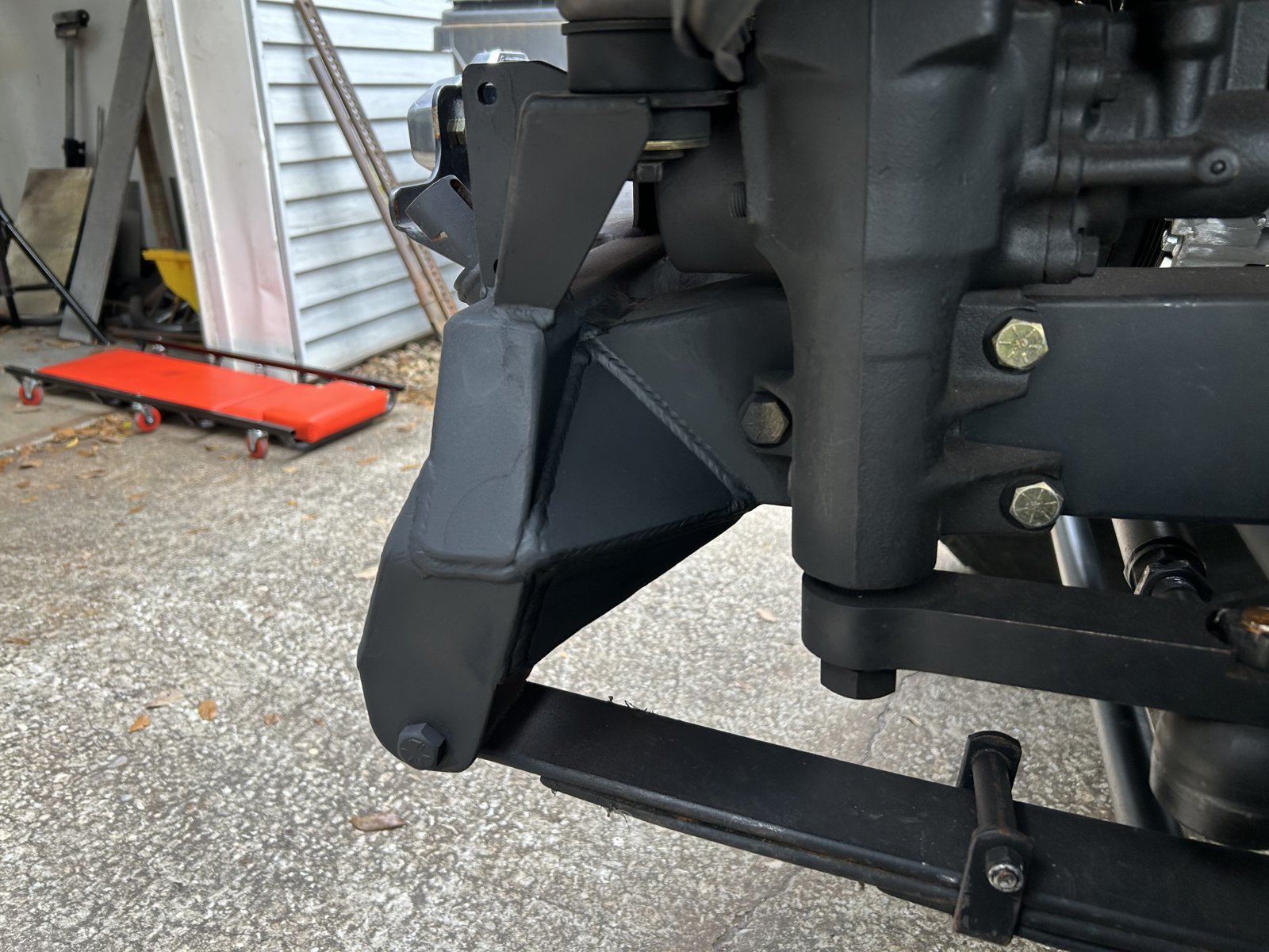

    Finally finished gusseting the front spring hangers
    I’m considering making 1”-1.5” longer shackles for the front. It’s looking like I’m going to need to add some castor and bring the front up a tad to be more level

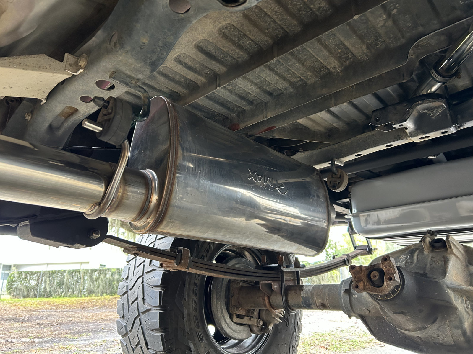

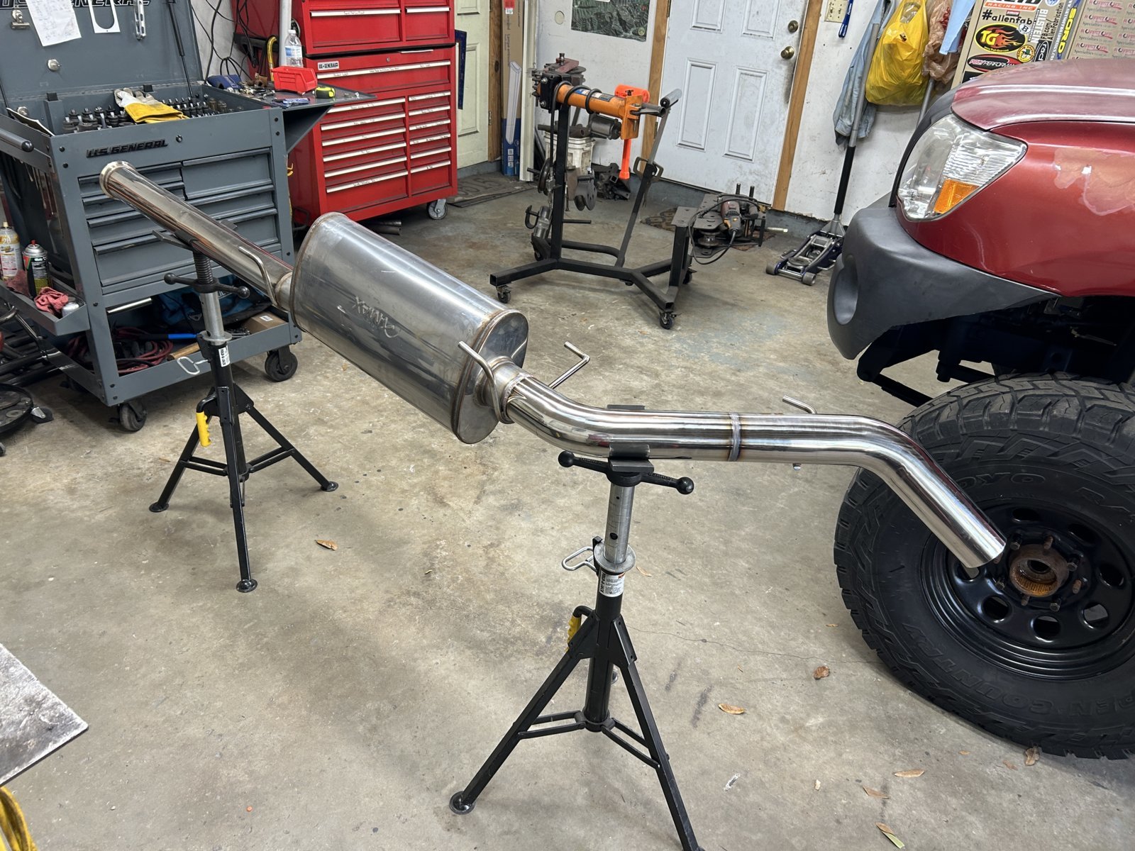

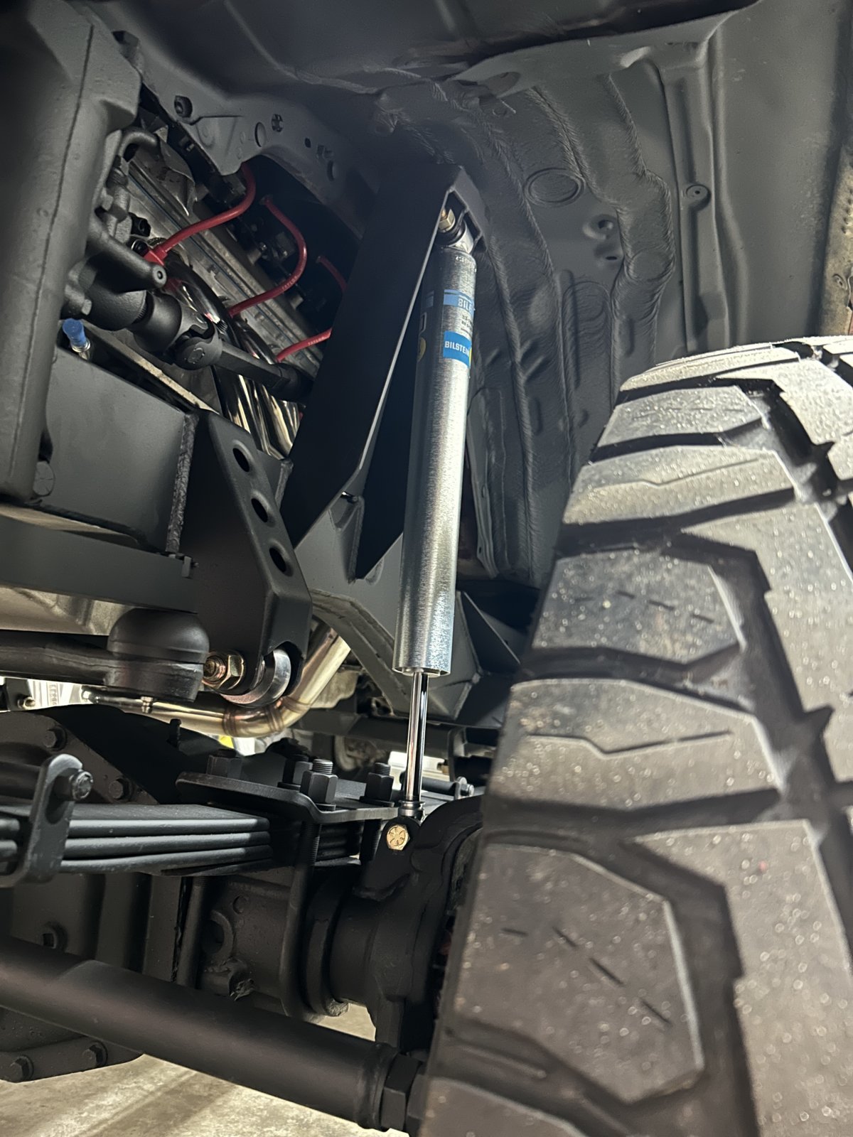

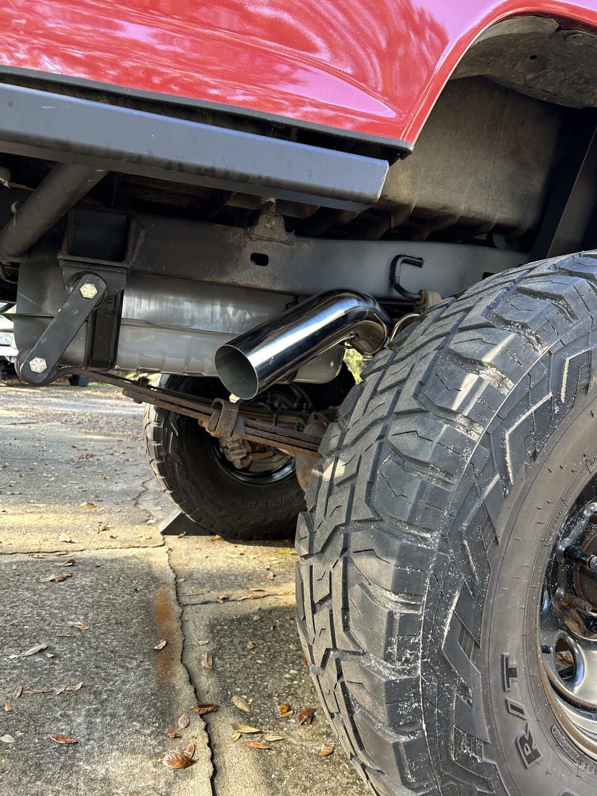

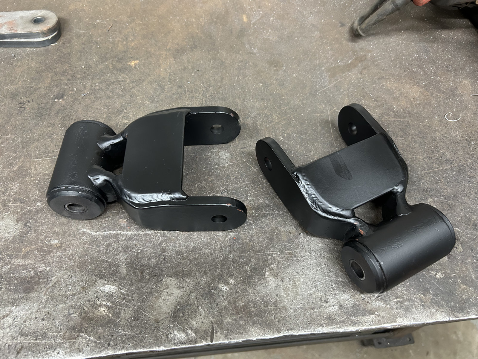

    Decided to knock out the shackles on the front. Remade them from 3.75" to 5" and it kicked the caster to about 5 degrees, and will give me a little more uptravel. I'm much happier how everything is in the front now. Ordering shocks next week to finish that up
    Finally found a muffler that I think I will be happy with, 22x11 stainless Street max, 3.5" in and out. It was the biggest muffler I could fit lol. It was only $120 from jegs and the few sound clips I found of it were pretty quiet. Ordering a couple of 45s to make the tailpipe dump out near the factory location next week as well.

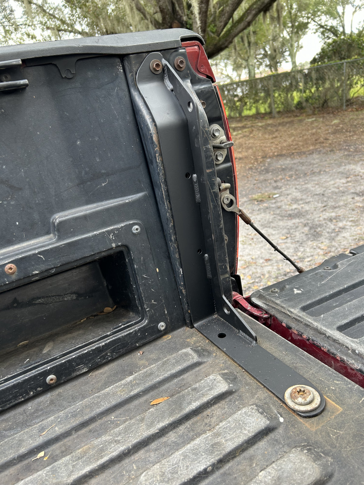

    Knocked out some bed stiffeners that I wasn't really even sure I needed. Easy project though and better to have them than not I suppose.

    Im a lot happier when I went with longer shackles. Helped with steering clearance

    No need to splurge on shocks when you’re on leaf springs

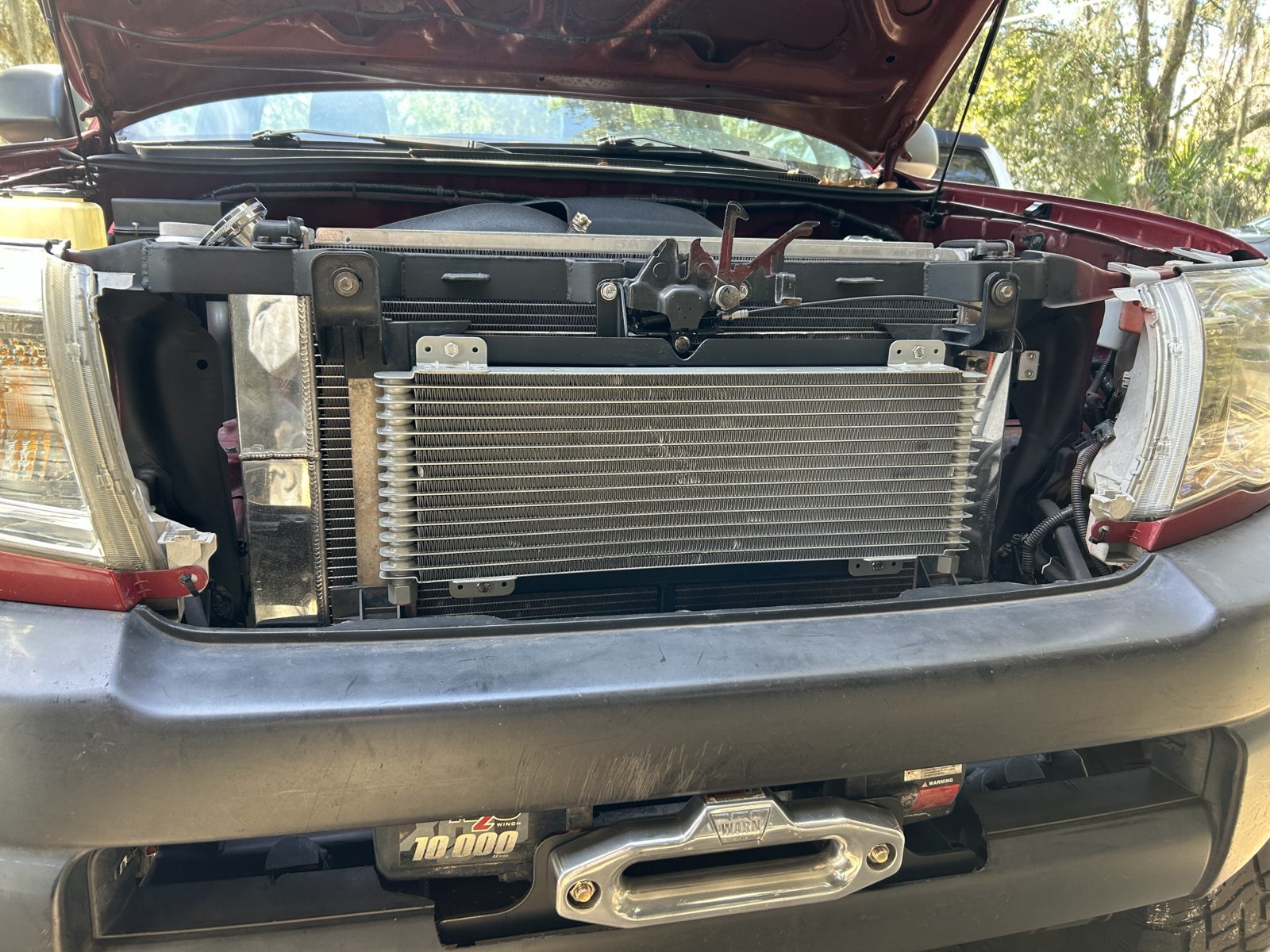

    A lil bling for the exhaust. Near factory-ish exit but 3.5” and stainless

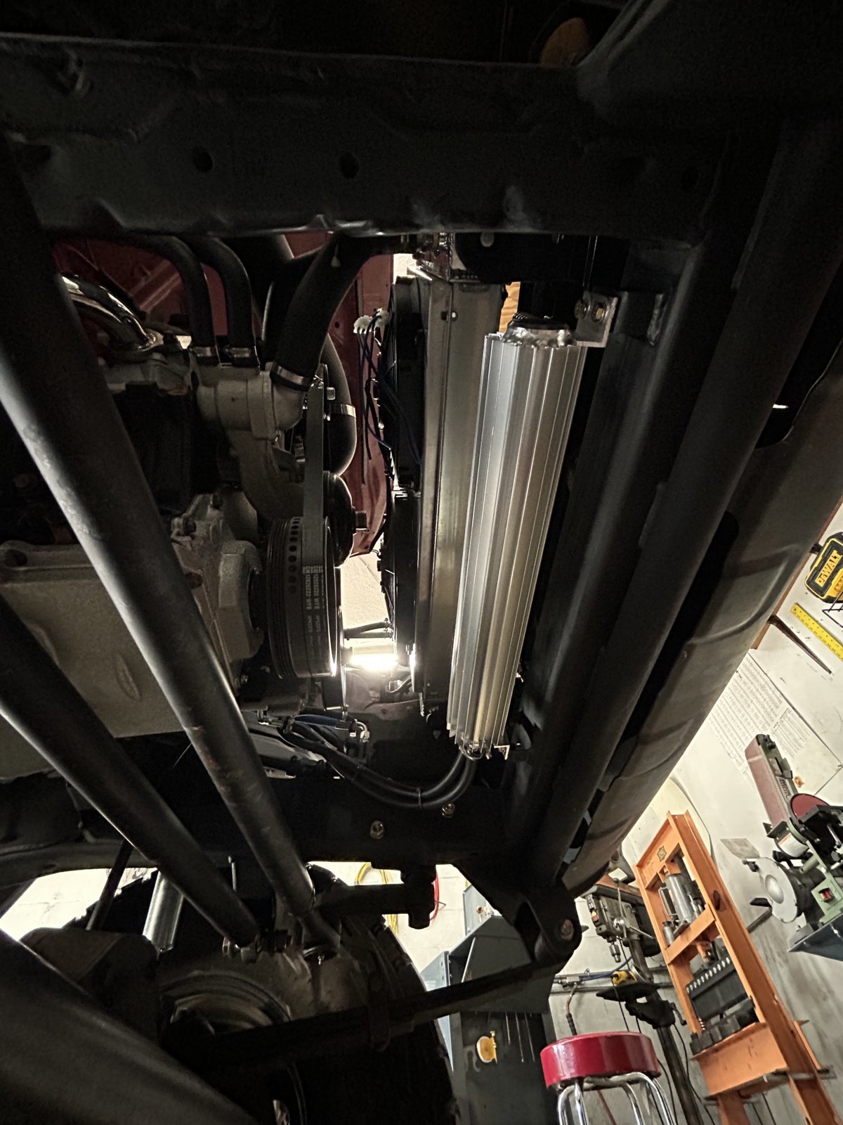

    ordered a tru-cool brand 40k trans cooler on Amazon…. Took forever to get here, and when it did, it was clearly a knockoff. Whatever, eating the cost and running it anyway

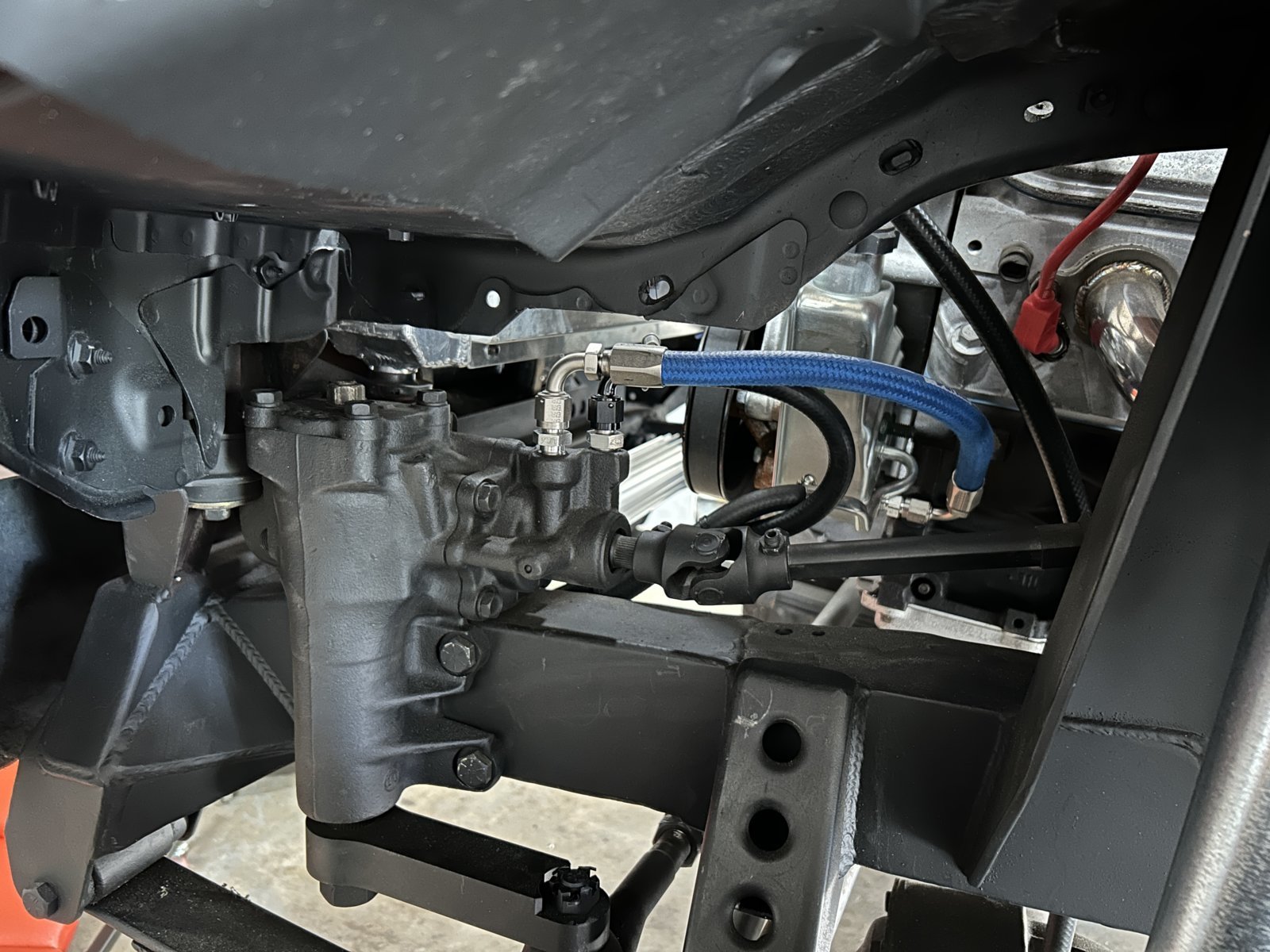

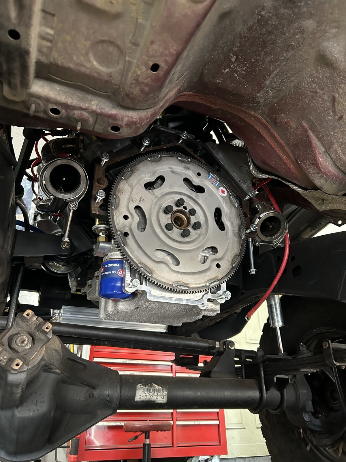

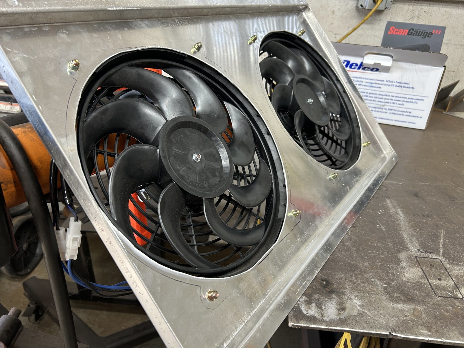

    Been quietly working on this thing lately, mostly just boring stuff. I only have Sundays to work on it at the moment...
    -roof sound deadener installed
    -center console and gauge cluster pulled for powder coat
    -steering cooler and lines made
    -radiator fan shroud completed with nutserts and reinstalled
    -transmission pulled for rebuild
    -o2 sensor bung welded into drive side collector
    Starter, flexplate, Scangauge 3, most brake lines, and charcoal canister are here and awaiting install. The next three big purchases are going to be the Harness (still :D), torque converter, and rear driveshaft. After that, I can get this thing cranked and the I will move on to the rear axle rebuild
