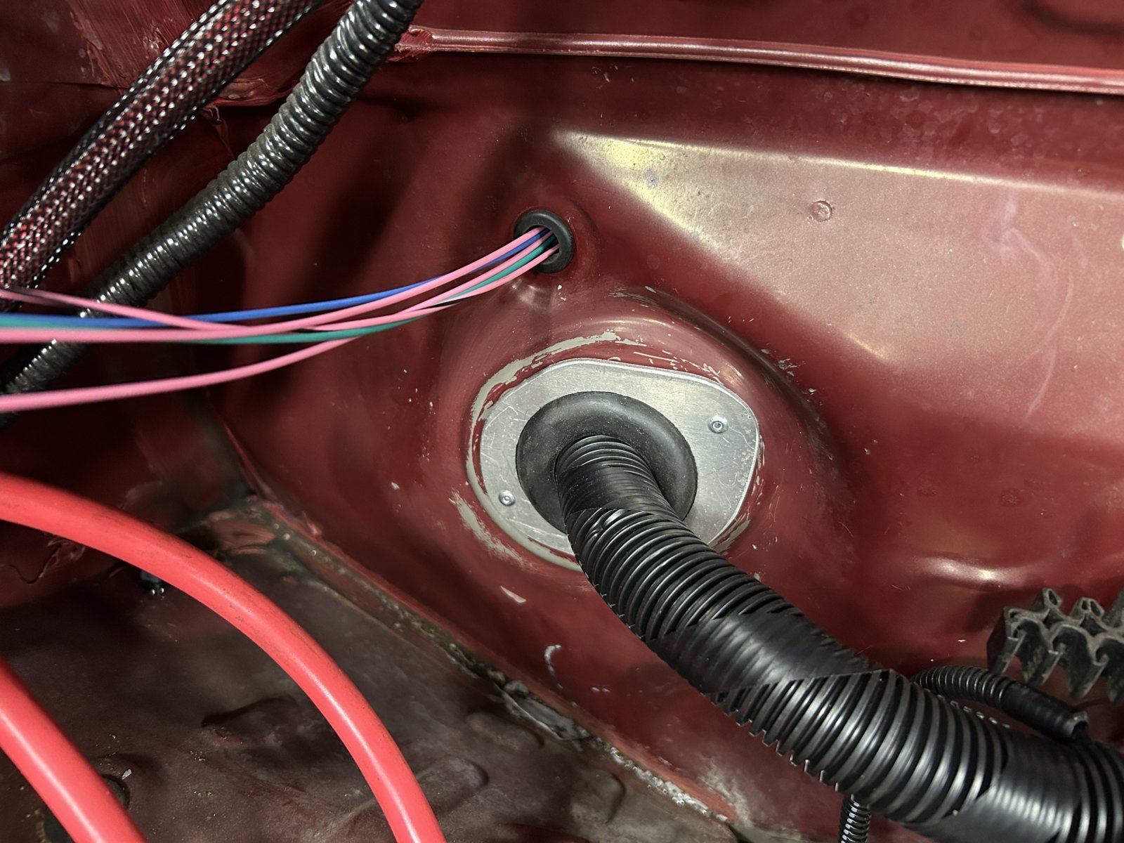

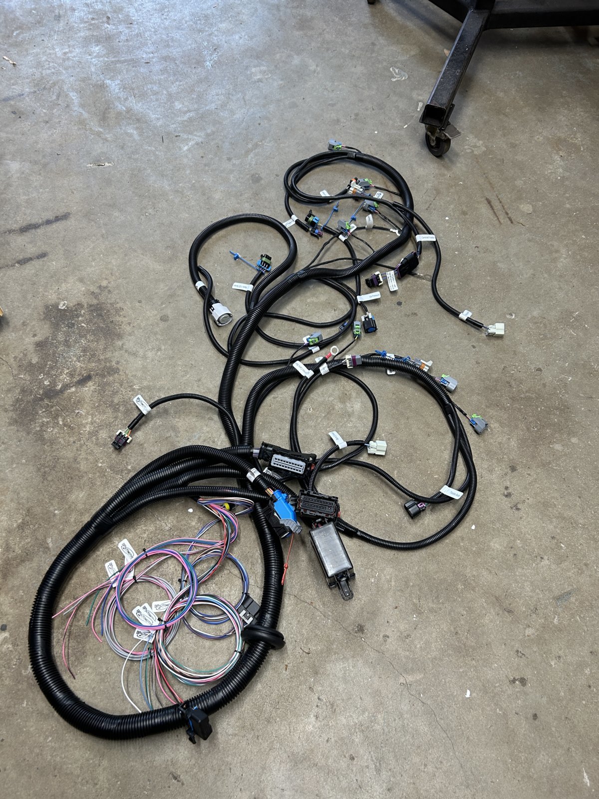

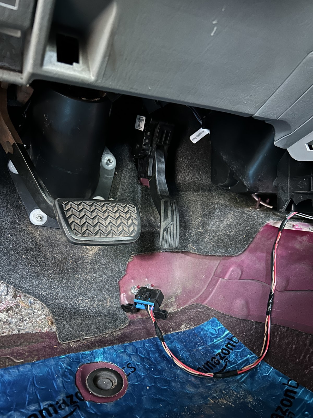

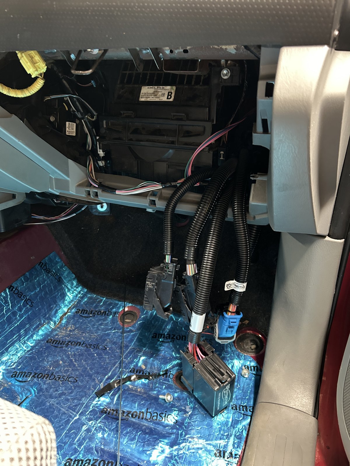

    BP swap kit is here and 60% installed. VERY happy so far with the kit. Forgot (didn't realize) that I needed a separate fan relay control kit so I got that ordered. I also need a different oil pressure sensor but other than that, everything is there. I still need to run a few more wires for the oil pressure/trans temp/coolant temp sensors so I will loom those and run along the BP harness for a factory look. GM pedal trimmed down and installed, firewall plate riveted in place, and most shit is routed to just about where it needs to be.
    I am going to build a nice aluminum air intake box so keep it as sealed off from the engine bay as possible. I even have some Lexan laying around for a clear top....

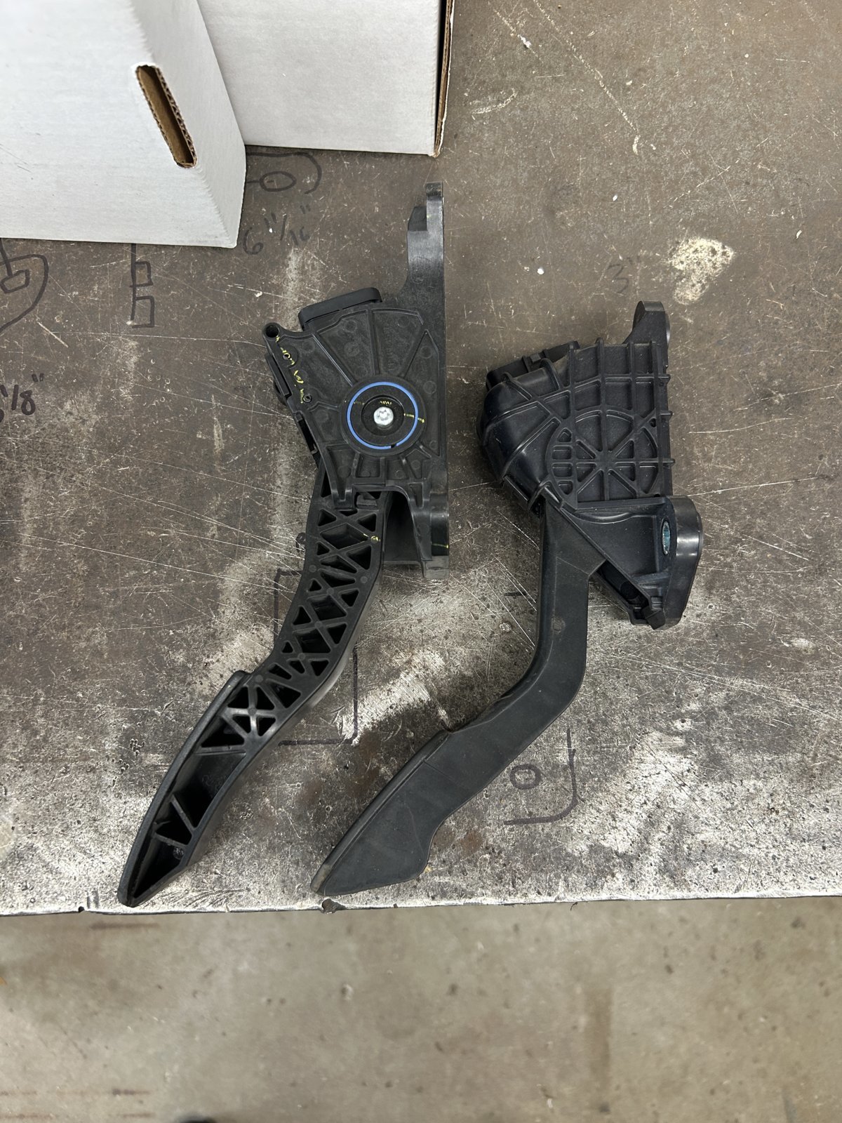

    Can I ask a stupid question?
    Where or What is the gas pedal from?
    I had to buy a pedal, tach module, ECU/PDM from an 02 Silverado and $1175 for a wiring harness. I also had to buy new 02’s after spending over $120 for Denso 02’s. I purchased just about every part more than once!
    :frusty:
  10. Mar 11, 2024 at 3:27 PM
    #270
    allenfab
    allenfab [OP] I hate everything
    Oct 23, 2014
    #140913
    2,653
    Todd
    Lakeland, FL
    08 5-lug on one tons
    I’m not sure what vehicle the pedal is meant for, but it was included in the BP engine controller kit. Complete new harness, ecm, tcm, ecu mount, gas pedal, gm o2 sensors, and MAF sensor and weld on maf plate for $1550 delivered

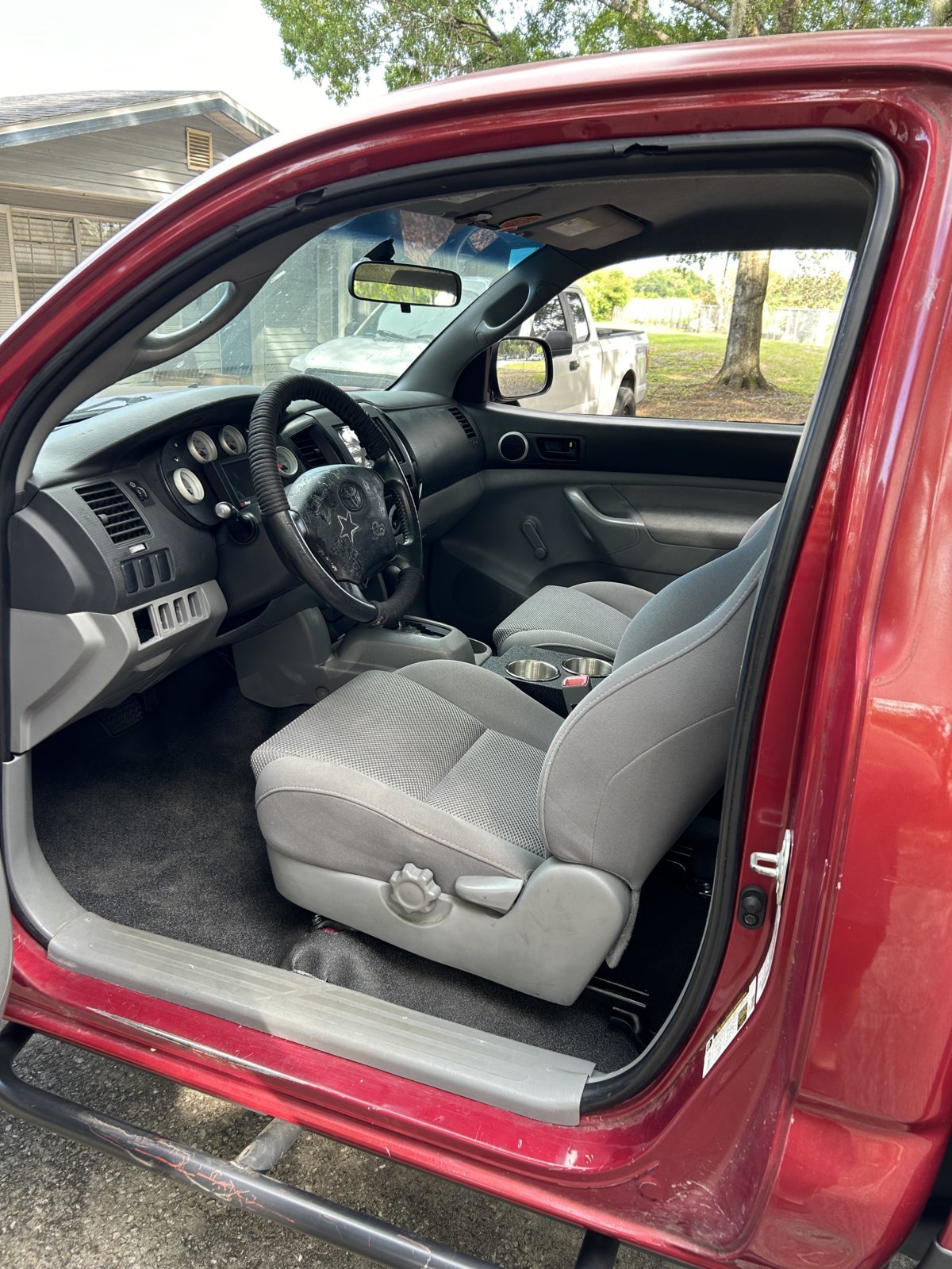

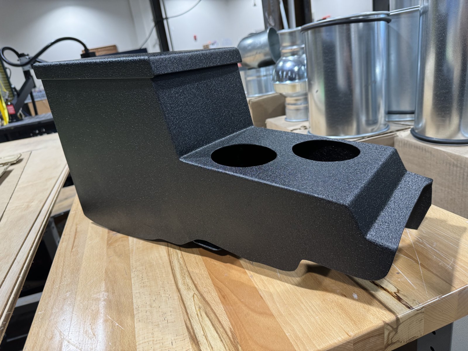

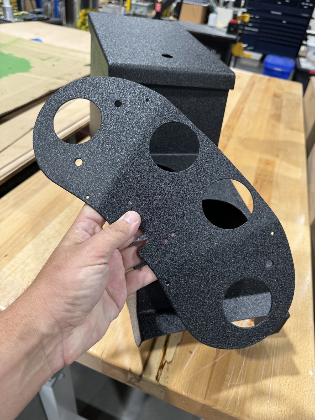

    Cluster and center console back from powder. Should have this thing turning over in the next two weeks

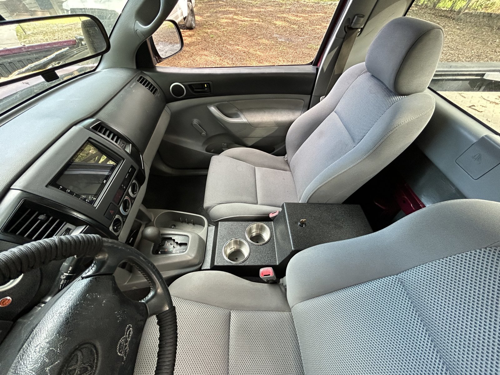

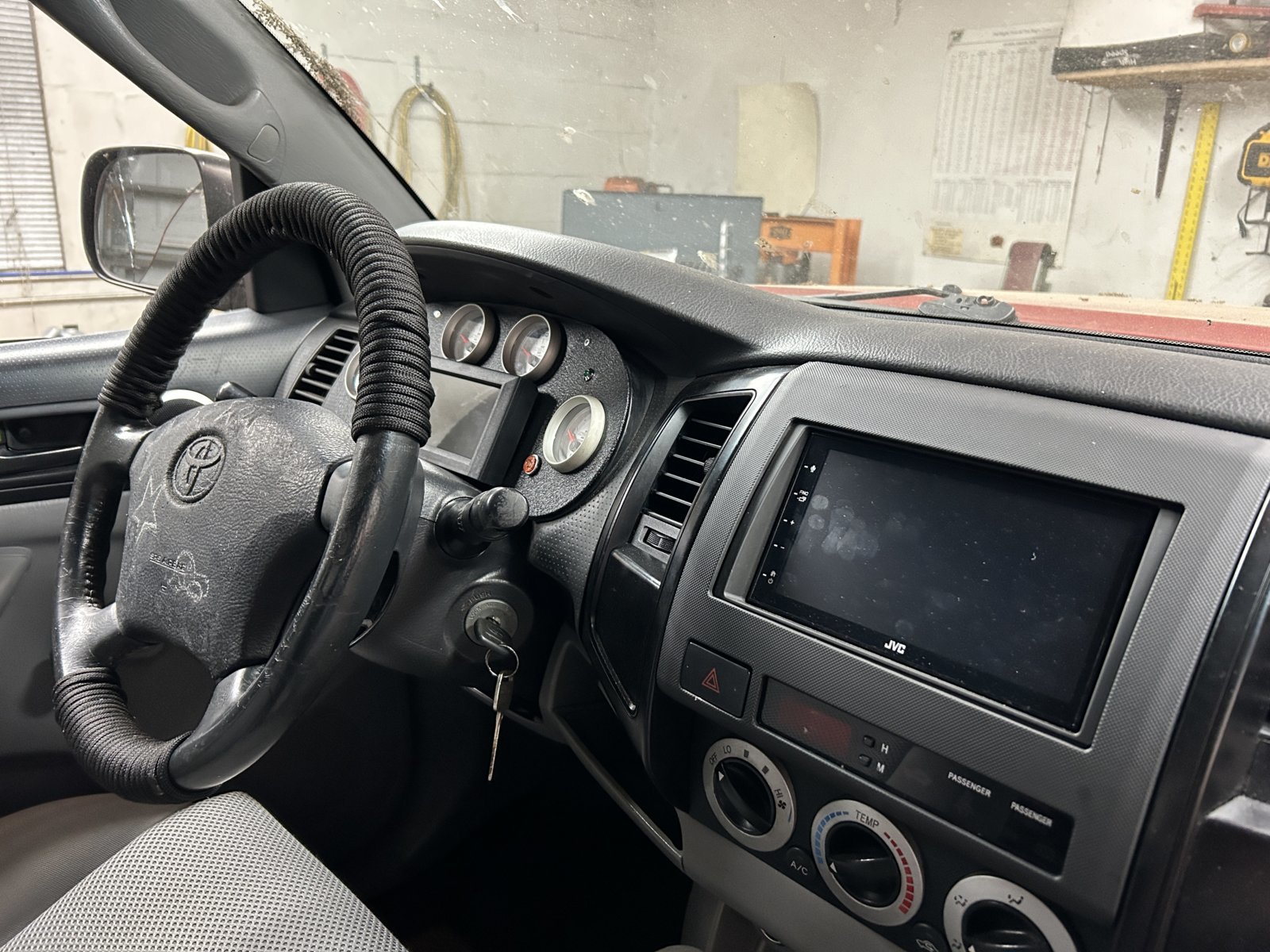

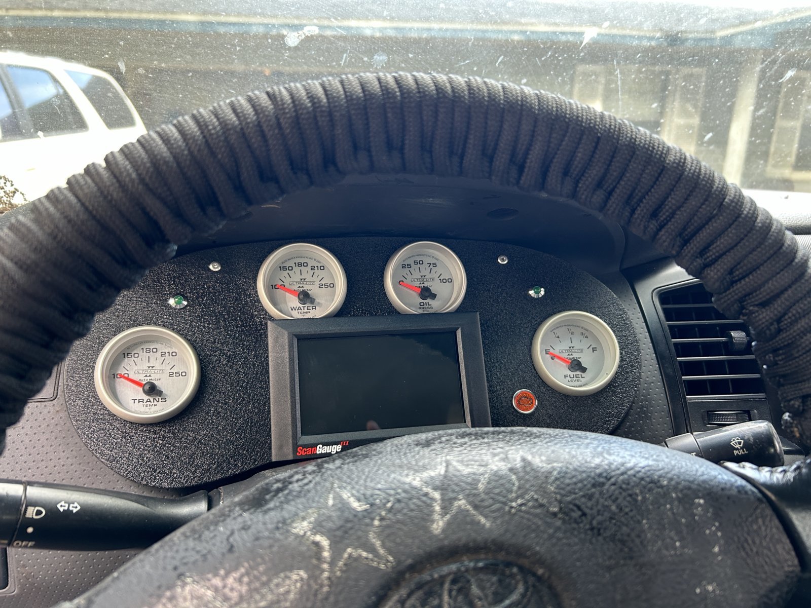

    Vinyl flooring, center console, cluster, gauges, scangauge, and new radio are in. BP harness is 95% installed, just need to hook up the fuel pump wire and bolt down the ecm and tcm. I decided to upgrade the fuel regulator and filter before I even try to crank it so I went with an Aeromotive adjustable regulator and filter. Running new lines for that currently. Transmission is off getting looked at as well....
    New steering wheel is on the list... tried to clean off the bullshit that is on there and now it shows up more lol
