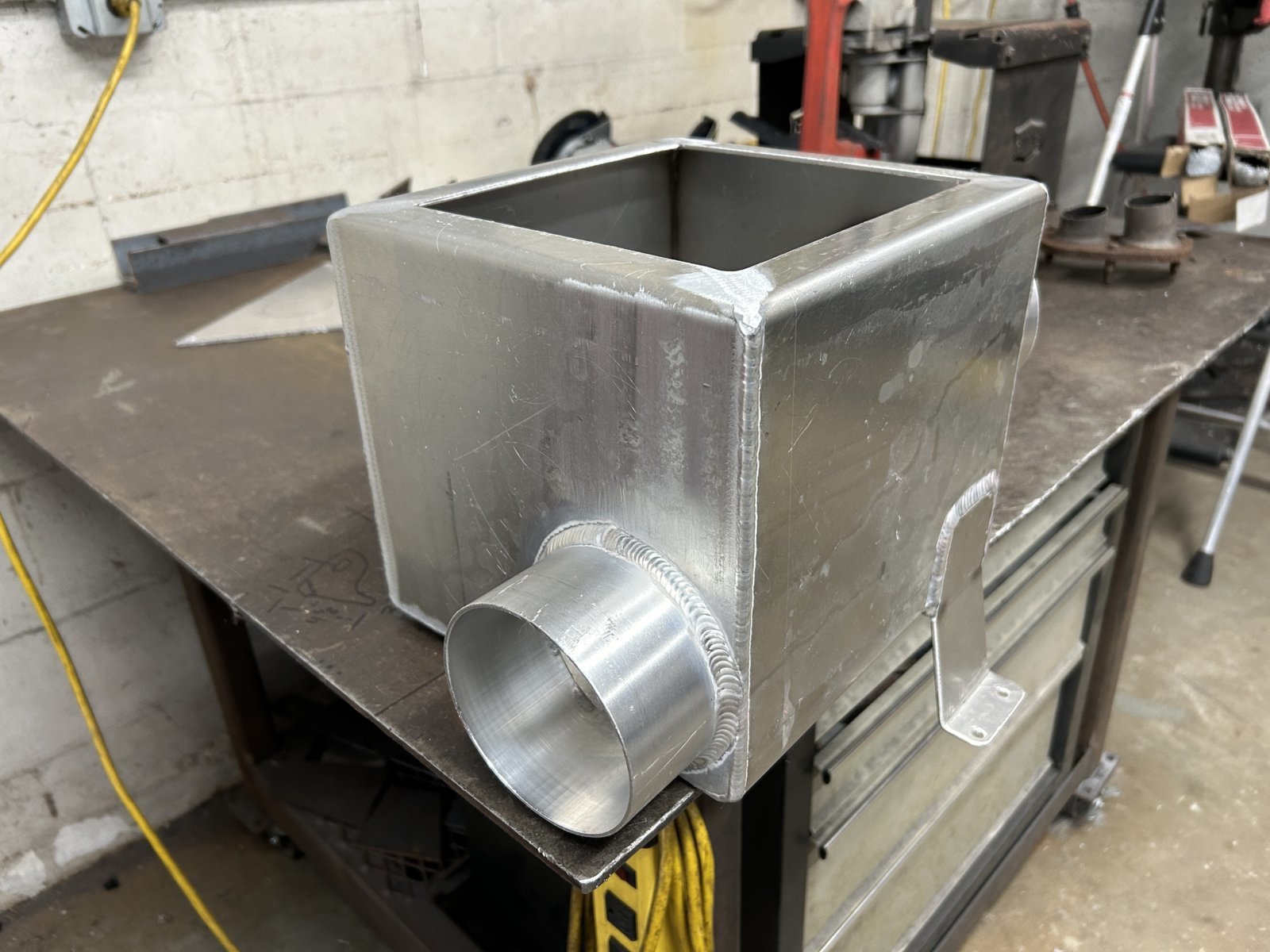

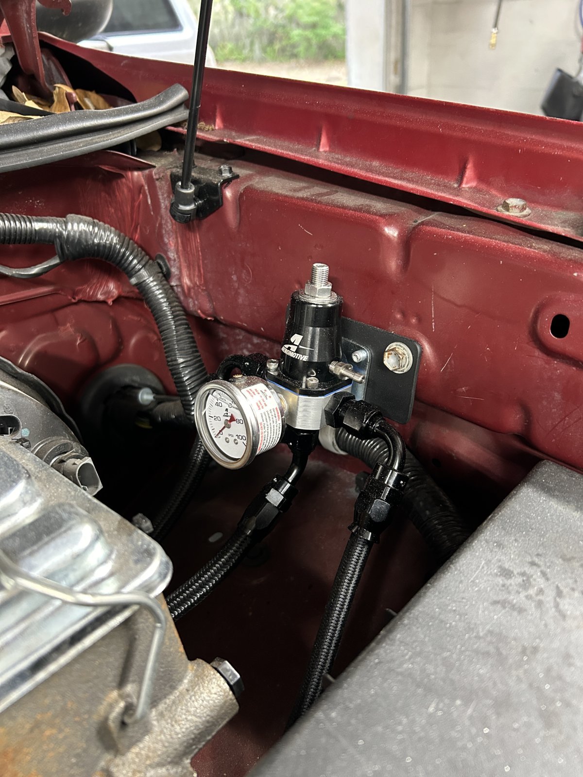

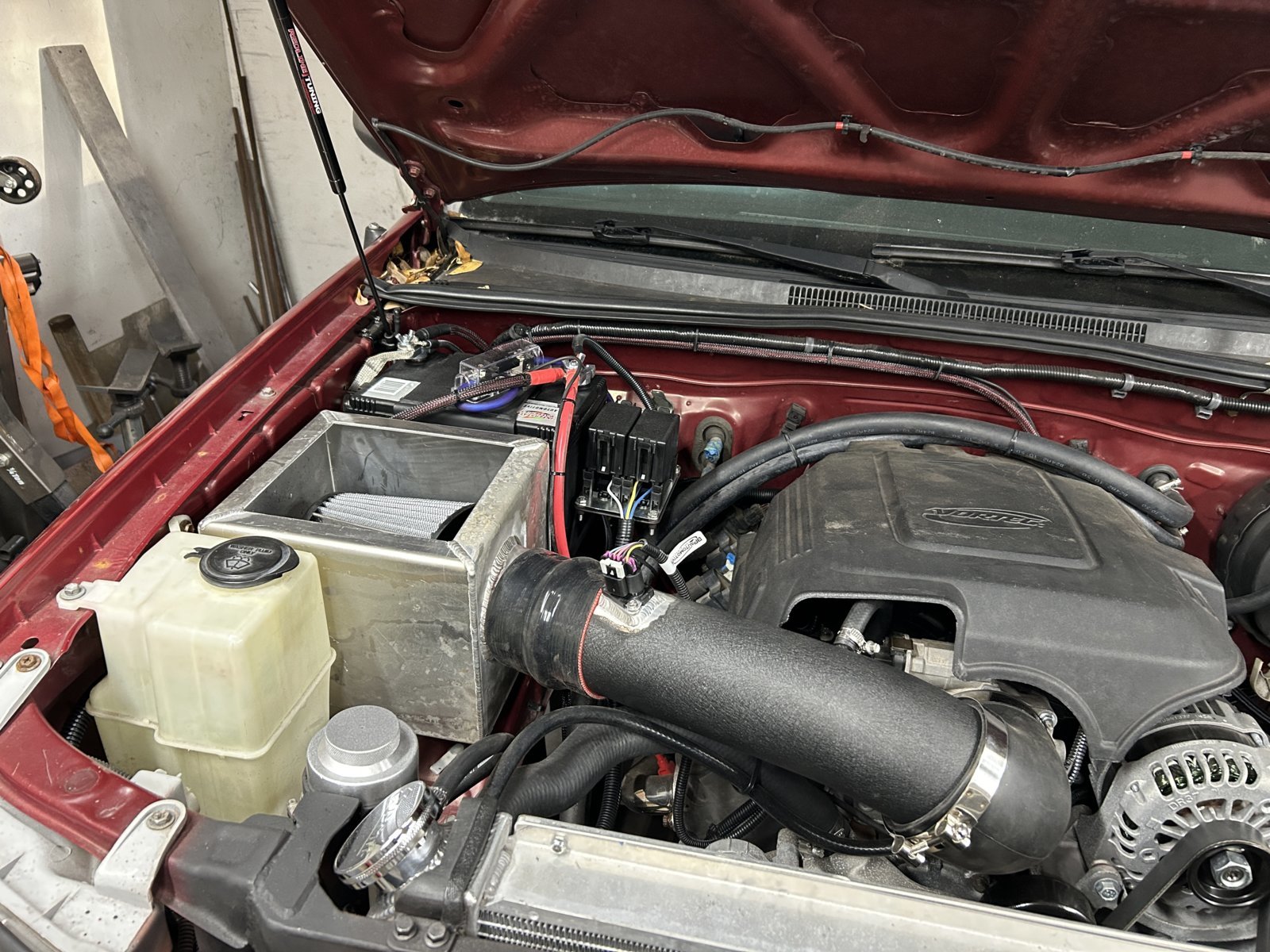

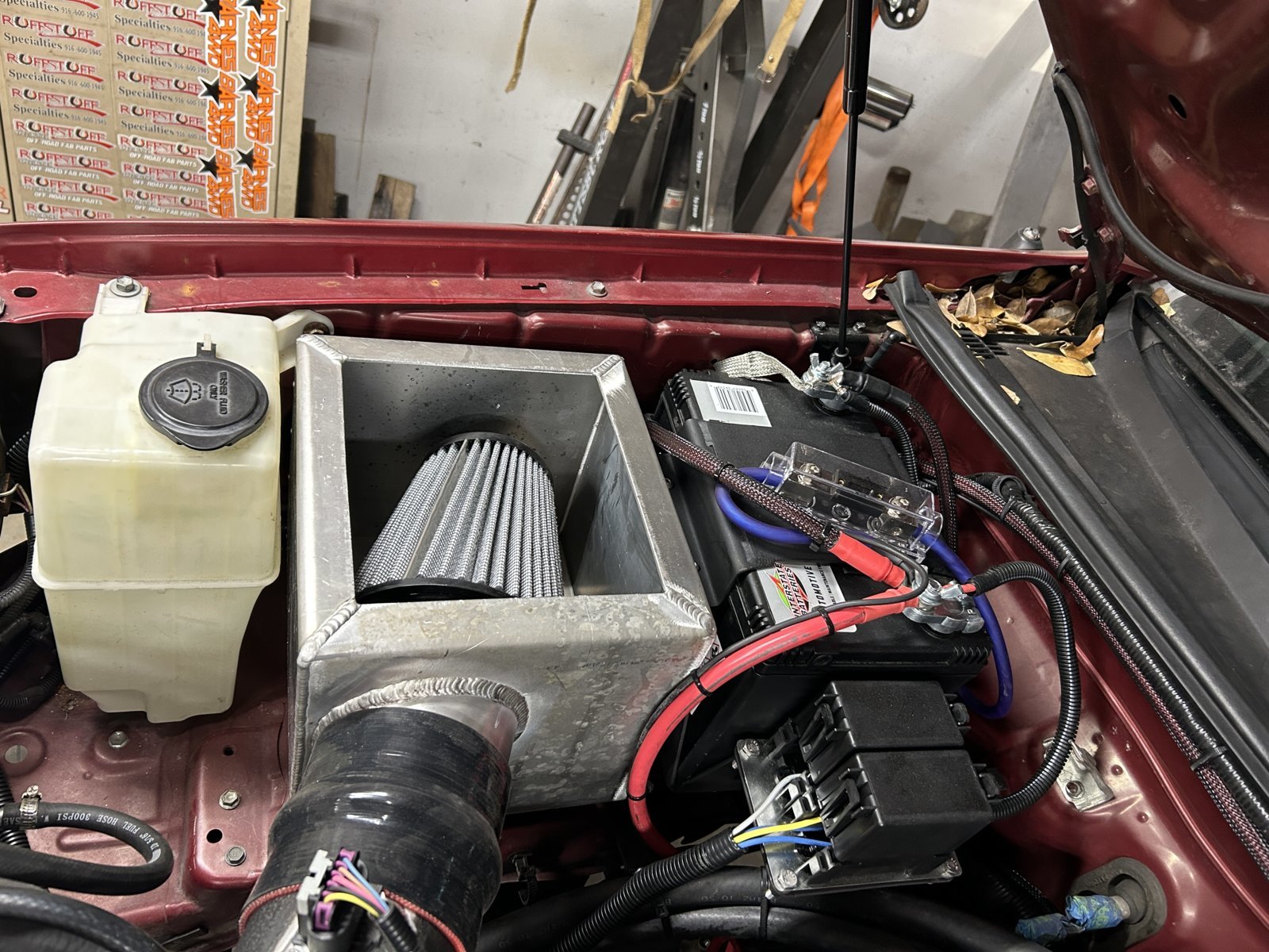

    New fuel regulator, filter, and lines front to back installed. Modified the battery box hold down to fit over the Interstate battery as the box is designed for an Odyssey. I also began building the air filter box with some 1/8" aluminum that was laying around. I am going to do a lexan top with my business logo lasered into it....

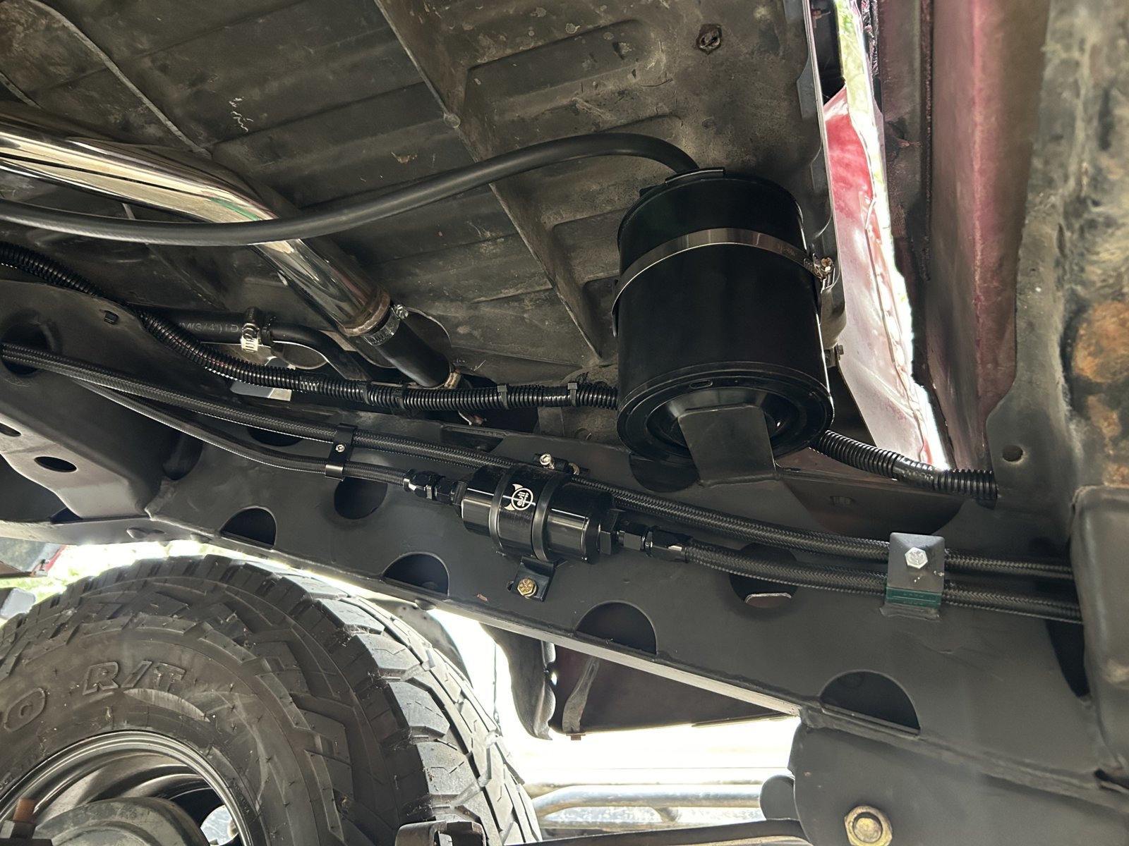

    Got the universal charcoal filter mounted. So car, no fumes coming from that that I can tell. I accidentally ordered rubber lined fuel hoses instead of the PTFE lined ones again so I think I am getting some fuel smells from those lines (garage smells like gas when truck is in it overnight now). I'll just leave it outside for now until I can narrow that down

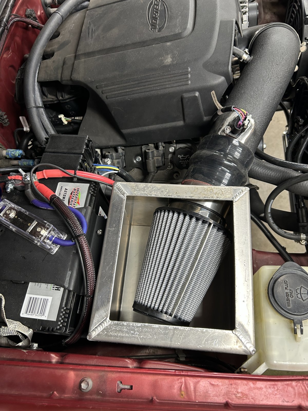

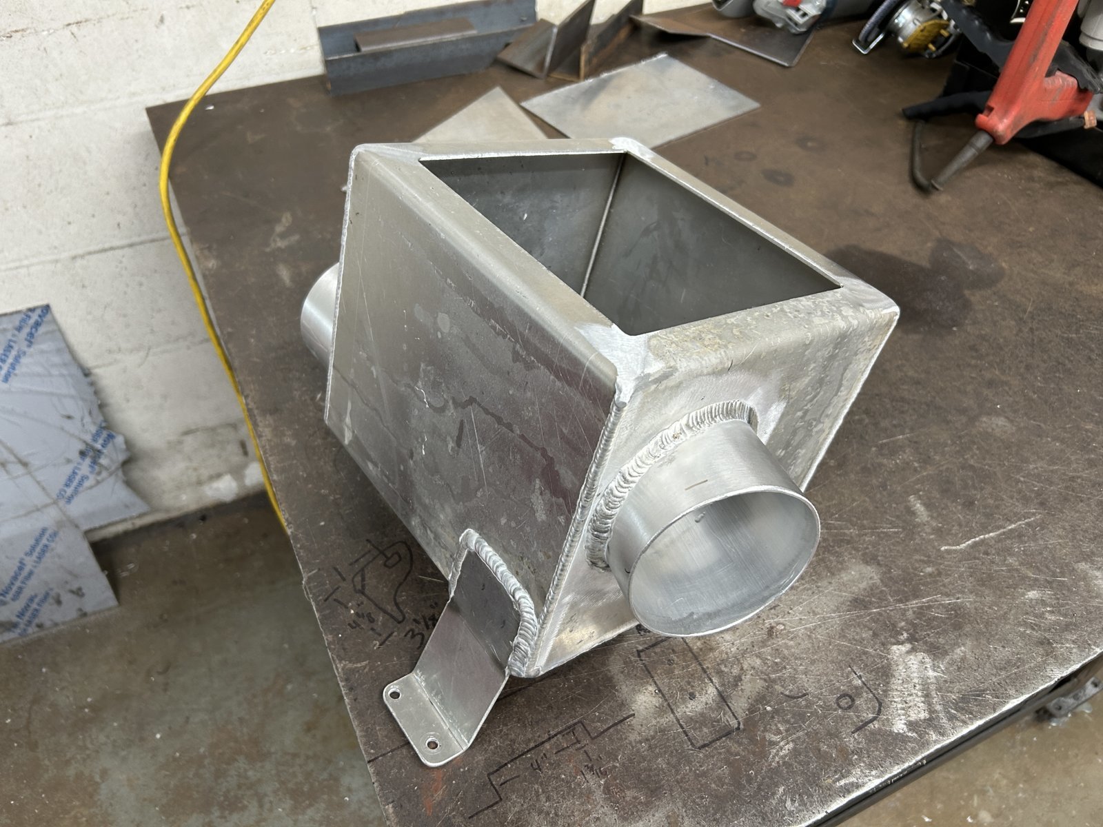

    air box done and ready for powder coating, some hose/wire/cable management done under the truck

    Just an FYI guys they say aluminum is one of the hardest metals to weld.
    Just out of high school I worked for a small aircraft component manufacturer that made air filters for small aircraft. The owner of the company after a few months working there asked if I like to try welding? Sure Mr. Brackett
    His son a friend of mine, we both had welding class in High School together. Scott gave me some pointers and about 6 tungsten tips. I swear I spent more time at the grinding wheel grinding tips than I did sitting at the bench trying to weld.
