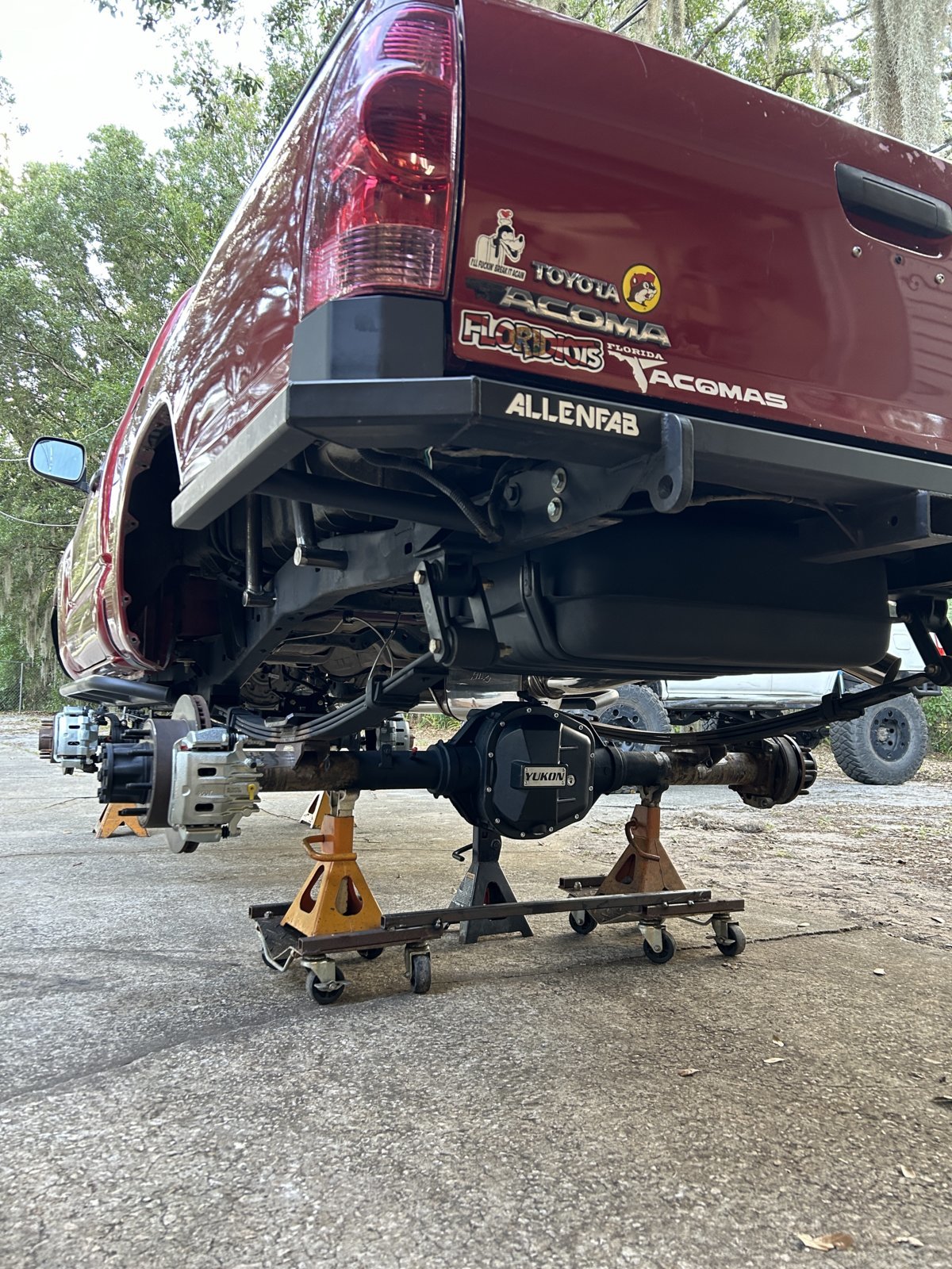

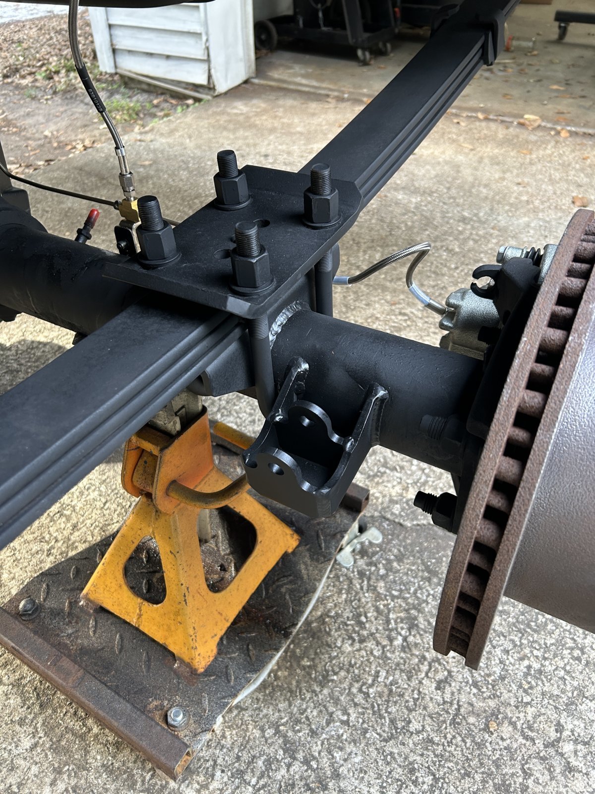

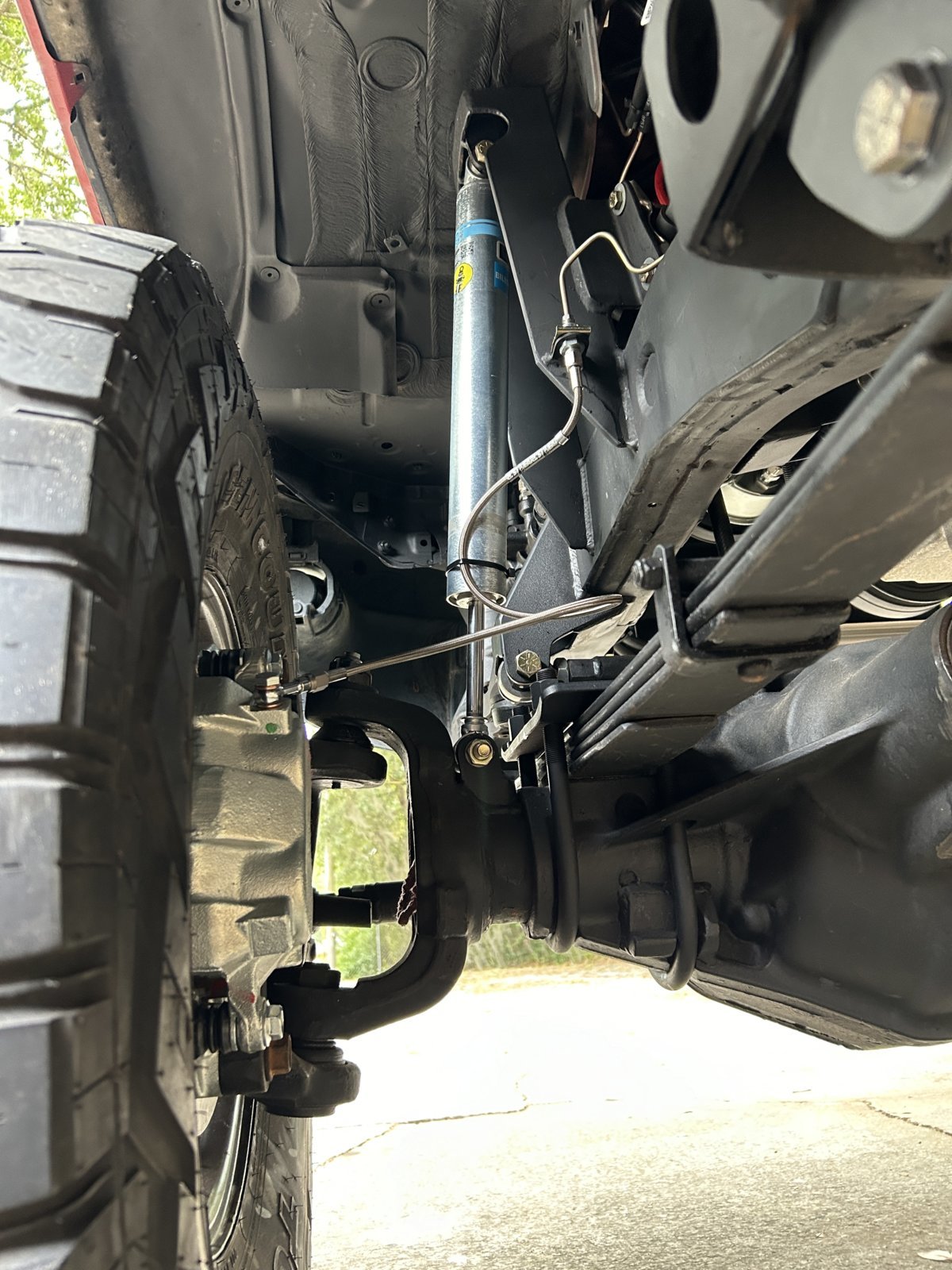

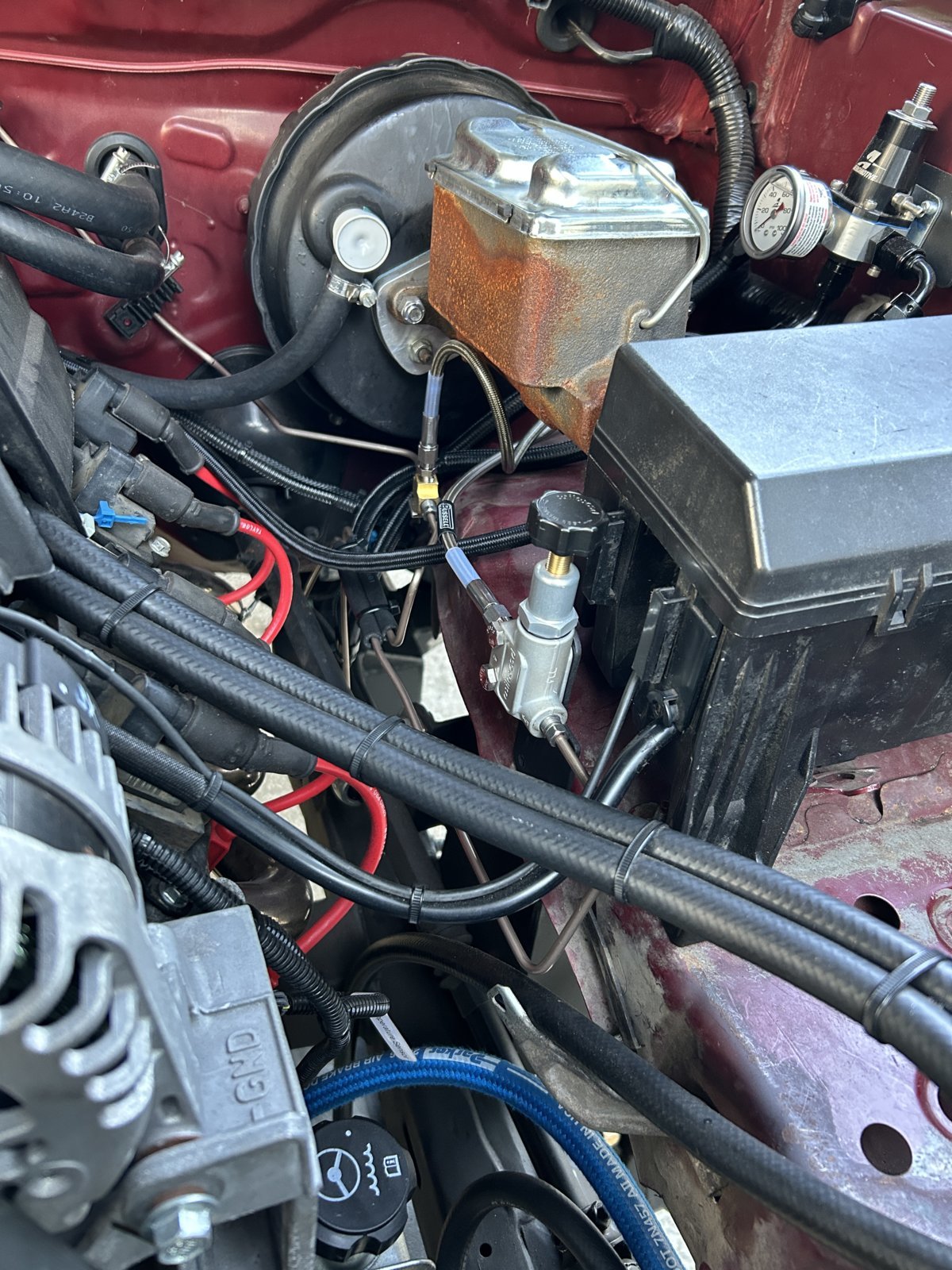

    Transmission shop is going to get a visit tomorrow. One month to do what they said was a "one week job" and over two weeks since they said they would have my converter "next day".
    Meanwhile, all brake lines are done, 4.56 gears and Grizzley locker installed in rear, and 3 of 4 calipers installed. Had to redo the rear shock setup because the first try was too close to the tires for my liking.

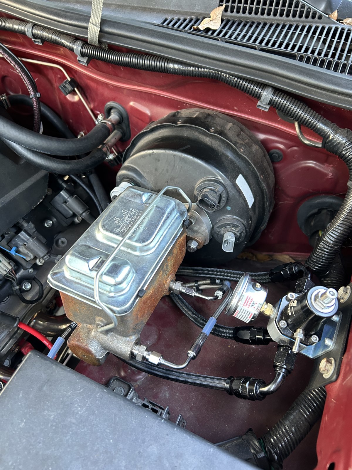

    Tundra booster with what MC? Custom adapter?
  12. Apr 25, 2024 at 6:56 PM
    #312
    allenfab
    allenfab [OP] I hate everything
    Oct 23, 2014
    #140913
    2,650
    Todd
    Lakeland, FL
    08 5-lug on one tons
    Yup, with a GM 1-5/16” booster. Got the adapter from Trail Toys. I’d have to look again to see what trucks that master came in. 80s/90s 3500 truck I think

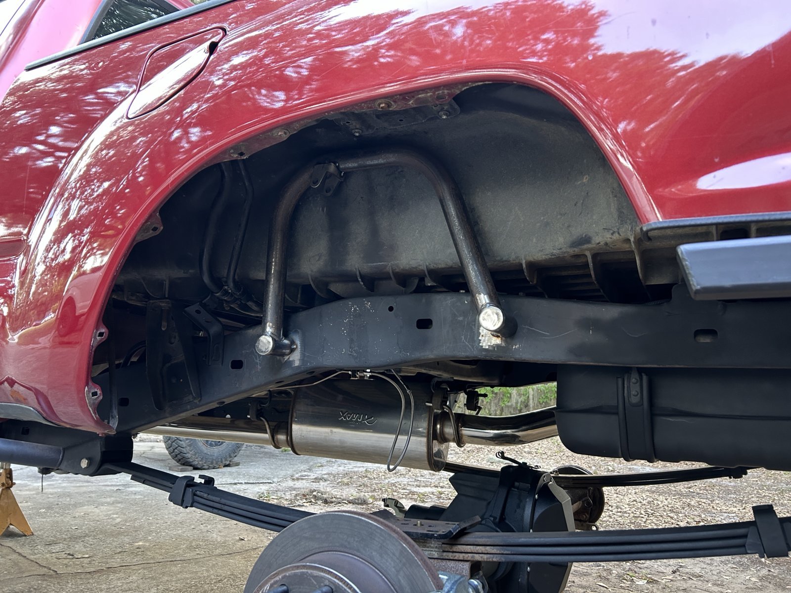

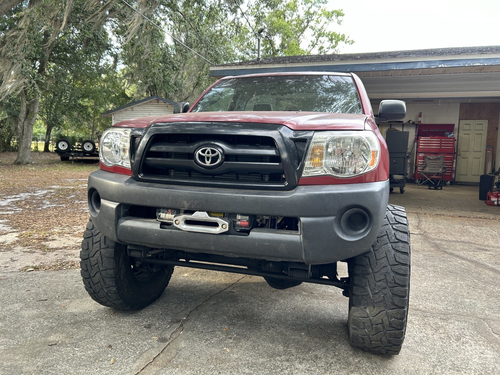

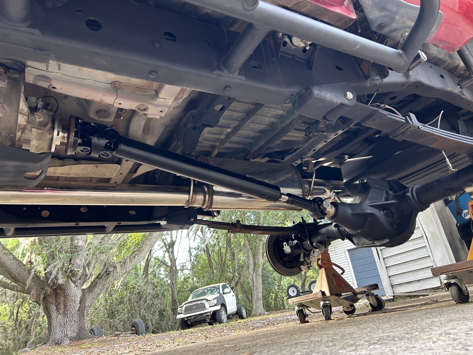

    Trans got new 3/4 clutches and seals, and it's getting a new pan tomorrow with a temp sensor bung that I already welded in. Trans lines made, shifter hooked up, exhaust and driveshaft are in. The brake tee on the rear axle leaked when I was bleeding the brakes, so I replaced it with an extra one I had and it leaked just as bad, so I ordered a few more to try and get that fixed. Also had to order a different trans dipstick. This thing will be moveable next weekend
    Rear pinion angle set and perches welded in along with lower shock mounts
    Front calipers and brake lines in. Front end gears/shafts will be done later...
    New Ebay grill
