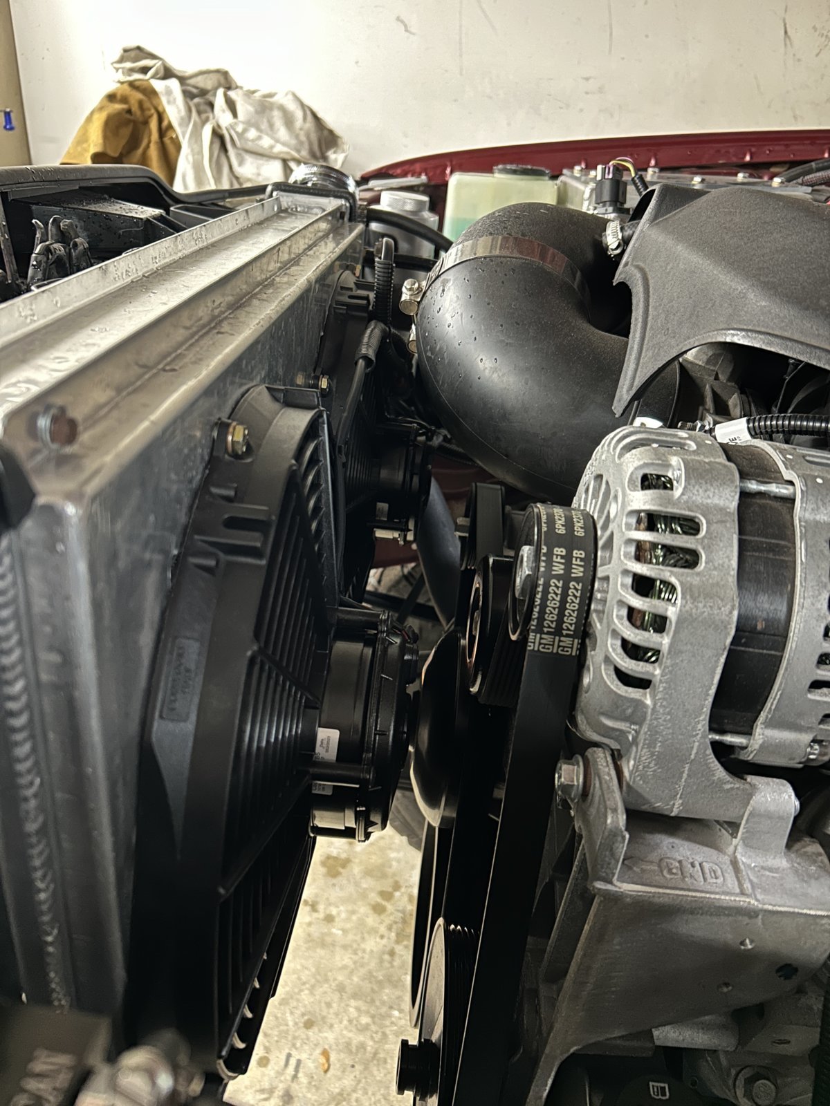

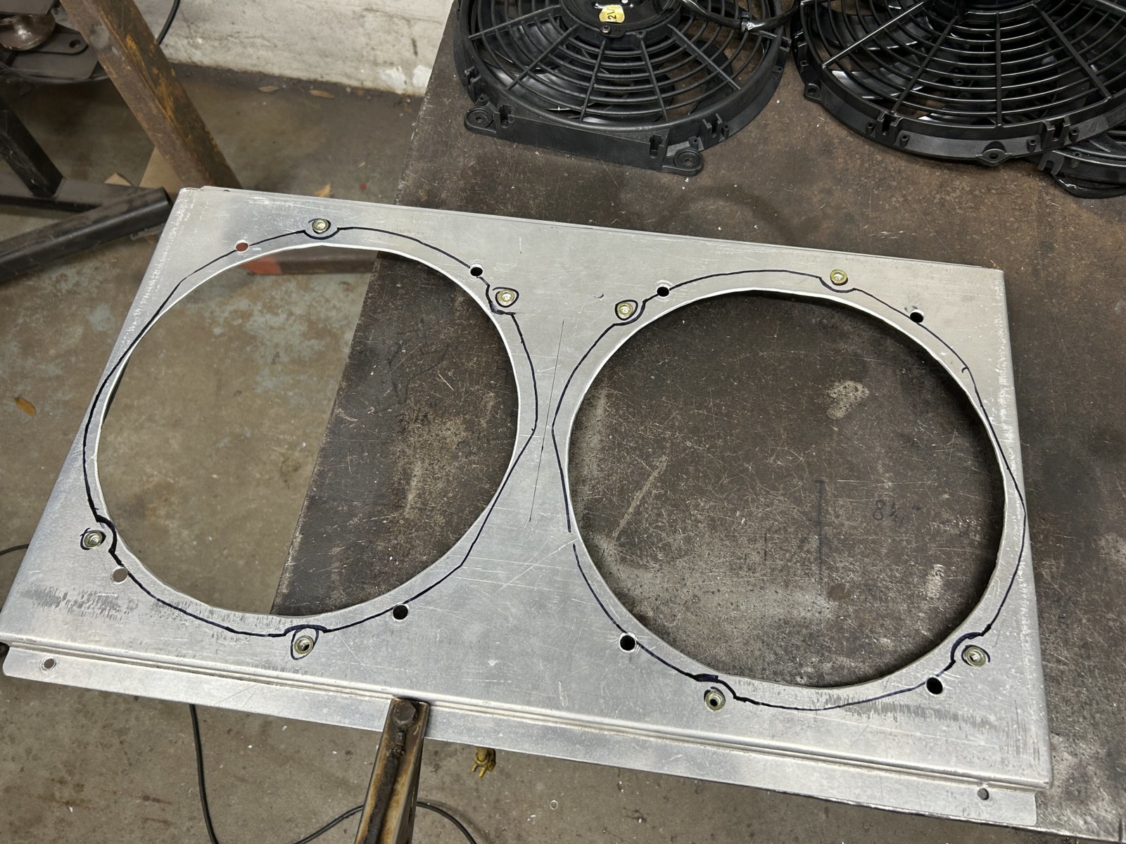

    I started reading more into cooling fans and started questioning my setup after seeing temps get as high as 226* while at a long red light on a pretty hot day. My original fans were 12" Summit Racing fans rated at around 727 CFM at around 7.7 amps each and it turns out that they are actually 11" fans. So, I went with two 12" SPAL's that pull 1451 cfm and 14.5 amps each, so doubling the amps and doubling the CFM.
    The fans kick on low speed around 203* and high speed at 217*. After a quick test drive, the temp never got above 216* and usually stayed around 199-210 when cruising.
    Trimming of the shroud showing how much smaller the old fans were

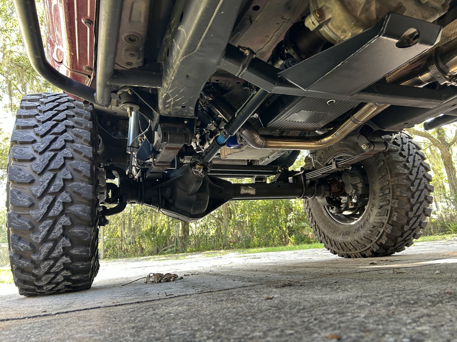

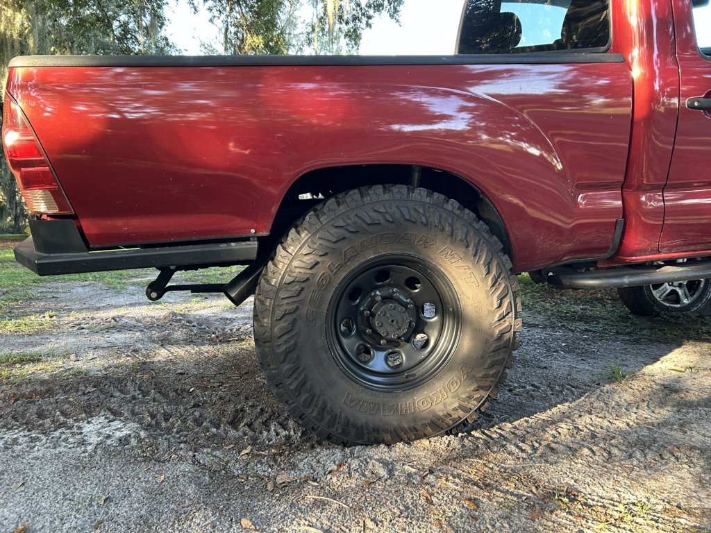

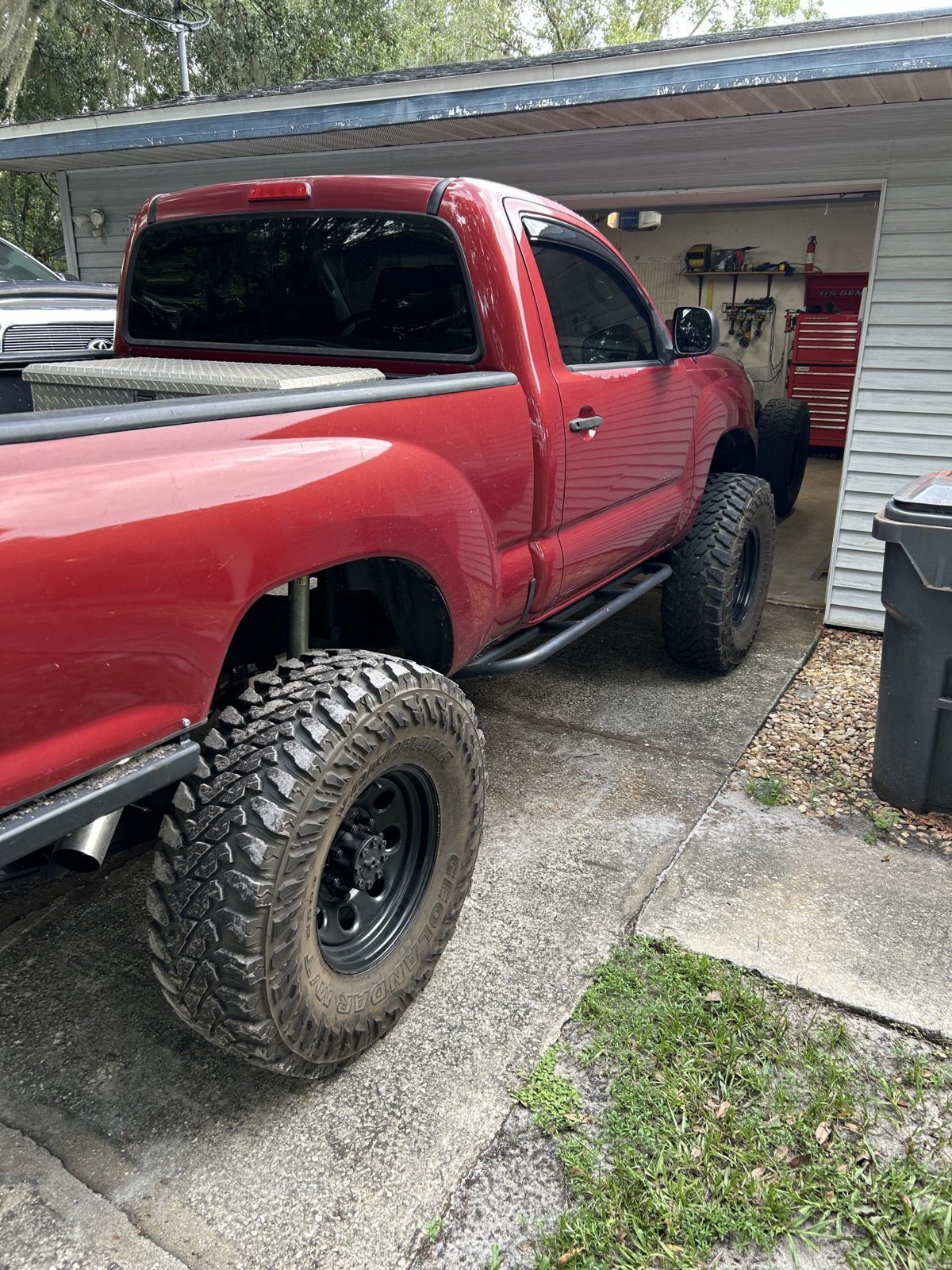

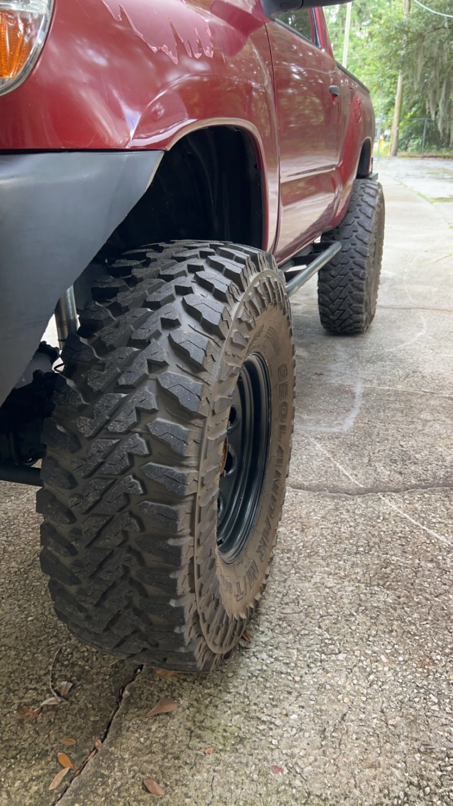

    New (used) tires. Geolander G003’s 37x12.50. Even got a brand new spare in the deal

    this thing is DONE!!!
    Grizzly locker and 4.56 gears installed in the front and everything is now buttoned up.
    The Mishimoto thermostat that I had installed failed to open out of nowhere while just idling in my driveway while I wasn't paying much attention. I reluctantly installed that piece of shit at my tuner's request and it almost cost me an engine (he wanted a lower temp activated stat). Luckily the scangauge alarmed me and let me know what was happening. Hard for me to believe that Mishimoto is still even in business with how dogshit all of their products are. Ok I'm done ranting....

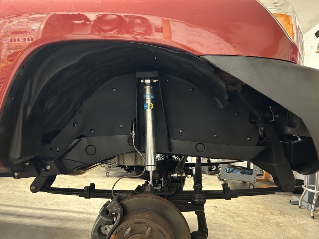

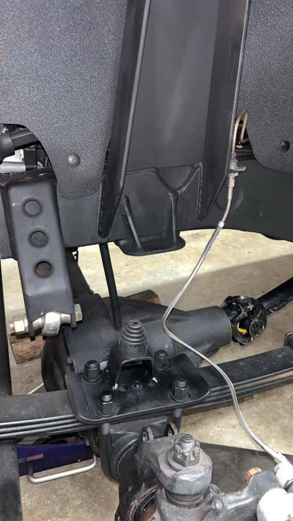

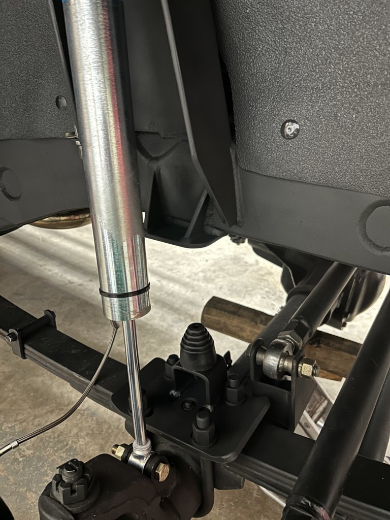

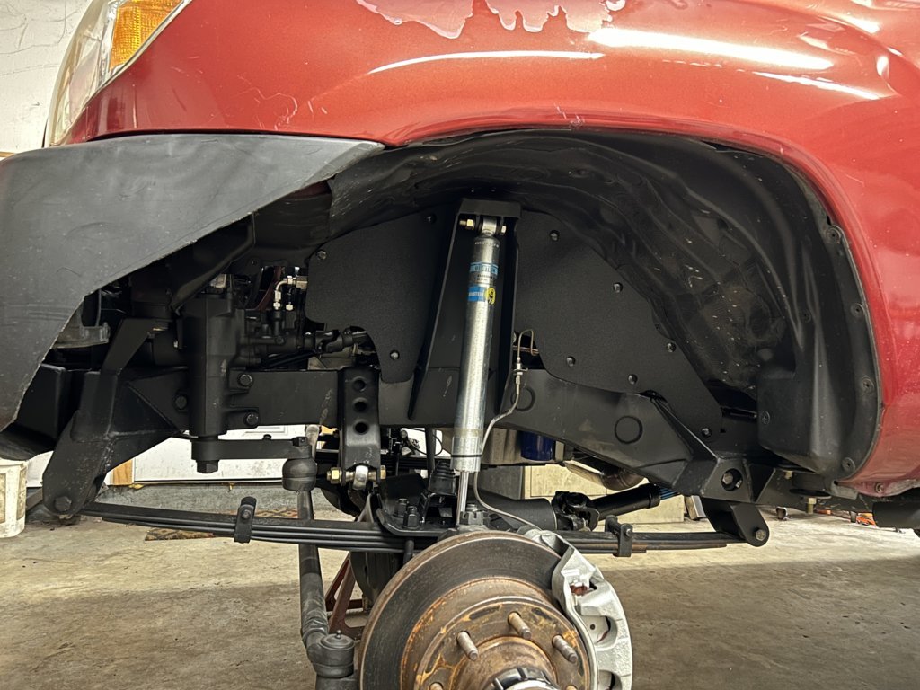

    Gap guards done and front bumps welded in on the leaf spring plates. Landing pads for the bottom of the frame are in the works along with getting the rear bump mounts built

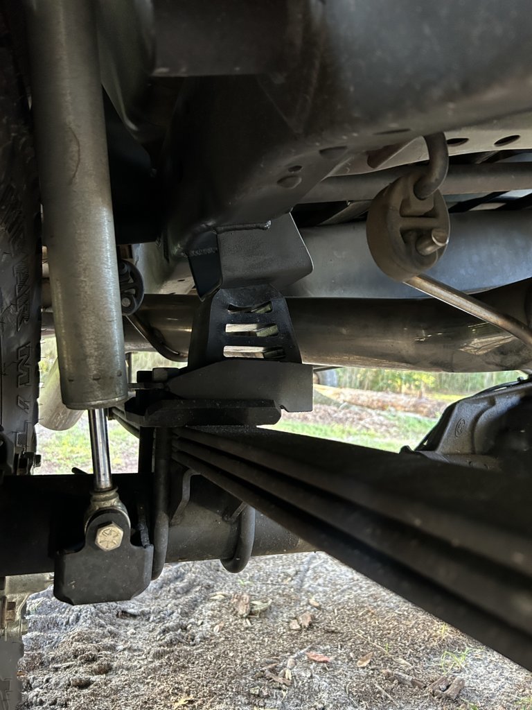

    Did the first oil change over the last couple of weeks and finished the landing pads for the front bump stops. Rears have been started and should be done by the weekend... then maybe wheeling?

    I will say the only thing bad is if the stops are Polly they are almost as hard as a rock!
    Sorry but if you think you might hit the stops from time to time *I* would look for a long rubber stop.
    Foam stops might work there’s hundreds of styles out there with different firmness. Just a suggestion and a couple examples below. But it’s really none of my damn business…

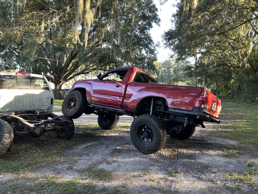

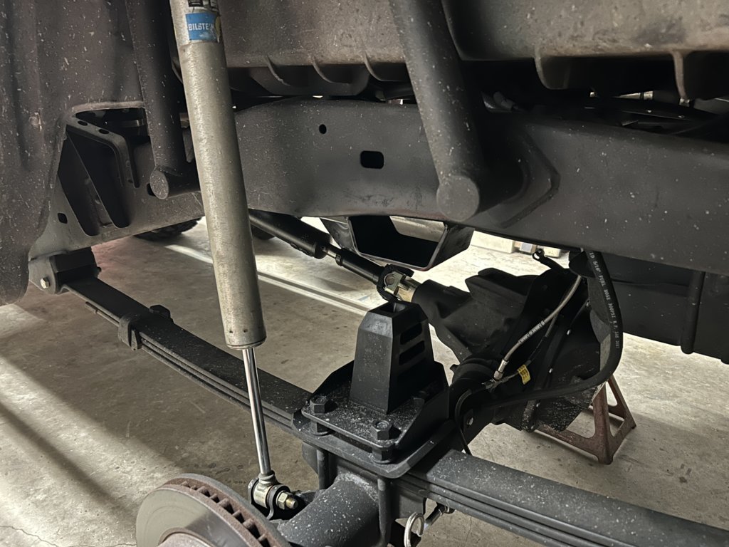

    Rear bumps done. Wheeling pics coming soon
