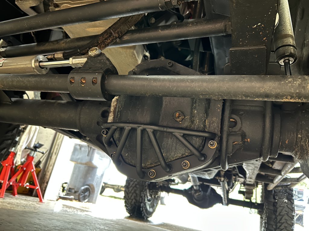

    I like that diff cover. It's different for sure.

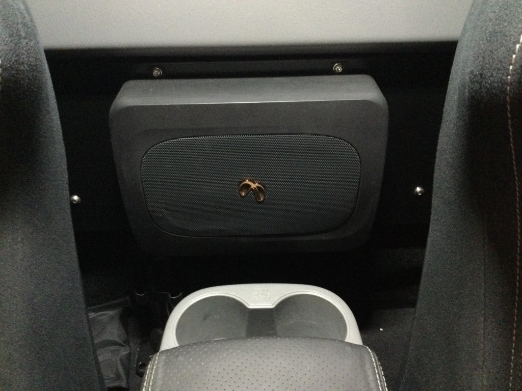

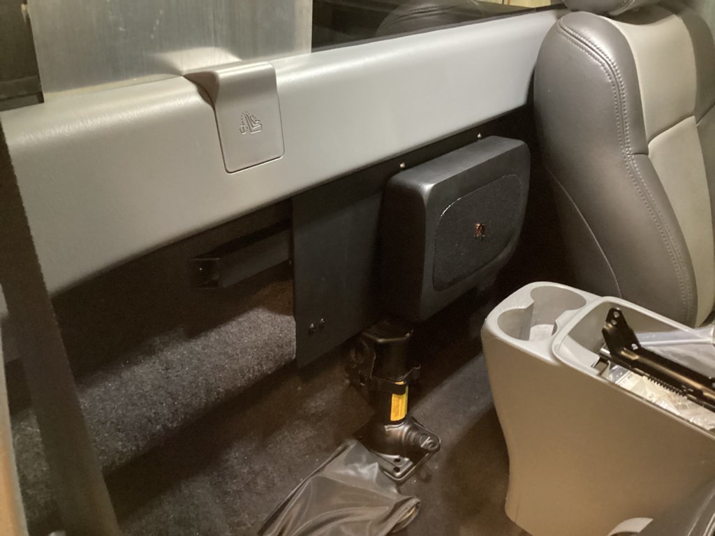

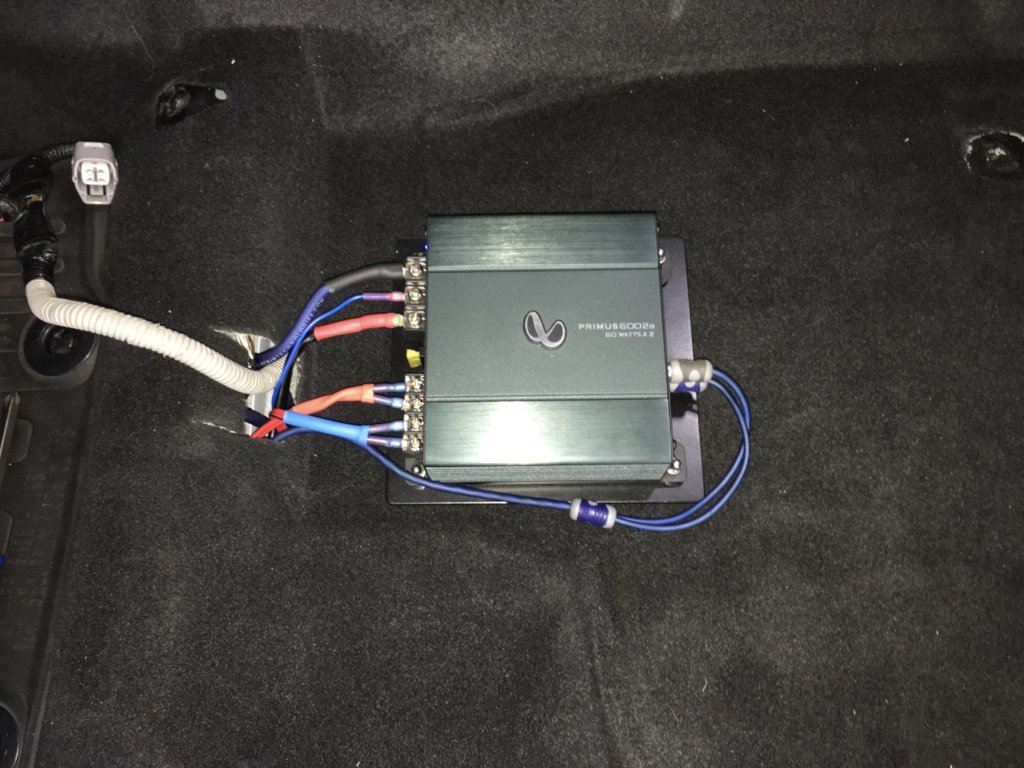

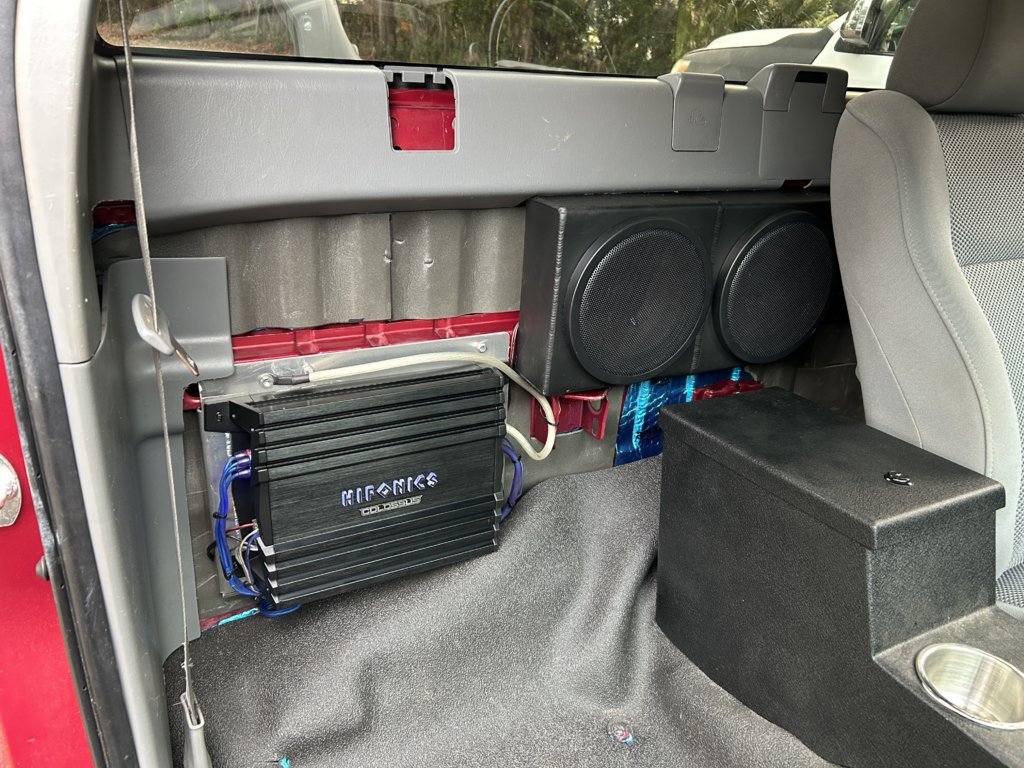

    As for the tunes I did something similar.
    Mounted a self powered Infinity 8” sub on the back of the cab using some of the factory 6 mm bolt locations and added a few riv nuts. Had a friend weld a piece of 6061 1 x 2 x 24” to a piece of I think .190 6061 aluminum, then had it powder coated. Added sound mat and glued the crap out of a piece of carpet to the back of the cab and bolted it down. A member here found a set of WAY OVER PRICED 6.5” carbon fiber door speakers with soft dome tweets for 1/2 price but I still paid over $350 for the door speakers, it sounds incredible with just an 60w Infinity amp running the door speakers. He also wired and turned the whole system.
    IMG_1020.jpg IMG_3264.jpg The Amp is mounted to a small piece of aluminum then velcro to the carpet

    Can't say that I've seen diff armor like that. Very cool.
