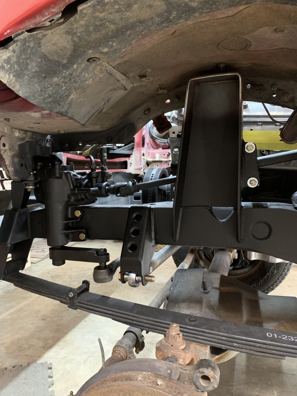

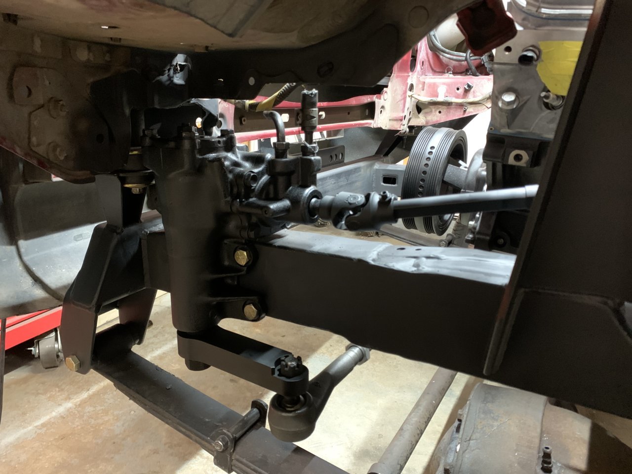

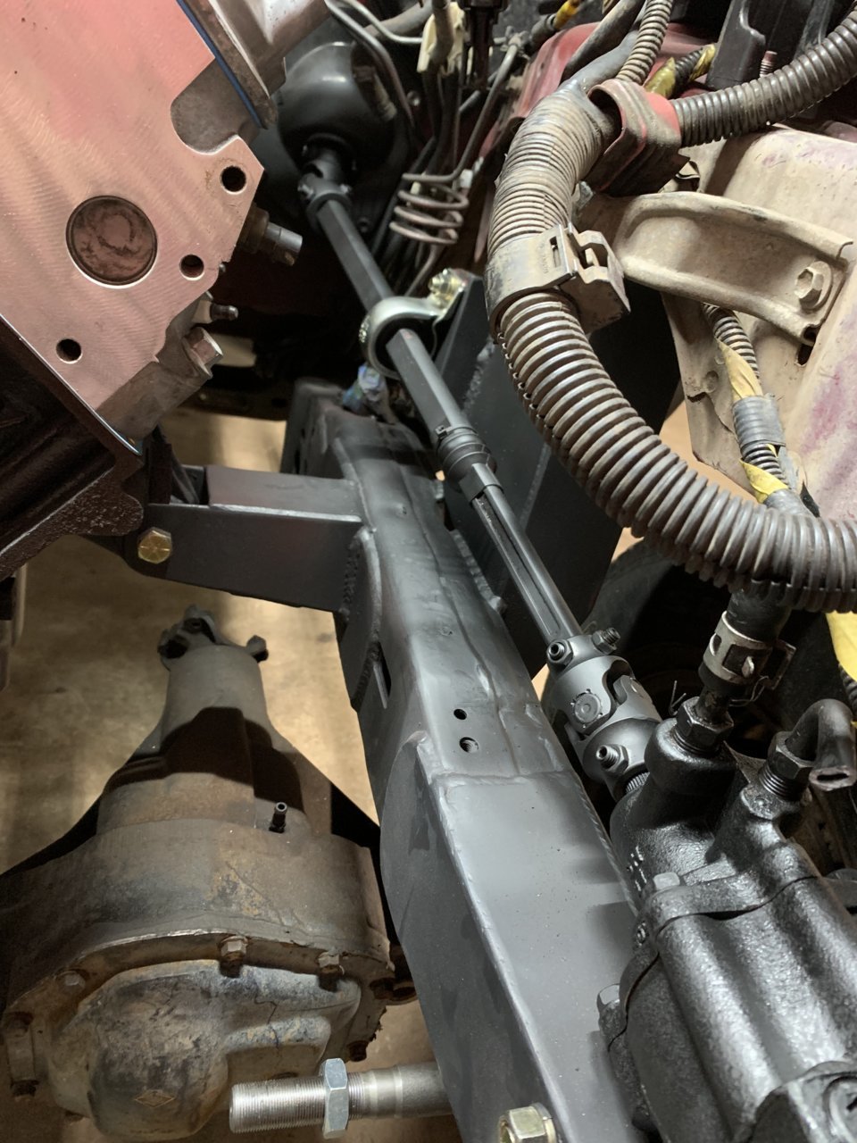

    Steering from firewall to frame is done. Took me three tries to get the steering box back together after the drilling/tapping and rebuild because I’m a jackass but I’ll save that story.
    got some DOM and other steering stuff coming so that’s what’s up next

    Are those axles out of a 99-04 Super Duty? I'll be following the build, as I am starting to gather parts for a similar swap on my 07 regular cab. After seeing yours, I thunk I'll take the KISS principle and go leaf sprung on the front.

    Yup, 99-04’s. Good axles that are cheap. Only drawback is that leaf spring perch width, makes the shackle mounts a bitch

    Are they a PITA as far as mounting the springs to the frame, or? I'm guessing the center section is in the way for moving the perches around to the width you need?

    Maybe some of both. I actually don't mind the perch width as it adds some stability to the truck. But the width makes the shackle mounting points right where the frame is still wide as fuck, so if you really want to use shackles and want a low ride height you're going to have to french them into the frame, there is no other way around it.

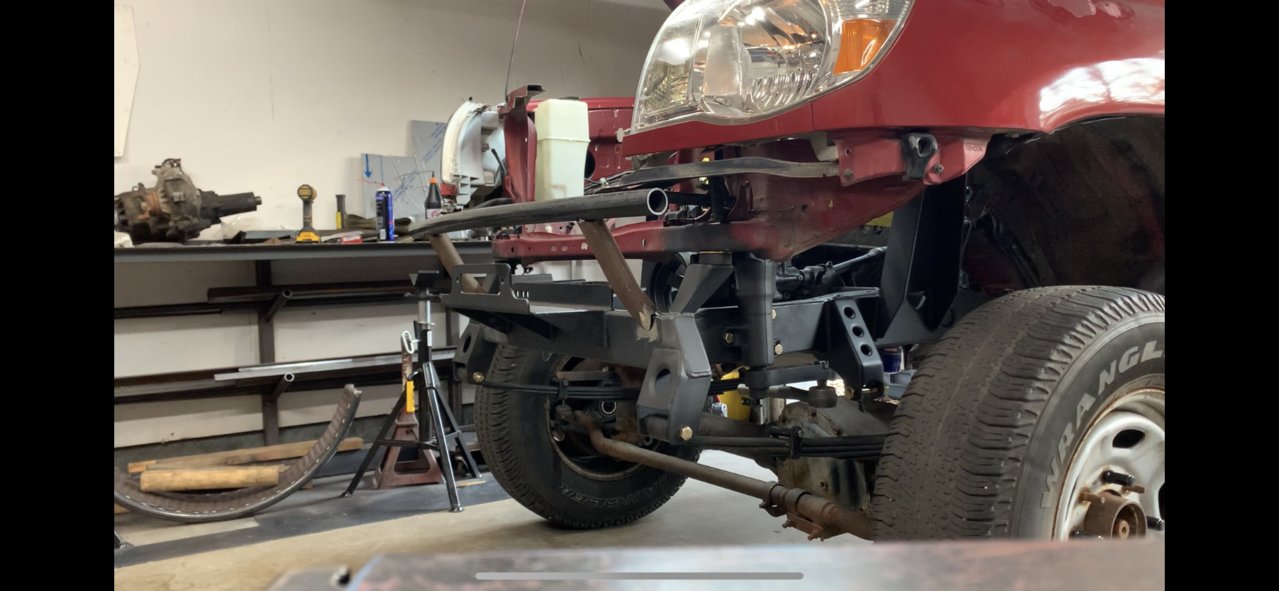

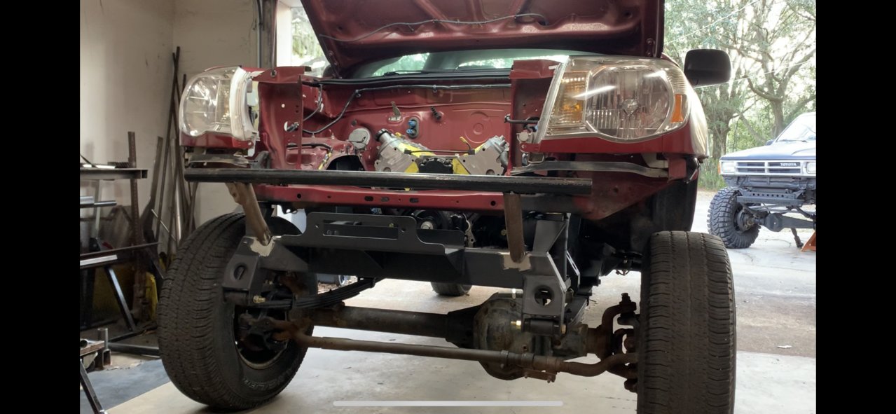

    Frame side panhard bracket welded up. I built it a while ago but had to modify it to raise it up a little higher. The panhard bar itself is also welded and painted, but waiting to do the axle side mount until I do the steering links which may get done this week..

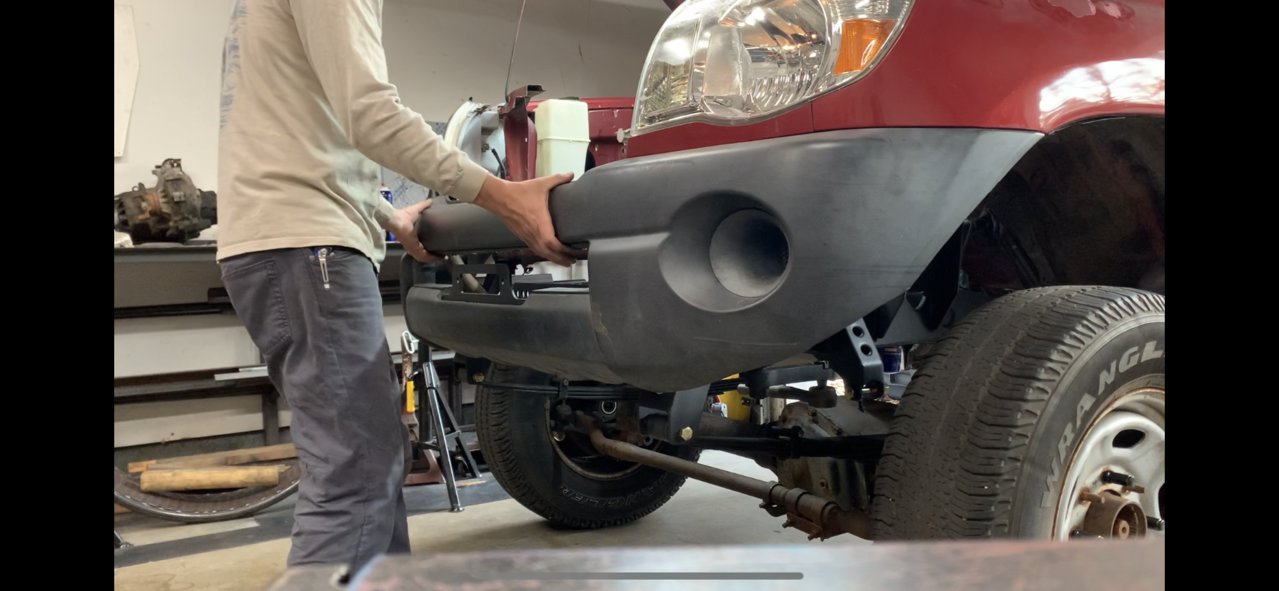

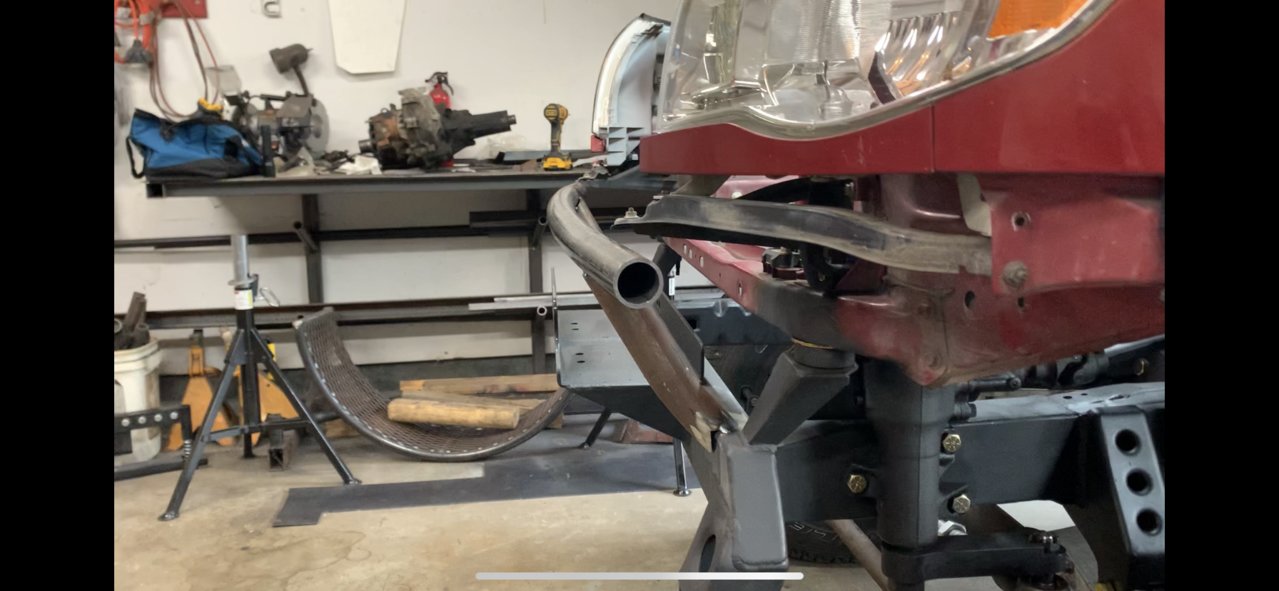

    While waiting on the rest of my steering parts, I started to mess around with a front bumper. I still really want to keep the factory bumper on most of the time but am going to build a tube bumper that the factory bumper will slide over and secure with a couple of screws. The challenge will be getting it to look good but I think I can do it.

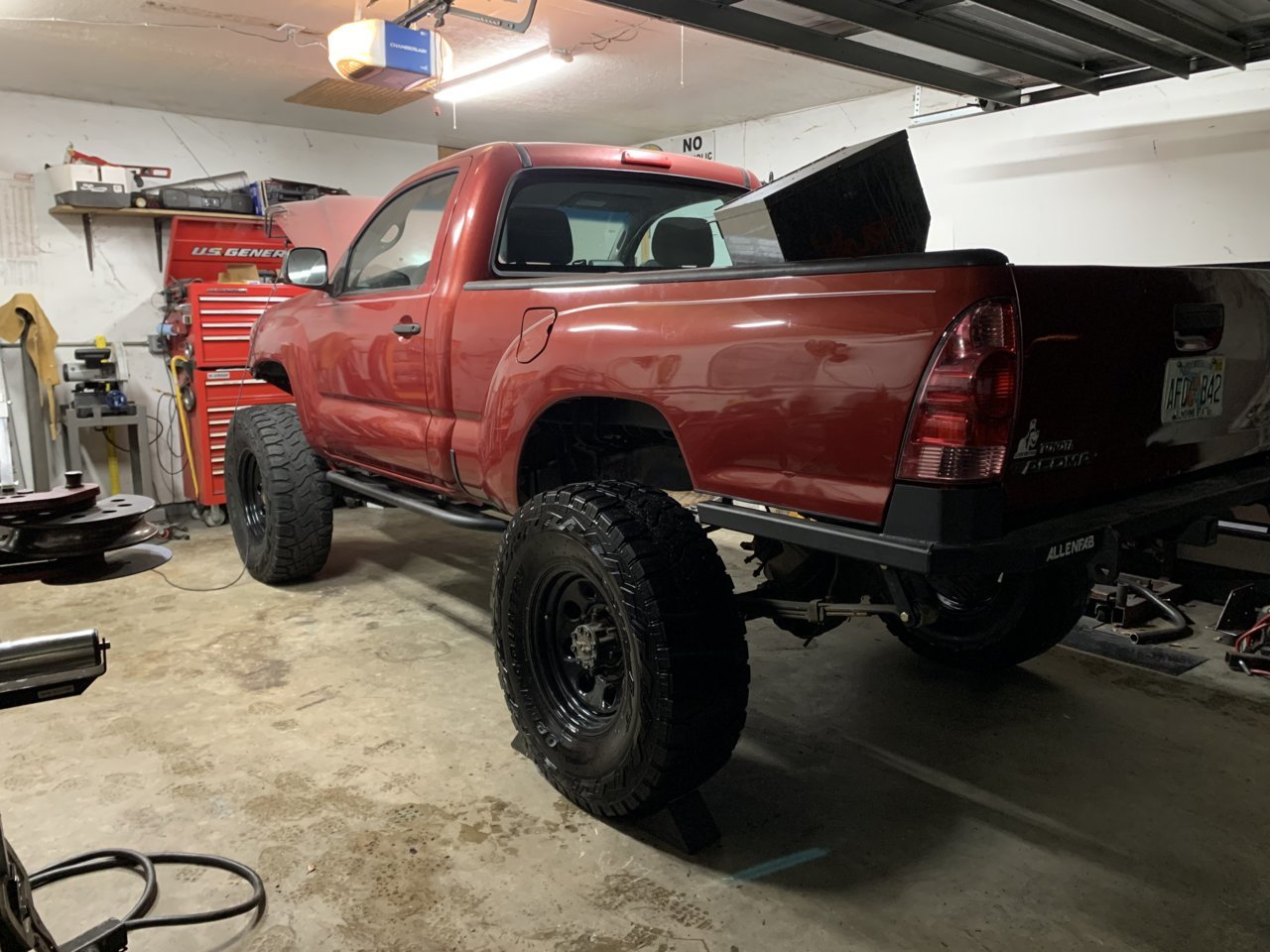

    22.5” frame height on 37s

    Finally got to read your build thread. Looking great!
    Still remember the previous one, the white reg cab, with nostalgia :D. Man, that was such a crazy bad ass build!
    22.5" frame height on 37"s is amazing.
    Curious, why not links and coilovers on this one? Was that part of the idea of wanting to keep things simple and low(er) cost?
    Always enjoy seeing the stuff you build. Very creative and well executed :thumbsup:
