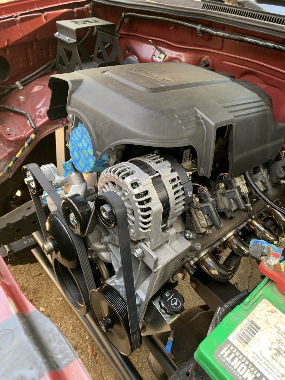

    Current spending spree has ended. Going to work on some other things for the next bit until extra money comes back around, but I bought a ton of stuff to get the motor closer to being done. New 145 amp alternator, steering pump and pulley, salvage yard fuel rail and injectors, and salvage yard Vortec engine cover (my favorite piece cause I am a weirdo), and AC Delco belt all installed over the last couple of weeks. All sensors have been GM genuine or AC Delco to keep everyone happy.
    Got the core support TIG'd back in so I can start to figure out radiator stuff. Threw the a/c condenser back in to get an idea of what I had to work with and it looks like I am limited to about a 32"x 16"-18" radiator. Summit has one that I think will work. I also think that I will have to run dual fans instead of one big ass electric one like I had hoped. The tit that hangs off the front of the water pump for the stock fan sticks out further than I want it to so it makes the fan situation happen. Gotta get a radiator sooner than later....

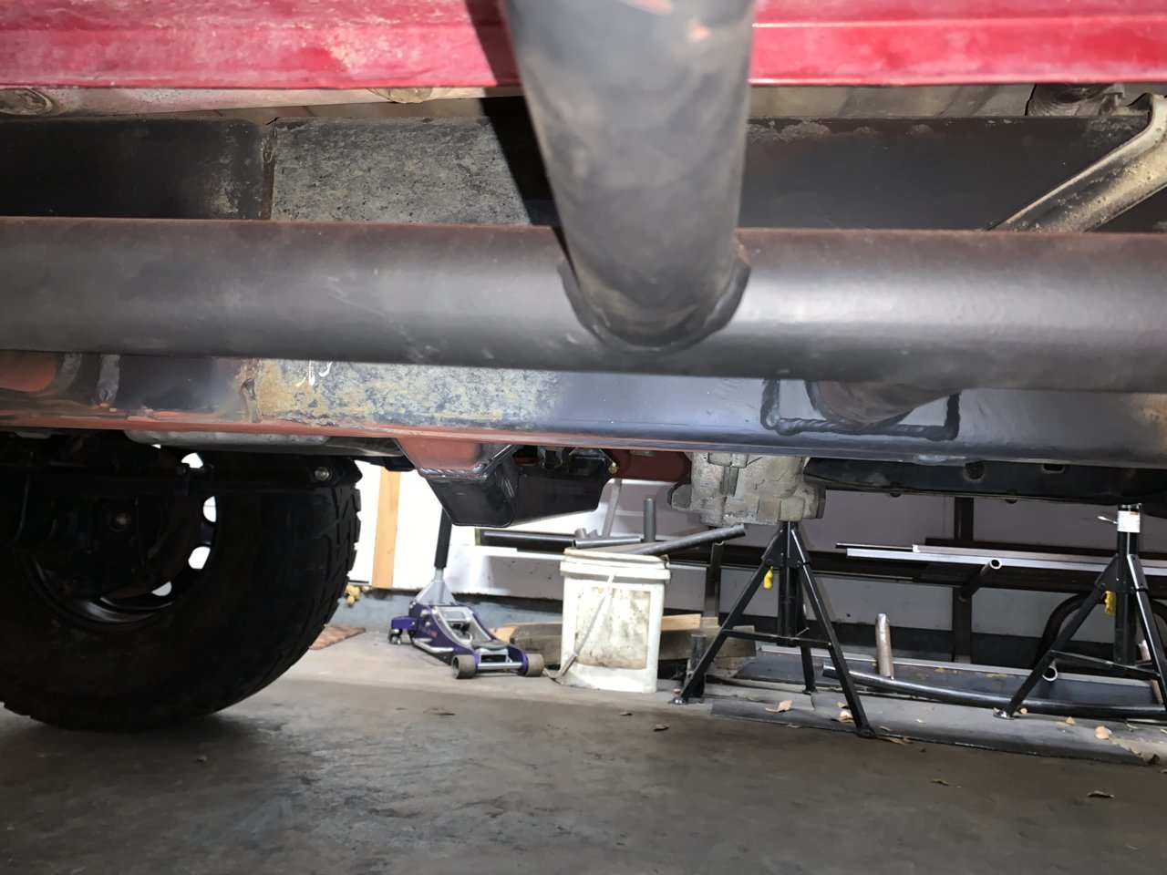

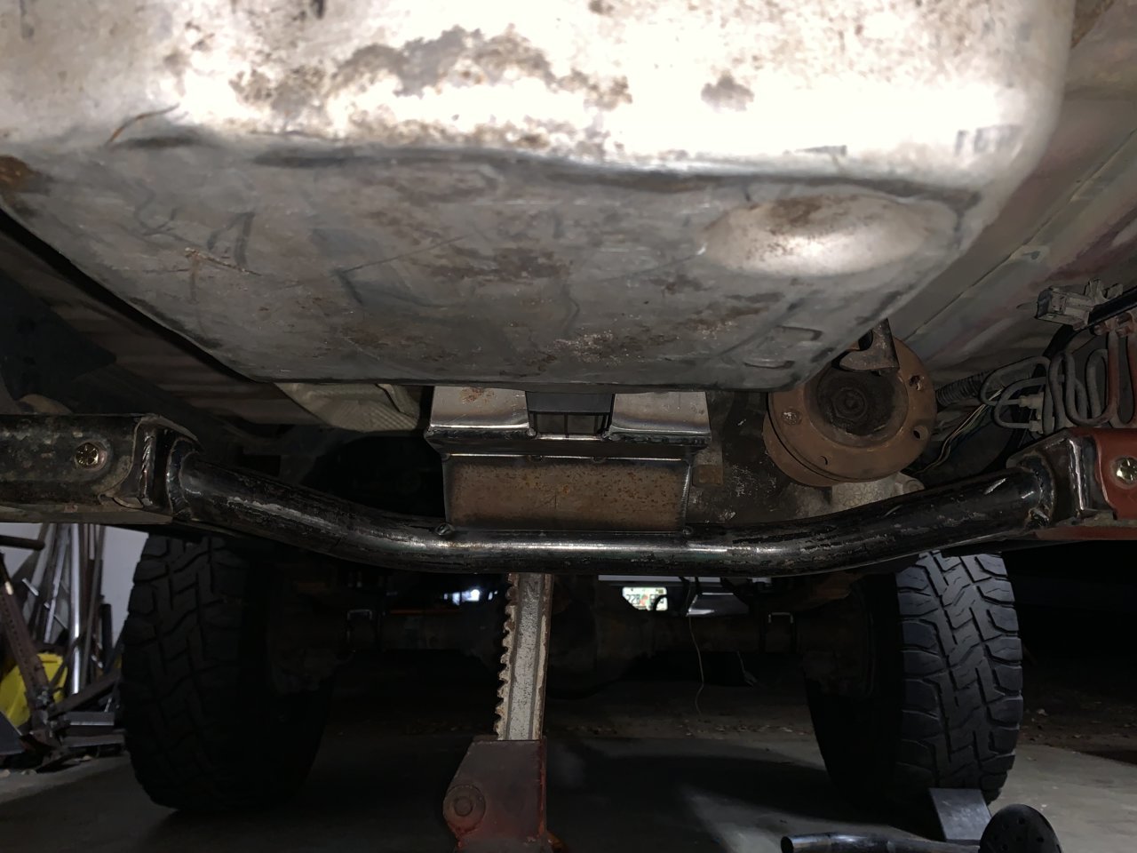

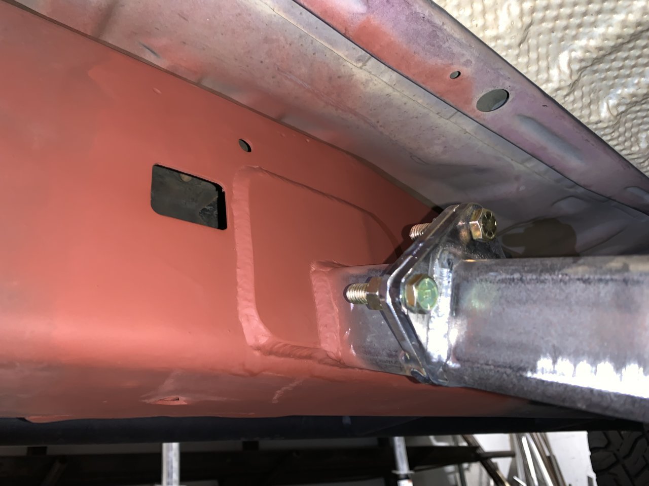

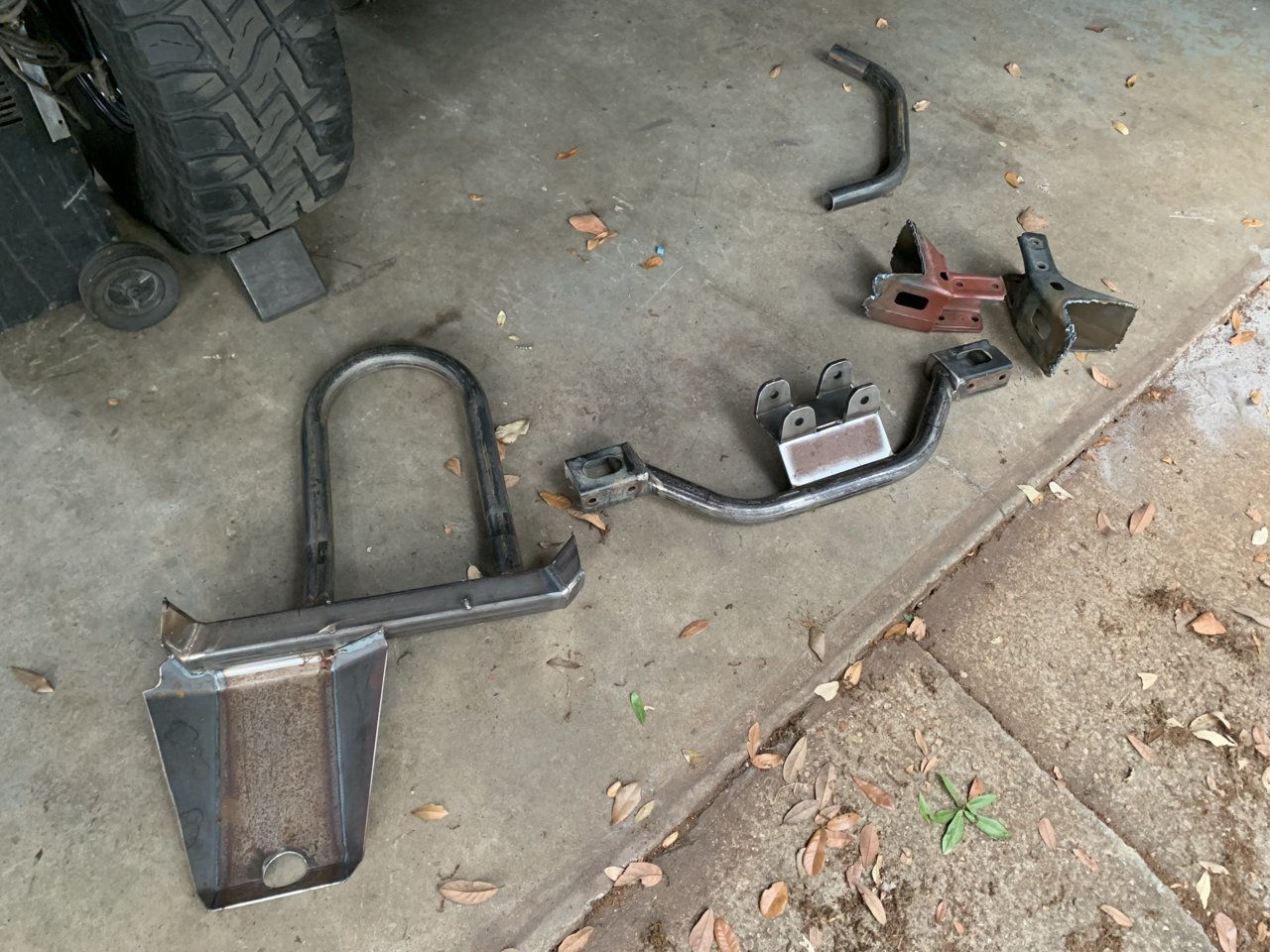

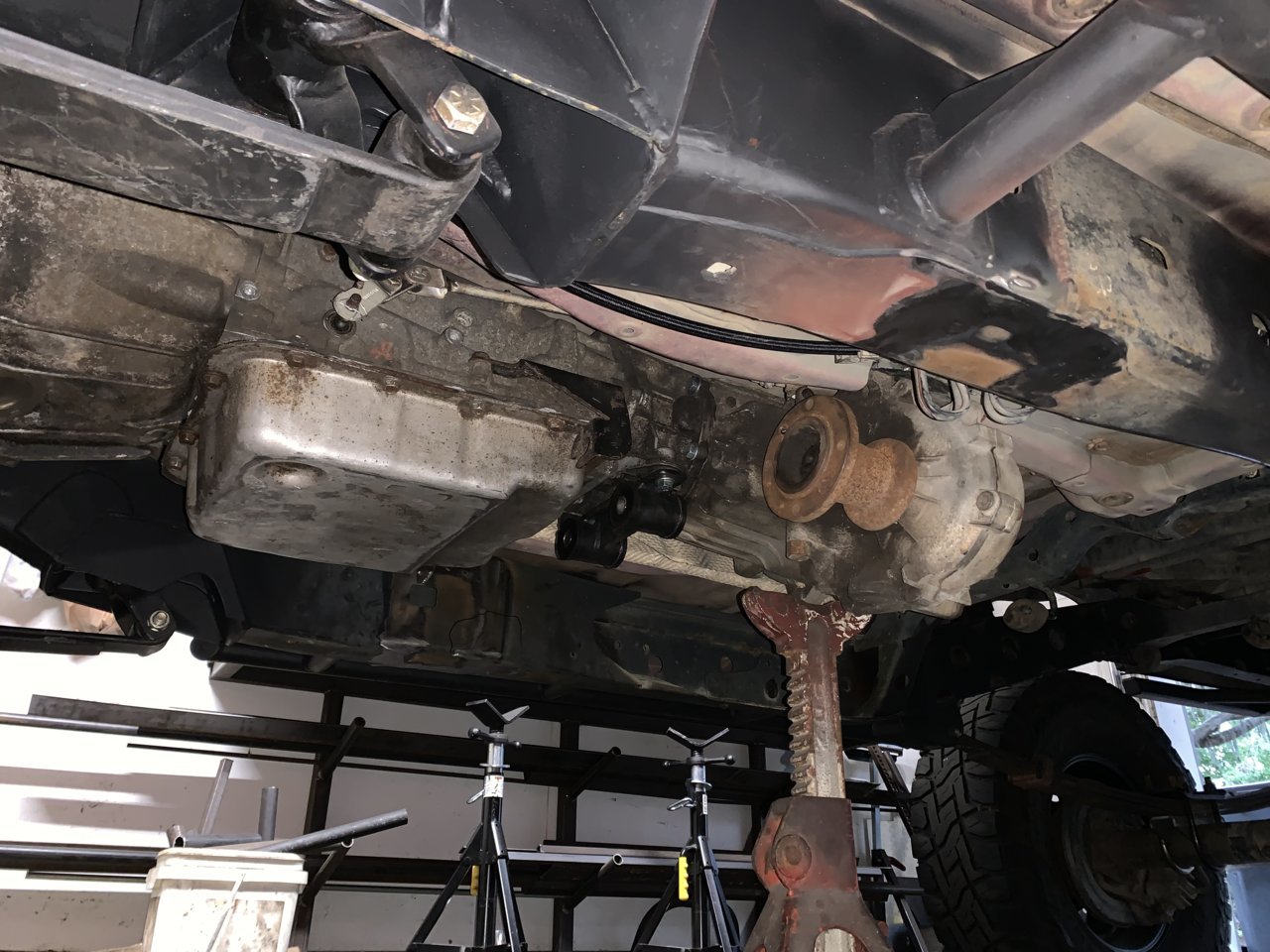

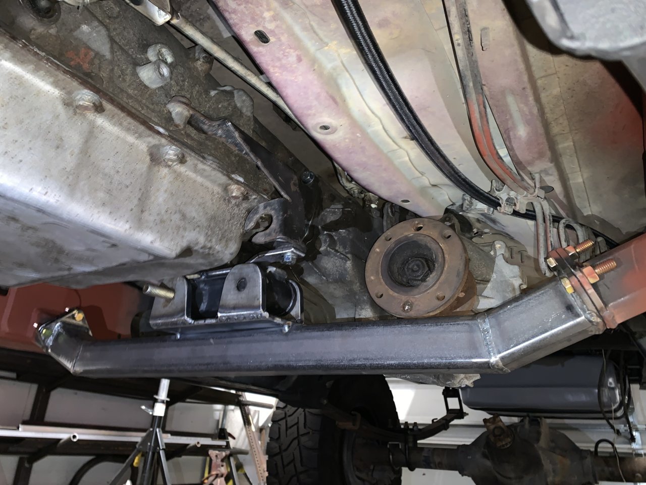

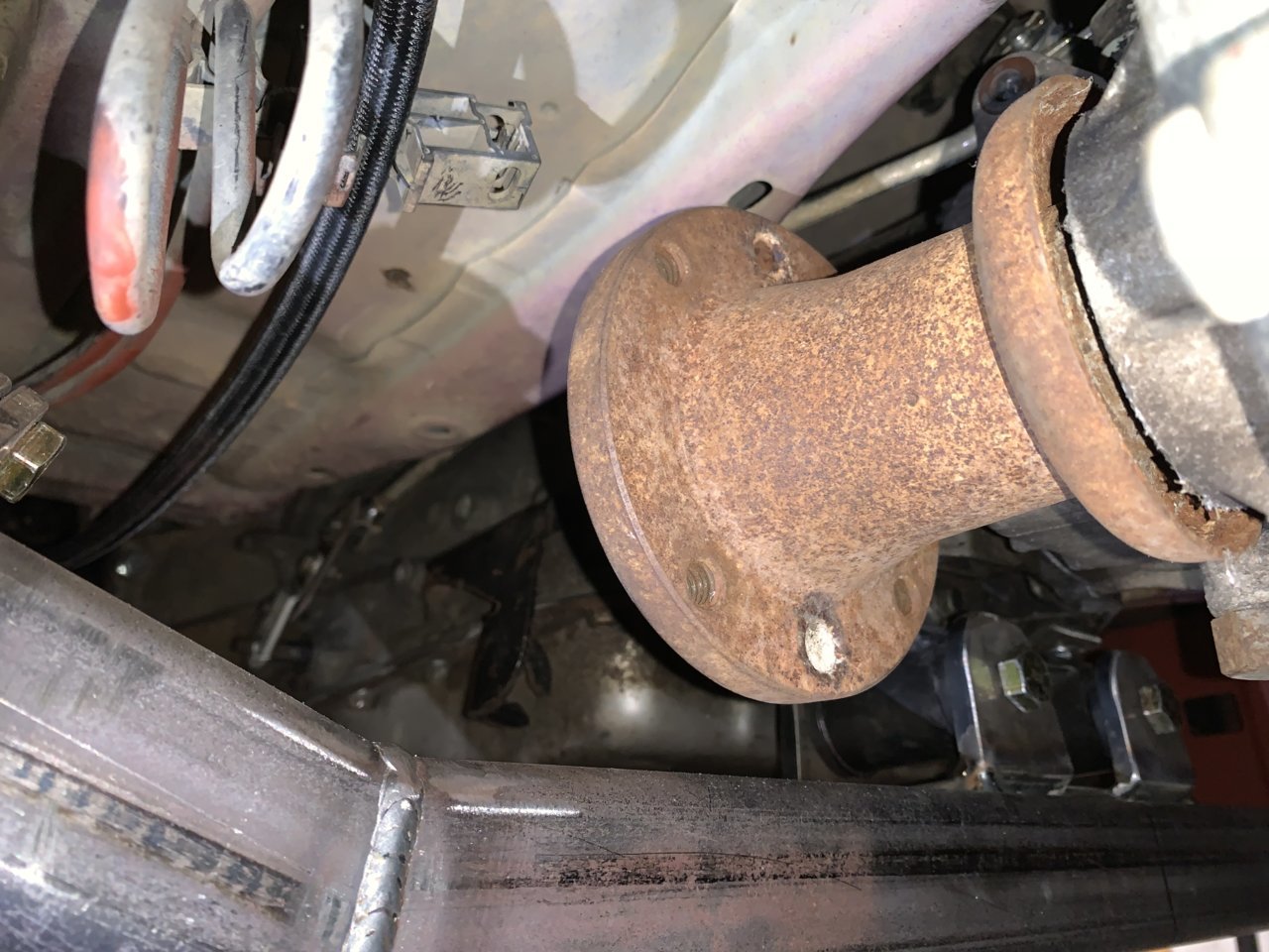

    So I finally convinced myself that I didn't like my transmission crossmember and that I needed to build a better one. That started with me cutting out the old one and bending up a tube and doing some plate work for the mount... absolutely hated it ...
    So I cut that one out, along with the factory frame mounts. They just stuck out too much inward to the center of the truck and they were a tad too far forward...
    The abandoned versions.... (salvaging some of the t-case skid off the first version)
    So I came up with this version. 2x2 3/16" tube again, but with my own mounts and everything else pretty much. Plated the frame with some 3/16" and used 6 - 3/8" bolts. This version allows front driveshaft clearance without any notching, and keeps any notching from being needed. Like said above, the old skid I made will be cut off and rewelded to the new member, and this time the transmission pan skid plate will be removable separately. Having to drop the entire crossmember just to pull the trans pan if ever needed is a dumb idea, so had to make that change...

    God I wish I had just half of your skills! Your welding is amazing!! :bowdown:

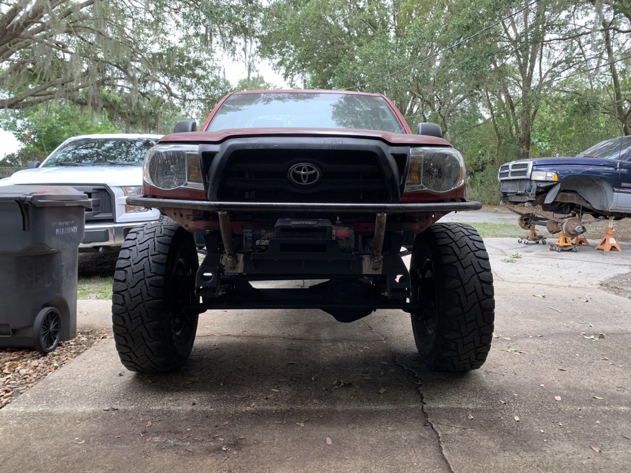

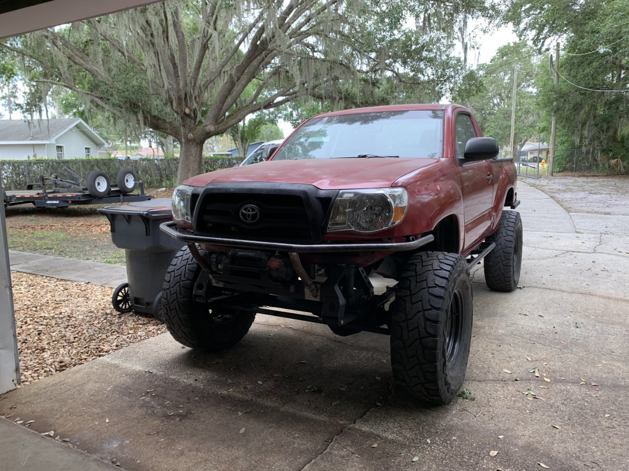

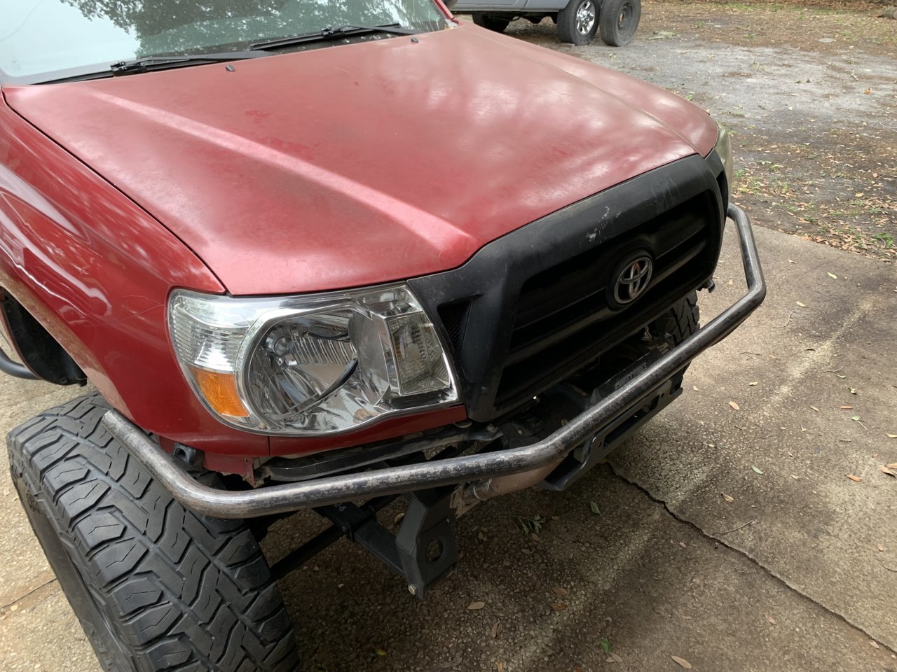

    Had a pleasant day in the garage today. I ended up buying back the 14" 5125's off my old truck from Tim so I was finally able to get the shock towers welded on.
    Got started on the front bumper. These are the bare bones of it as I am not sure if I am going to build it more as a tube bumper or a hybrid bumper. I am kinda just winging it on this one.

    Got a lot of stuff lol
    Booo!! Go no bumper lol.
    I still need to do chevy 63s still.
