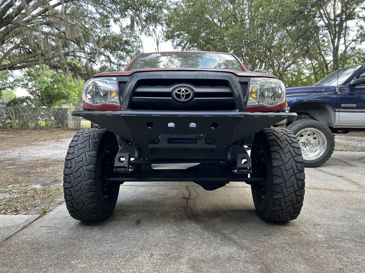

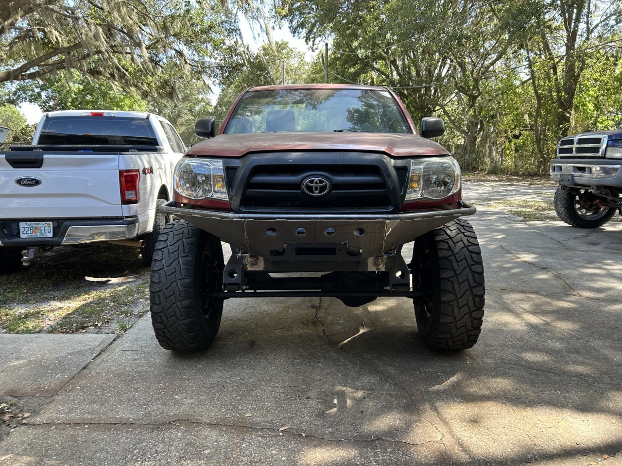

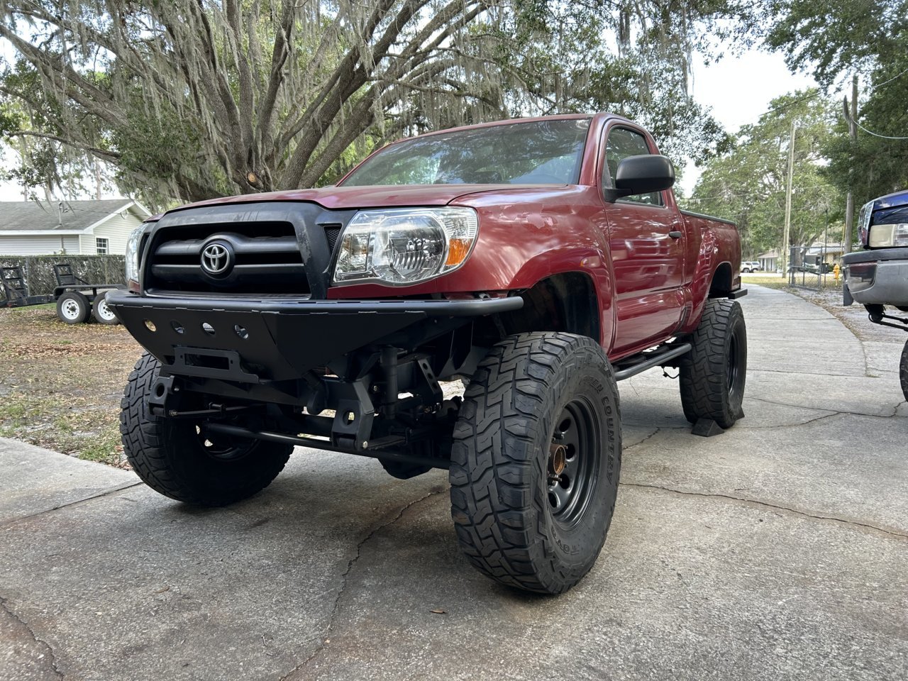

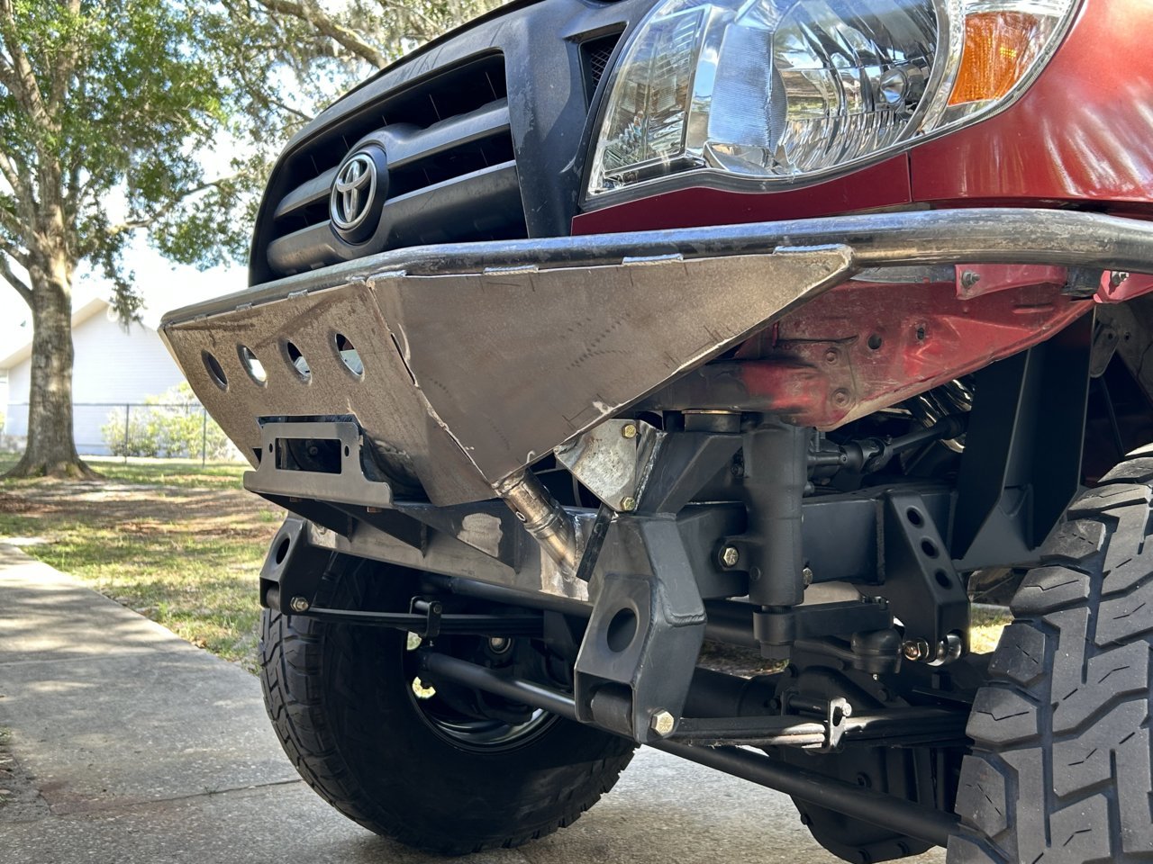

    What I came up with for the bumper... definitely different than anything I have built before but I dig it. The top is going to get a plate except where the winch is so the clutch can be used. I completely forgot about recovery points so those will be added directly to that front crossmember. It will also get some light tabs after I decide what cheap ass lights I will be running. May add a small stinger, but I am undecided I'll look up some bumpers with them to see what they look like.

    I still say you got to be one of the top fabricators and welders here‼️ I was kind of hoping you were just going to run bracing behind the OEM facia / bumper cut up. I absolutely LOVE the dimple die holes….
    Crap I’m willing to drive from TX to you for an 304 stainless exhaust system then back home to AZ.
    Your work because your welding is SO damn pretty….

    The cool thing about this setup is that I can remove the new bumper, and the factory one will still bolt right up, if I ever felt it necessary.

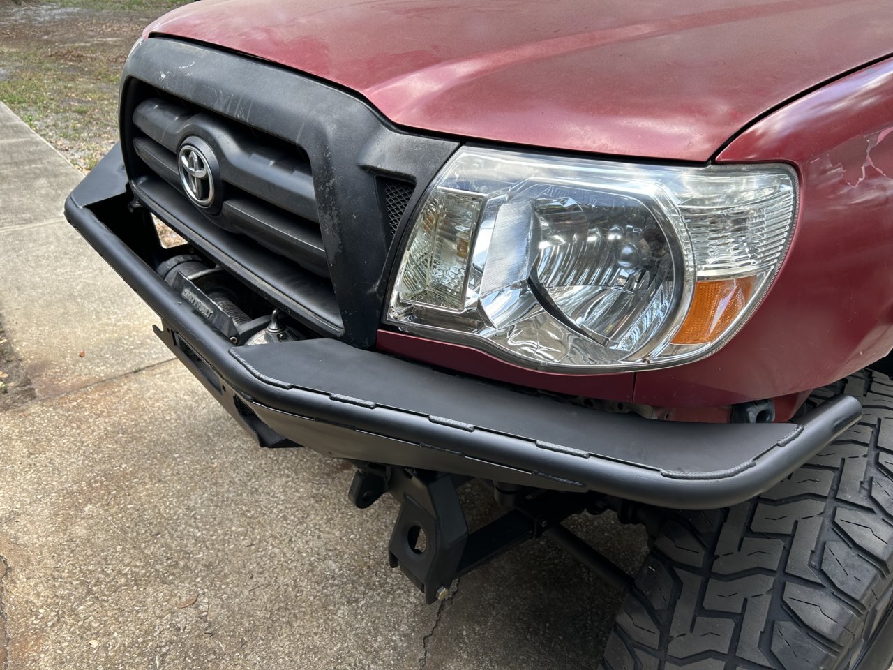

    Looks a little like the one you did for me. Haha.

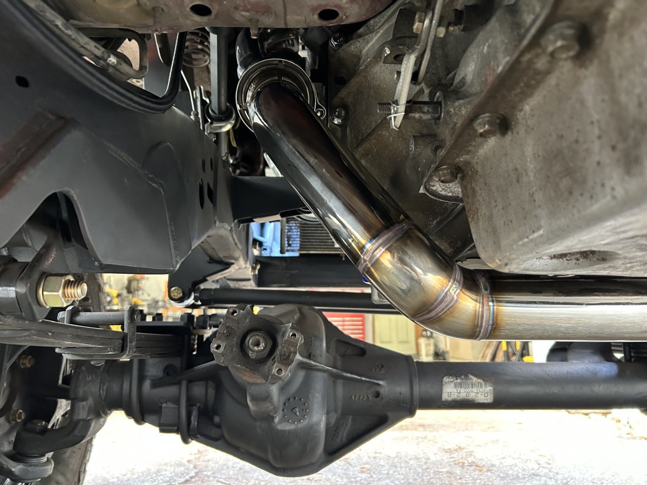

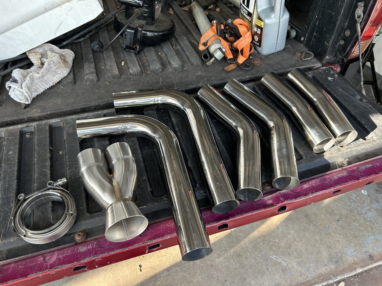

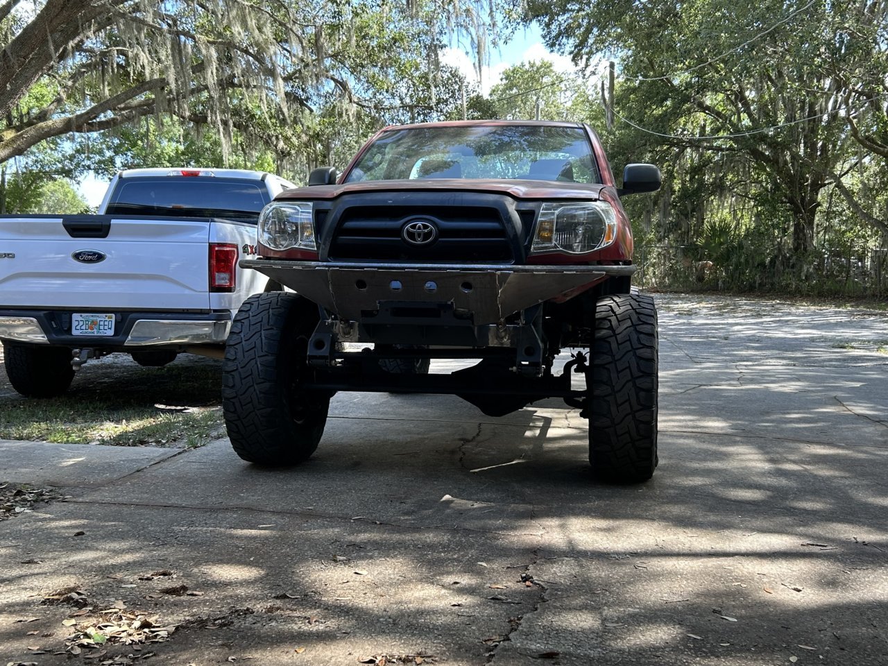

    Knocked out the bumper. I’ll add tabs for lights down the road when I figure out what I wanna run. Shackle mounts added to the main crossmember/bumper mounts.
    I ordered the stuff to do my y-pipe… all 304 stainless that I spent too much on. Everything after the merge pipe will probably be carbon :rolleyes:

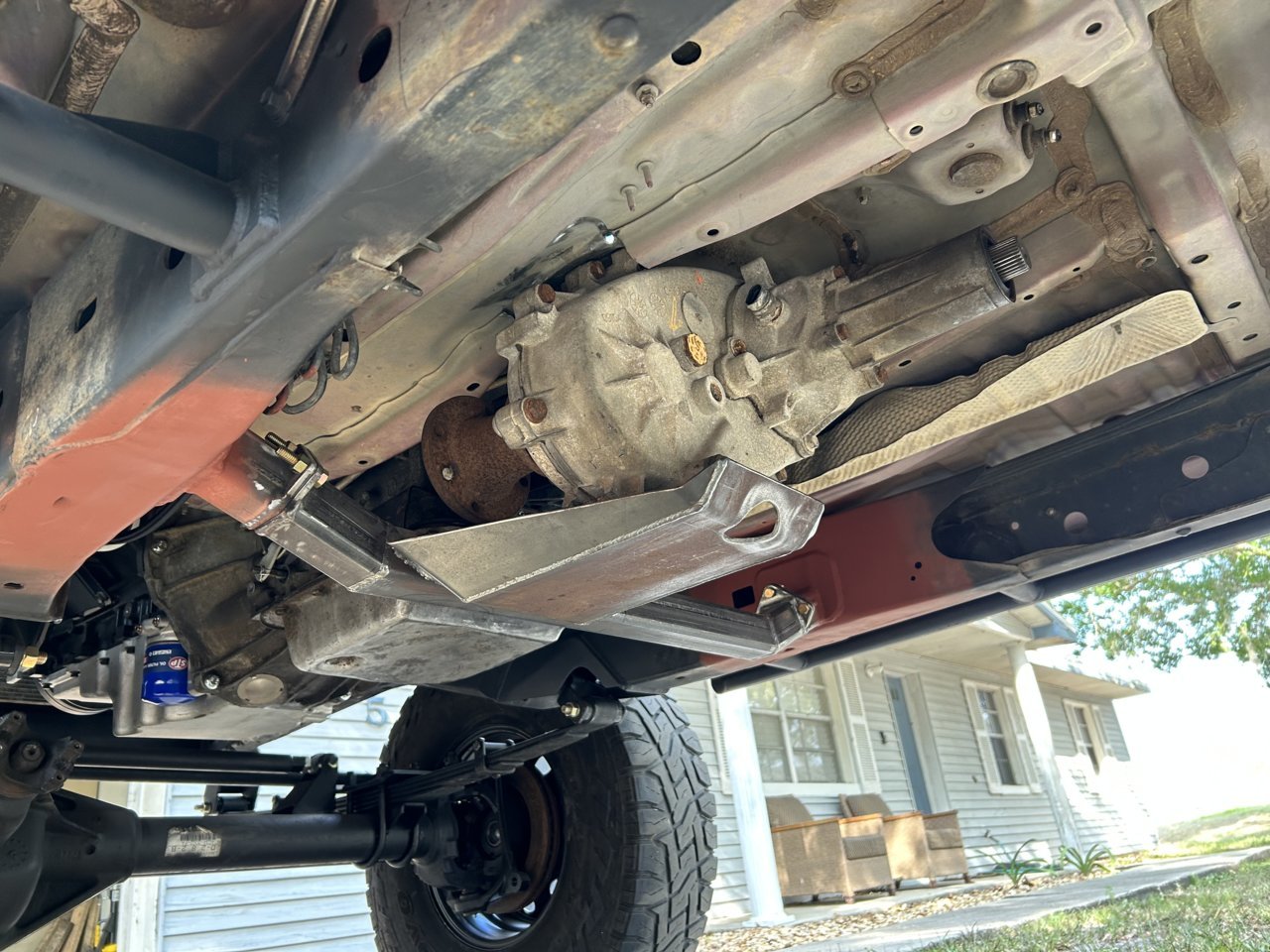

    Got the old t-case skid cleaned up and welded on the new transmission crossmember. It still needs a couple more things and then it’ll be pulled for final welding and paint

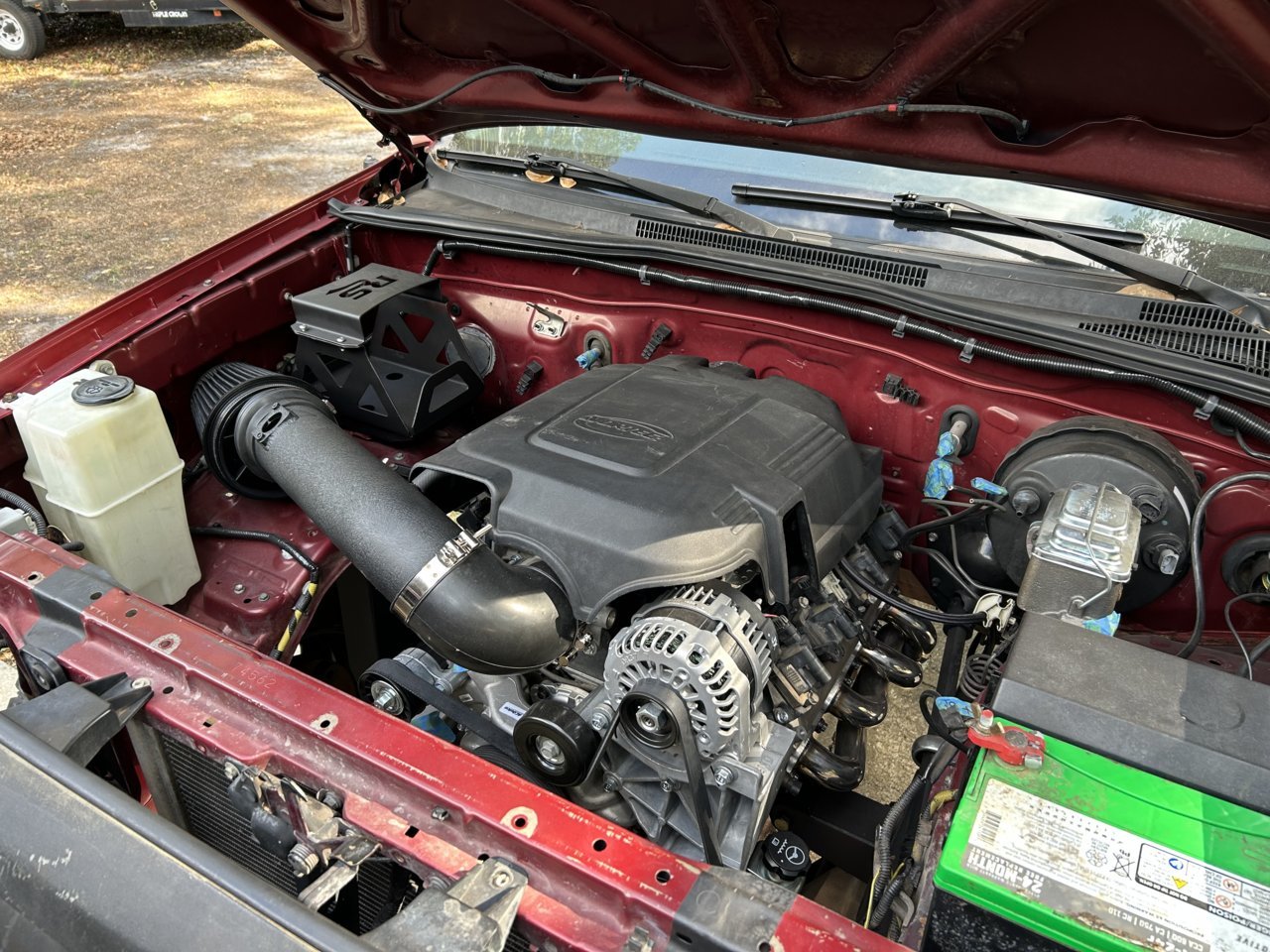

    Bought an incredibly cheap Silverado intake off Amazon knowing that I was going to be hacking it up, but it fit pretty much how it needed to. I hate the filter so I’m buying a better one, and then I’ll make a half box around it to keep it dry

    I’ll have to grab a pic. It’s pretty flat. That t-case skid hangs down below the crossmember a tad but that’s it. The transmission skid will also have to hang down below the crossmember as well

    This was $330 worth of shit and I still gotta buy at least two more pieces :rofl:
    I’m going to be cussing myself after this part of the build

    Man that engine bay looks nice! Tidy and clean!

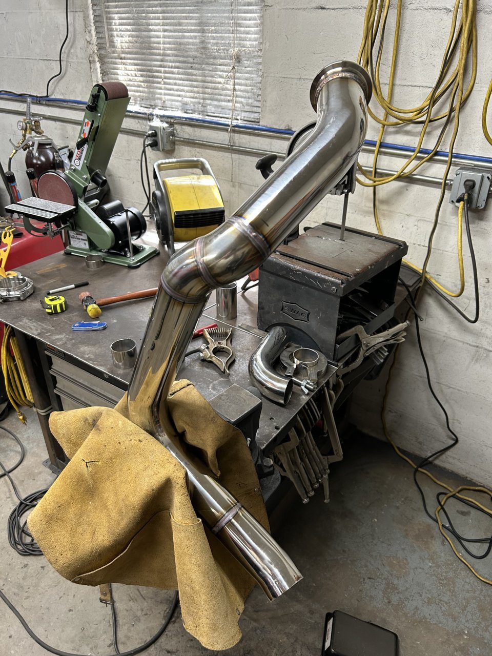

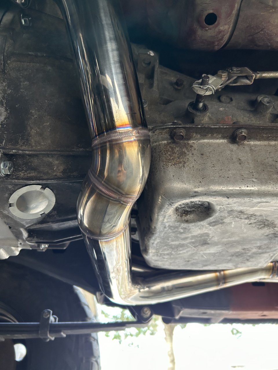

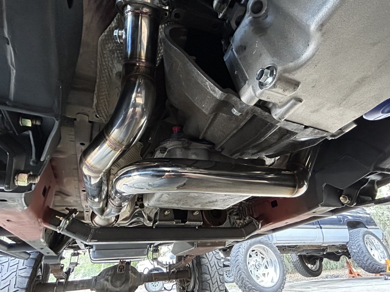

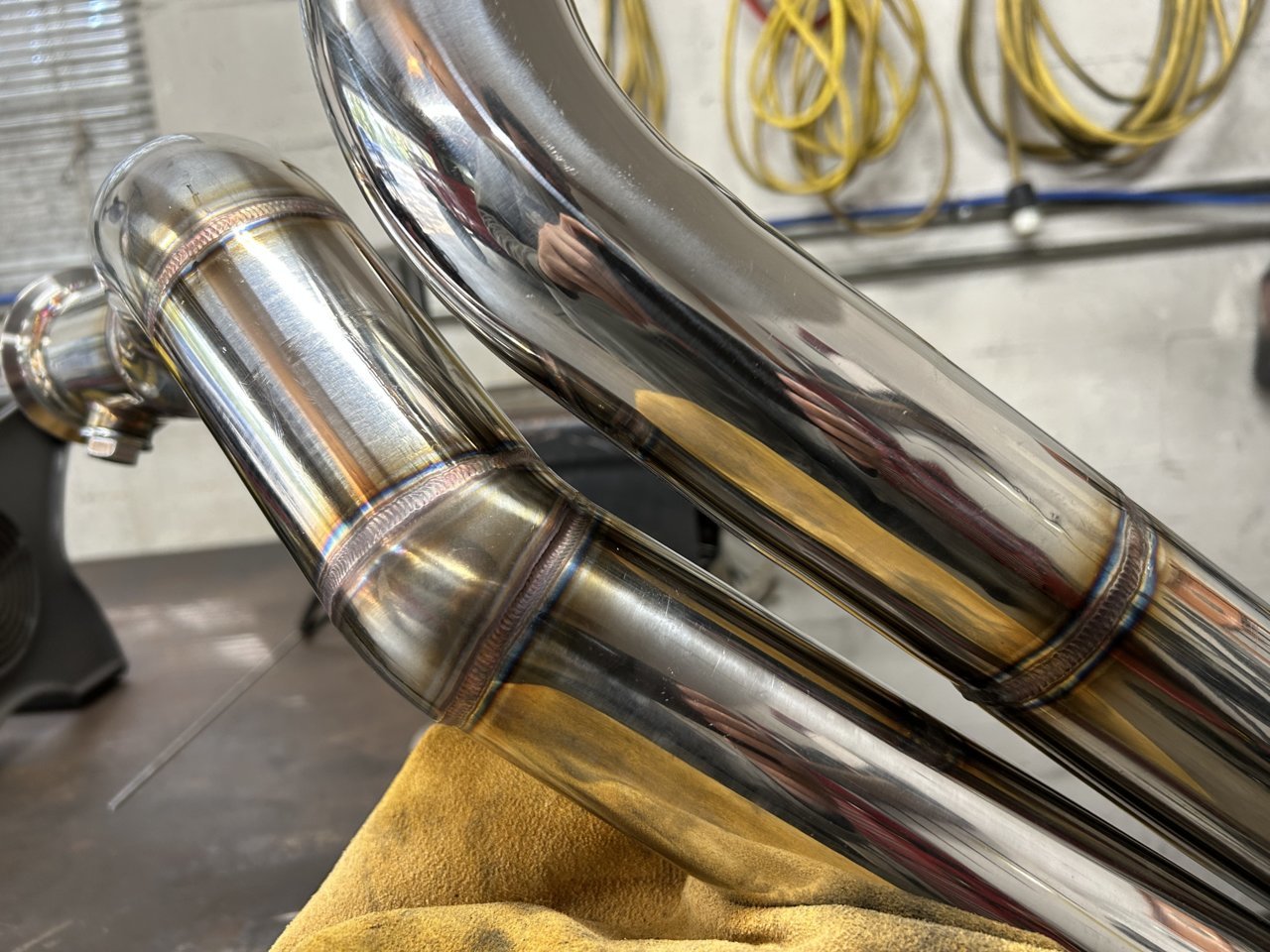

    Driver side crossover pipe done. Not bad for a first timer. It’ll look better once I get that ugly color off the welds

    Reg Cabs, 5 lug, 5 spd, Magnuson & LS Swap, StopTech’s, Yada Yada Yada…
    @BassAckwards What do you think of those welds?
    Jesus Christ I paid $1,000.00 in cash just labor for this exhaust system otherwise if I paid with plastic it was $1,174.00 and I purchased and supplied every bit of the material/s!
    I.e. I purchased the high flow cat, piping, both mufflers, V-bands, bungs and solid bar for hanging.
    Plus after 3k miles the 304 will be completely a dark brown.
    Maybe you should consider building exhaust systems.

    I mean, if I kept track of the hours I’ll have into the entire exhaust, I’ll have $1000 worth of my labor into it plus material, so that price might not be too unreasonable. And my labor is on the way low end of what people typically charge per hour.
    A well-fit and welded exhaust is very time consuming to build

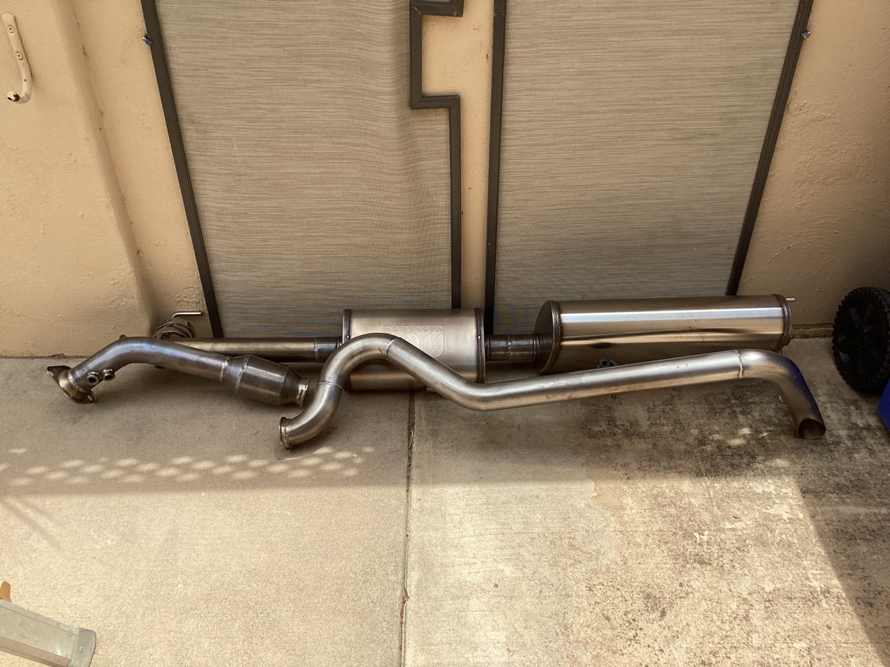

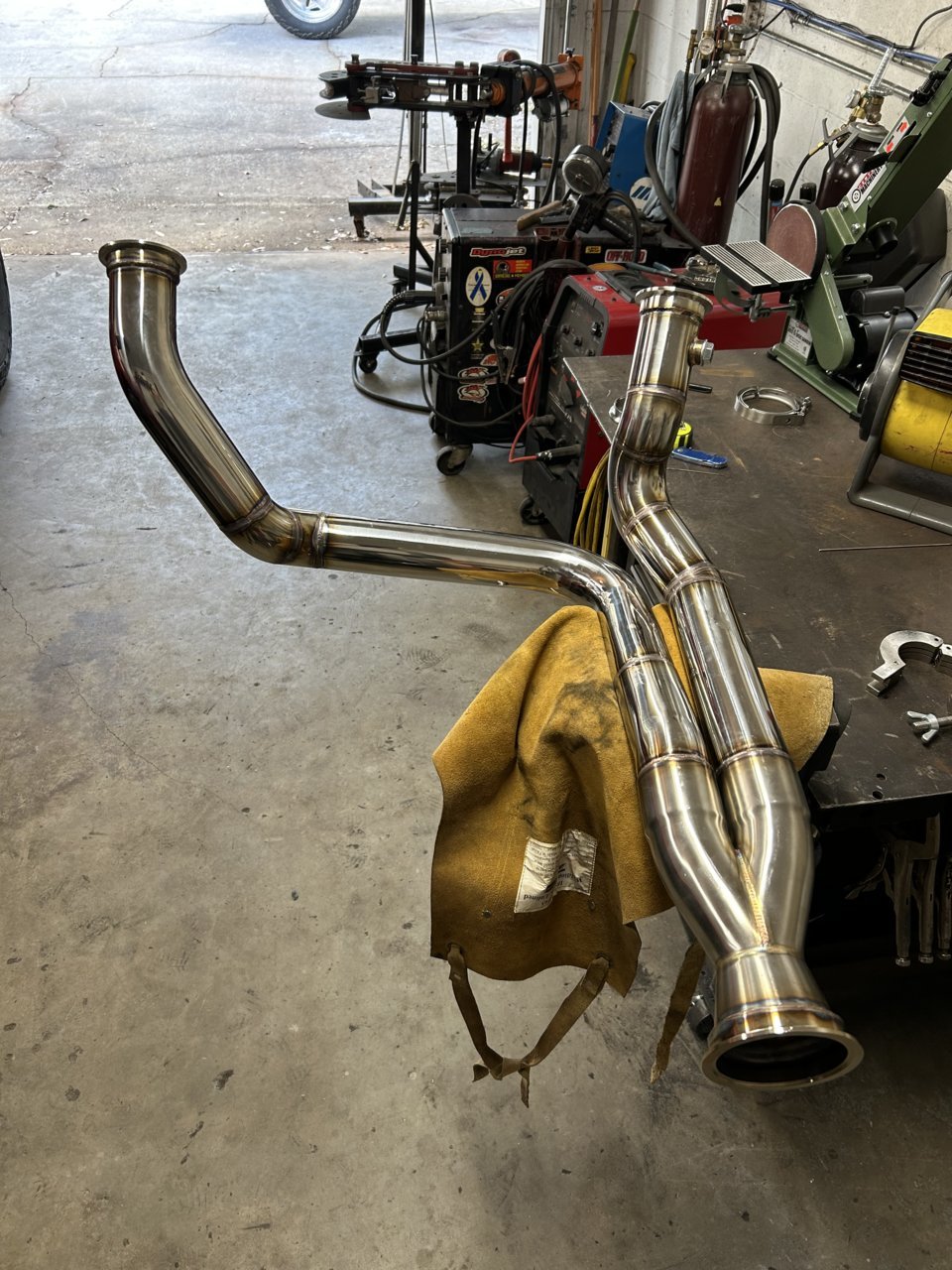

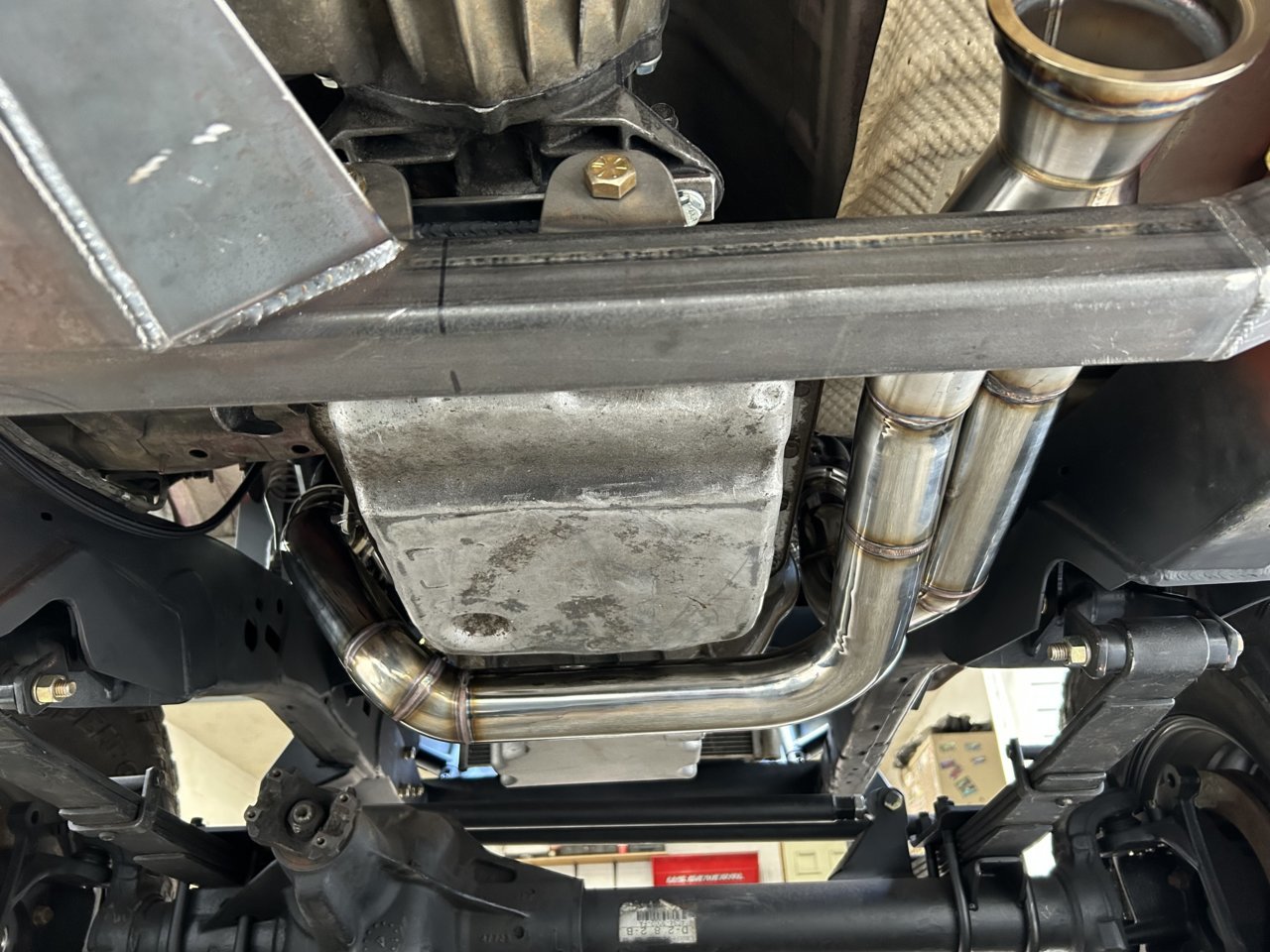

    Crossing that off the checklist
    IMG_0109.jpg IMG_0112.jpg IMG_0119.jpg IMG_0116.jpg IMG_0117.jpg IMG_0118.jpg

    :101010: :bowdown: :drool: Your welds are incredible‼️ If you change your mind about welding exhaust please let me know…
    You know this is your fault! You keep showing off your incredible talent… I personally know the owner of this company, Paul. His guys weld exhaust headers and exhaust systems for a living and you put some of them to shame… And trust me I asked Paul many many times but he said he doesn’t do one off systems anymore…
