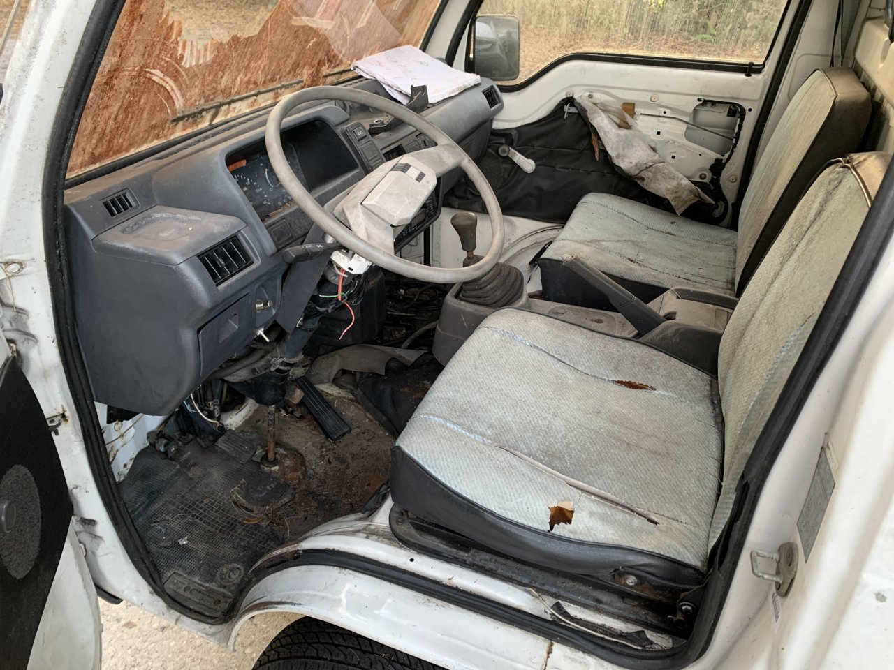

    Been a while since I’ve had any vehicle to work on since selling my Tacoma in 2020 (other than my F150, but bolting on store bought parts is not a build). So, figured I’d start a thread on side jobs/personal jobs/and this mini truck I acquired. Anyhow, I had a Cushman “white truck” sent my way from my bro in law that he needs me to get running and useful for a woods/hunting truck. It didn’t run, broken clutch pedal, rotted away gas pedal, fist-size hole in the gas tank, and a missing cv axle up front.
    when I got it…. 990EB96C-3903-475D-AFAB-9820691A3592.jpg 3C345F47-10F7-4356-B5A1-F1FB64D6AE4F.jpg

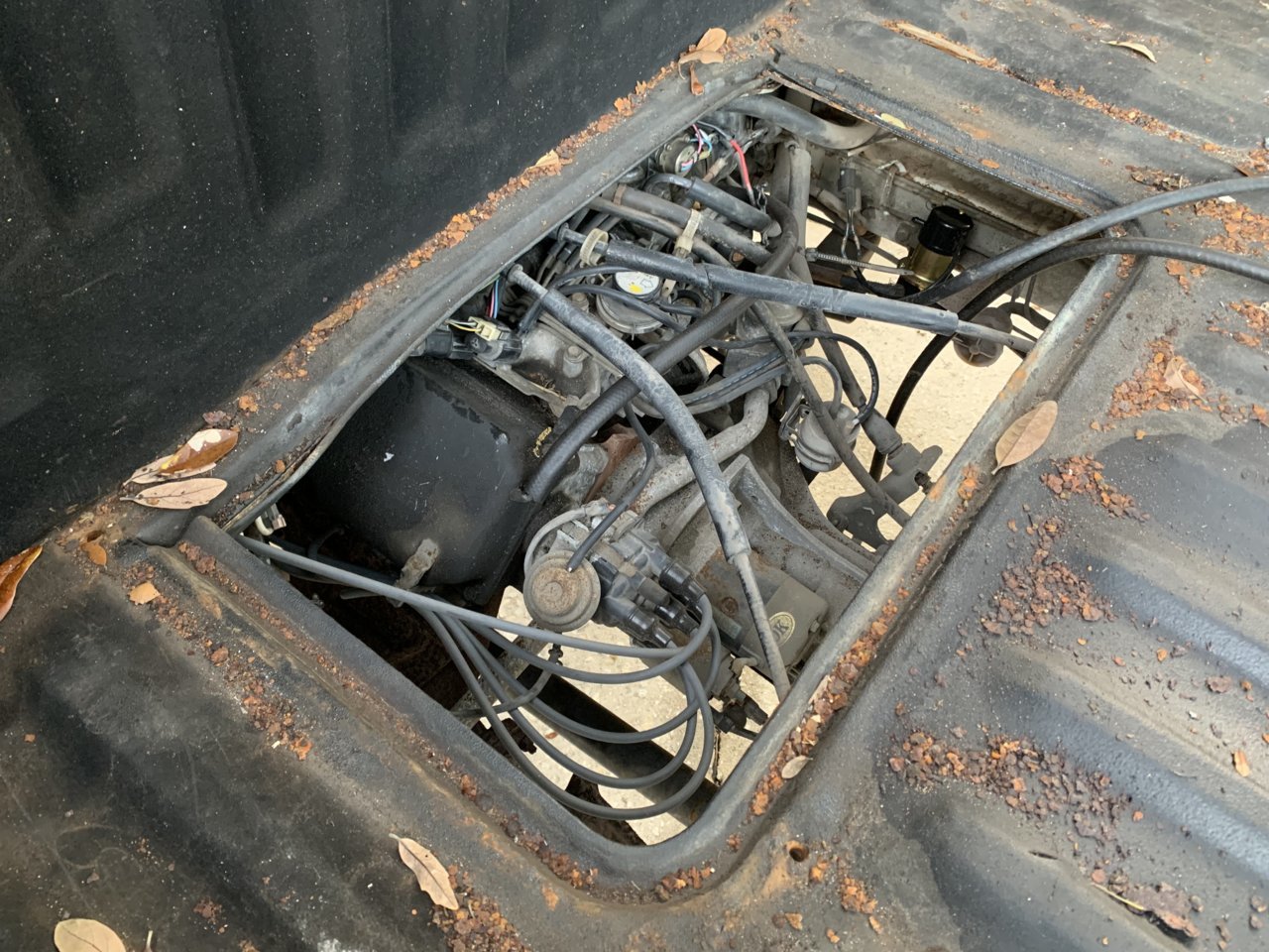

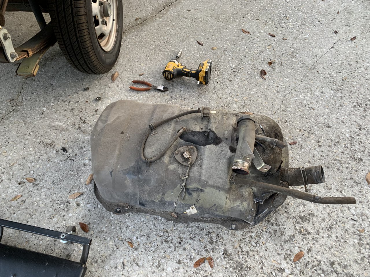

    Along with the truck, my bro-in-law gave me $350 cash to get started buying what I need to get it going, so I am going CHEAP with everything :D. Got it running out of a gas can, but the carb is shot (after twice cleaning it), so doing a Harley cv40 carb swap once the parts come in. Yanked out the gas tank and all fuel lines, cleaned the interior up and got to work.
    B201CE63-BCE5-4083-B2C9-879811679CC4.jpg 2FD9B6C3-9B78-40B7-B143-4C0F27FD8E71.jpg 8F3ECCCF-AE05-4200-84DF-FF70856D643C.jpg

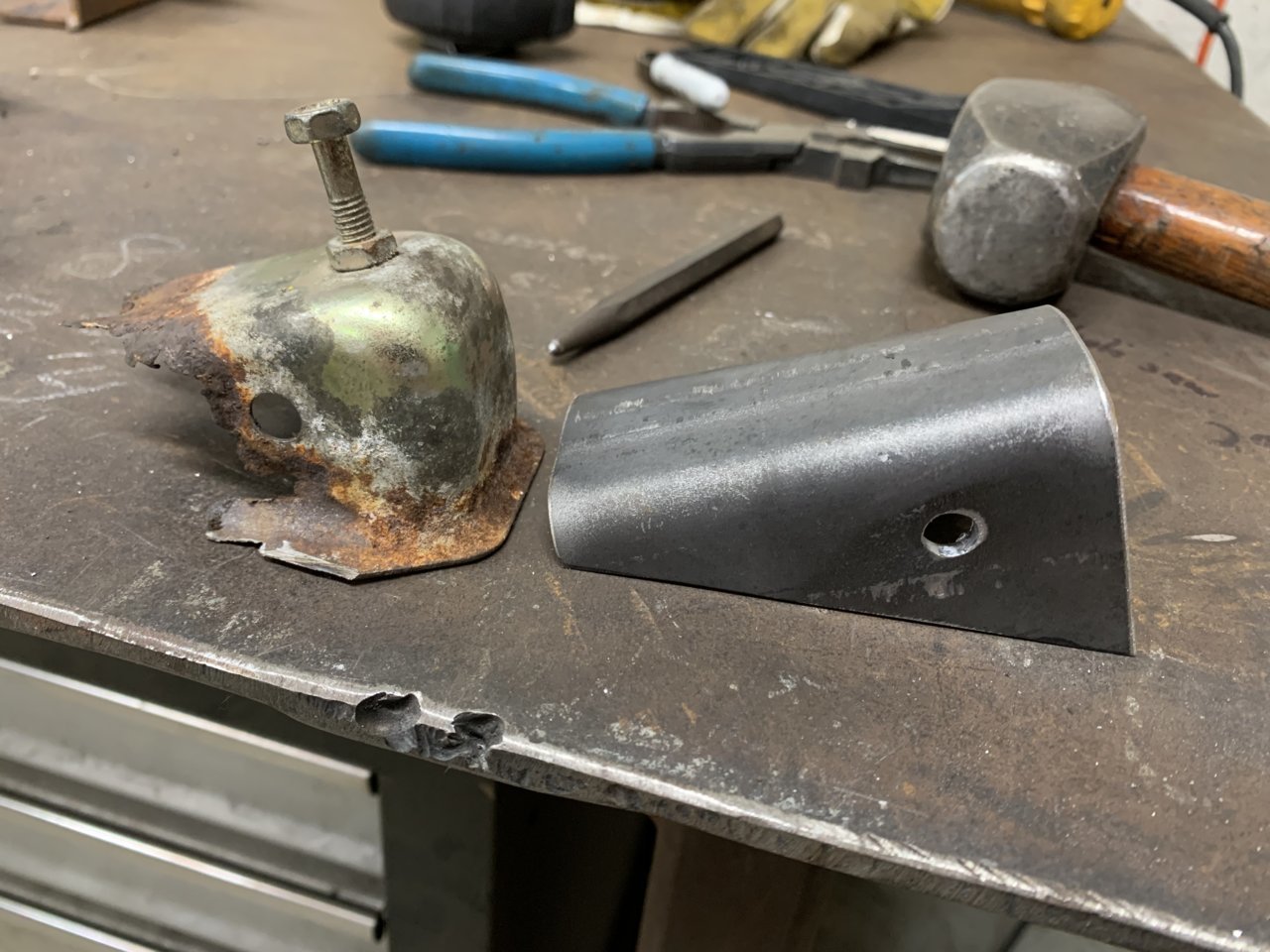

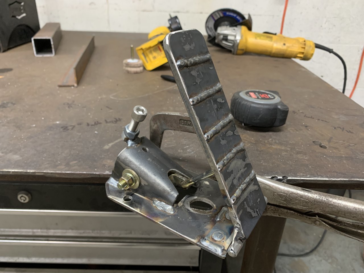

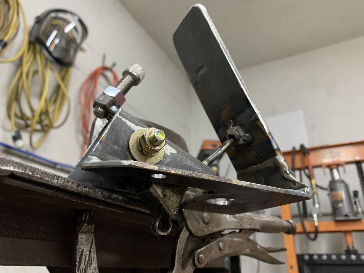

    Been slacking on this. Had to cobble together a new clutch cable attachment for the clutch pedal and fab up an entire new gas pedal, as the old one was rusted away. I also threw a CV40 carb on this (common swap on these, it’s a Harley Davidson carb) but it’s still idling just as high as it was before with the stock carb. Need to research more to see what could be the issue.
    1354729A-C7A4-4776-907C-E8F5B4EF8B8C.jpg A8368F42-B0DE-4B7B-9392-28613CC18D5A.jpg 02A9FA40-E54A-47E3-A26C-9A42780765AE.jpg
