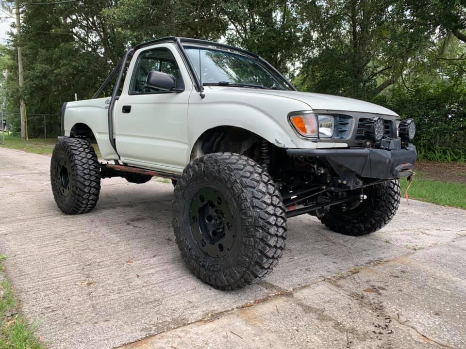

    As it currently sits:
    After 2 years of looking for a truck, this is what I have brought home. I was looking for a truck for quite some time, but I couldn't bring myself to pay the $5k+ asking price of the beat to shit 4 cylinder Toyota pickups locally. I ended up buying a 1995 Tacoma 3.4, 5 speed, 4x4 Regular Cab off of a buddy who had sank and hydro-locked the motor for $1k. After a salvage yard motor swap, new clutch/flywheel/misc. other parts to get this thing running and road worthy, I had about $3400 into it total. Now the fun stuff starts...
    1995 Tacoma Regular Cab 240k miles on truck
    1998 motor with 138k miles, timing belt changed at 109k
    R150F 5 speed transmission with new clutch, flywheel, misc. seals
    manual shift chain drive transfer case
    Modifications
    Powertrain
    3.4 V6
    R150F 5-speed transmission
    Atlas 4 speed 10.34:1 transfer case
    Vibrant Resonator
    Flowmaster Delta 50 muffler
    Axles
    08 Super Duty Dana 60
    4.88 Motive Gears
    Detroit Locker
    Warn Hubs
    08 Super Duty Sterling 10.5
    4.88 Yukon Gears
    Detroit Locker
    Suspension
    Front 3-link
    RuffStuff heims (1.25" and 7/8" heims)
    Radflo 12" 2.0 Coilovers custom tuned by Brian @ 4 Wheel Underground
    Rear Chevy 63" leaf springs
    5" shackles
    14" Bilstein 5125 Shocks
    Steering
    Toyota IFS box rebuilt and tapped for hydro assist
    Sky Manufacturing chromoly flat pitman arm
    Derale 12" heat sink cooler
    Stock Pump with extended reservoir
    PSC 1.5"x8" ram
    PSC hydro assist lines
    Trail-Gear power steering hoses from pump to box
    Jesse Haines Weld-on Crossover steering
    Tires/Wheels
    37x12.5R17 Maxxis Razr Tires
    17x9 Vision 85 Soft 8 black steel wheels 4.5" BS
    TMI rock rings
    Other
    Smittybilt 9.5 winch
    Custom front plate hybrid bumper
    Custom Tube bed
    Dovetail/Bobbed bedsides
    Rock Sliders
    Tractor supply tool box
    Hi-Lift and mount
    Jerry can with holder
    18" Radiator
    Electronics/Interior
    PRP Daily Driver suspension seats w/PRP mounting brackets
    Raptor-lined Floor
    Fire extinguisher with Drake quick release mount
    Bussman fuse/relay box
    Paranoid Fabrications switch panel
    OTRATTW switchesr
    Uniden PRO520XL CB radio
    Main use is for trails, camping adventures, hunting rig, and of course the wonderful Florida mud :luvya:

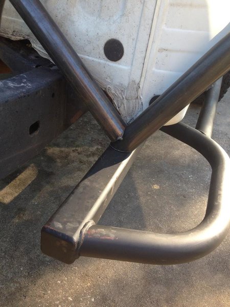

    a few more pics...

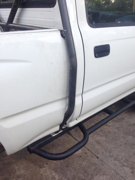

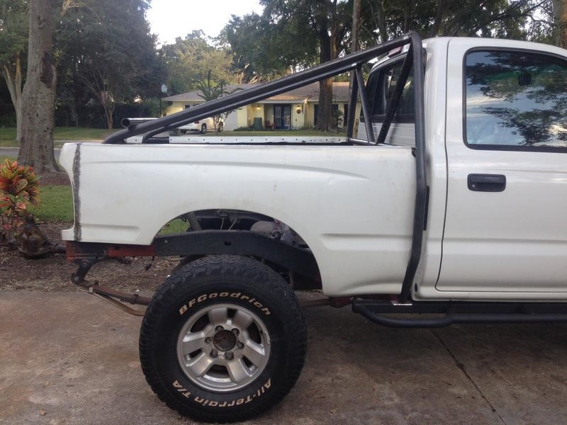

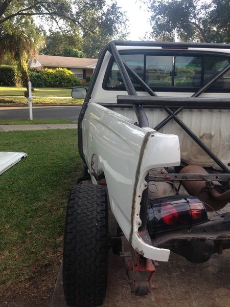

    Started cutting the bedsides and bobbing it..... this is my first ever attempt at this or body work for that matter, so it could very well come out looking like shit

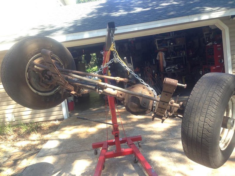

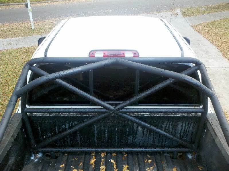

    Picked up the Dana 44 last night out of a 1982 Jeep J10. Also got started on the tube bed...

    I'm excited to see this tube bed.. What bender do you have?

    Pro-Tools 105HD

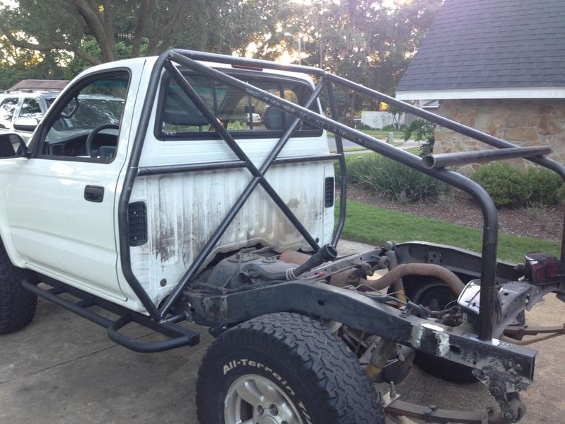

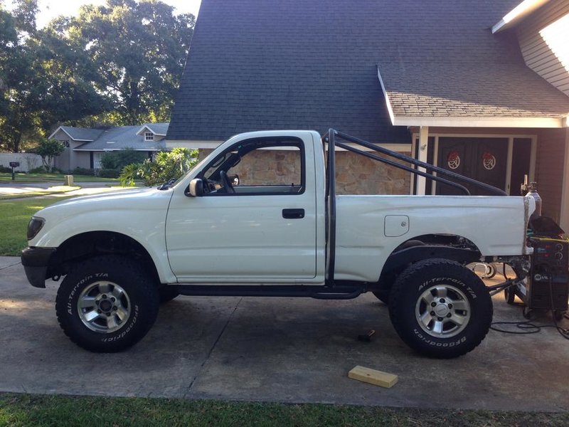

    messed around with it a little more today... didn't get too much done though

    I should have stopped by.

    I was going to text you, but I was in and out of the house all day. Had to run some errands so the time I spent building shit was all split up throughout the day

    Looks good so far, I'm digging it.

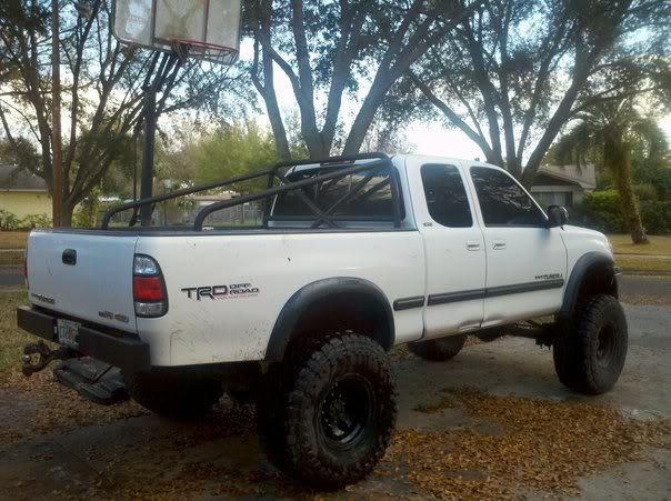

    I wanna do that exact tube setup in the rear, but cut holes in the bedfloor for the tube to pass through instead of cutting out the bedsides like you did.
    Looks really nice!

    That's how I did in my old Tundra so I could still use the bed to haul my 4 wheeler and other stuff. It was pretty slick looking

    Got any pics?
  18. Oct 27, 2014 at 5:27 PM
    #18
    allenfab
    allenfab [OP] I hate everything
    Oct 23, 2014
    #140913
    2,333
    Todd
    Lakeland, FL
    95 Tacoma Single Cab 3.4 V6
    3-link SAS, Detroit's f/r, 37 RAZR's, Atlas 4
    The only ones I still have, none of the actual tube going through the bed

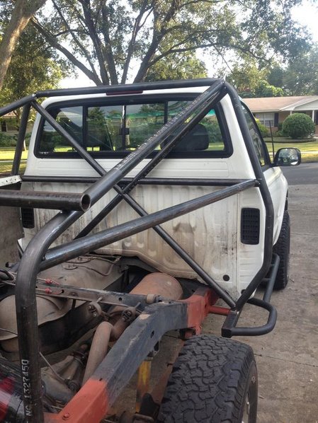

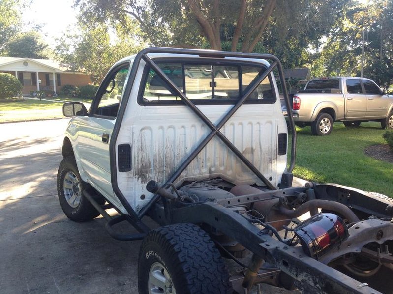

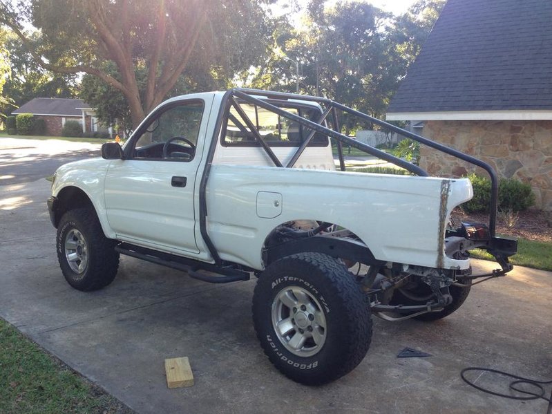

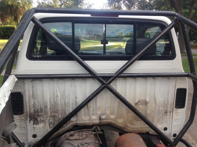

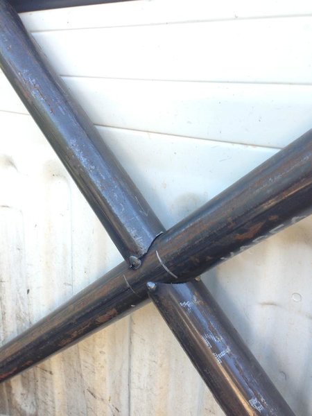

    My buddy Walker came over and hacked up the bedsides and got them to fit pretty good. I added a little bit of tube work to the cage as well. It is coming together pretty good.
