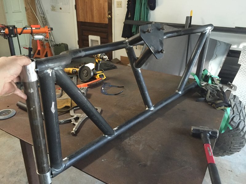

    Just a regular ole Pro-Tools 105 HD tube/pipe bender

    Nice... now that I can view on a PC... no wrinkles, turned out cool.

    Pretty much done minus the spindle for the hinge and pull-pin style latch. Hopefully I will have it installed on the truck by next weekend.

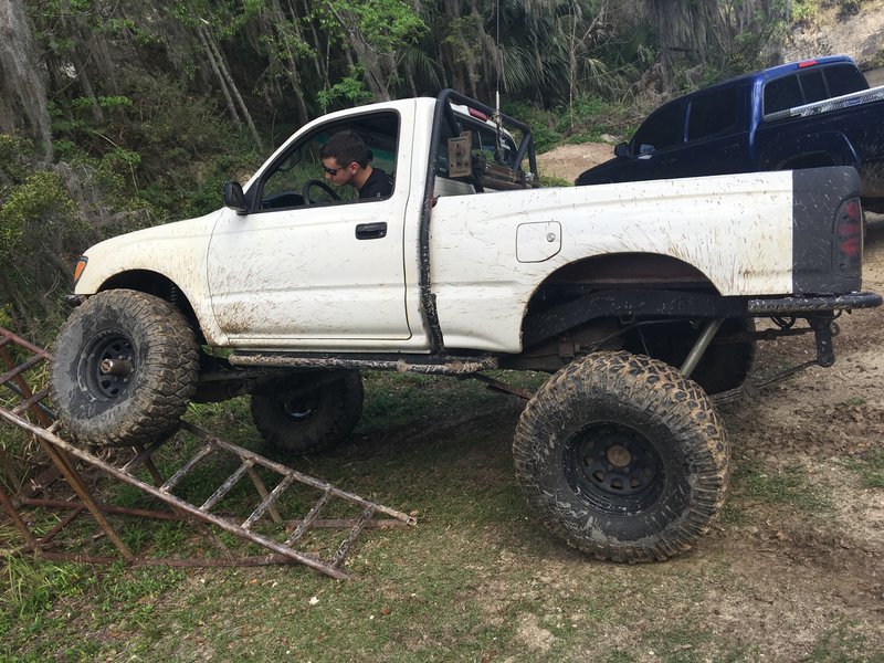

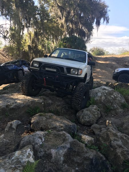

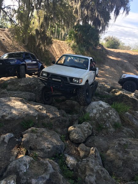

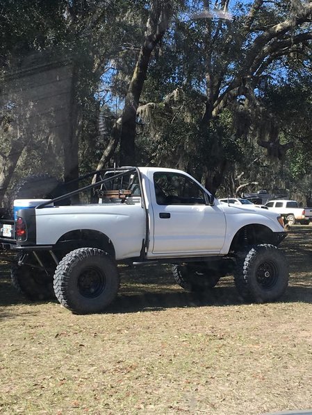

    A few pics from Hardrock
    Photo Mar 20, 5 38 05 PM.jpg Photo Mar 20, 10 33 29 AM.jpg Photo Mar 20, 10 33 34 AM.jpg Photo Mar 20, 11 45 46 AM.jpg

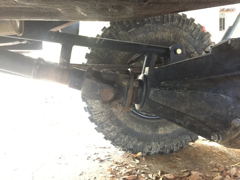

    Question:
    What is your pinion flange angle versus the angle at the trans output flange?
    I have severe driveline vibes... killin' me.
    Thanks.

    1998 SR5 Xtra Cab 4WD V6 Spartan Package
    OME 3" lift with Dakar rear leaves and 883 front coils. 36x12.50 Super Swamper TSL/SXs on Pro Comp Series 97 15x8 Steelies, Bud Built Front Skid, 4xI rock sliders, 4.88s and an Eaton True Trac LSD up front, 4.88s and a Detroit Locker in the rear, LED cab clearance lights, Sway Bar Delete, Rear Diff Breather Mod, Autometer Monster Tach, Cobra 25LTD Classic, Roof-mounted 3' Firestik Firefly, Garmin GPS, HiLift Jack, Flush-mount LED pod lights in rear bumper, 28" light bar in the front bumper, rear shock relocation (Ruff Stuff brackets), u-bolt flip with Ruff Stuff Anti-wrap perches, CBI rear frame reinforcements, 10" travel Bilstein 5125 rear shocks, heavy duty front crossmember made by Allenfab, Rear shock mounts/crossmember (for upper mounts), spring perches, frame plates, and front crossmember welded in by Allenfab, CBI Ditch Light Brackets, Ditch Light Pods. AllenFab Custom Hybrid front bumper and recovery points. Drivetrain lifted 2" in conjunction with a 2" BL. Modified Trail Gear transmission crossmember/skid. Warn Xeon 10K winch. Large left side body mod.

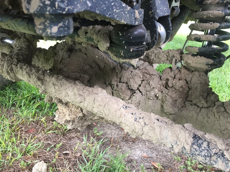

    Be sure you wash that mud off before it gets too dry. That shit at Hardrock dries into concrete. You'll be in there with a chipping hammer knocking the crap off if it dries out. :D

    Front or rear? I'll check when I get home today from work.
    Had to wait till I got home to get it off. I just threw a sprinkler under the truck for about an hour and it knocks most of that stuff off but if it doesn't, it loosens it up enough to knock it off with the sprayer on the hose.

    ... for the rear when you have time.
    The rear has a Deaver 8 pack sitting on the OEM perches. Been fine for years. The cross member I made is off somehow.
    Thanks.

    @Ritchie the pinion is pointed up about 10 degrees. My driveway is sloped so plus or minus a degree lol. It's almost pointed directly at the t-case output.

    Hmmm, mine is too. Currently at an OEM angle of 77 degrees.
    The output flange is @ 85, which I set with the new cross member to replicate the OEM angle there too.
    Dunno.
    Thanks for checking.

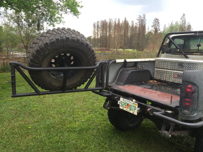

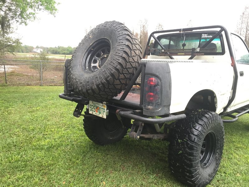

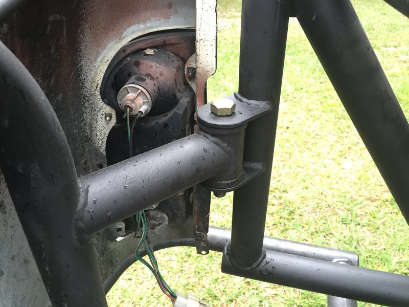

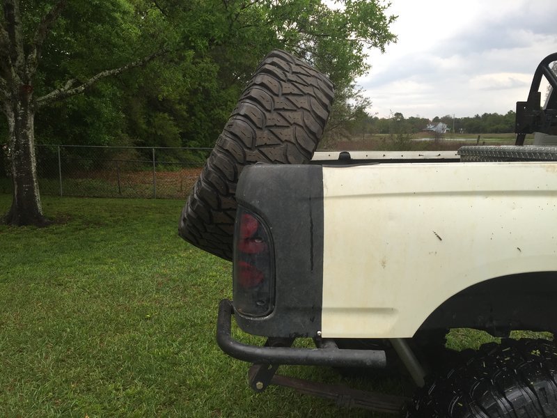

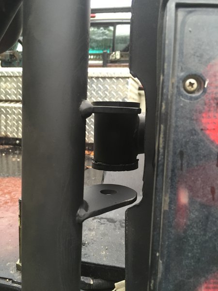

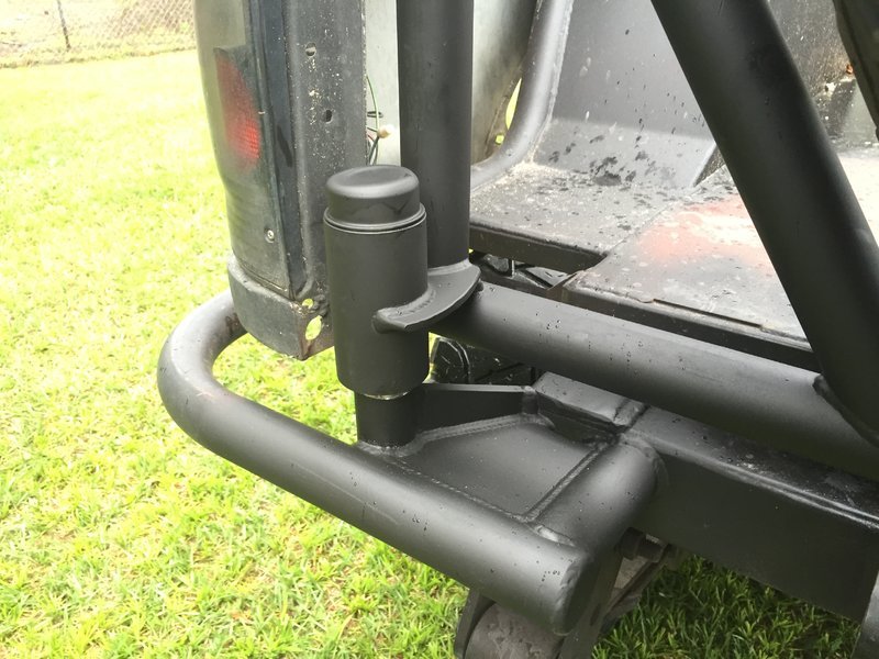

    Spare tire carrier/tailgate is complete. I ended up using a tiregate hinge from ruffstuff and a poly bushing for the latch. The bolt in there now will be replaced with one of those red-handled pins (have to find one that is 9/16"). We will see how everything holds up because I have seen occasions where the vibrations and movement of the tire and tiregate will cause welds to fail from stress.
    When the gate is open it sags 1/4", so I have to lift up on it to get it back in line with the bushing. This was expected and I don't see it as a big issue because it will be closed and latched 99% of the time.

    That turned out nice.
    If there is no frame flex/ droop at the end, I'm thinking that the weight of the rim & tire are causing the 1/4" sag.

    Should build a fold down table or stuff for a grill hahaha. Some of them gates are crazy how that have them

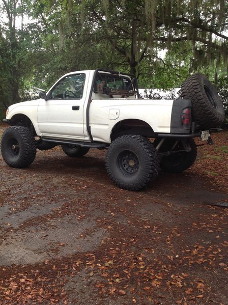

    I don't have a pic with the bed loaded, but I just took this one with the new tiregate and spare tire hanging off the back. I can't remember the frame height but the truck is on 35s.
    EDIT: found a pic with the old dovetailed bed with spare, full cooler, and full rubbermaid contained with camping supplies and tools. Also the toolbox is full of stuff. And this was before I lowered the front an inch
    SnowroxKT[QUOTED] likes this.
