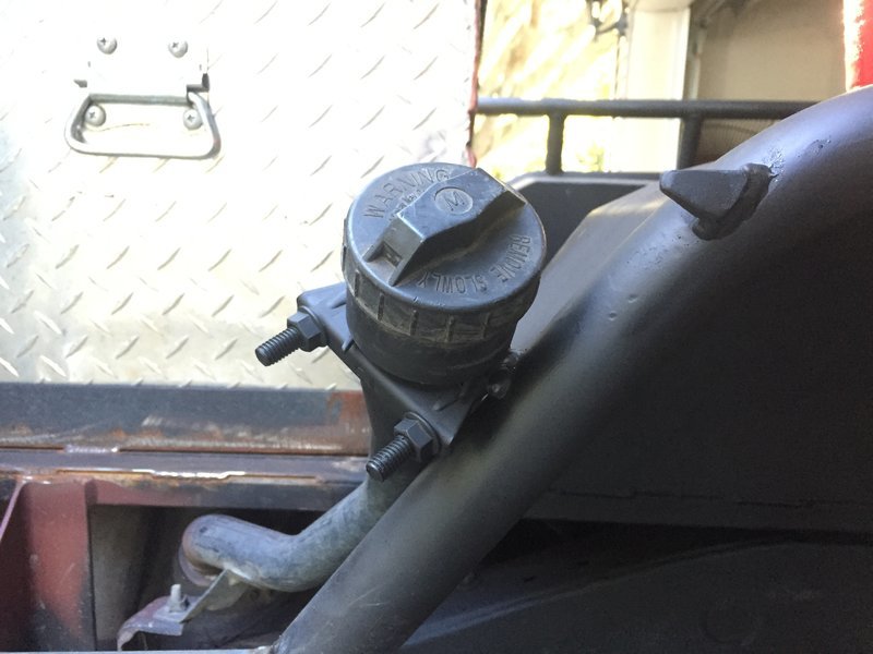

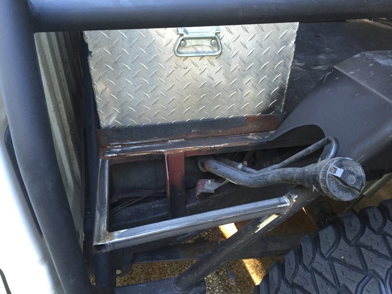

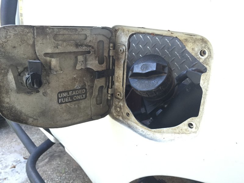

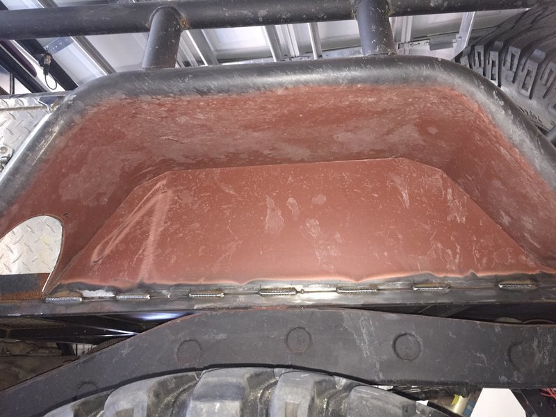

    Decided it's probably time to get my bed finished since wheeling season is fairly dead. Pulled the bedsides off today and got the gas filler neck mounted. I just used an exhaust clamp welded to the bed frame to hold it in place. That damn thing has been flipping around, not mounted properly for close to 2 years now.

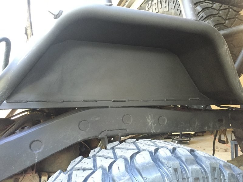

    Finished the stitch welds inside the driver fender as well as painted it. It had a coat of primer on it along with mud stains, so of course I painted right over all that :D
    Did a few other things too, I'll let the pictures do the talking there.

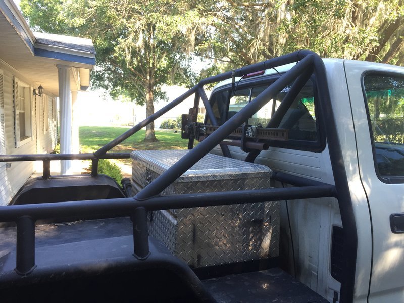

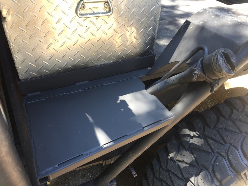

    Managed to get the bed floor put in by the filler neck. I'll be making a removable cover to hide the filler neck and to protect it. Also did some dimple die work like I had on the old setup that ties the bed into the rear crossmember.
    Finally added two more tubes to connect the hoop into the bedsides. This will add some rigidity to the hoop in case I were to ever roll it. I still have the start of an interior cage that I need to finish and install.
