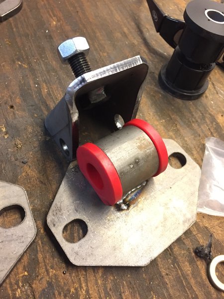

    Just finished ordering a couple parts...
    4xInnovations transfer case mount
    RuffStuff Specialties motor mounts
    Both utilize poly bushings so it will stiffen things up and prevent the drivetrain from twisting so much, which causes ripped rubber mounts and drivetrain contact with the body. I am taking a gamble with the RuffStuff motor mounts because they are only labeled as fitting 22R/22RE motors but they look identical to the Trail Gear bomb-proof mounts, minus the shit trapezoid shaped bushing on the TG mounts, and they are advertised as fitting 22R/22RE/3.4, and other motors. I think the RuffStuff mounts will fit though.
    Got some 1.5" DOM and internal tube clamps in today from Chassis Unlimited that will be used to finish the transmission crossmember. I am also going to build a mount that bolts to the inspection plate on the bottom of the Atlas that will have another poly bushing that will bolt to the transmission crossmember. That Atlas is ~140lbs.... so I want it supported. And then after that, a newly designed skid plate.

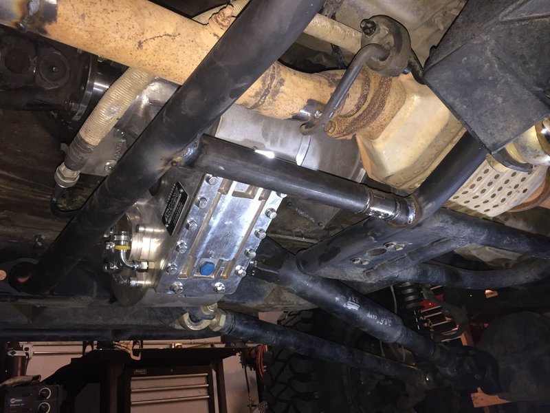

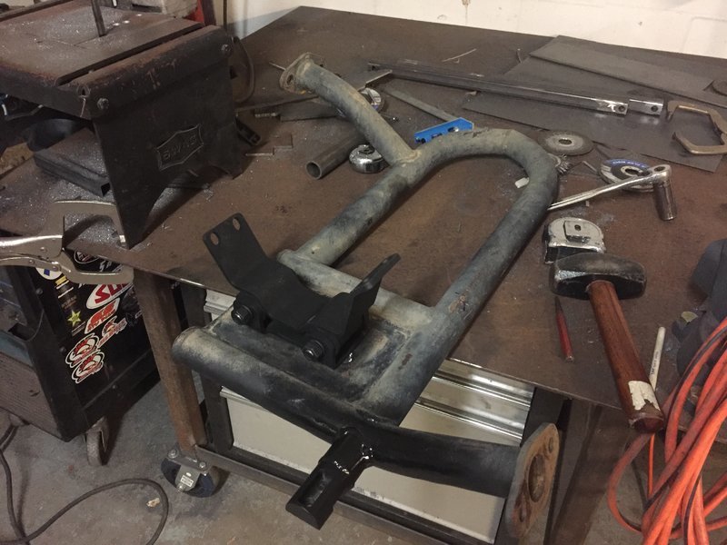

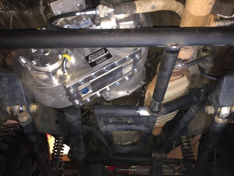

    Continuing work on the crossmember. The 4xinnovations mount is in, which raised the case and trans up a little bit, which is good and bad. Good for ground clearance, bad because it's kissing the floorboard while sitting still :facepalm:
    Also got the atlas inspection plate mount drilled out, but forgot to take a pic. Still thinking of a good way to mount a bushing it or or the crossmember to support it. Motor mounts should be here tomorrow.

    Trying to understand the pic, so is the full weight of your atlas resting on that cross member?

    No, I can see how it appears to in the first pic though. Right now it is supported by only the new transmission mount, but later on there will be another poly mount under the atlas

    Ahhh....got it; the angle of the pic threw me off :D
    Looking forward to seeing the mount you create. I might eventually want some support under my atlas as well

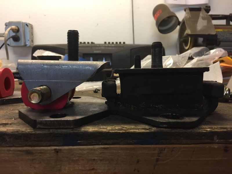

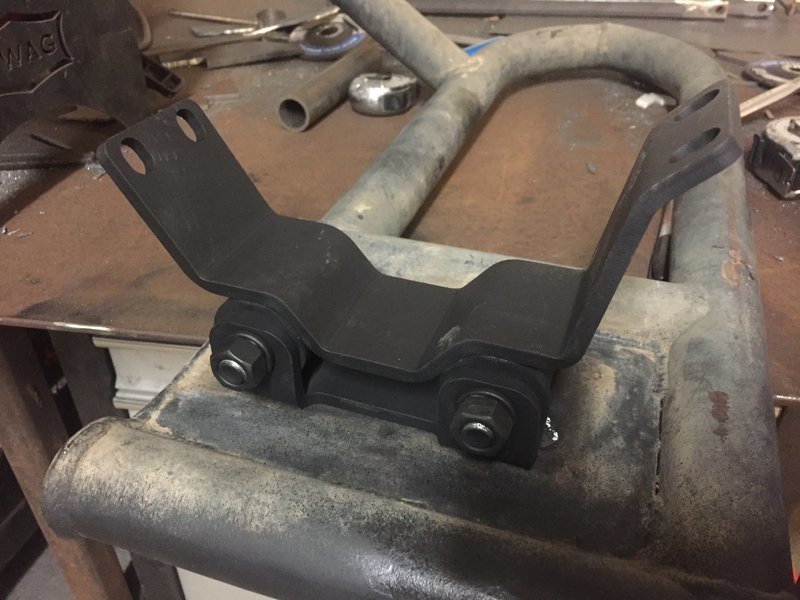

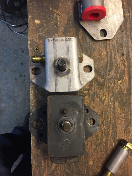

    Got the ruffstuff motor mounts installed and they are a direct, bolt-on fit (they are different heights in the first pic, but there is a plate that goes on top of the stock mount when installed, so with that in place, they are the exact same height). Took it for a test drive and the vibrations are definitely noticeable but more than manageable. No more shifter movement and it honesty feels like it is shifting better/smoother. Only thing that I need to do now is trim some more sheet metal around the twin shifters for the atlas. After the new mounts, the front wheel drive lever won't shift into high. No big deal though, it will be a 15 minute fix with the air saw.

    Man, those mounts look really good!

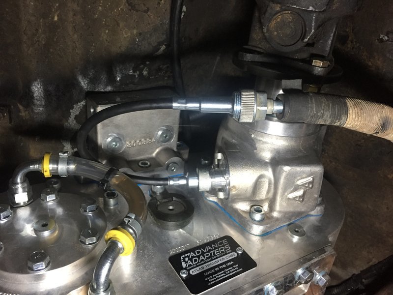

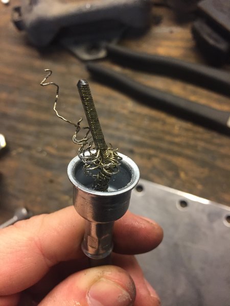

    180 miles after the atlas install and already the first breakage :facepalm:... Speedometer stopped working while on the interstate earlier. It managed to mangle itself and I am pretty positive it's from the tight radius in the speedo extension that AA provides you. They sent me two for some reason so the second one is in. When it happens again, I am going to look into converting it to an electric speedo.
    Also, still no flange from high angle driveline :mad:
