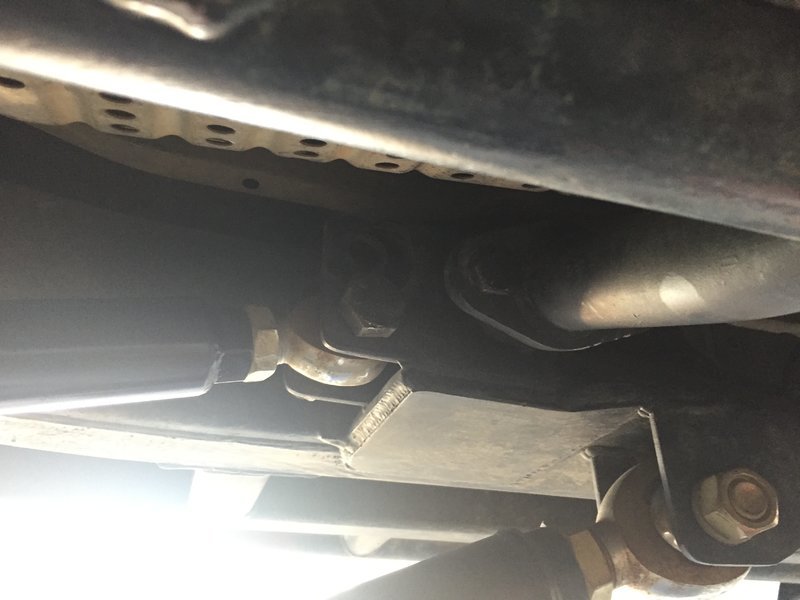

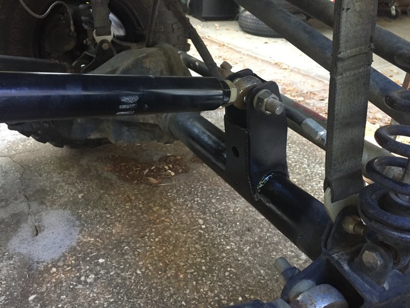

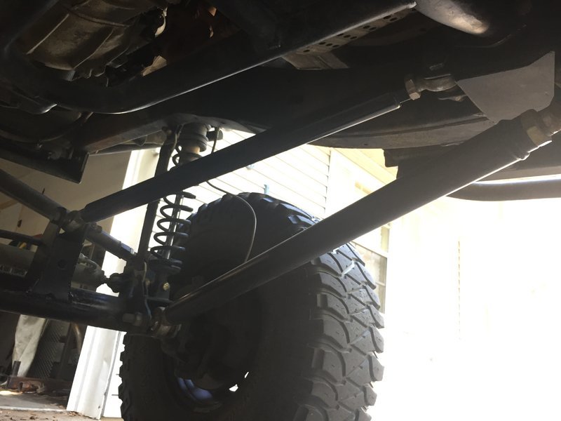

    Made some geometry changes on the front end. Chopped the upper link mount off the axle and mounted it further forward, but kept it the same height it was. This allowed me to add 4.5" to the upper link which will greatly help reduce the castor and pinion angle change while the suspension cycles. I also dropped the frame mount side to the lower hole from the upper hole.
    Castor went from 6* positive to around 3*positive. It does wander noticeably more on the road but it's still tolerable.

    I've been told many times that the more vertical separation between the upper link and the lower links the better. Were you also thinking about making that upper link bracket at the axle end taller?

    To an extent, I think that is true. I liked the way it was height wise at the axle, just needed that upper link longer so I kept the height the same.

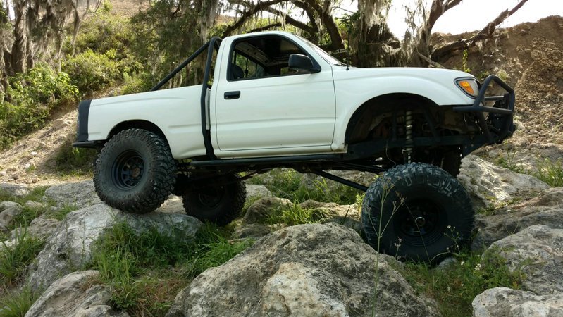

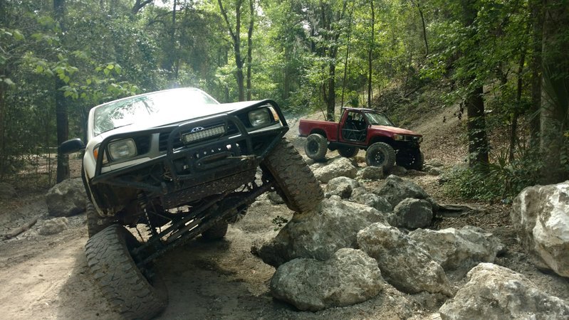

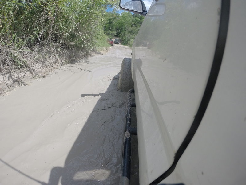

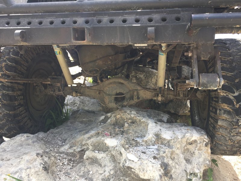

    Trip report from Hardrock today, 4/30
    First time out with the Atlas and I was not disappointed. It is awesome to have so many gearing options with the 5 speed transmission. No major breakage, just some rock rash on the sliders, rear bumper, rear diff, rear traction bar, wheels, and tires. And I broke the zerk off the front shaft u-joint. No biggie though...

    Seems like he really doesn't need them. He followed a guy on 37s or better around and did everything that guy did while I was there...well, except for one hill that I tried and got denied on and Todd then tried it and got to the top and decided the final ledge was a little too sketchy-feeling. The other guy (can't remember his name...help me out, Todd, haha) climbed right up it and made us all look like chumps. At any rate, 37s would just be causing him to break more shite with that D44 front axle. :D

    Robert was the name. I really wish you would have stayed for what we were hitting after you left. We both went to that larger rock garden that is right up next to the mx track. He went up it no problem and I had to winch out. I tried a different line after and made it after some trouble. We've got video of everything, just having trouble transferring them to my phone from Josh's.
    Oh and Robert tried the peanut butter and jealous hill and made it to the very top and was denied. I had to go around to the top so he could winch off of me. I didn't even bother attempting that hill lol.
    35s will be the biggest these axles see. It's a good balance point between width, height, tire size, and the parts I have. I won't even look at a 37 without a one ton.
    And on another note, I finally like the 63's. Cutting that third leaf down worked wonders and it rode almost as good as the front.... Almost.
