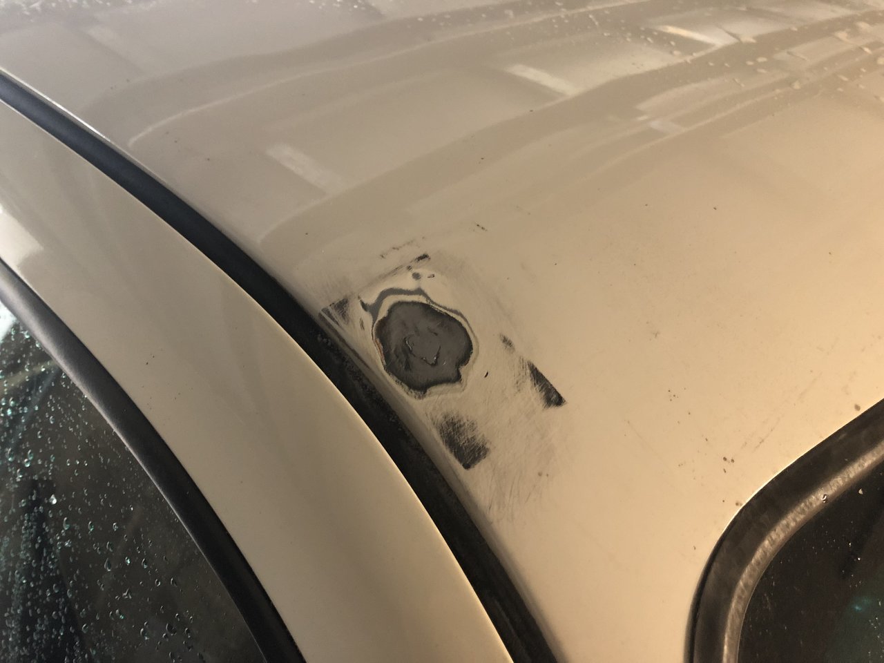

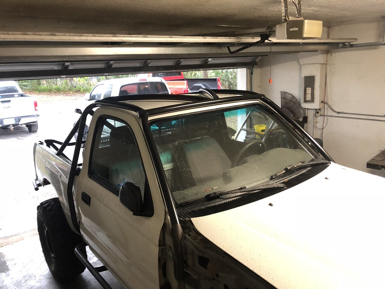

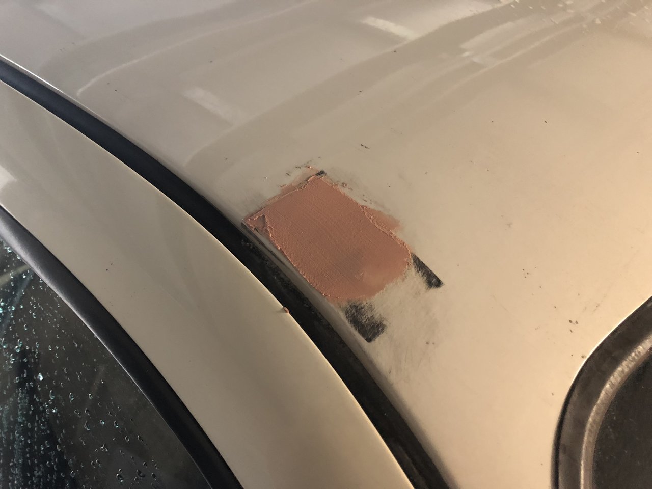

    Had a more productive day than I planned today. I plug welded some holes a couple years ago that the old owner put in the roof for a light bar. I never put Bondo on them, and the paint I used was starting to show some small rust spots, so I sanded them down and did some Bondo work, sanded them down again and put some automotive-type spray paint on them.

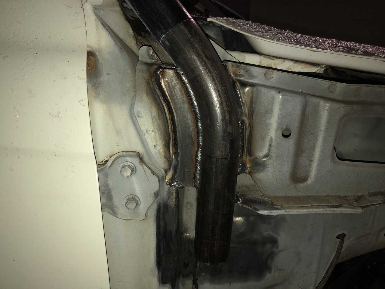

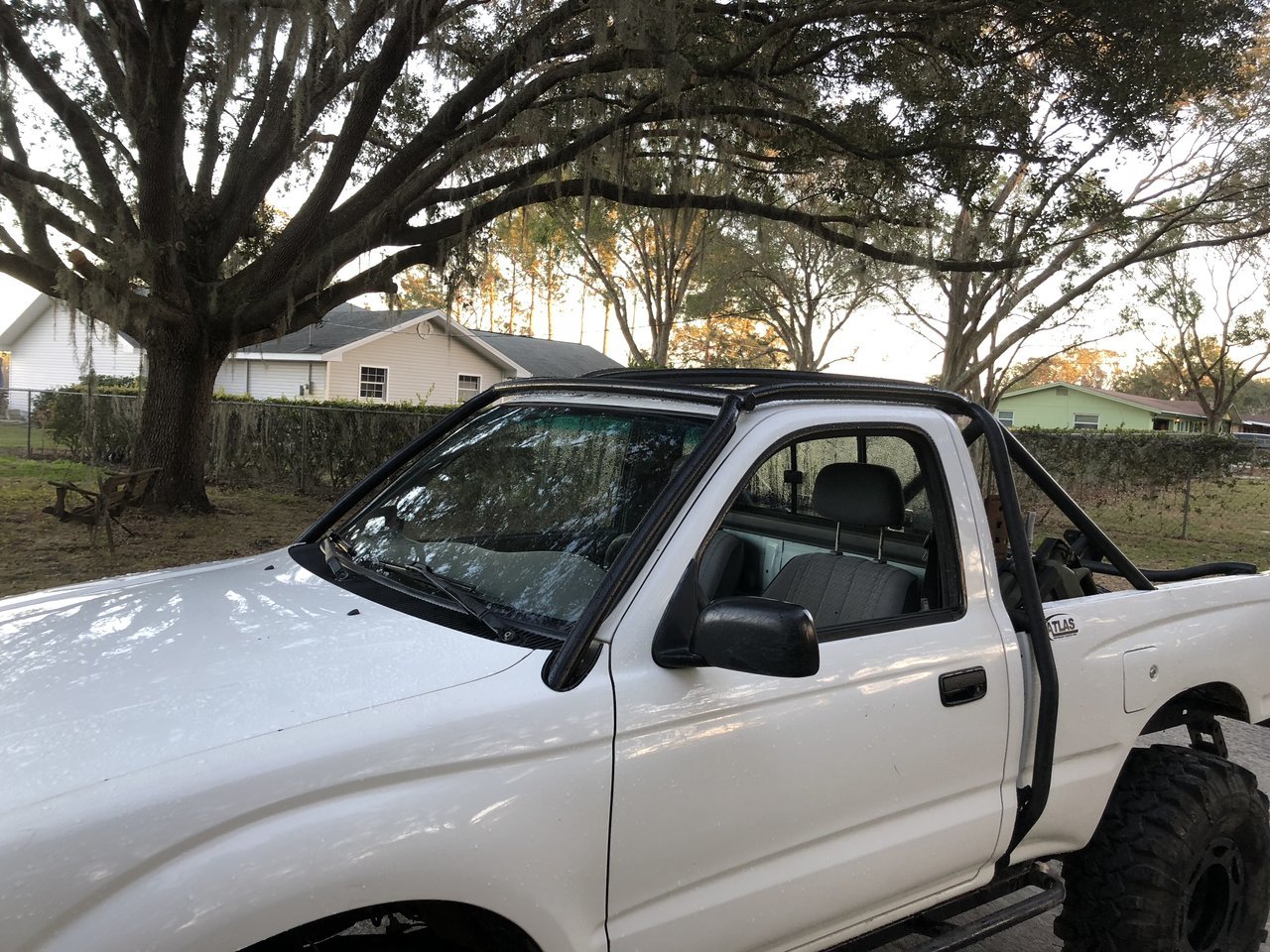

    Pulled the cage last week and finished the welding and painted it with some tractor implement paint with a brush in an attempt to keep it from needing repainting down the road.
    Got the cage put back on and mostly welded up. I'm going to do a lot more playing where it attaches to the inner fender.

    I like the rolled tube and your body tie in is way cleaner than mine! I've just got as much weld as you can get along that seam on each side
    allenfab[OP] likes this.

    Thanks man, even though the driver side is much worse :D. I fucked up the bend that goes into the fender so it's not perfect, but since it will be covered by the fender, I let it slide.

    Ha, I did the exact same thing on one side of mine too. I was running out of DOM and it became good enough because it was going under the fender

    Surprised you didn’t do one above the wipers to tie the corners in

    You can’t do a bar there because of the way the hood swings. It’d have to be like 6 inches up off the windshield to clear

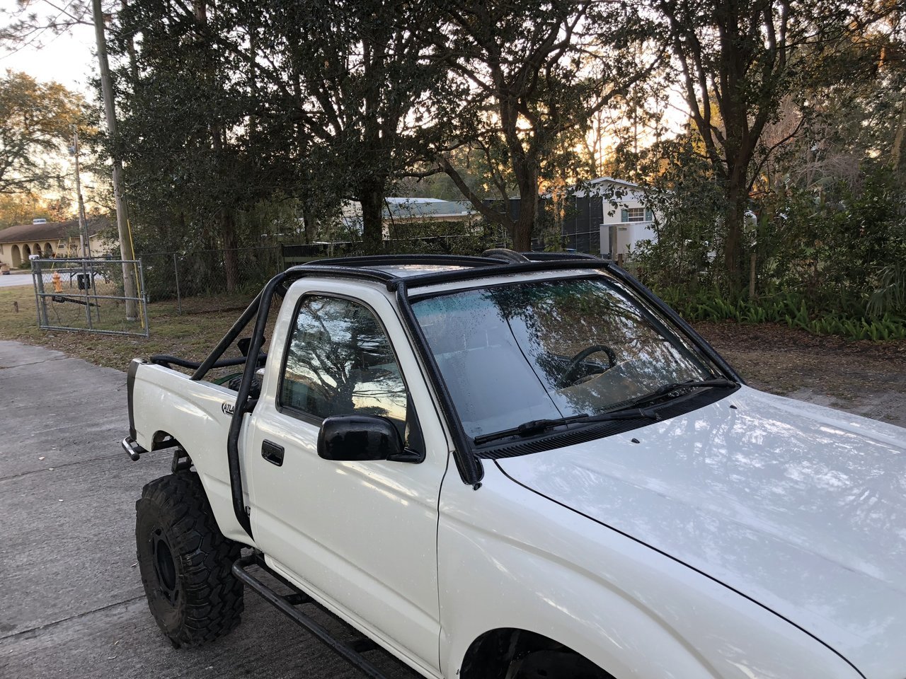

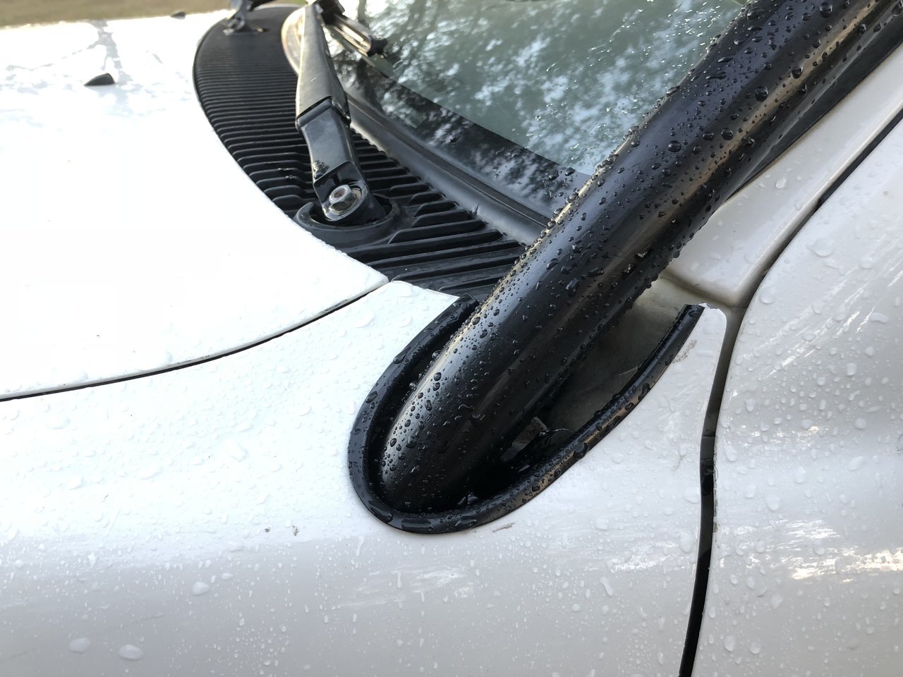

    Cage complete. Now on to getting the new steering pump and resi installed...

    So clean looking

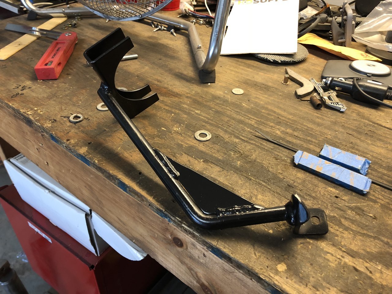

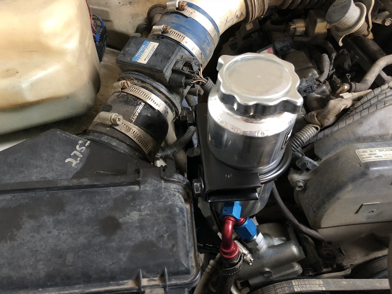

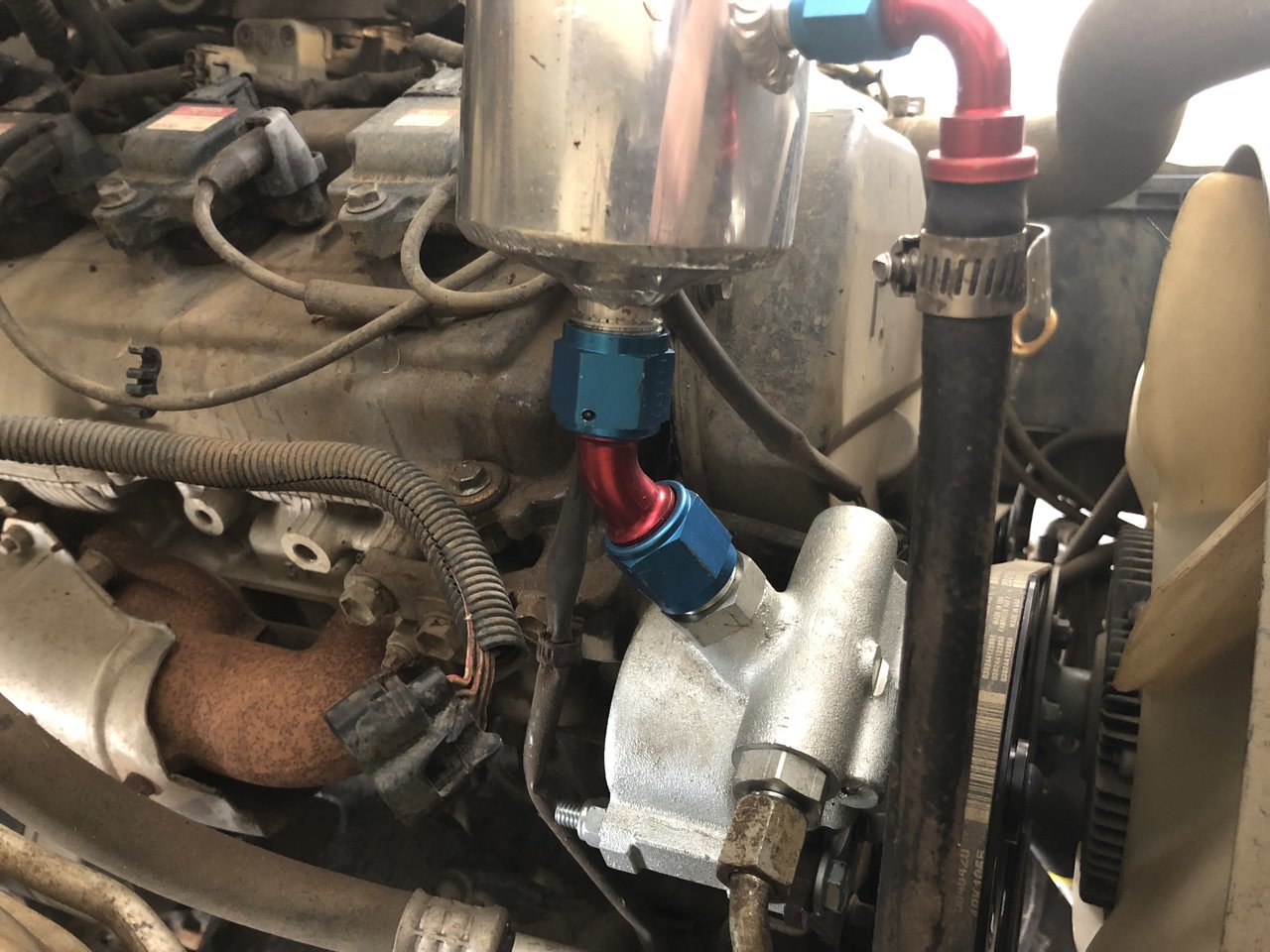

    Trail-Gear pump and cheapo resi installed. Mounted them directly together for the best flow possible and made a bracket to help keep things a little more sturdy. So far, not too impressed with the pump as it doesn't feel any better than stock, but that's just with street driving and limited 4wd driving in my yard. Time will tell how it works though....
