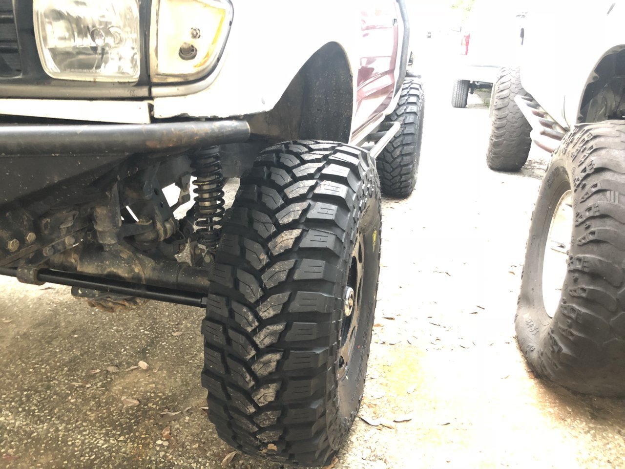

    Got dicked around by 4 wheel parts on a set of razr's, so I ended up with a set of trepadors... Which it was a toss up between the two anyway

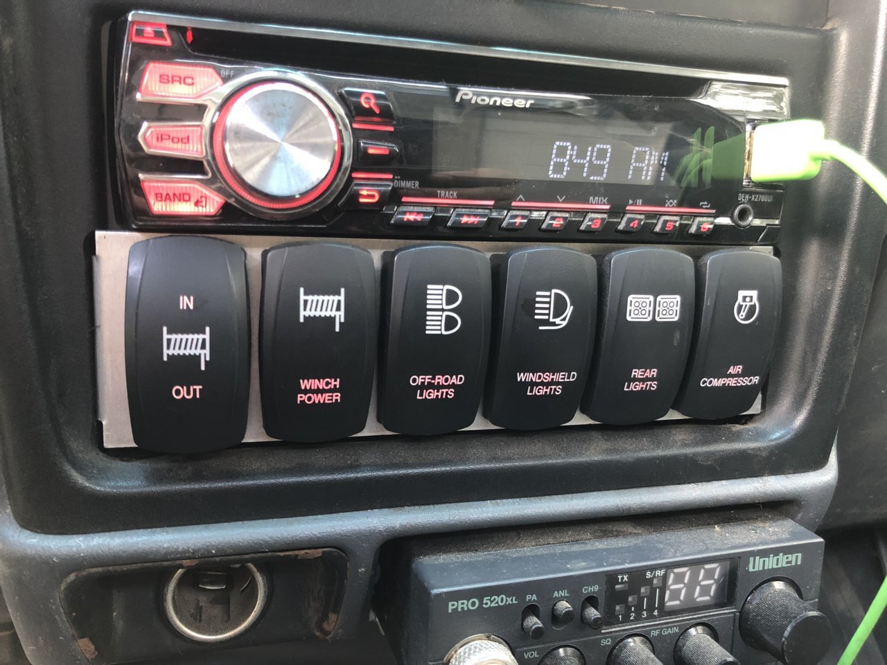

    Switched up the switches a bit. Removed and replaced the rock light and inverter switch that I had that weren't being used and added winch controls and windshield lights which will be installed sometime in the next year. And another pic of the new Trepadors

    I like the next year part:rofl:

    Just being honest lol.
    I did buy another rocker for "bed lights", so I can just swap the rocker itself on the switch if I decide I want to put these old lights on the bed. I'm undecided....

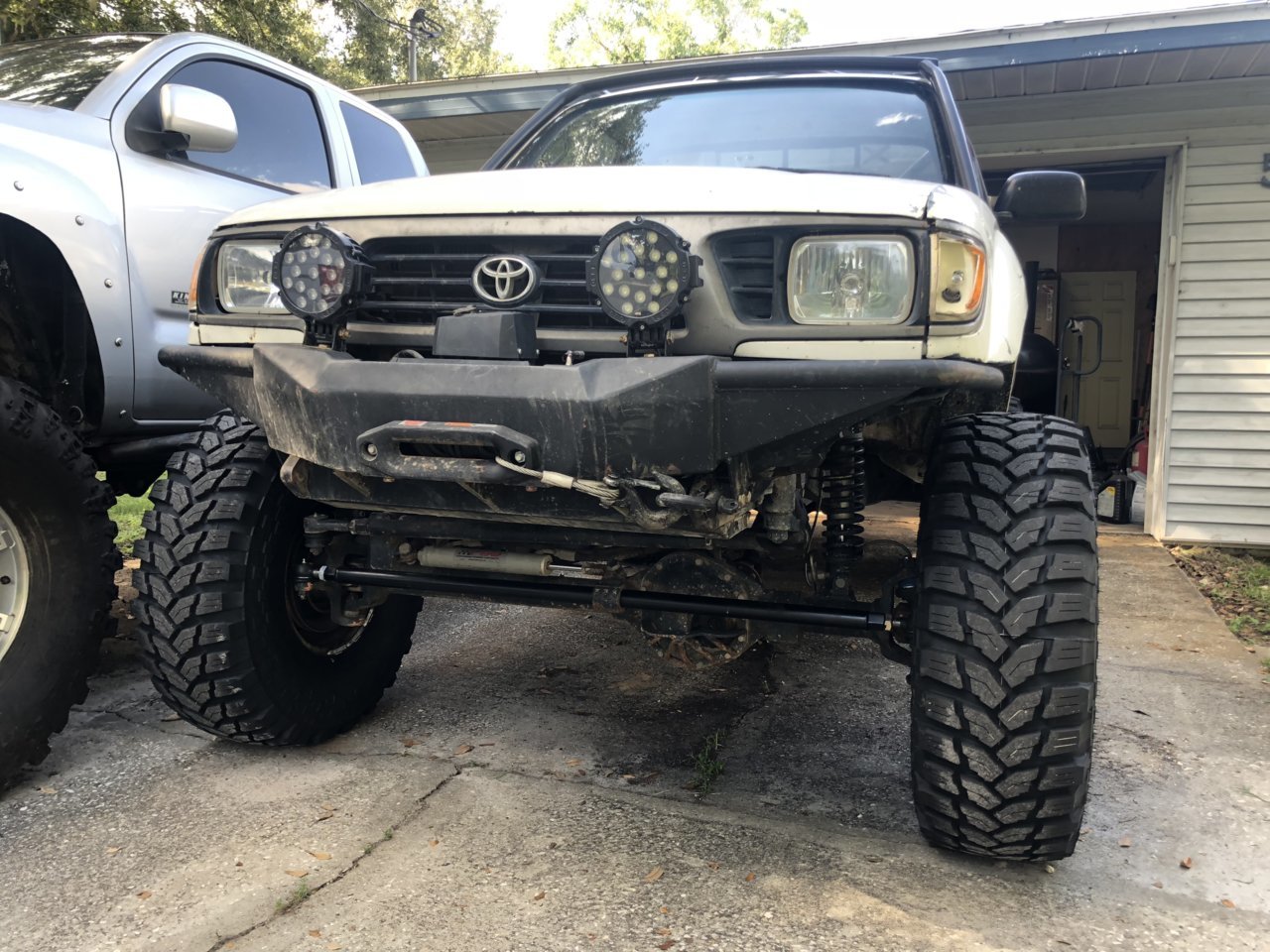

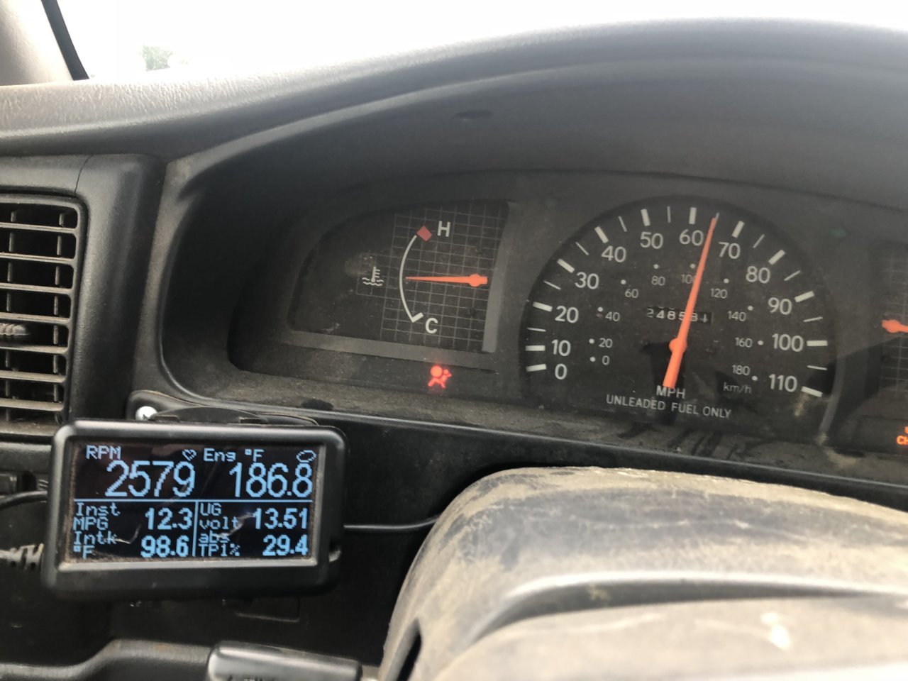

    Rechecked my Homebrew alignment and it was about 3/8" out of square from front to back. I got it down to 1/4" just by shortening the panhard bar by a few twists. The front passenger tire was about 1/2" further out than the driver side, but now they are the same. I know I'll never get it perfect, even if I had a professional do it. I took it for a spin after and it did seem to track a little better at all speeds.
    These tires are sweet at high speeds. They rode great at 65, but I didn't push it any faster as the RPMs are up there at those speeds.

    Cool deal. Is the speedo right now?

    The speedometer is a little off, but not by much. I didn't have my GPS with me so I couldn't compare. AA did a pretty good job getting me setup with a near perfect speedo calibration

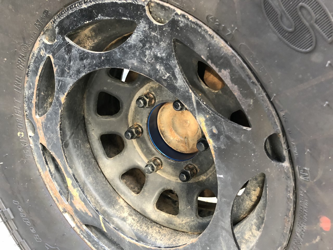

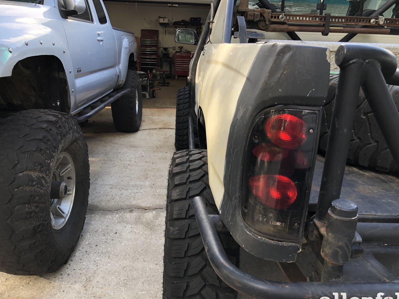

    Adjusted my drum brakes to the point where they are actually engaging and this thing is stopping better than ever before. I'm not sure the self-adjustimg levers or whatever they are called are actually working, so I may just have to adjust them manually every so often.
    Also decided to finally throw some 1.5" spidertrax spacers on the rear to match the front width. The front axle is 64.5" wide and the rear is around 60.75", so these spacers brought the width out to damn near perfect.
