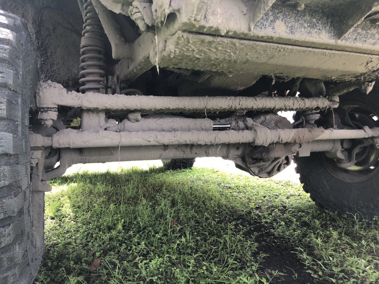

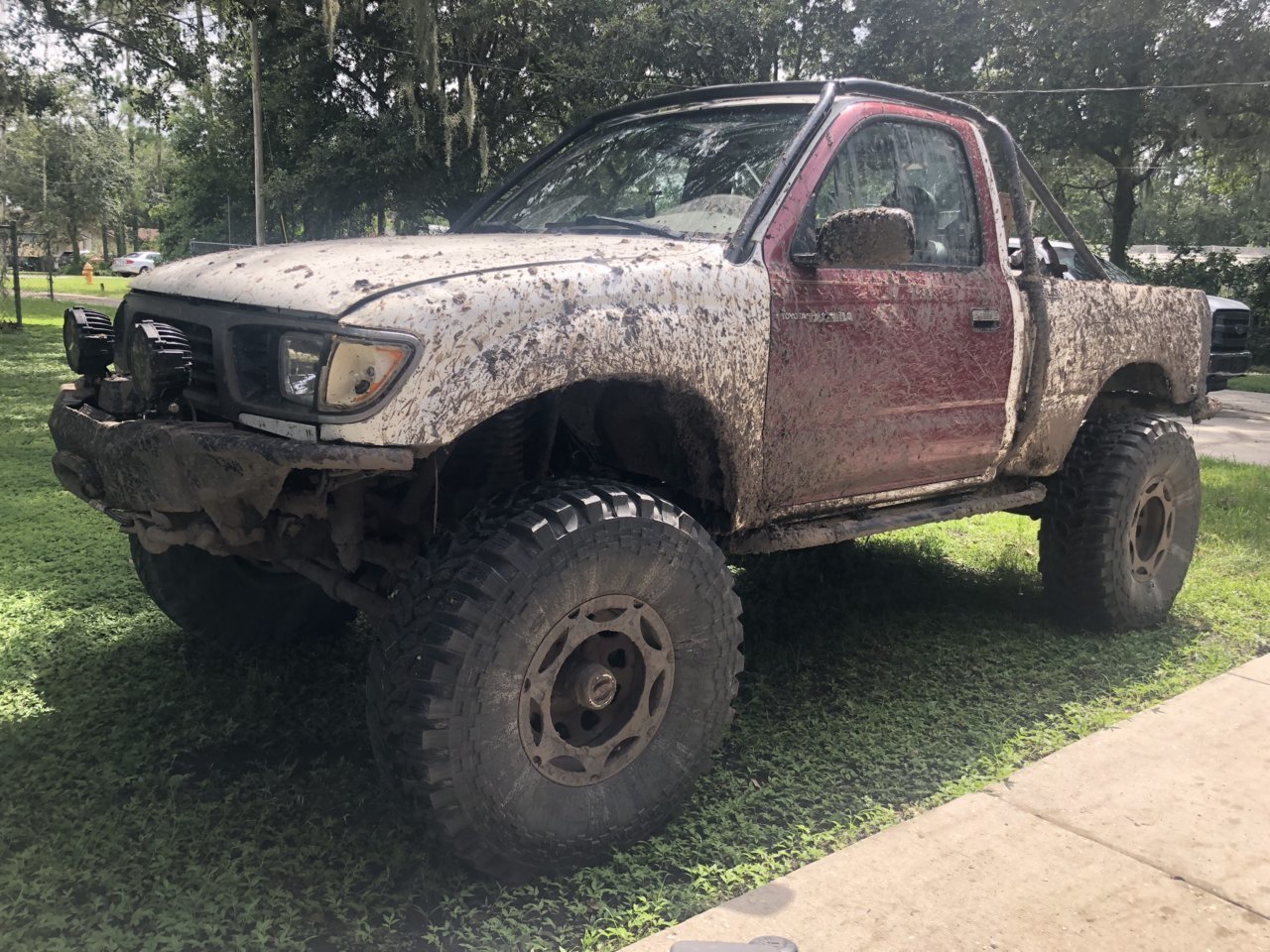

    The Trepadors did great in the mud I was in yesterday, no complaints whatsoever. They clean pretty good with very little wheel speed and they don't fling gigantic chunks everywhere like the ltb's. This is the last time this thing will be wheeled predominantly in mud. I do not miss cleaning this shit.

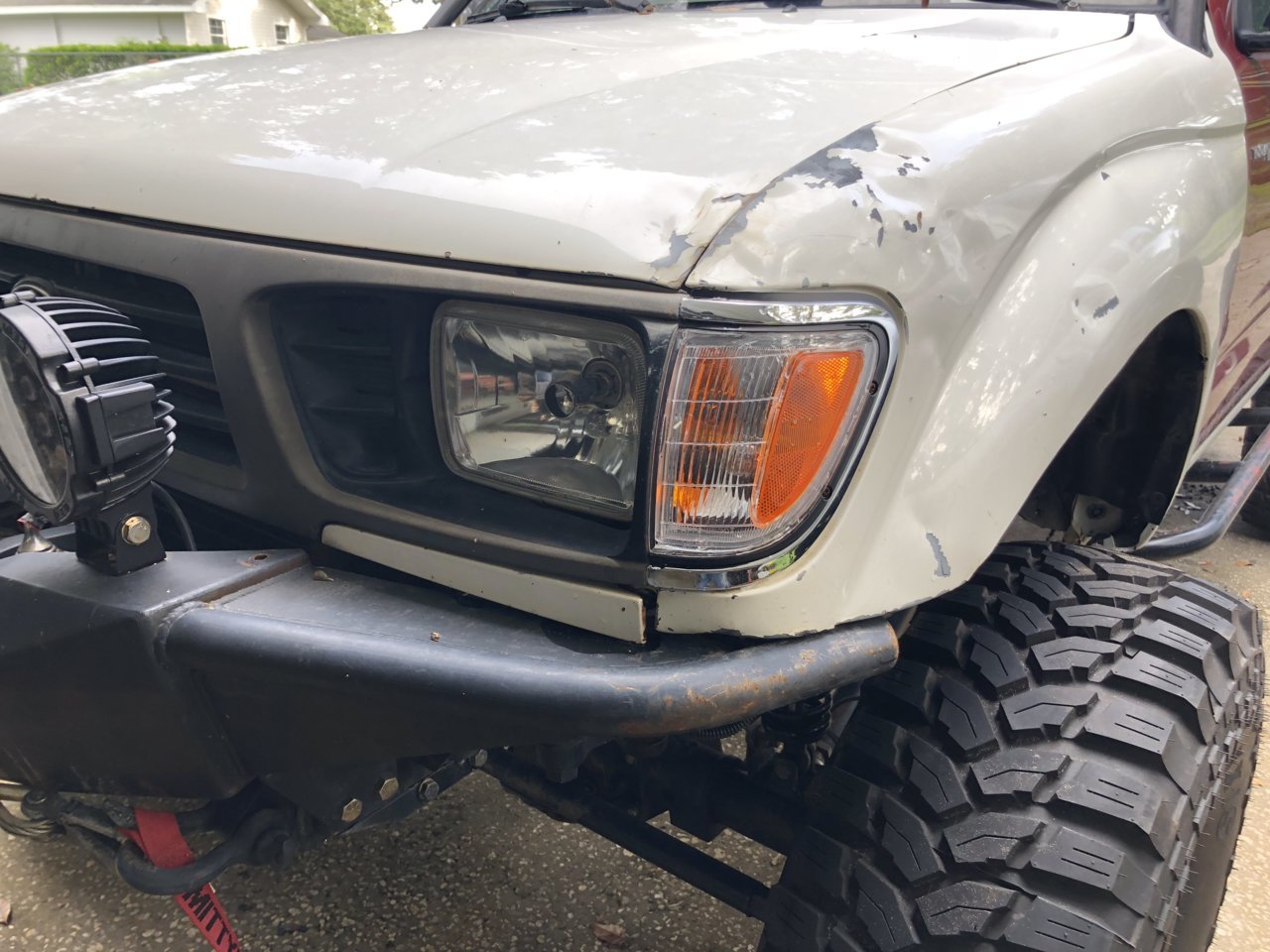

    Got some new chrome corner lights that don't match the grill, but look at the truck now, it's the least of my worries

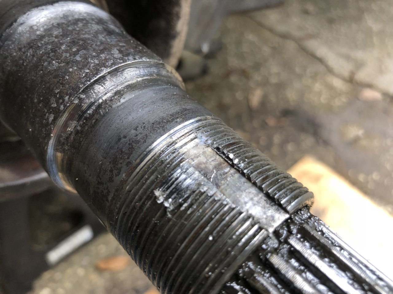

    Also need to source a new spindle.... This one is pitted, especially on the hub seal surface which is letting shit in and because of that, I had to replace the bearings on this side for the third time since the swap. The other side still has the same bearings from the original axle build. The threads also are trashed as seen in the picture...

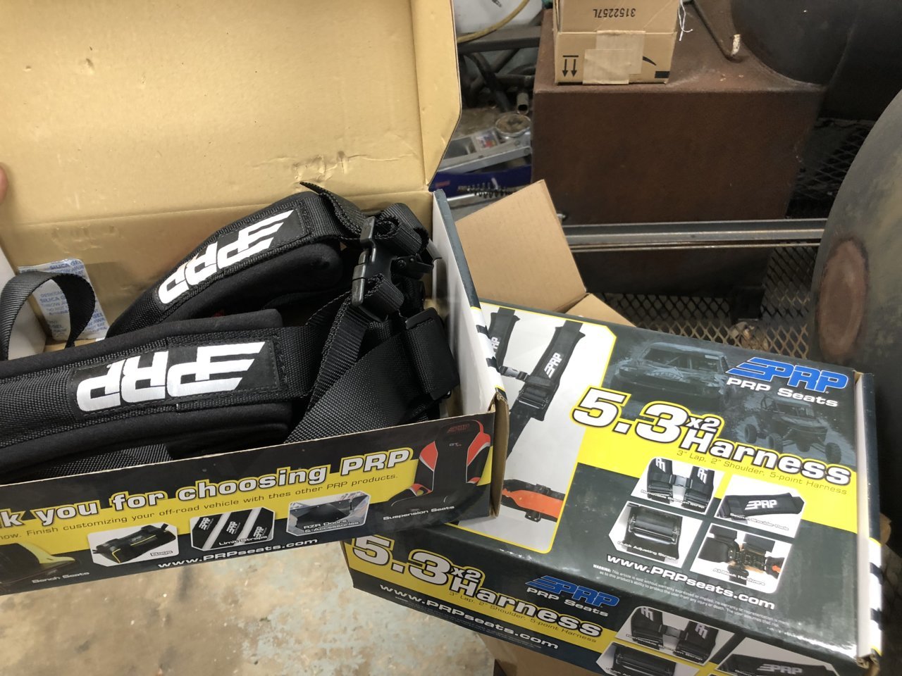

    New harnesses to replace the junk factory belts. This will prevent me from killing myself the next time I roll hopefully

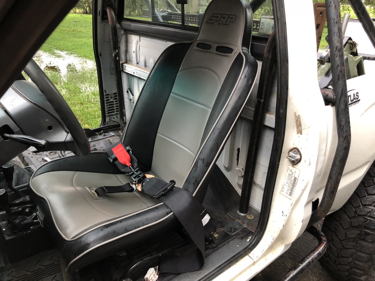

    Got one lap belt/sub belt installed. I have to do some brainstorming on how I am going to run the tube for the shoulder harnesses... It's a pretty straightforward thing but there's not much room to work with, and it has to be able to disconnect in the middle so the harness bar/frame can be removed in the future.

    The lap belts are attached to a small internal cage/bar that is tied into a factory seat bolt, factory seat belt bolt, and body mount bolt on the floor on each side. The upper part of the cage is bolted to the factory belt mounts on the b-pillar (I'll have to take some pics).

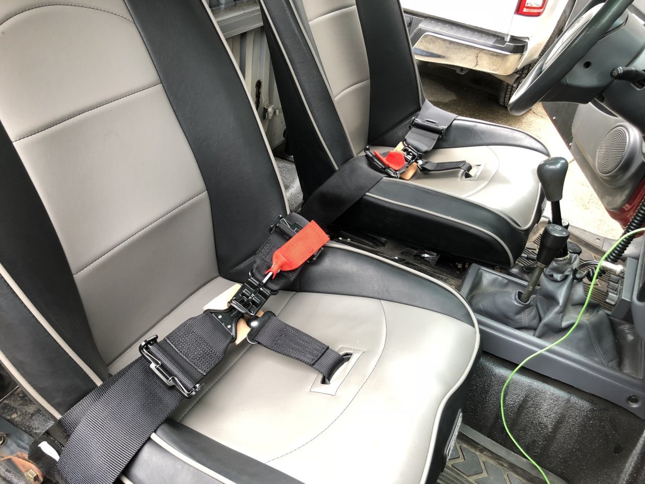

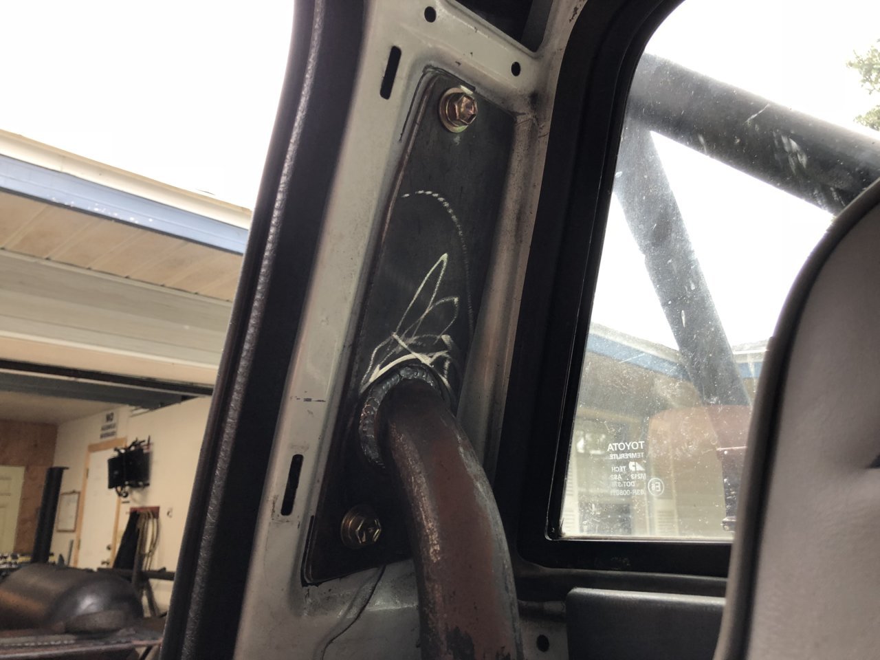

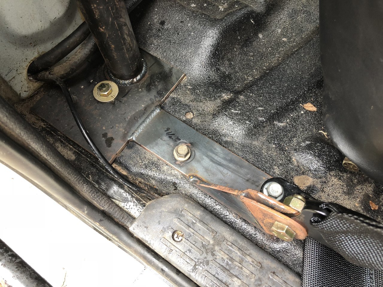

    Got the passenger side lap and sub belt in today. This will be sufficient for a wheeling trip without the shoulder harnesses while I get that part figured out (I doubt I'll really use the shoulder harnesses much anyway). Also a pic of how the side bars are tied into the cab. A tube will spam across both of these just a couple of inches below the shoulder strap slots in the seats and those straps will simple be wrapped around that tube once in. Then, I will just have to pull everything out to clean up and paint.
