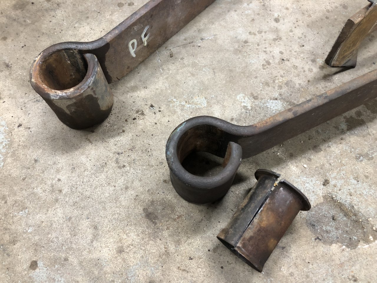

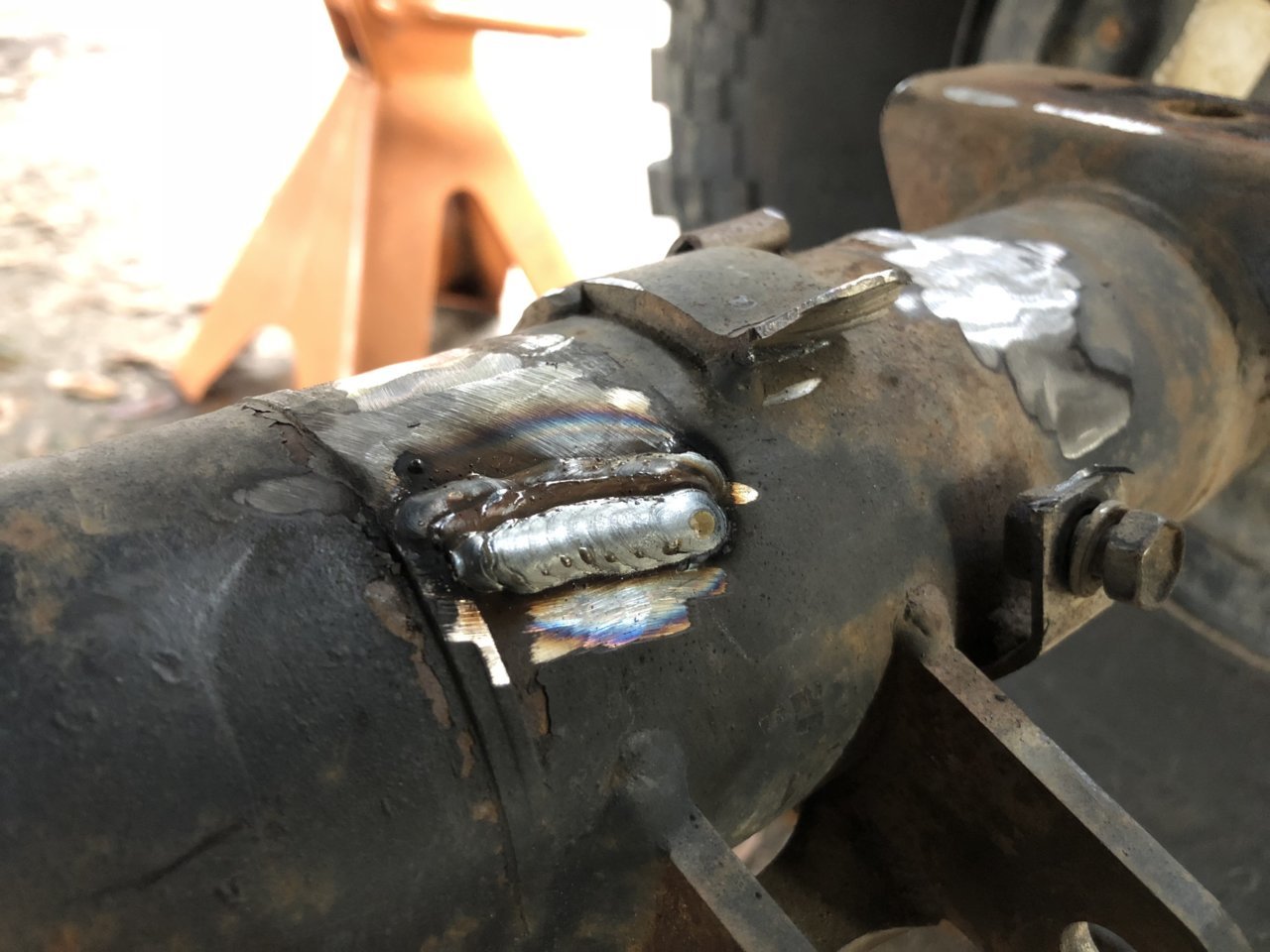

    Time to freshen up the rear suspension. New bushings in the 63's and I'm adding back a third leaf and removing the overload. The traction bar is being removed completely as it was binding and with it's non-adjustability, I wasn't going to be able to make it work. The traction bar bracket on the axle cracked and began to peel up on the housing, so I ground out the crack and added some weld. I'm going to knock off the factory spring perches and weld on the ruffstuff "anti-wrap" perches that I've had on the shelf for years. Hopefully that will be enough to prevent most of the axle wrap.
    I'm also tossing around the idea of trashing the brake hard lines and doing braided flex lines to clean things up and get them up more out of harm's way. Still undecided.....

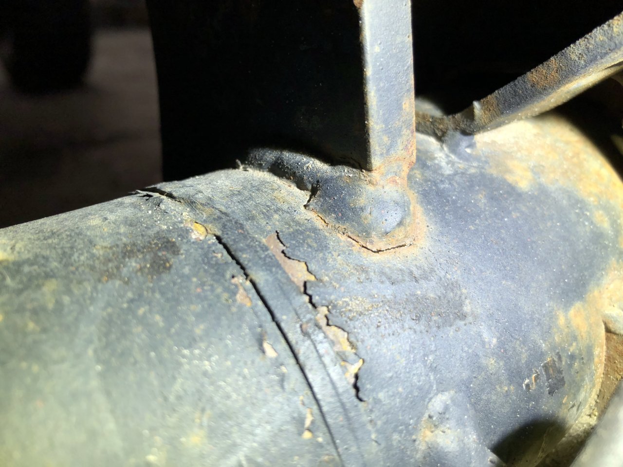

    I’m guessing you’ll want to add a traction bar back on again. Anti-wrap perches aren’t enough to keep my rear from wrapping. A bar is night and day for me on AP mini-truck springs

    You're probably right, and I'm anticipating that I will honestly. I'm going to wheel without it and if the axle wrap is extreme, I'll build another bar.
    I've already got a design in my head that I believe will be better, and I'm going to make the axle mount higher than the old one to keep it out of the rocks more.

    Glad I’m not the only one that has struggled to keep my bracket from tearing the axle housing. Makes you appreciate the amount of force put on an upper link for sure.

    Now that I have slept on it, I will probably go ahead and add one back and skip the hassle of changing the spring perches. I think I will go ahead and move the traction bar closer to the center of the axle too. I think mine was too far to the passenger side.

    Yeah, I can tell you the perches help a little, but you still get a little wrap with them. ;) Of course, you could use the perches AND the bar and maybe take a little stress off the bar. I would say definitely move it inboard though. Use it to protect your driveshaft as well. :thumbsup: That's what I was thinking on when I did one.

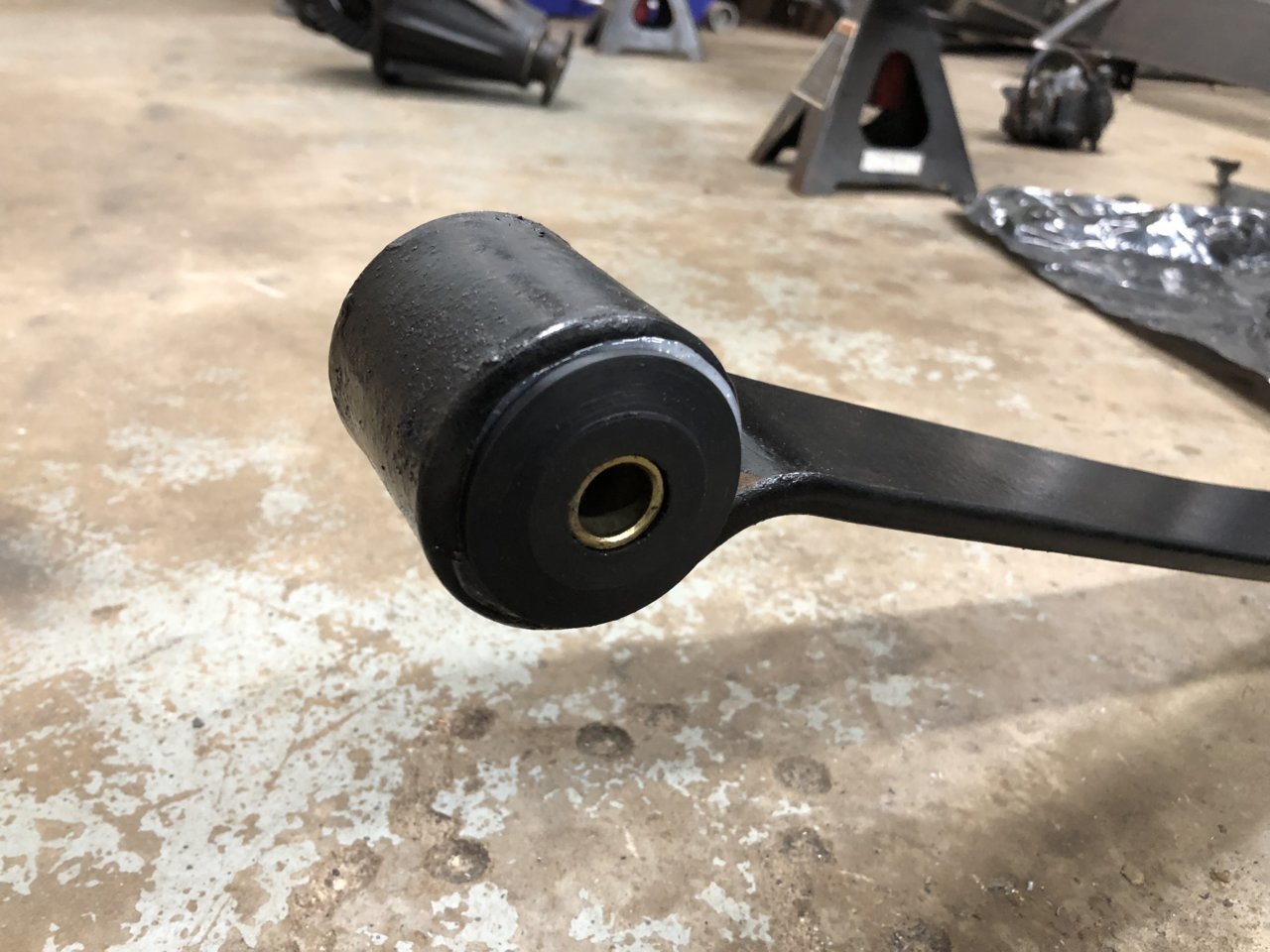

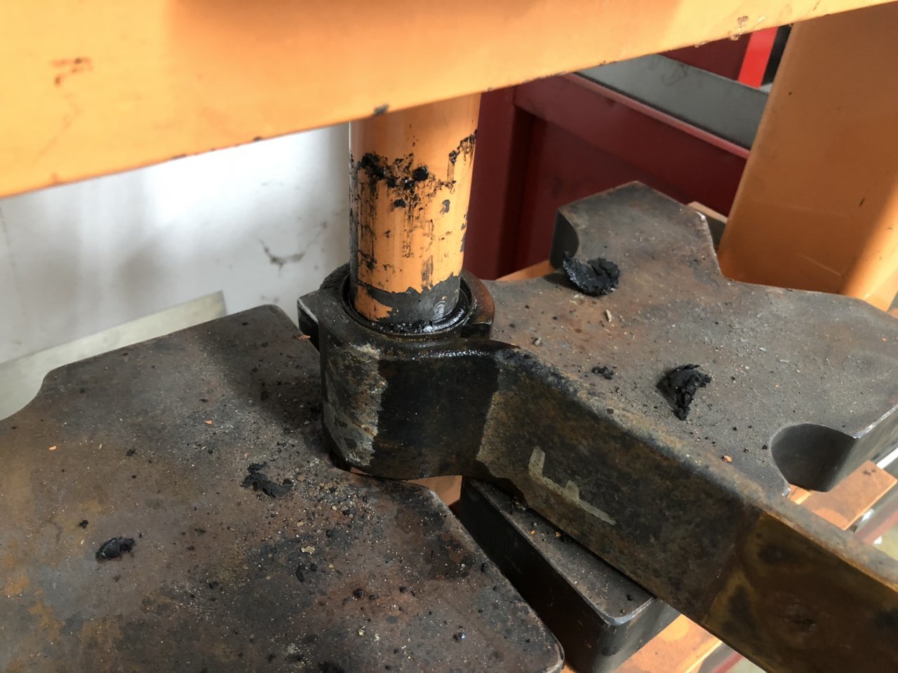

    The "new" old 63s are ready to go in, complete with new bushings, spring pads, and a slick coat of paint

    Nice! ...but is that a 4runner axle in the background there? Work for someone else or are you planning a disc conversion for the Q-tip?

    I'm going to play around with it. It's literally the perfect axle for my truck.... disk brakes, 64.5" WMS (exact same as my front axle), same spline count, but the differential is an 8" instead of the 8.4". I really wish I could just swap the whole axle in but I wasn't that lucky. It was free, so if it ends up I cant use anything off of it, I won't take a loss.
