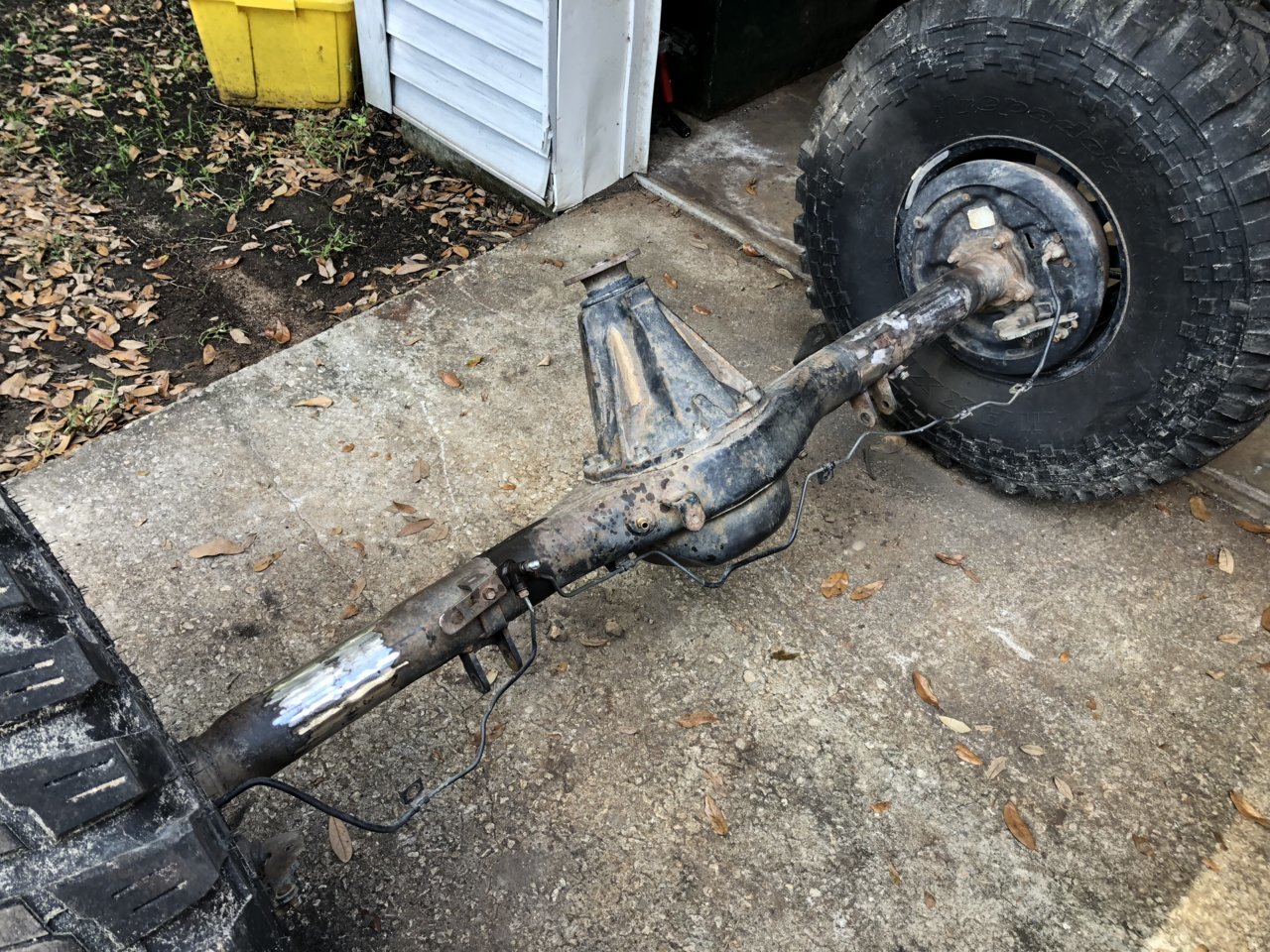

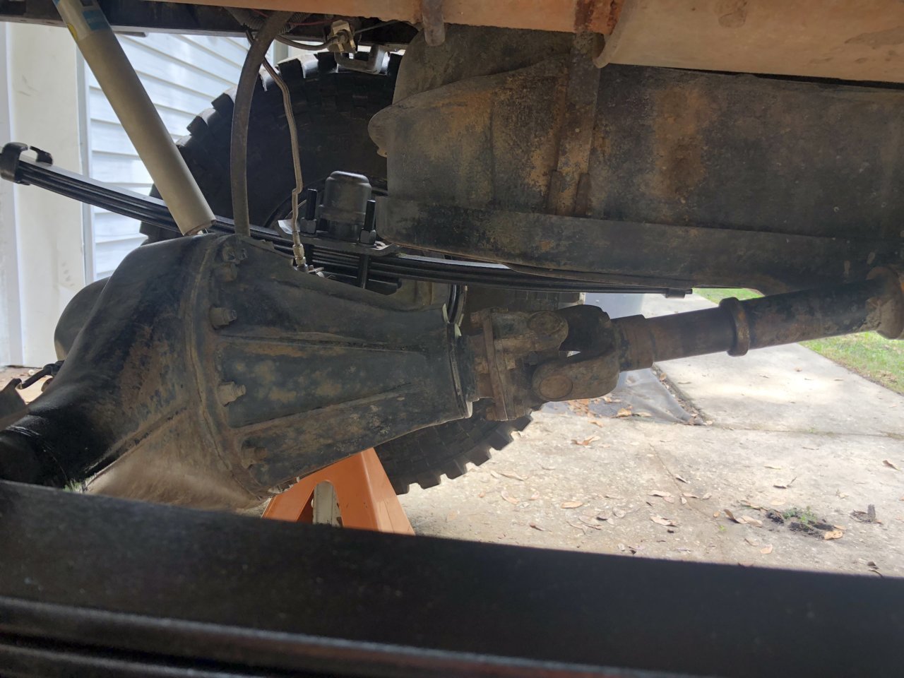

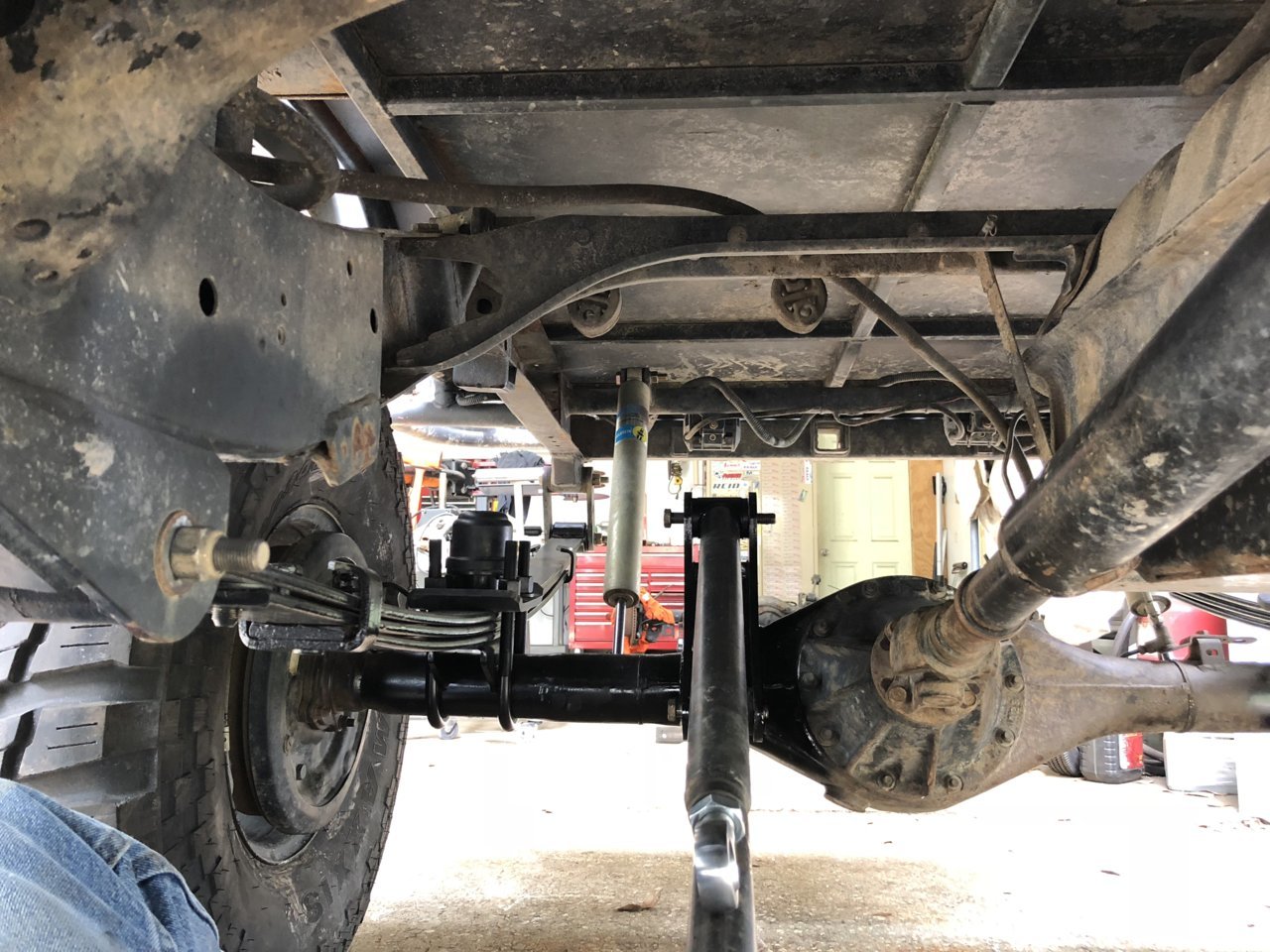

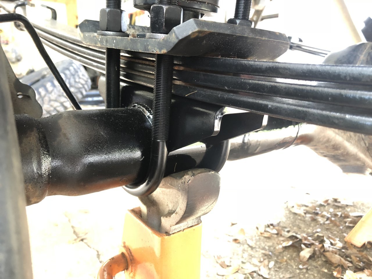

    Weekend update... New perches are on along with u-bolts and pinion angle corrected. Ordering new brake lines this week and then on to the traction bar
    FB8E5542-9604-43DB-871D-E5712B0E1ADA.jpg FBF6F38C-2638-4797-944D-9B501B7D3CE2.jpg D86362A8-D142-4A8F-B1B4-F897249B592E.jpg

    Does the angle of the 3rd member affect how the gears lube themselves?

    I'm going to piece together some from summit racing. I'm just going to do all stainless braided from the frame to the wheels.
    Probably to an extent. Idk what the max angle is before the pinion bearings start to get starved for fluid but I think I'll personally be fine. Pointing the pinion directly at the t-case output is suppose to be ideal for a double cardon driveshaft to reduce vibes, so we will see if I notice a difference. I mainly did it for the extra clearance to keep it away from the rocks

    As long as you aren’t doing anything crazy it doesn’t. The ring gear flings oil up to the pinion

    Theres a video out there where a guy has a clear diff cover showing what the gears actually do when spinning, basically shoots oil everywhere in there no matter what.

    I figured that was the case. Just wasn’t sure if there would be long term effects or not. Probably gonna have to do the same thing when I swap to D60’s.

    Good choice, I got my d60 pointed at the pinion with the same perches todd has and no vibes at all back there.

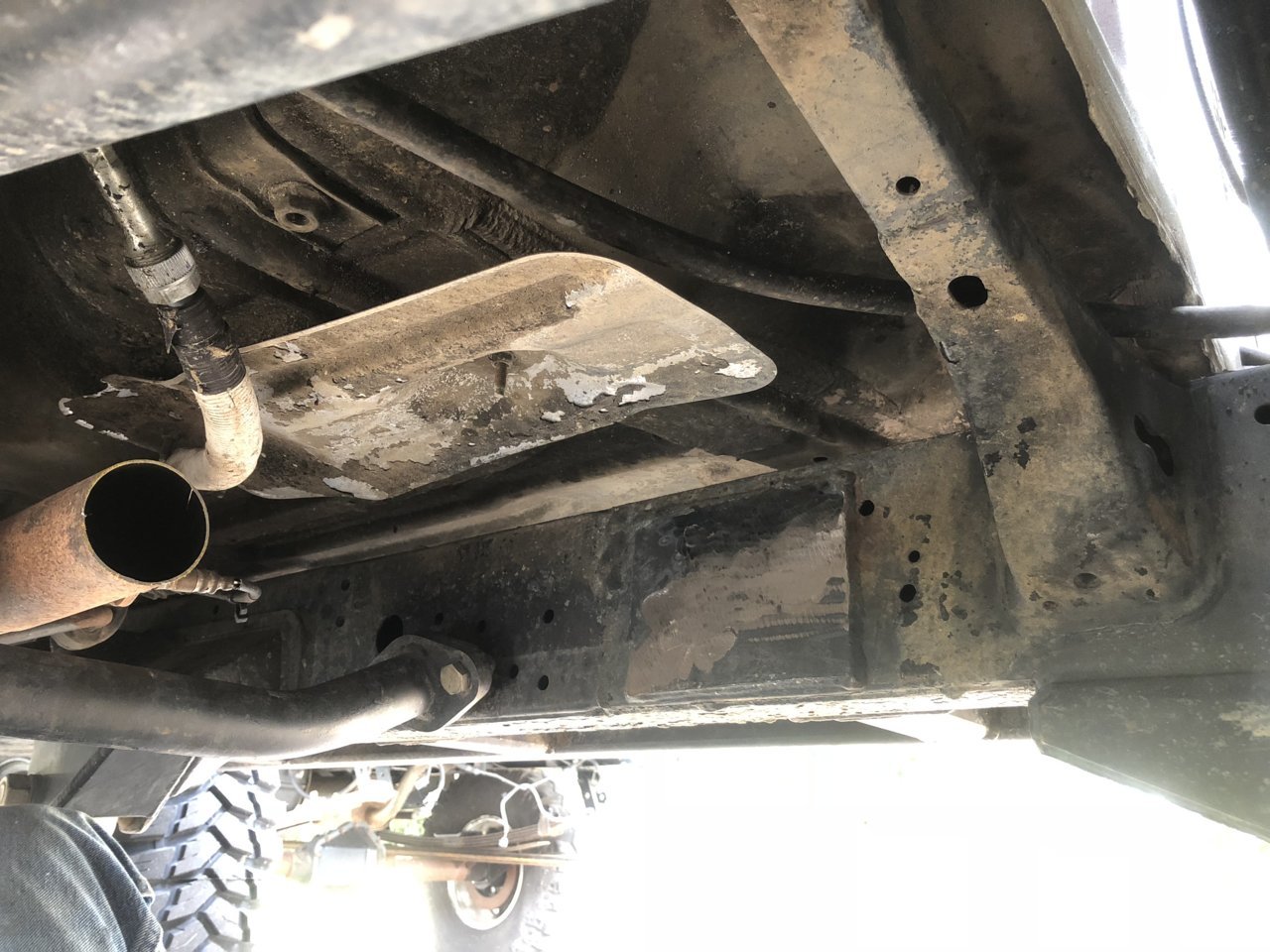

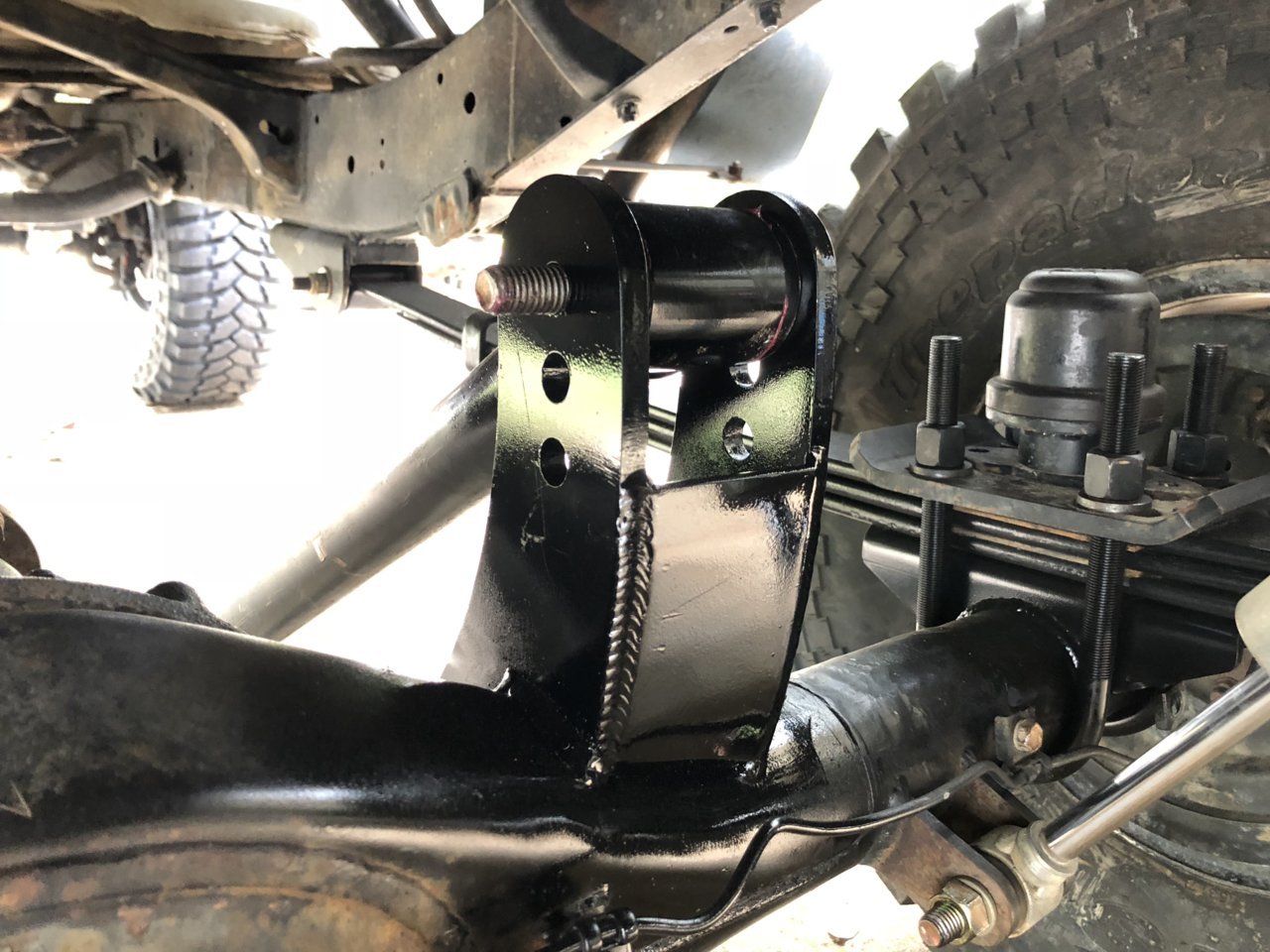

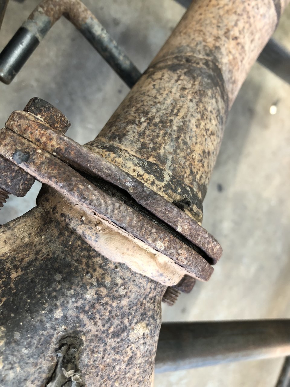

    Weekend update...

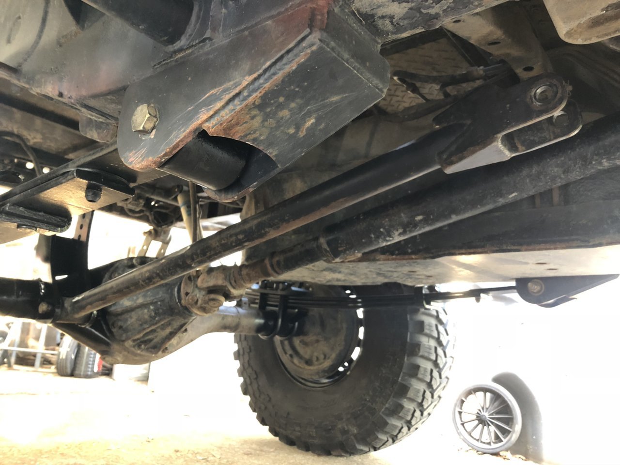

    I welded the new traction bar bracket onto the axle which I moved toward the center of the axle... Probably 4 or 5 inches closer than the old one. I got the old frame bracket that held the shackle cut off and cleaned as well as removing the exhaust up to the downpipe.
    I think I'm going to look into replacing the entire exhaust, including the cat, with something quieter. The flanges on the cat are really pitted, and the cat has 250k miles on it. Plus, a smaller cat would be easier to fit in what little space I have left under the truck.
    I also have another bad wheel cylinder on the passenger rear... I'm getting tired of replacing those.
    C6B8FFCE-9205-41E1-AA0C-D721CAD5D054.jpg 97C683E8-2F2C-4875-882D-9A2A4A4F68A8.jpg A0C46D28-55BB-4A7C-82B6-3990BFE62727.jpg FAB13050-E7E5-4217-8A33-D0CCEA7C655F.jpg EEB35D13-D5E8-4B52-81CC-5279F4061A8E.jpg

    17 4Runner TRD OR
    Modded it so much it turned into a 4Runner
    Just run without cats and dummy plug the o2 censors.
