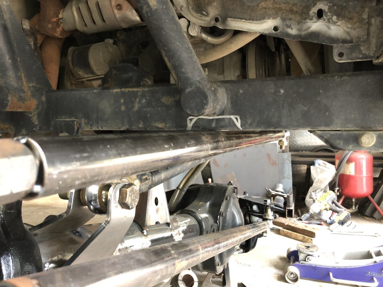

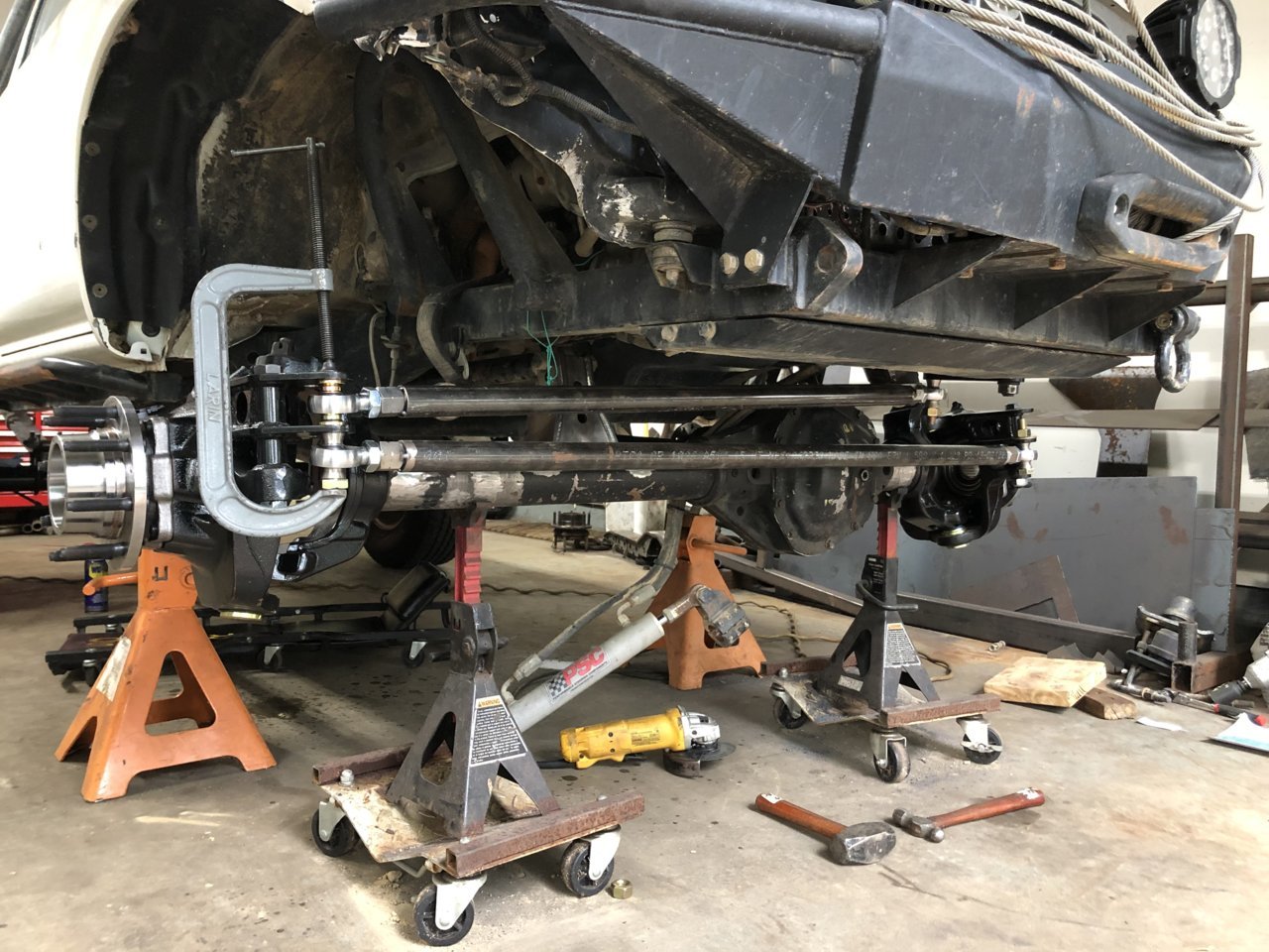

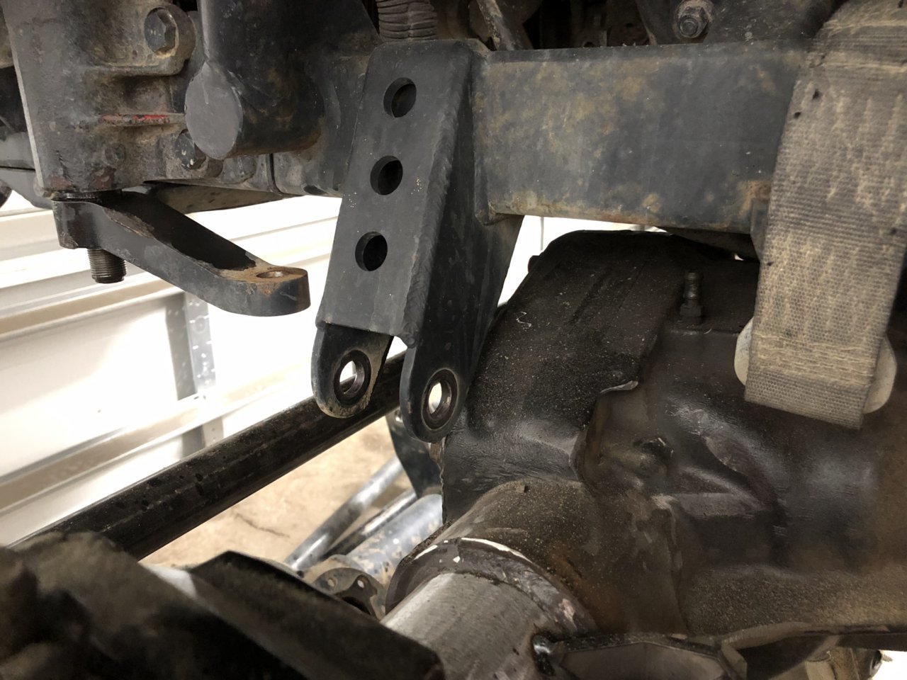

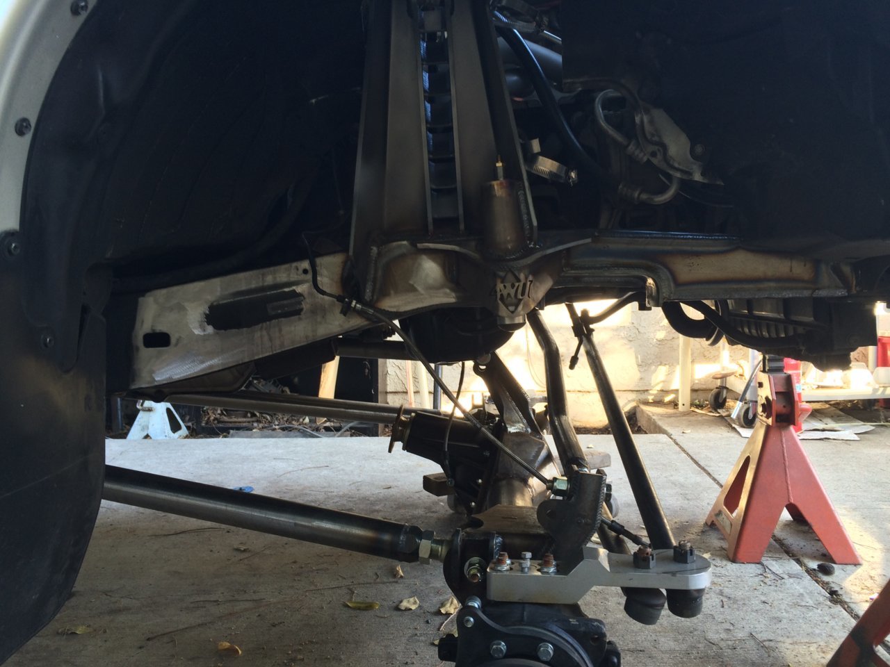

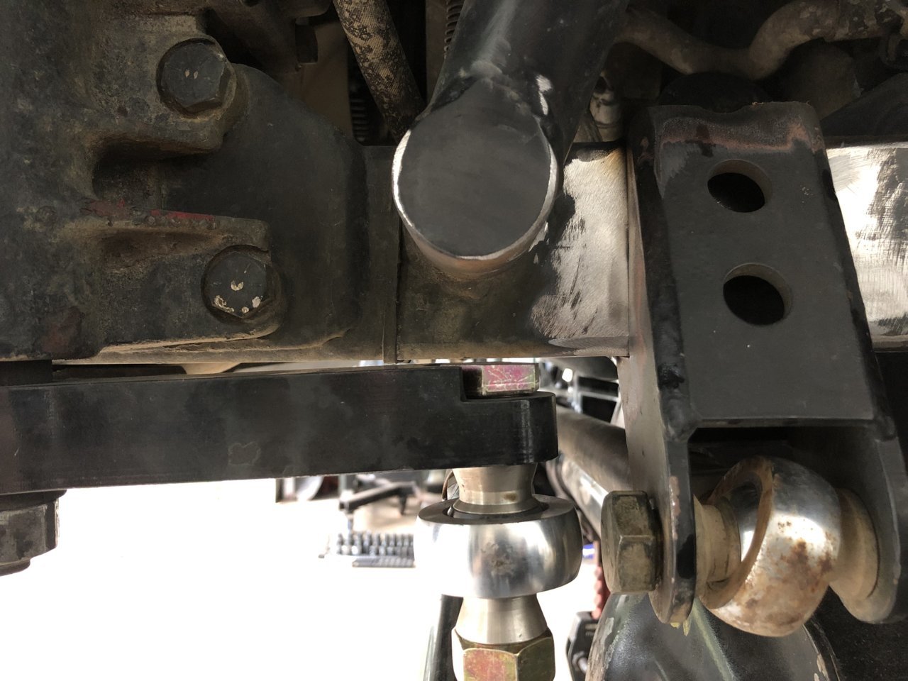

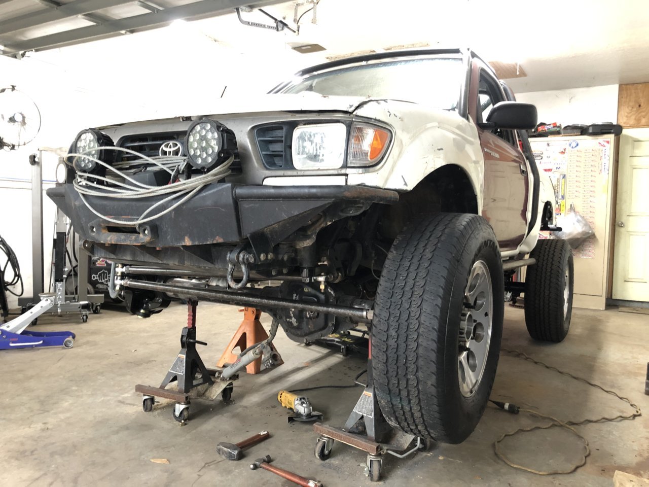

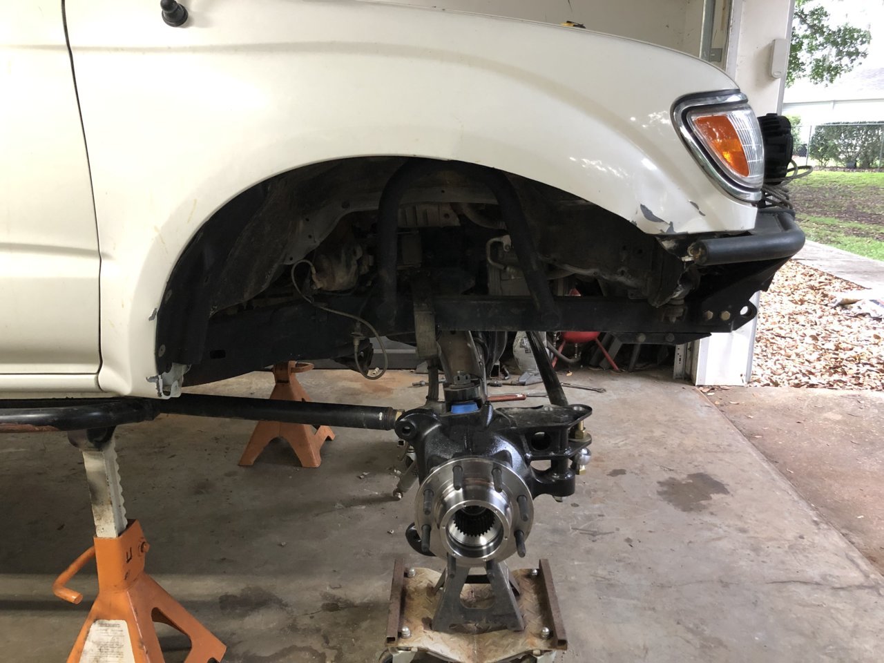

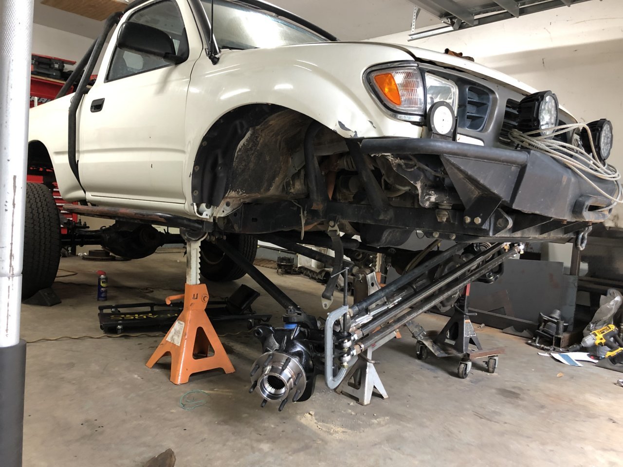

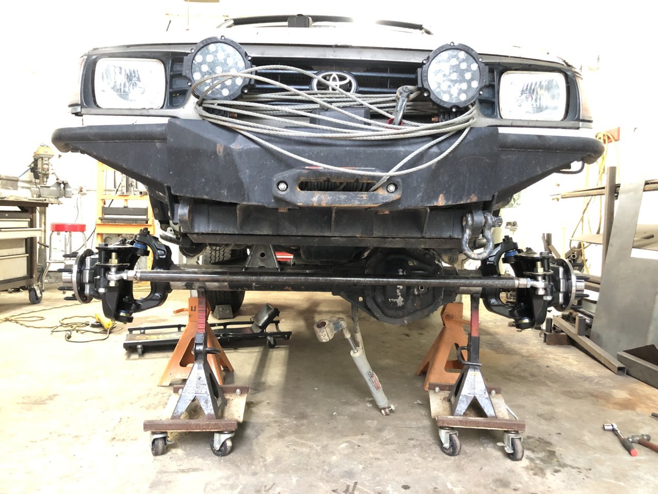

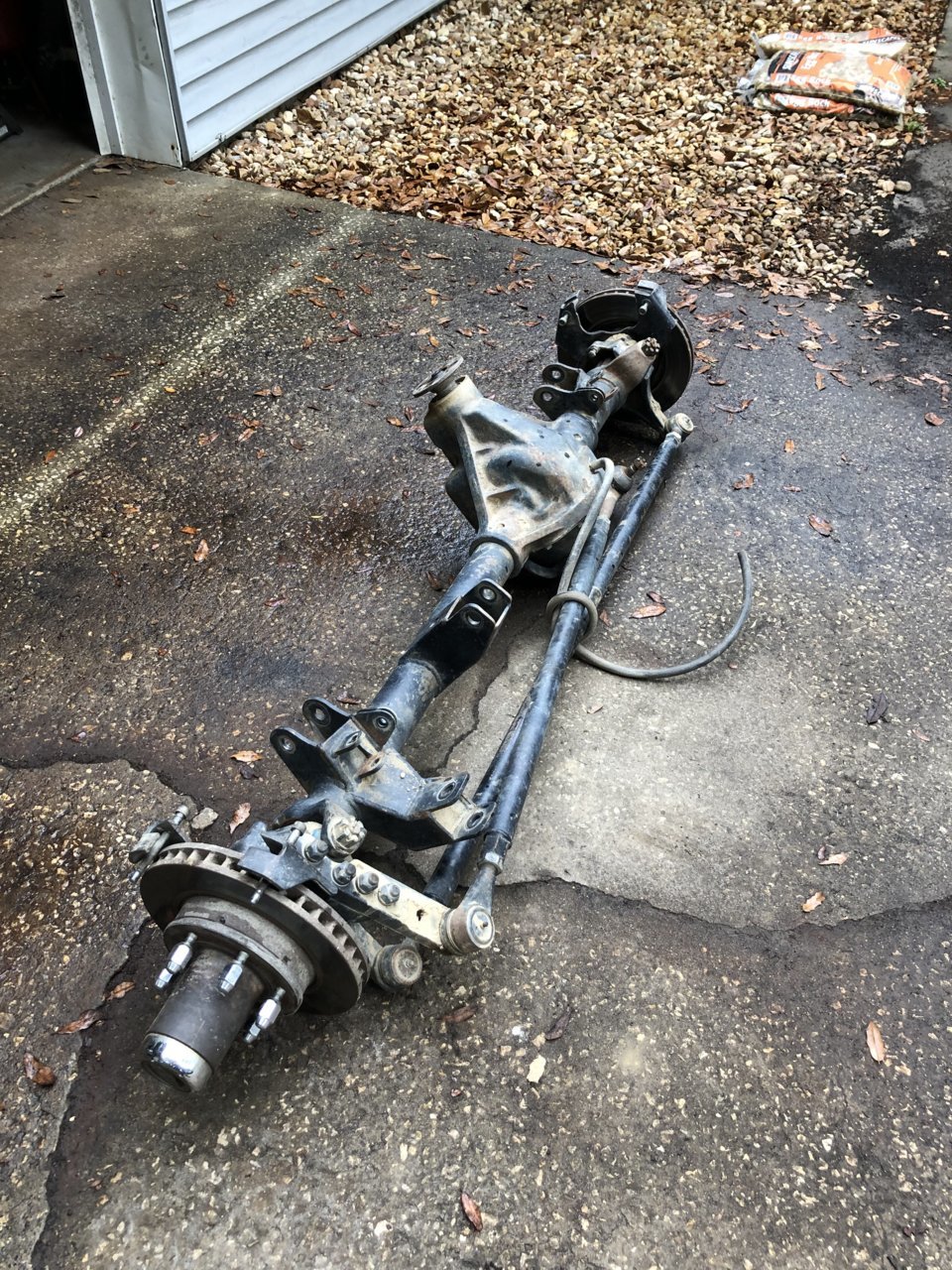

    Goodbye old friend...

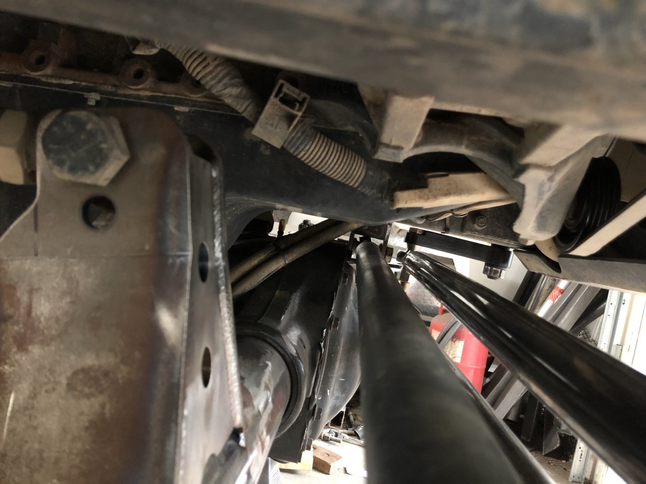

    Decided I shall start the swap
    0A2E8364-921D-48CD-B2C3-8F5824E905FD.jpg 5D356807-FBD5-4C6A-8898-568964D9253B.jpg 9669CAEC-E74C-4608-99CA-9944B62366BA.jpg 13356FBE-9A9C-4041-A843-27BD27147E7D.jpg BE34A27B-F927-4DD8-9D4D-D8E9AB1C0CB1.jpg
    Gonna have to swap over to a flat pitman arm and move the panhard frame mount up to match. Where the axle is sitting now is probably an inch or so higher than it will be at full stuff, depending on panhard and drag link clearance.

    Dayum...that was quick. It was still sitting on that D44 at 3pm. :eek:

    I went inside and relaxed for another hour too before I decided to start. It's a lot easier and quicker when it's essentially a "bolt-on" job haha

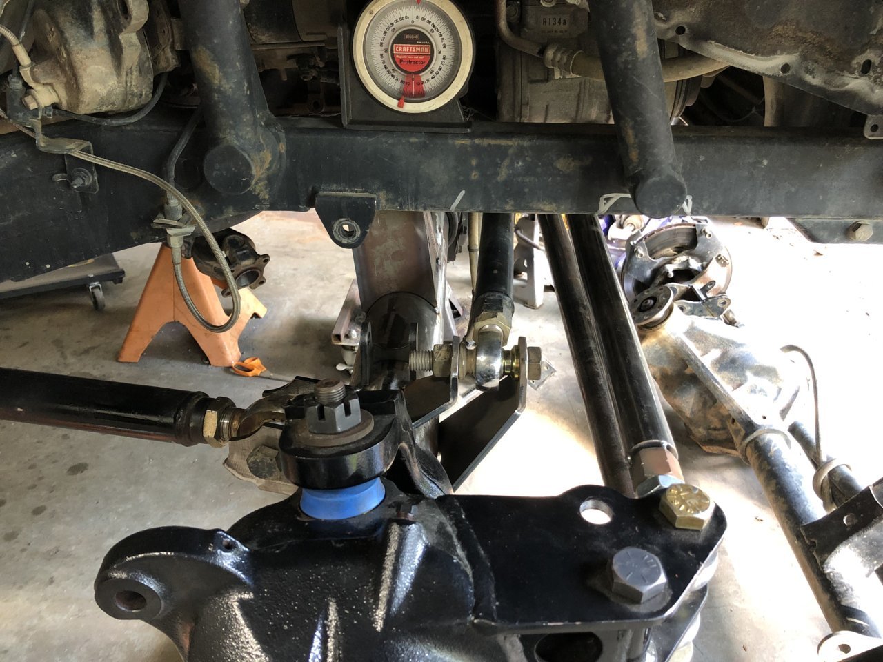

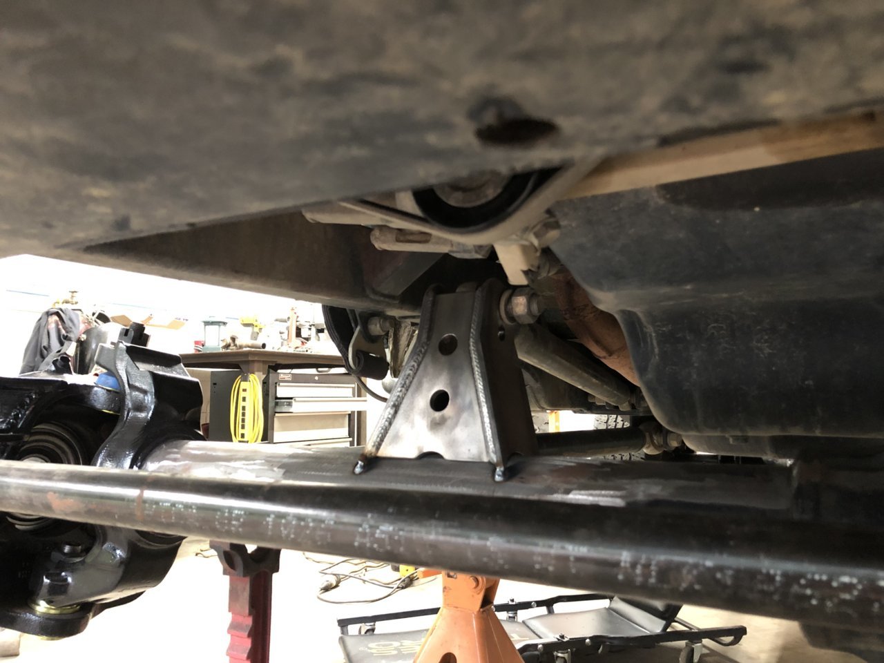

    Got the panhard mount cut off and moved up. It's still real tight under there but I think it'll work. I had to shave down the bolt on the pitman to clear the frame while turning passenger, I have about 1/16" of clearance now. Without major work, I'm going to have to run around 10* of positive castor to allow the panhard to clear the diff cover. I have no idea yet if the ruffstuff diff cover is going to clear because of its thickness. That amount of castor isn't ideal but it is what it is.

    The ballistic cover seems to have some more clearance going on

    Todd what are you doing with the Dana 44's?

    Lee already bought my rear axle and Dom is going to buy the front as of now

    Did you pull that 44 from a wagoneer by chance just wondering

    Mine came out of an 82 jeep j10 truck

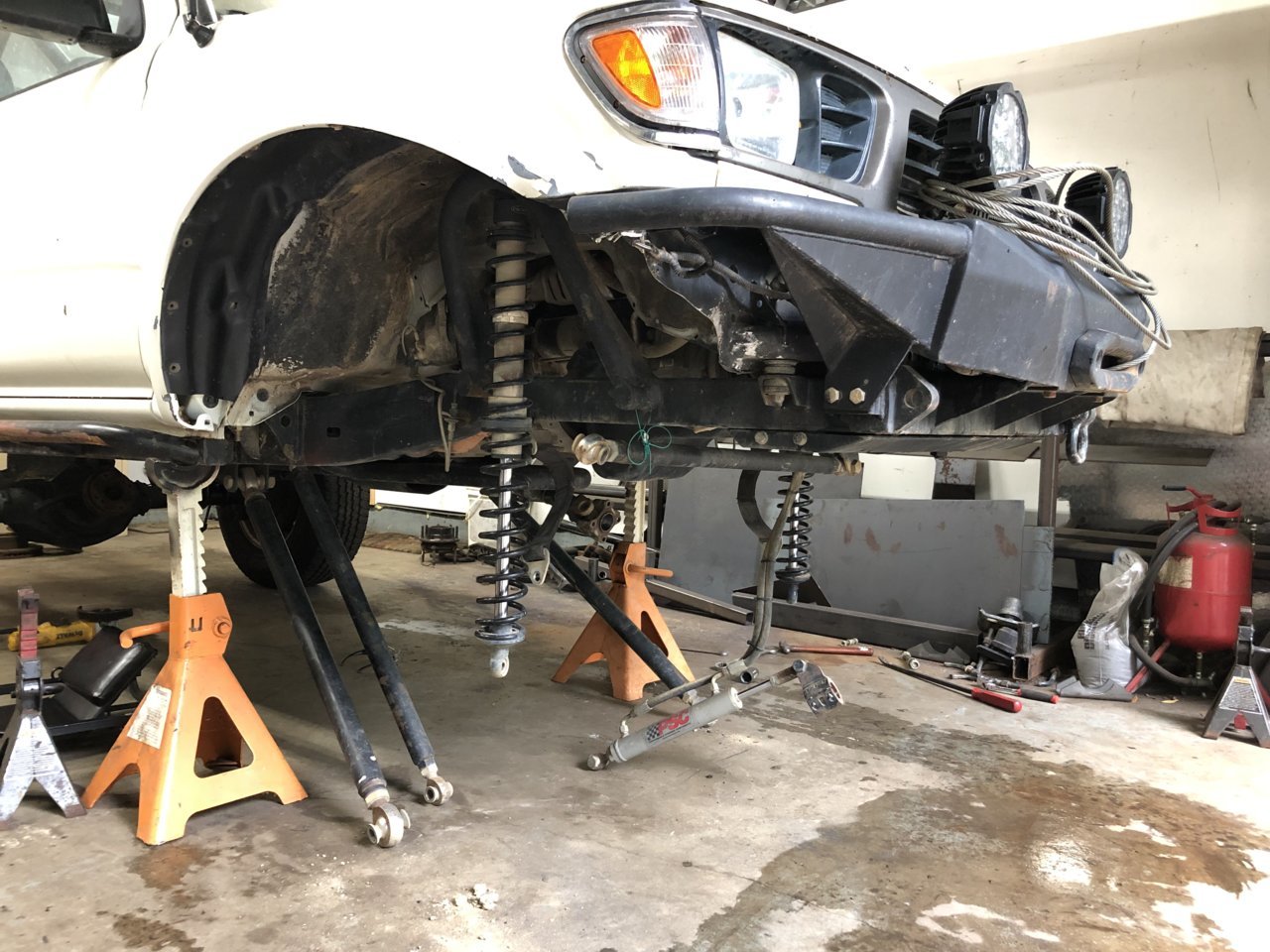

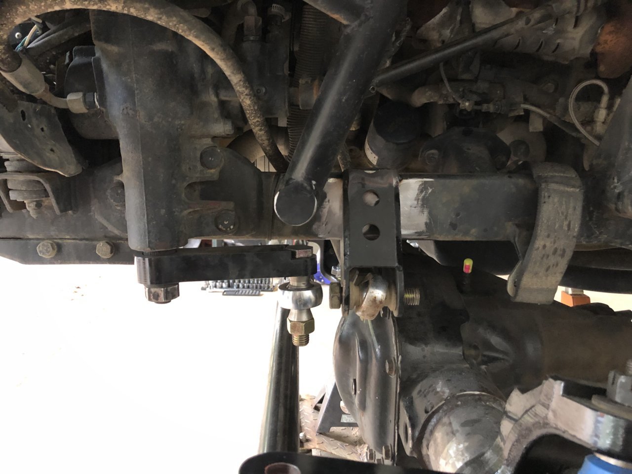

    Time for some frame notching and new coilover hoops

    Todd,
    Would pics of my frame notching help you?

    Absolutely

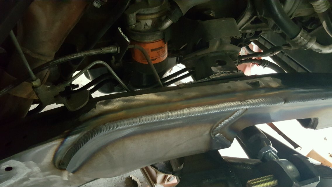

    Here is what I have at the moment. I can get specific pics this afternoon.
