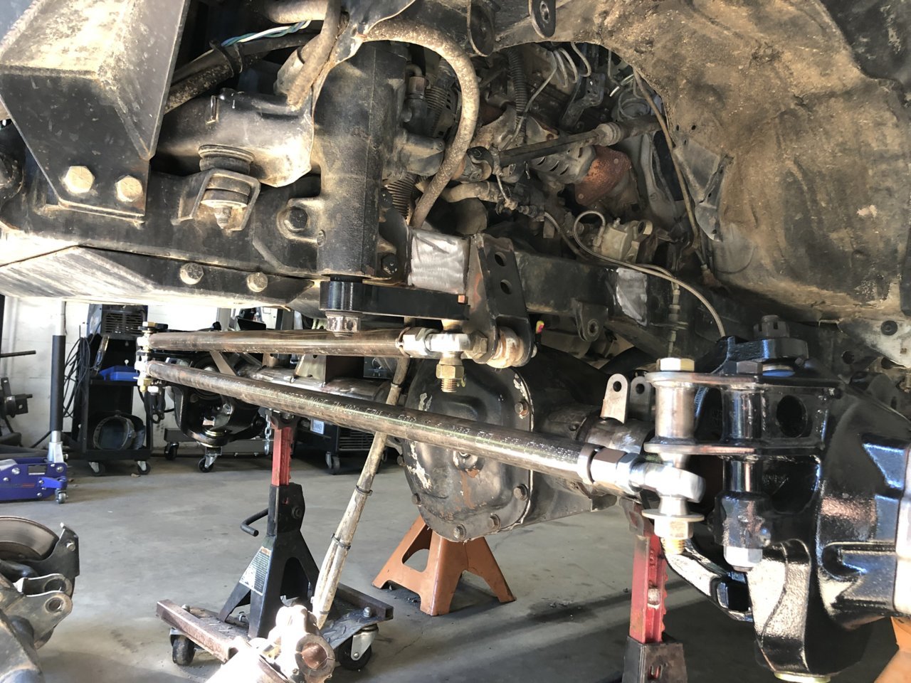

    Here are more pics after all issues were dialed in.

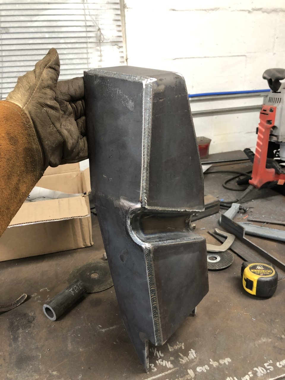

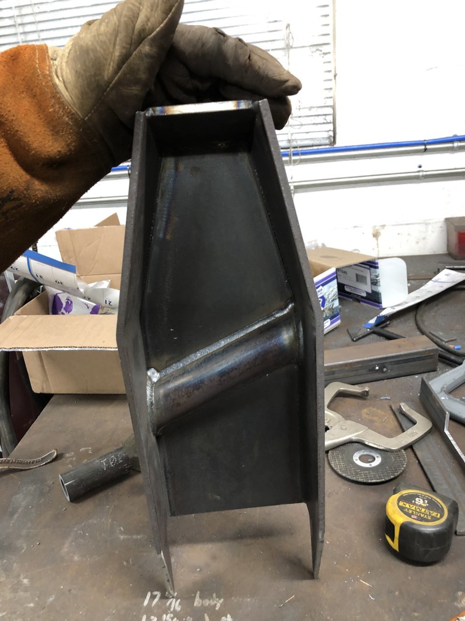

    Thanks Ritchie! This is pretty much what I had in mind doing. Notch out what I need, cap it, and plate the frame on the outside to add some rigidity and call it a day

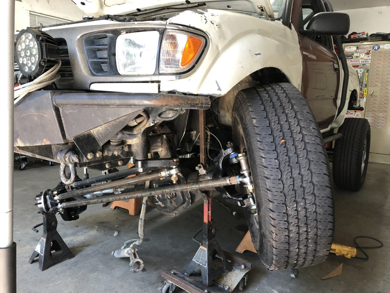

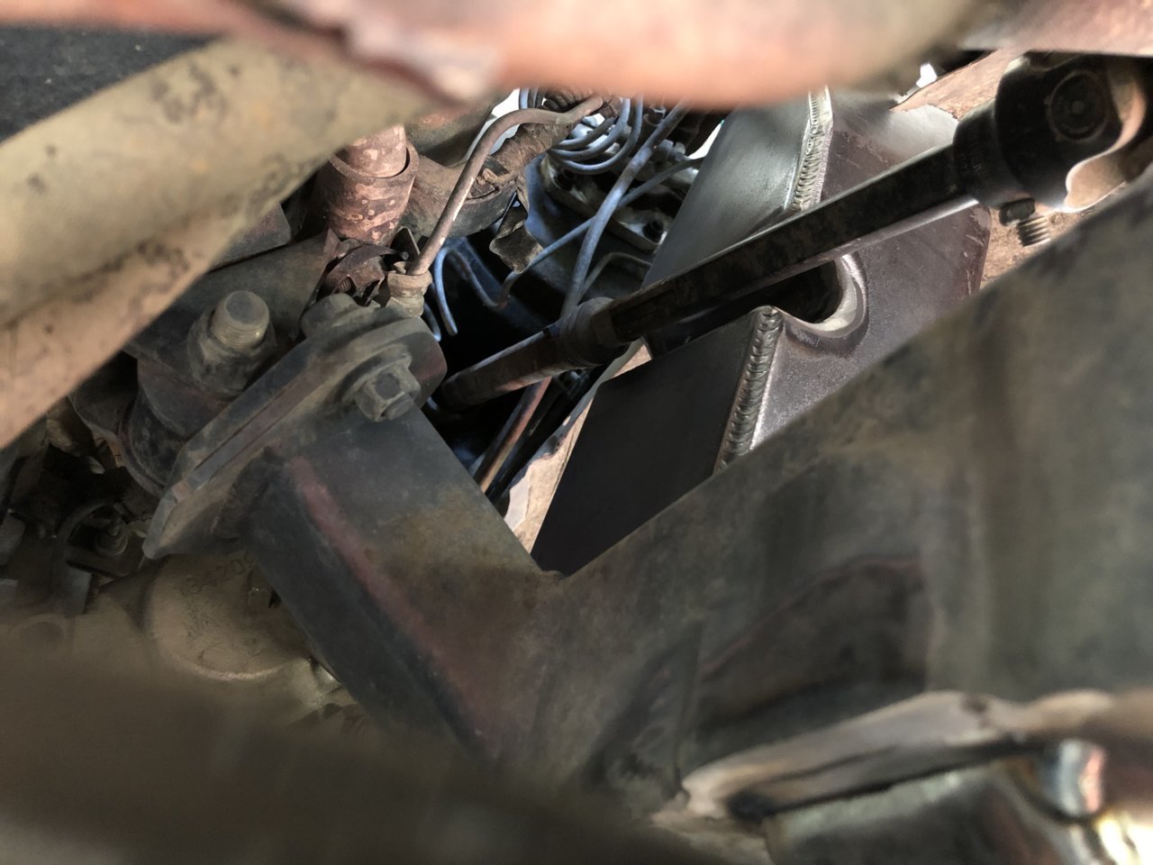

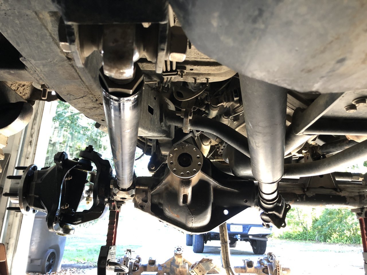

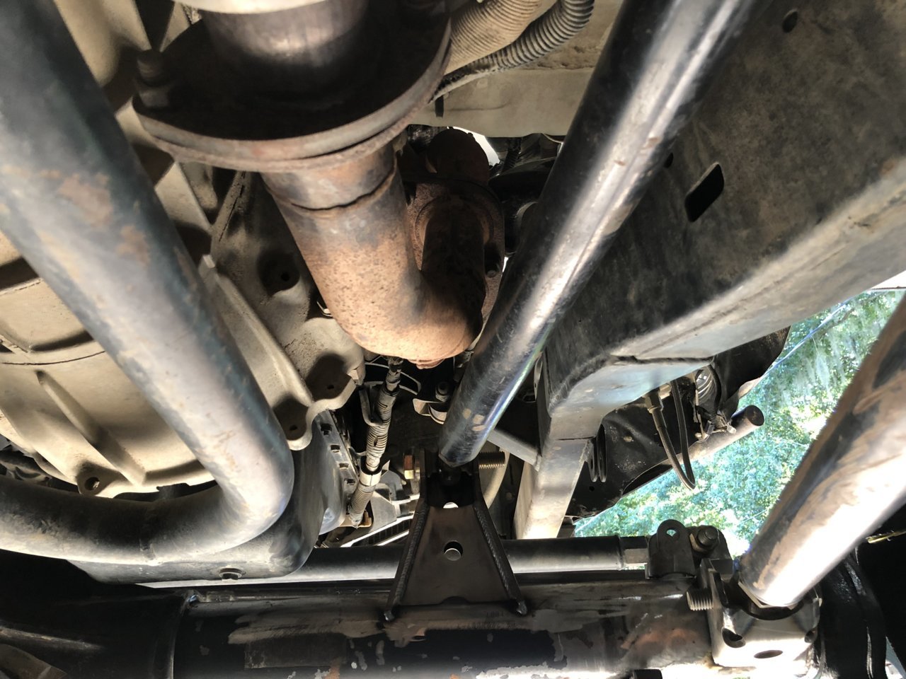

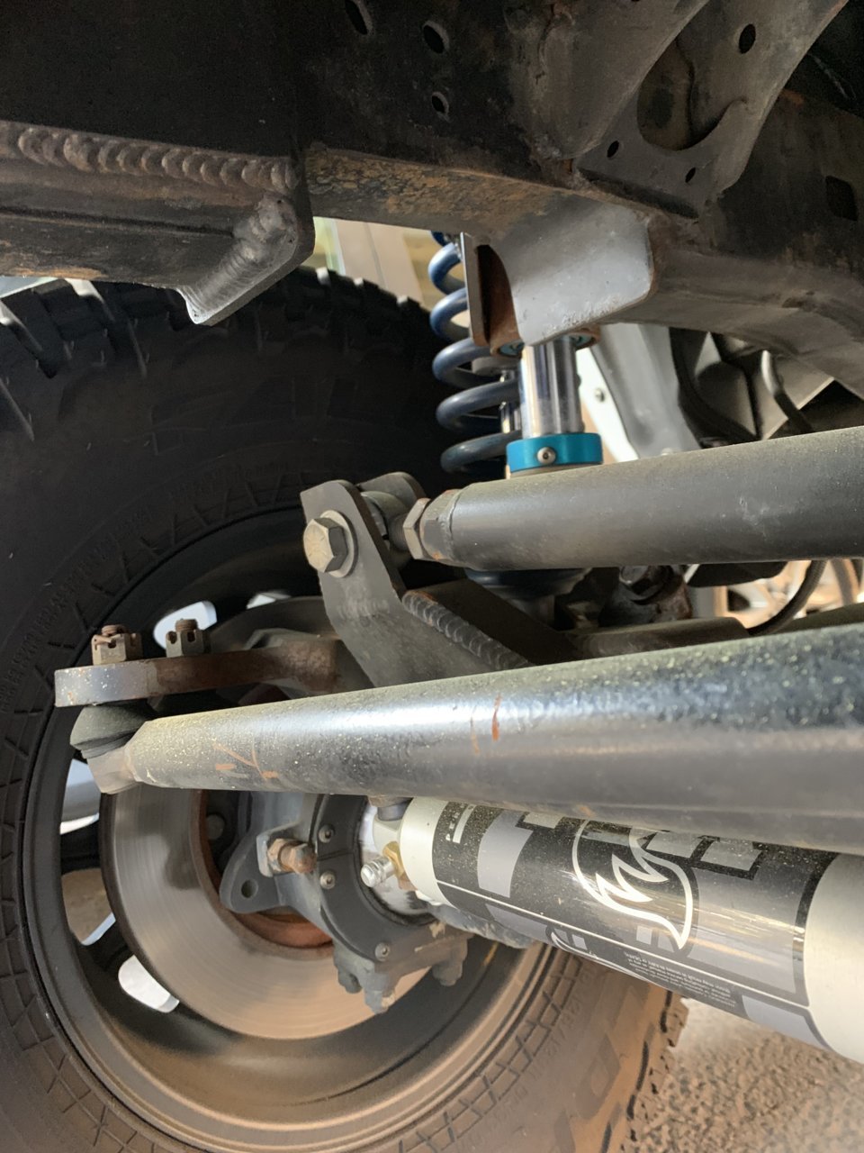

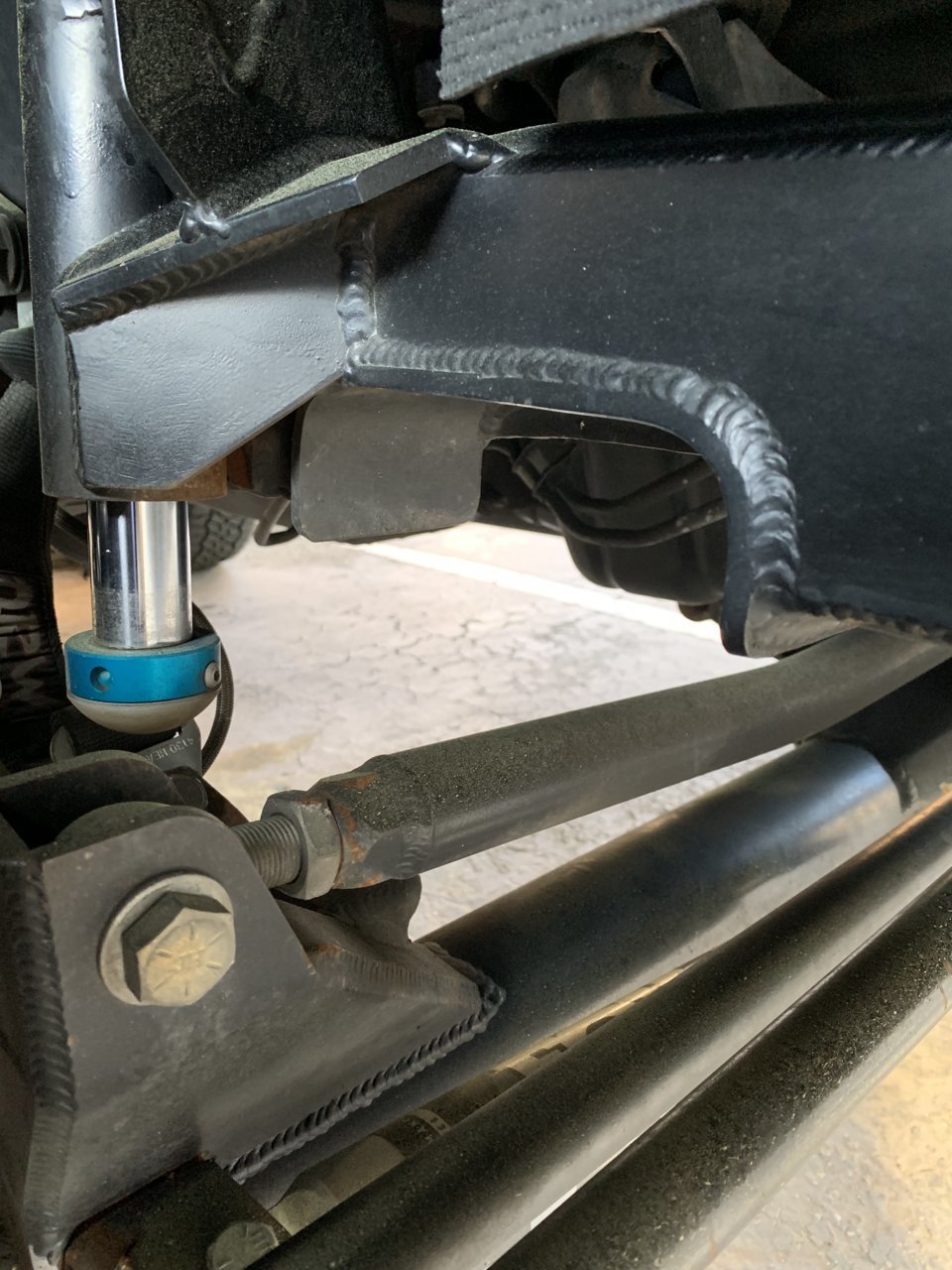

    So I ended up shortening the lowers and upper about 1.5" to pull the axle back and correct the castor back to around 6* positive. I probably got another inch of uptravel by doing that as well. I should have taken measurements before to confirm, but I do remember only having about 3" of uptravel and the rest down, so I'm hoping for more up now, which should happen.
    Old hoops off and cleaned up. Going to start on the new ones this week.
    Pics are at full bump.
    C446BB8F-535C-40CF-8A37-BF7DD0E73D72.jpg 2B426611-311A-4793-86E2-5D6F857F76DD.jpg 28E821D3-4253-46E5-857D-BC4FE97D0B63.jpg 6EA6D98B-EB67-4DF7-BCD4-A76152869B7A.jpg

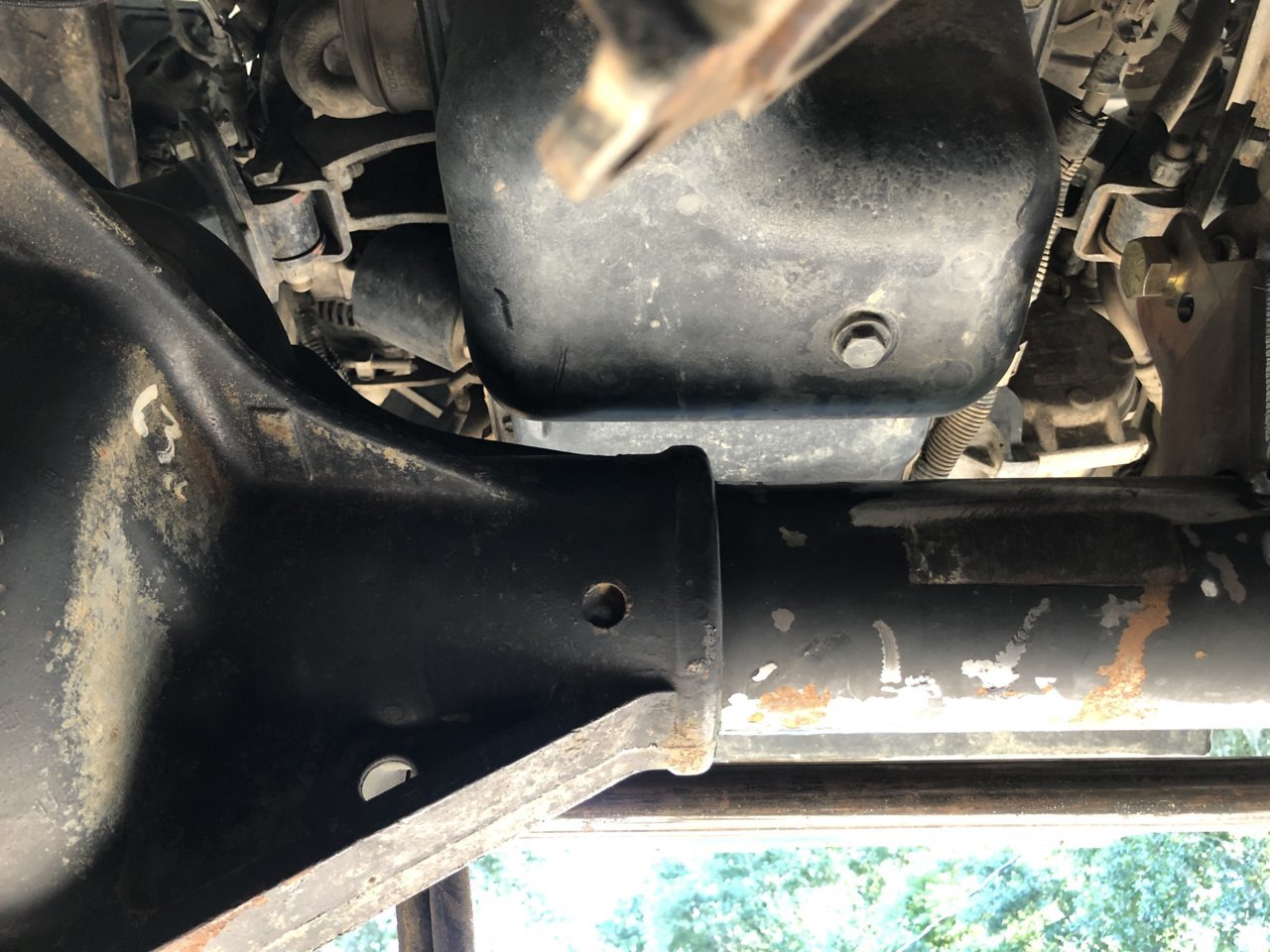

    Looking at that axle clearance I’m going to be moving forward a little to clear the pan with the truss

    You're going to have to mount your steering box so far forward... Don't call me the day you decide to do it lol

    You auto welded that lol nice beads

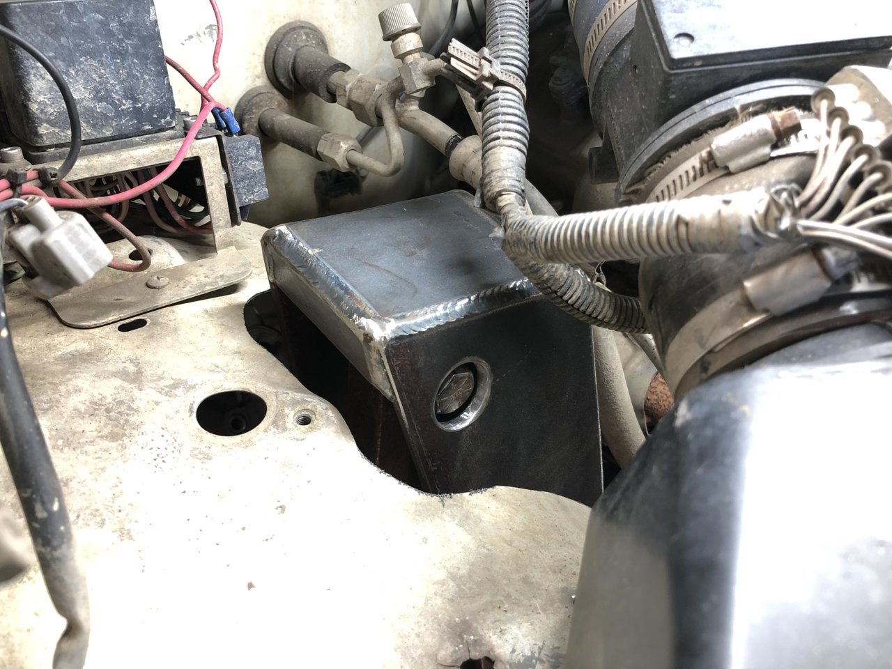

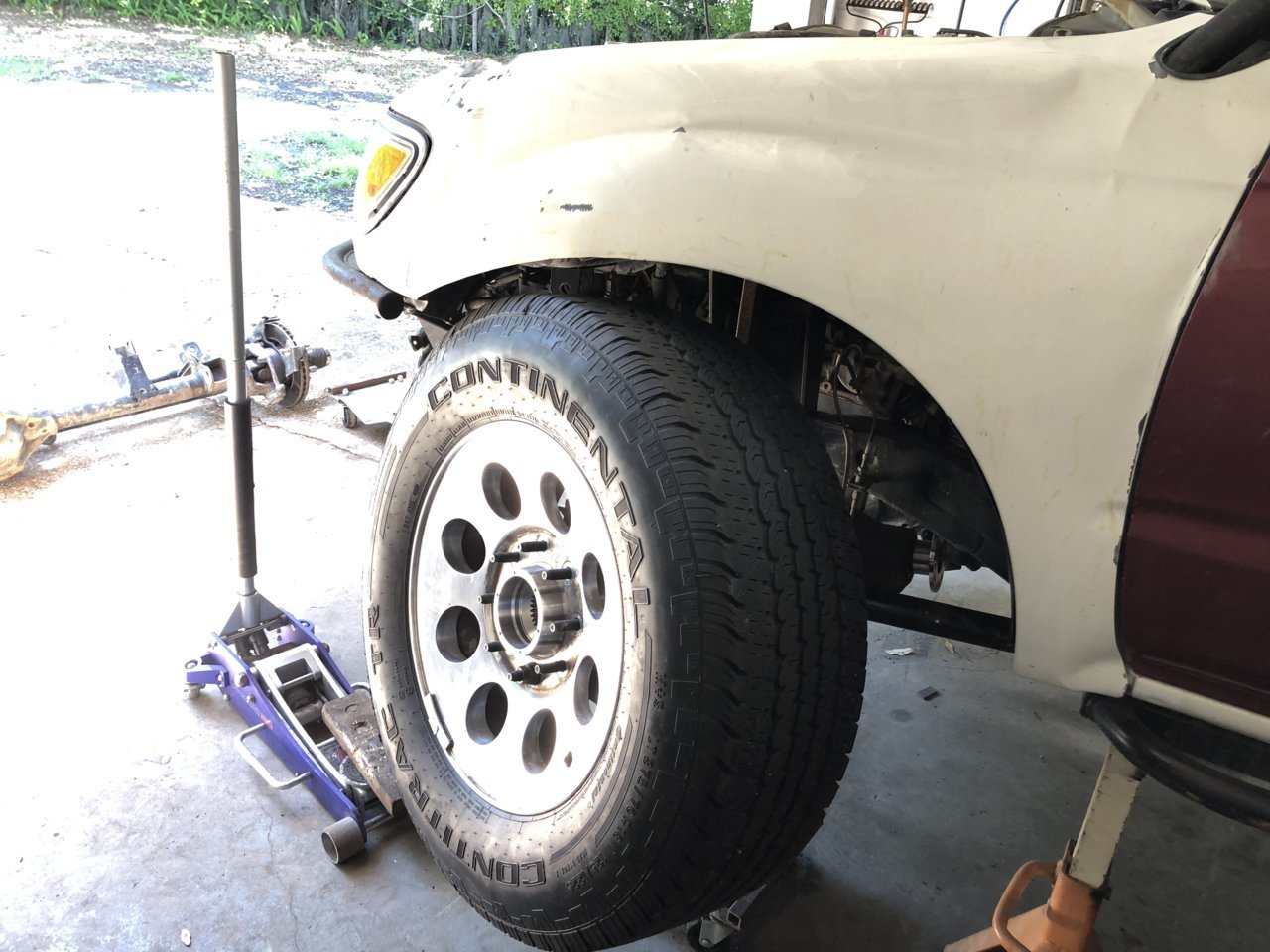

    Full stuff with a 32" tire....

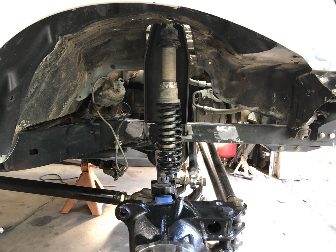

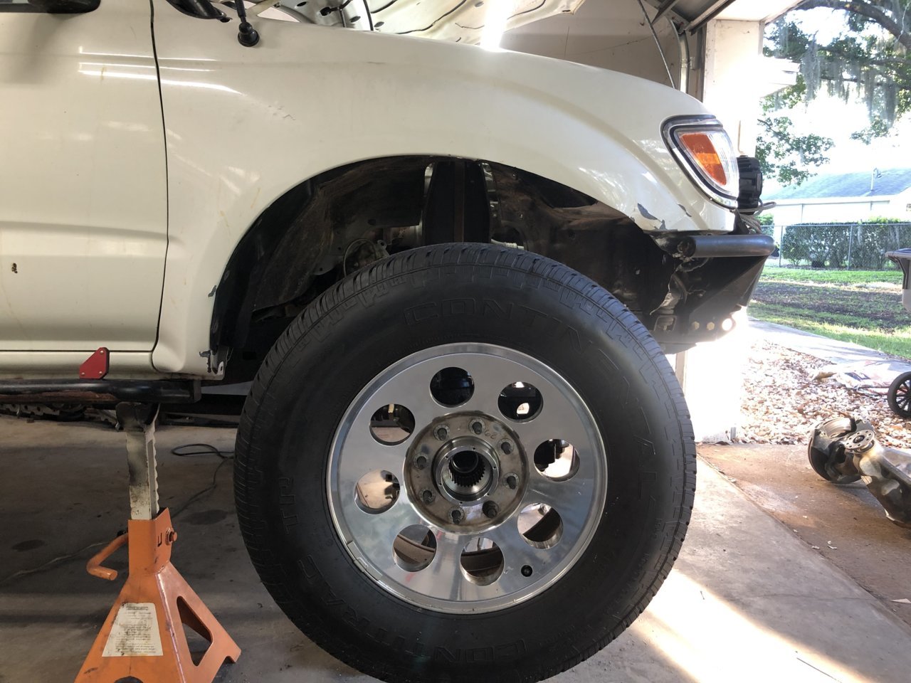

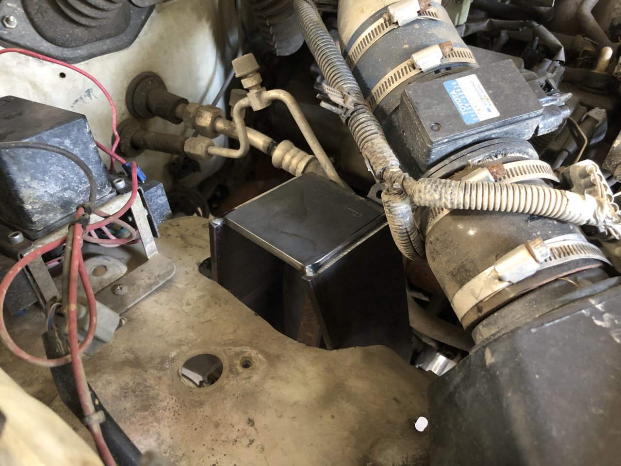

    B6A7CD14-3265-4011-979B-73669B312BB5.jpg 2D5AA3F8-C19C-4B52-A1CE-7E45D89B977B.jpg

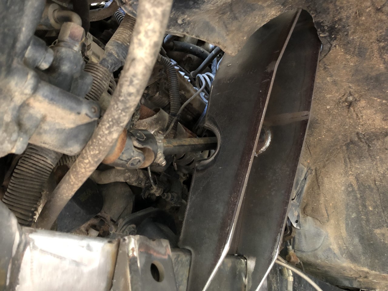

    Towers are fully welded up and tacked to the frame. I added guessets to the back of the towers that go down to the motor mount for a little extra strength.
    64FE9B1D-F38B-4682-BB1C-D78328F3717C.jpg 89E540A3-4A43-47A5-8E9F-ED781570F3A1.jpg

    Looking good Todd.

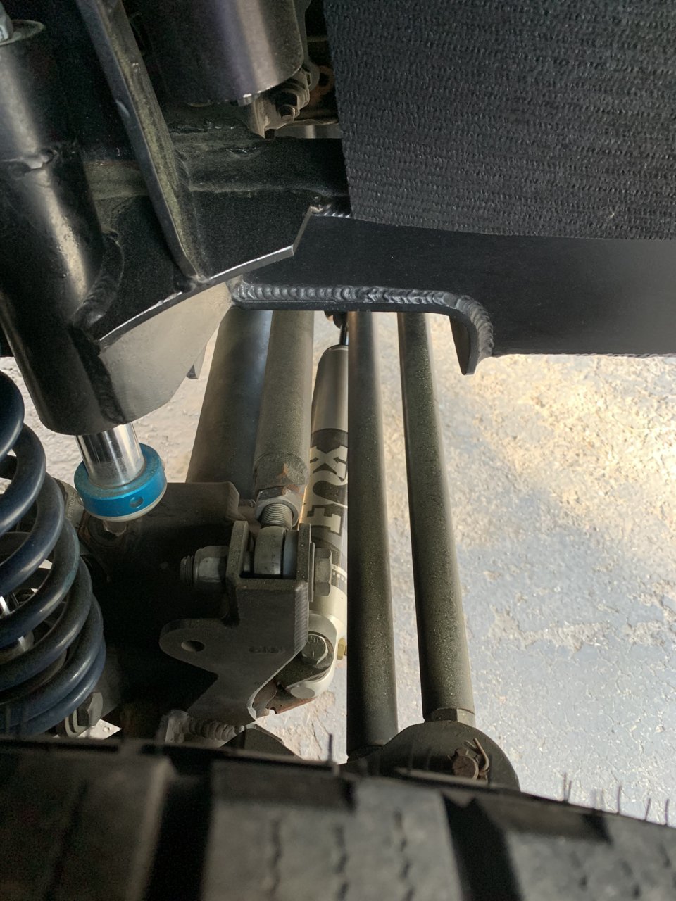

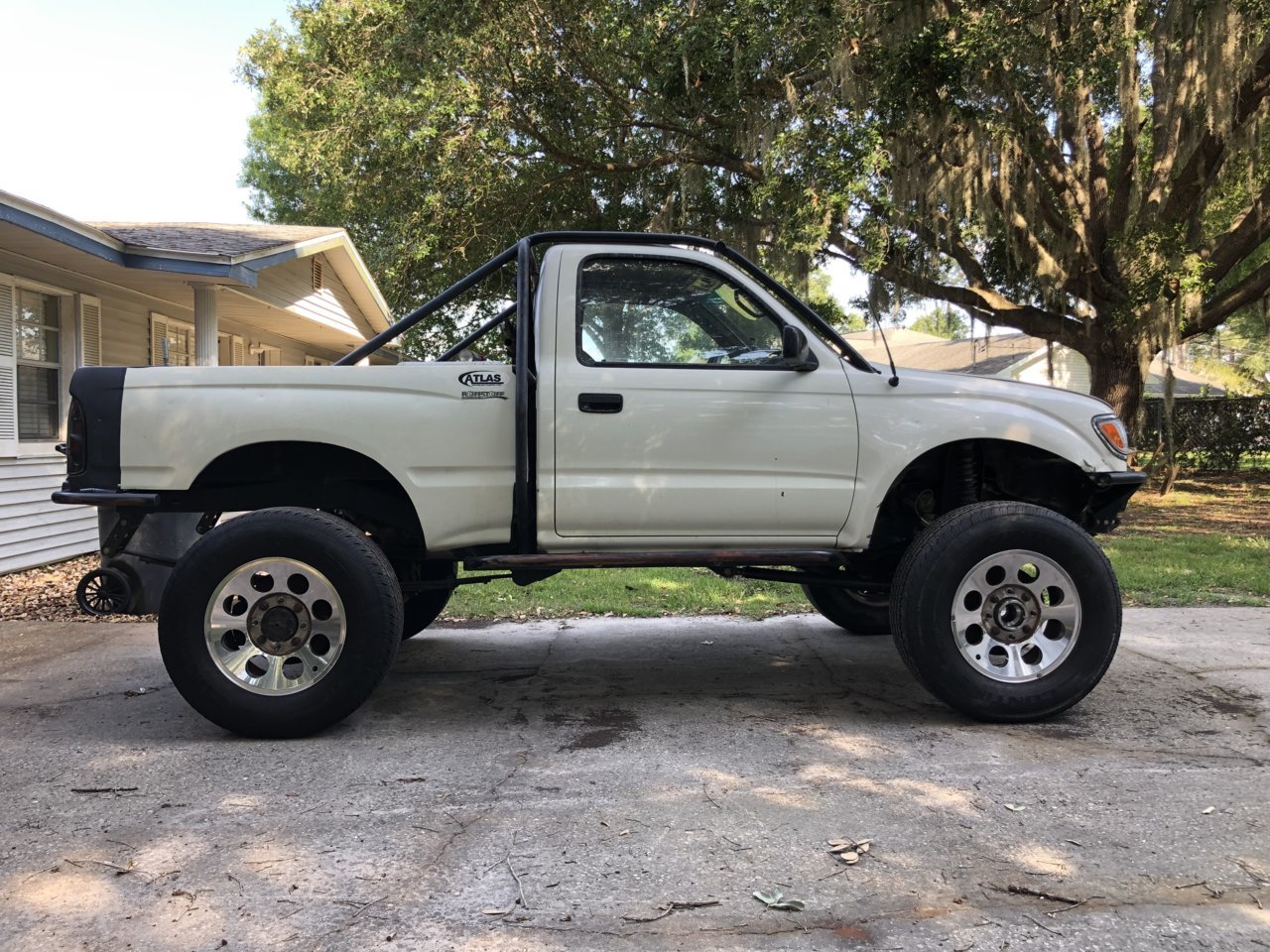

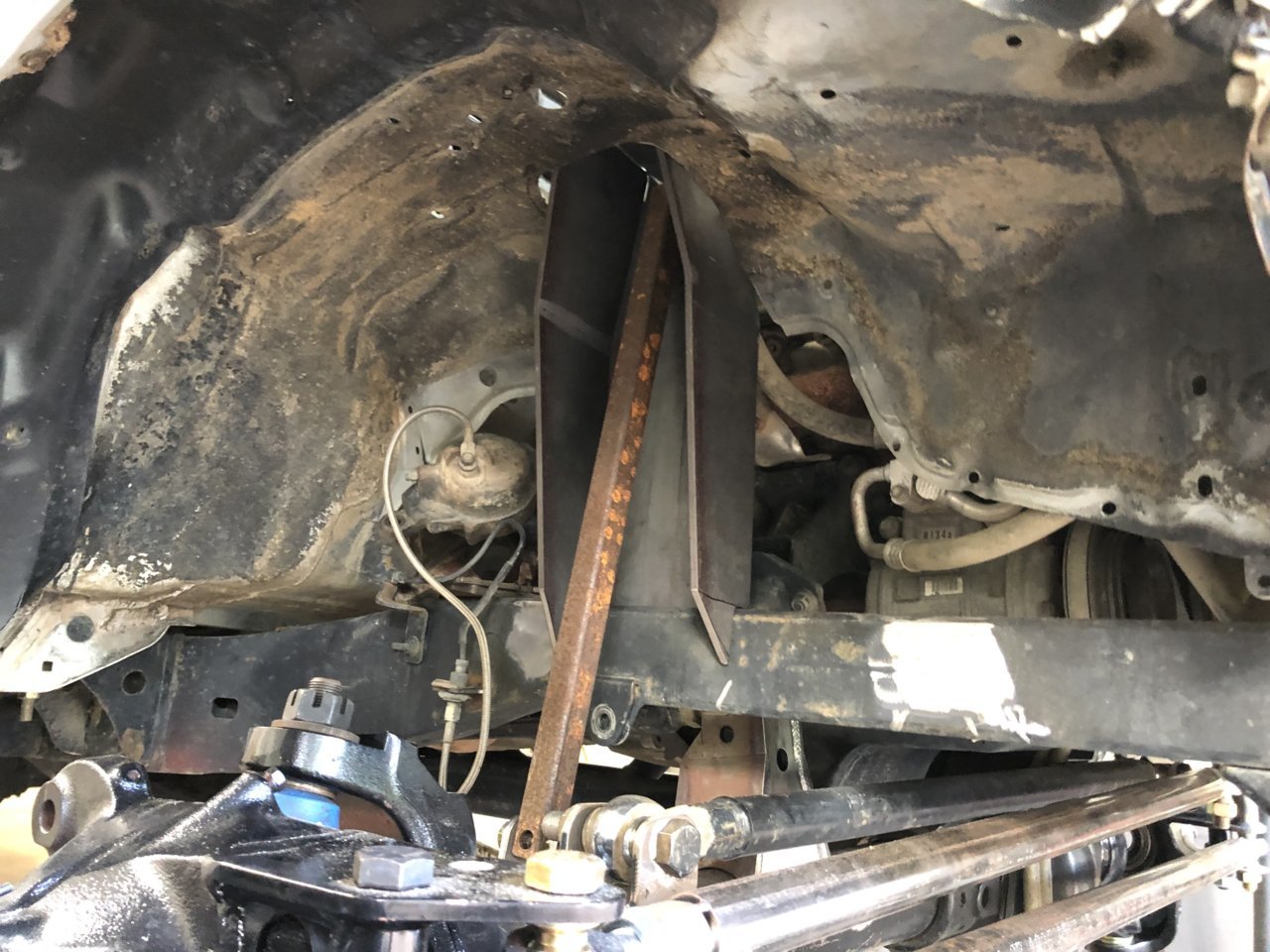

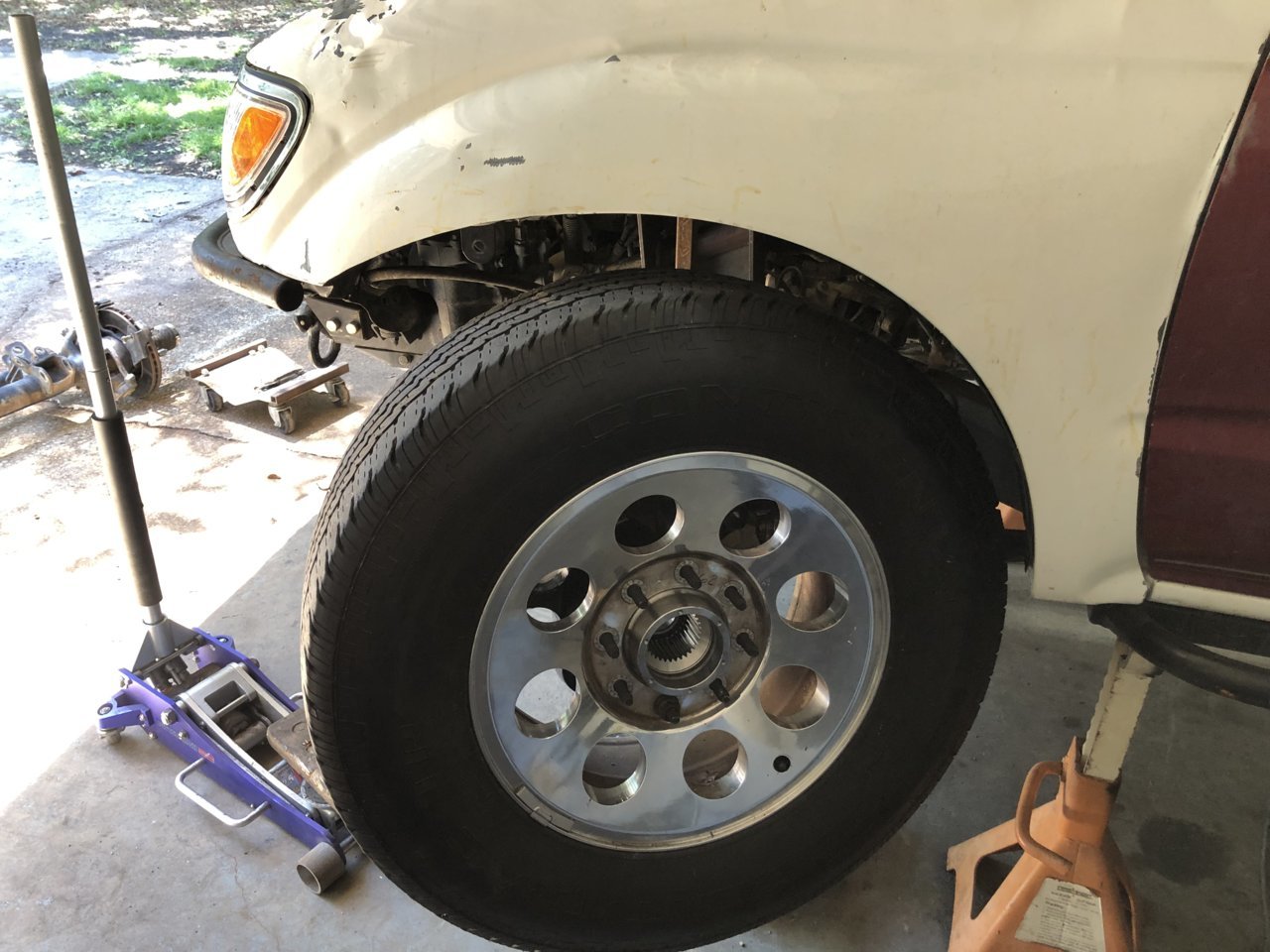

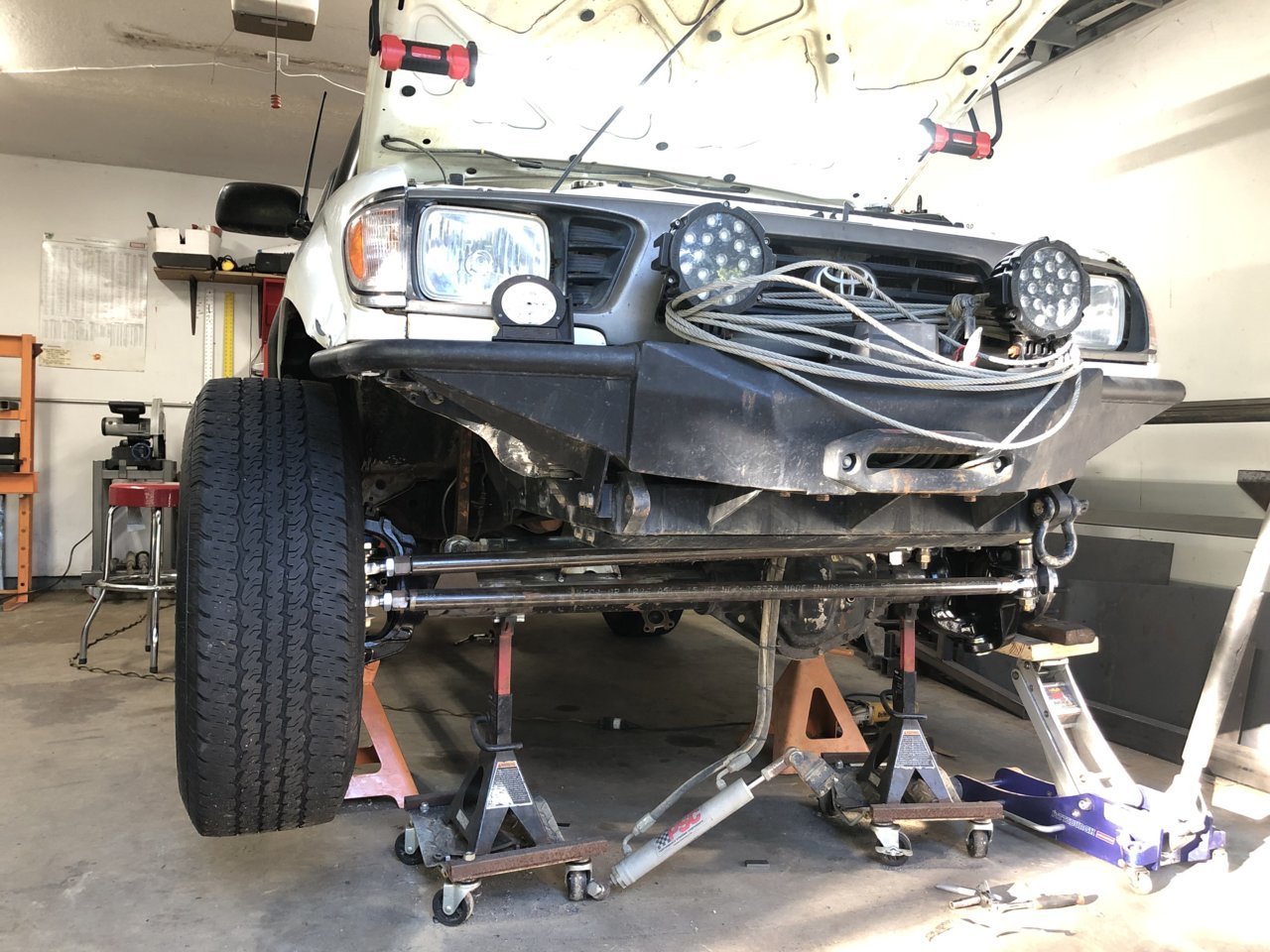

    Been hittin it hard during the weekdays.... Towers and frame panhard bracket fully welded in and did a little flex testing to see what I'm going to have to trim... And it's going to be a lot
    558782A7-B50A-4234-BFAA-2B93E8611CCD.jpg B566FEB0-728B-4A9D-85B1-A59782937709.jpg 2EABBB0A-F753-40A2-B9B1-73D73824BA57.jpg

    Just leave the street tires on, looks like they tuck nicely in that wheel well....

    I actually agree lol

    Looking good. That oil pan clearance is insane
