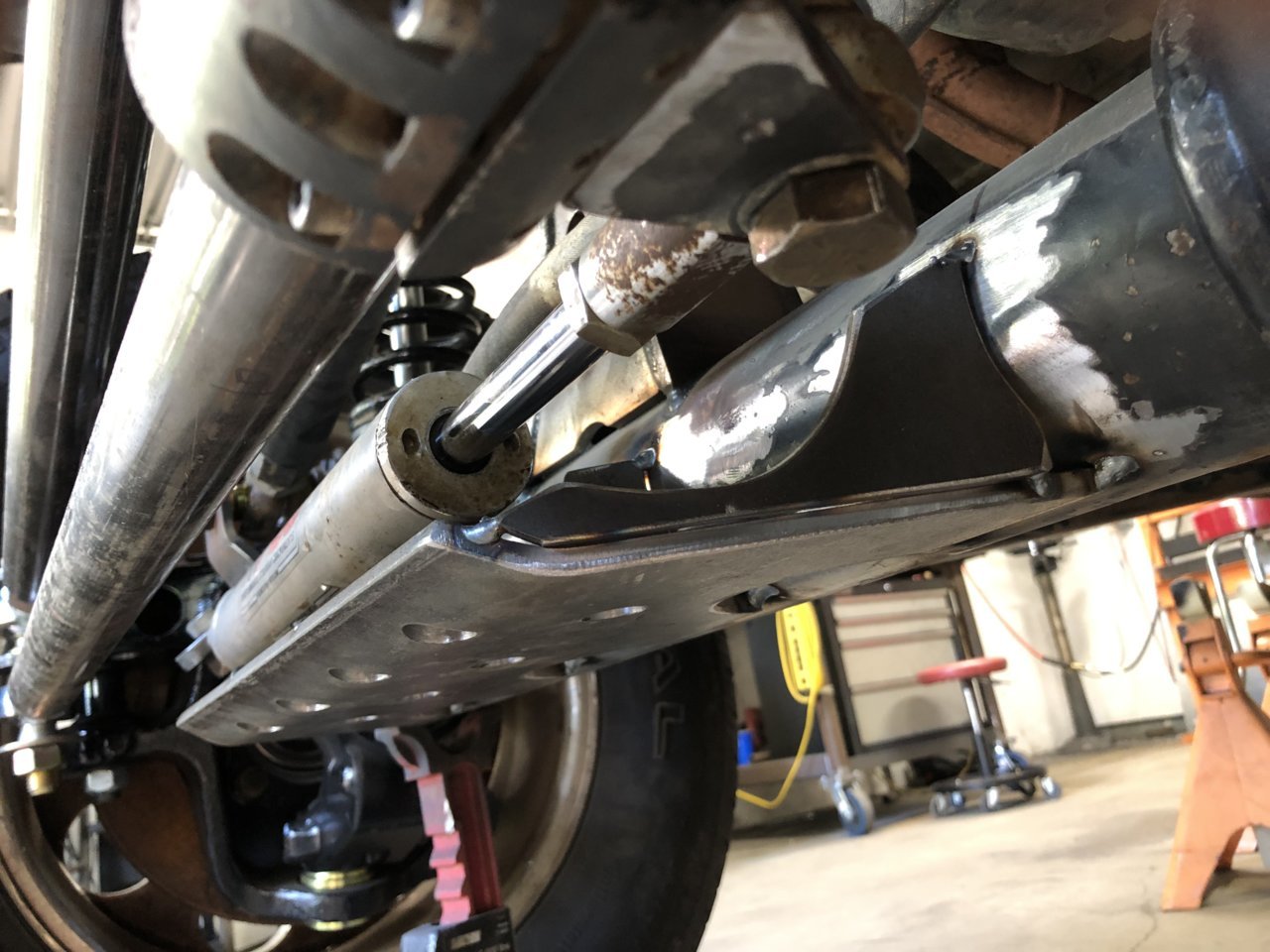

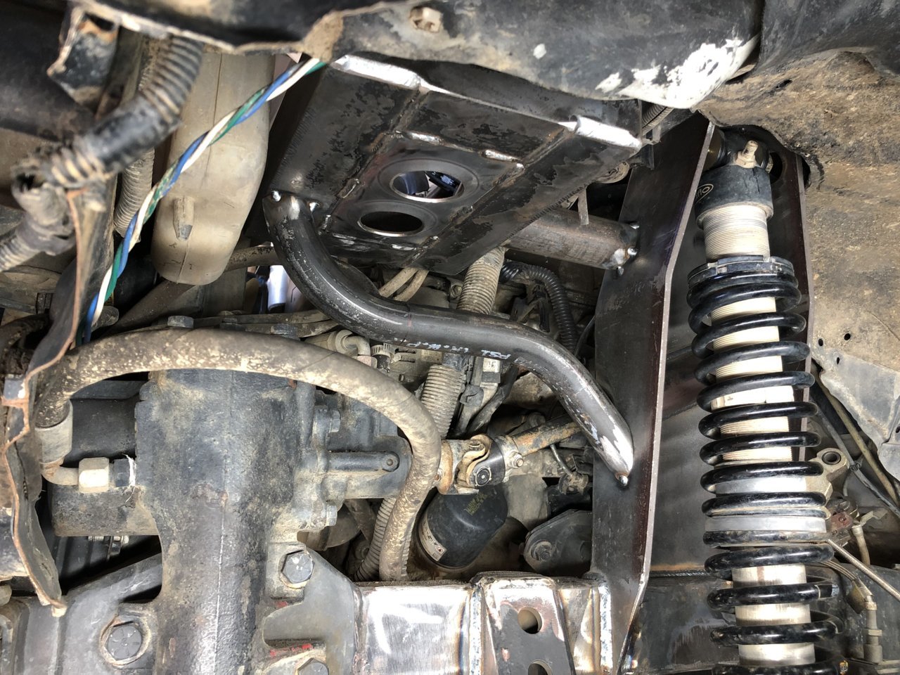

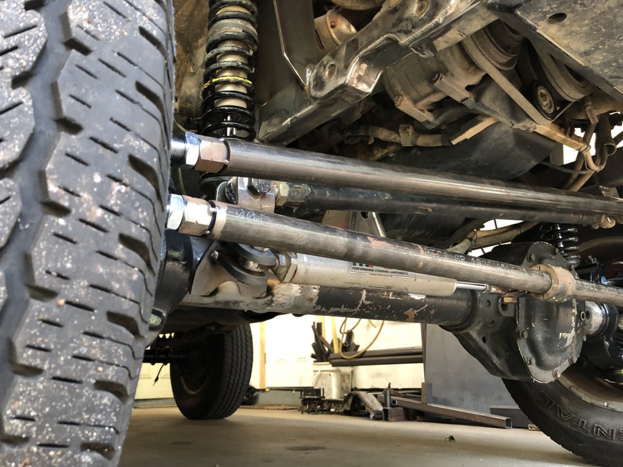

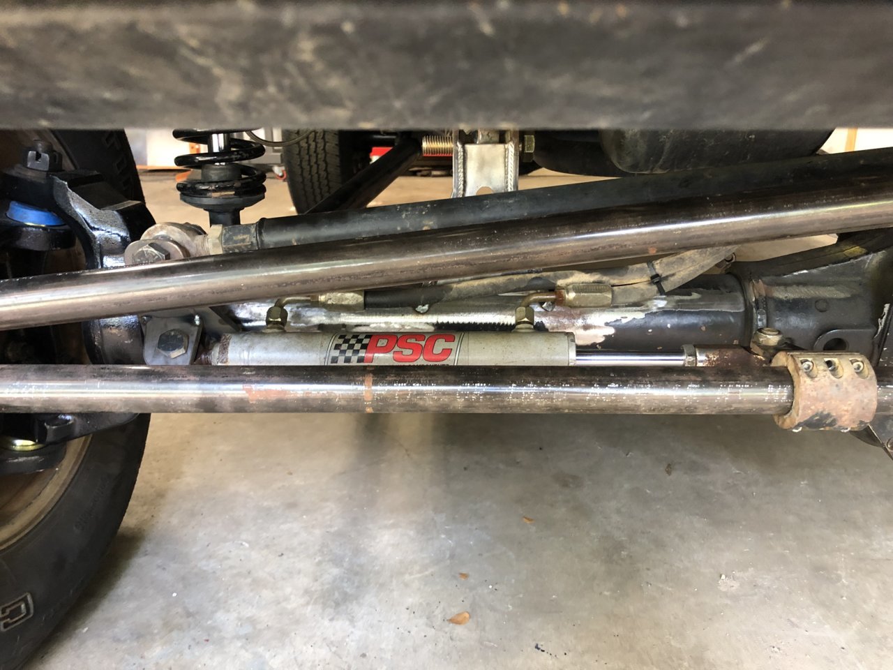

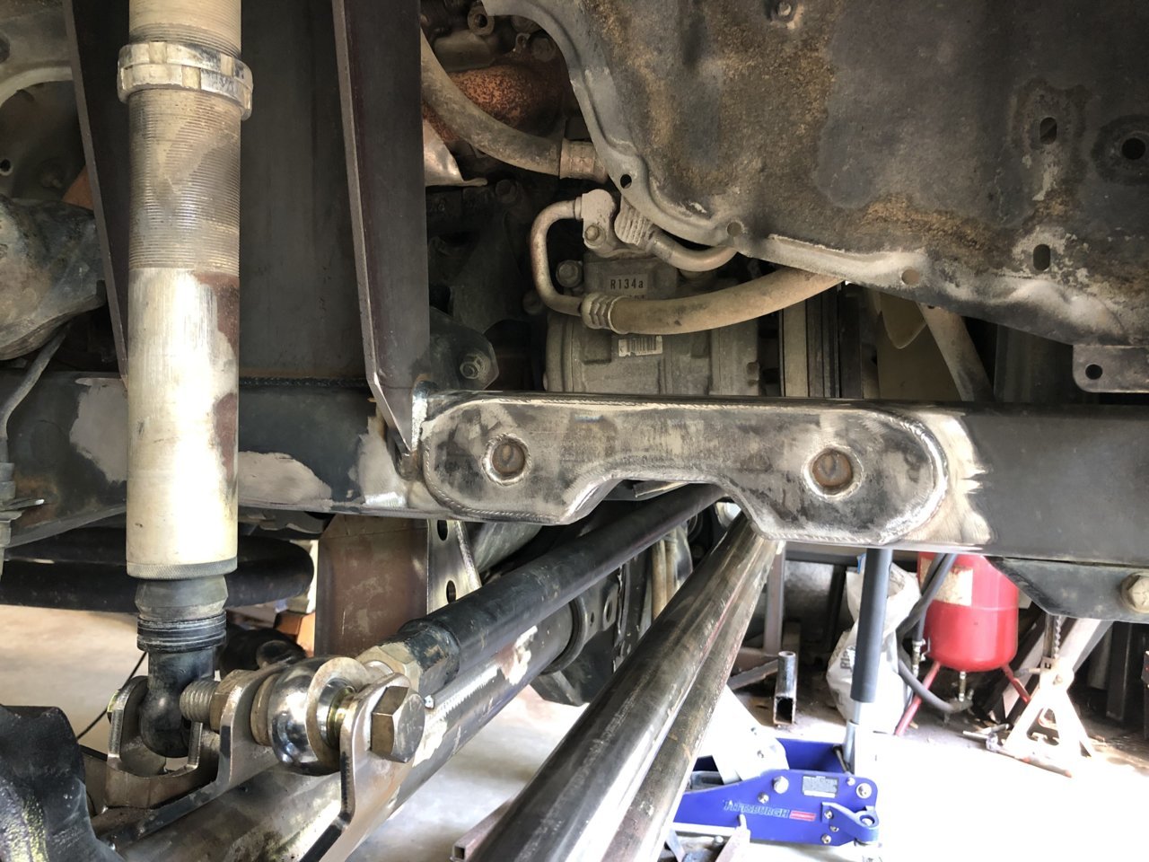

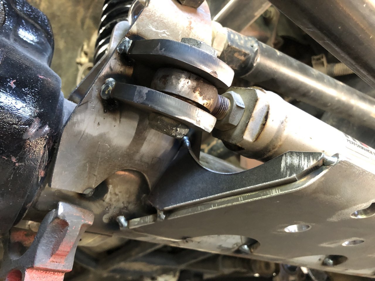

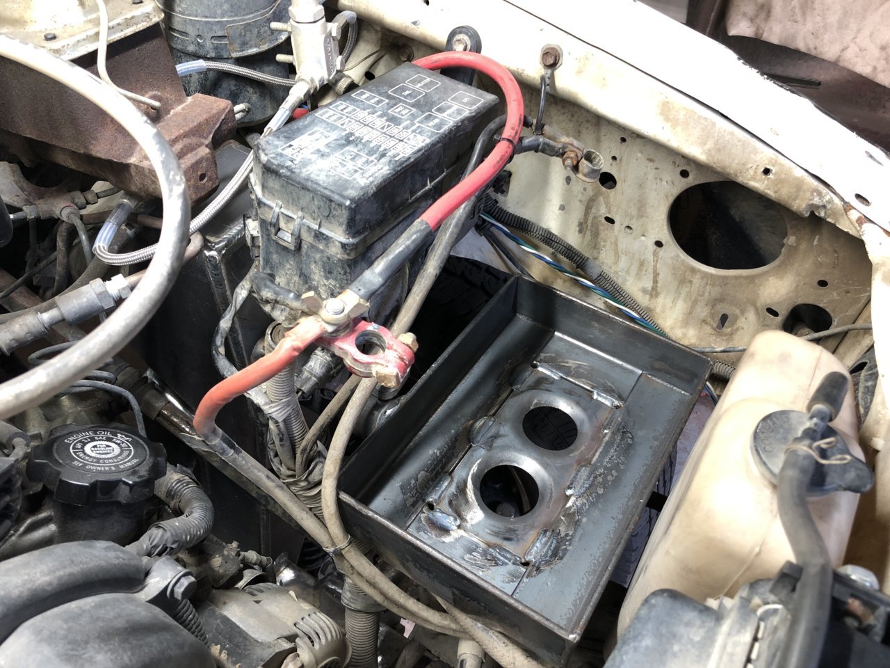

    Pretty productive weekend. I got the ram mounted up and the limiter sleeve removed so it's a full 8" stroke again. I am going to build a skid off of the axle to protect the ram next. I also cut out the factory battery tray because it was cracking and ripping away because of how I trimmed it to clear the steering box. I decided to build a tray that comes off of the coilover tower instead so it will be much sturdier.

    What did you use for a limiter sleeve?

    I bought a small aluminum sleeve from McMaster-carr that was a couple hundredths bigger on the I.d. than the shaft

    Did you just clamp it to the outside? Meaning you didn't take your ram apart and clamp it on the shaft inside the ram.

    Naw, I had to disassemble it and slide the sleeve onto the shaft. It's very easy to do.

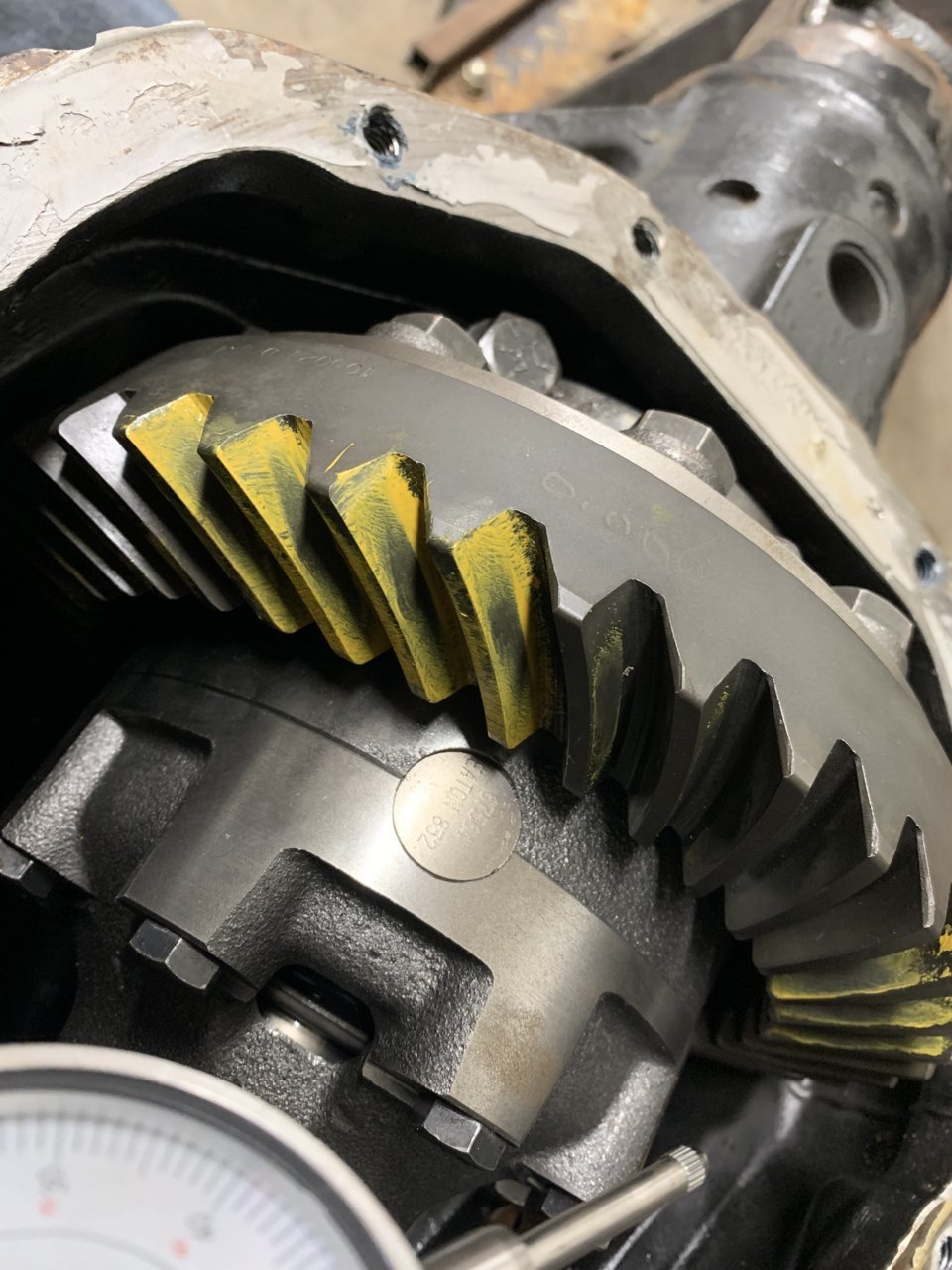

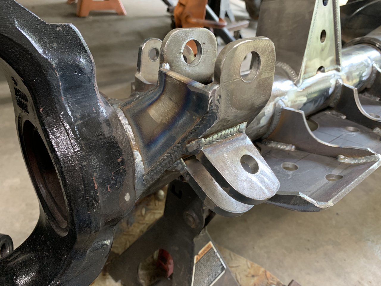

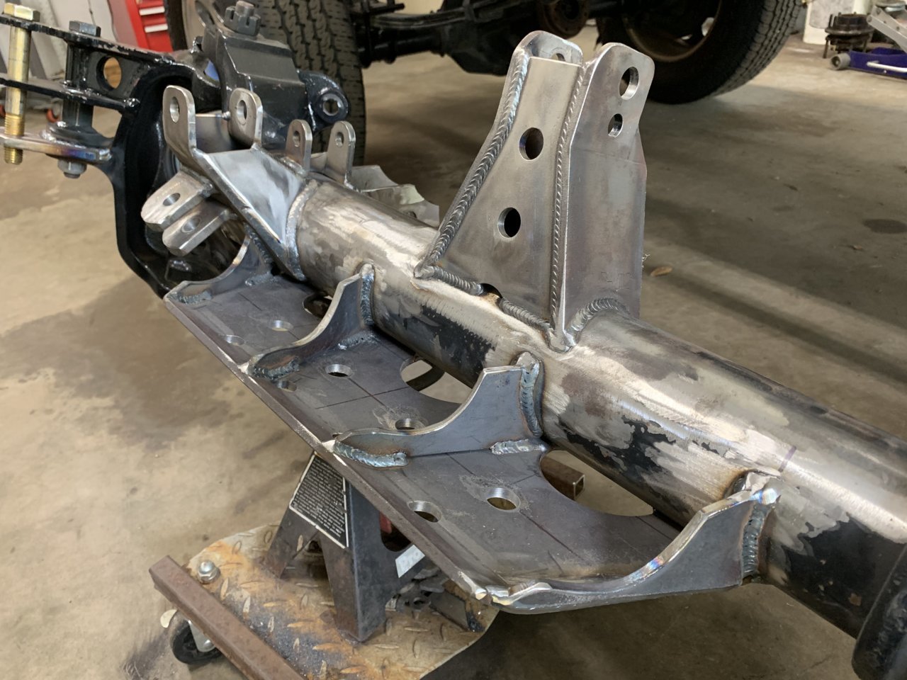

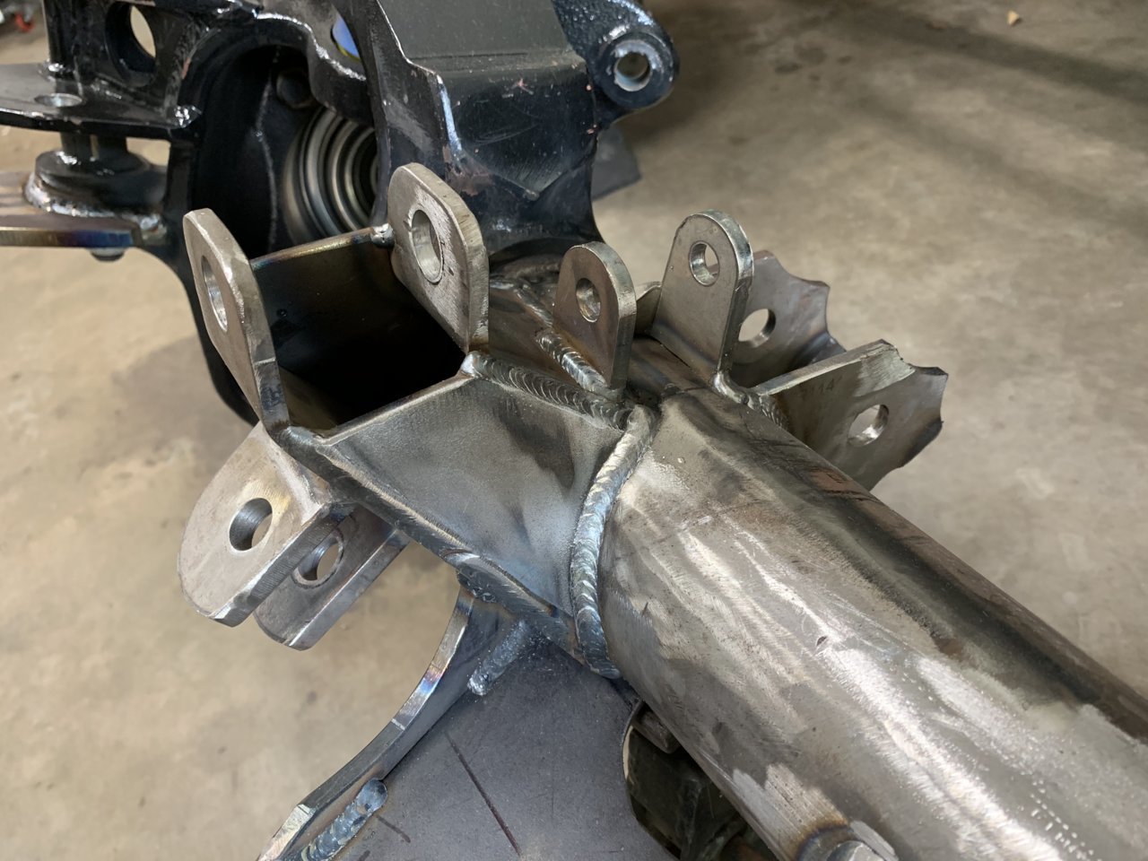

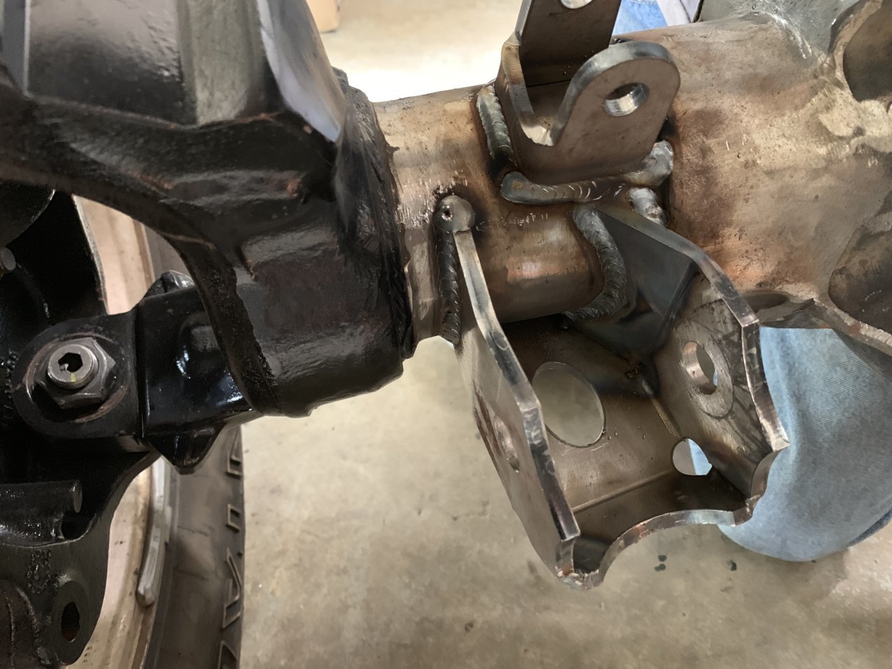

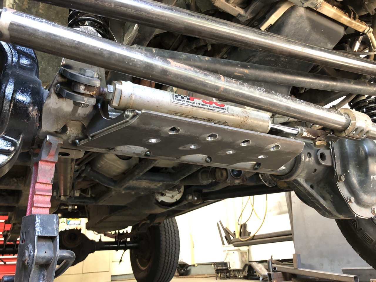

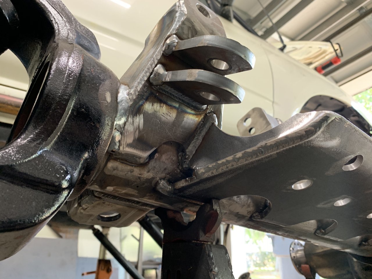

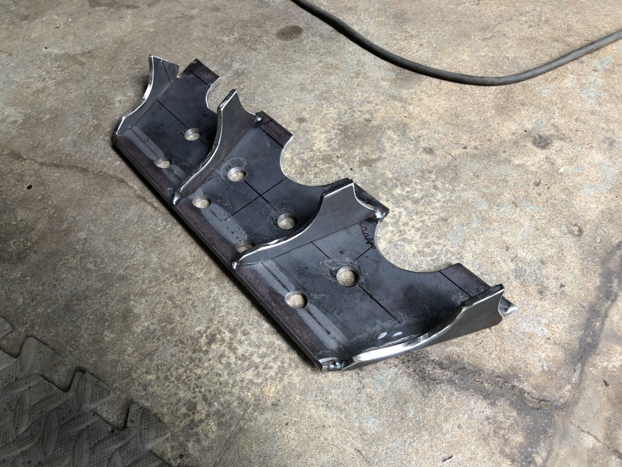

    Ram skid done. Axle is ready to pull, weld, re-gear, and paint.

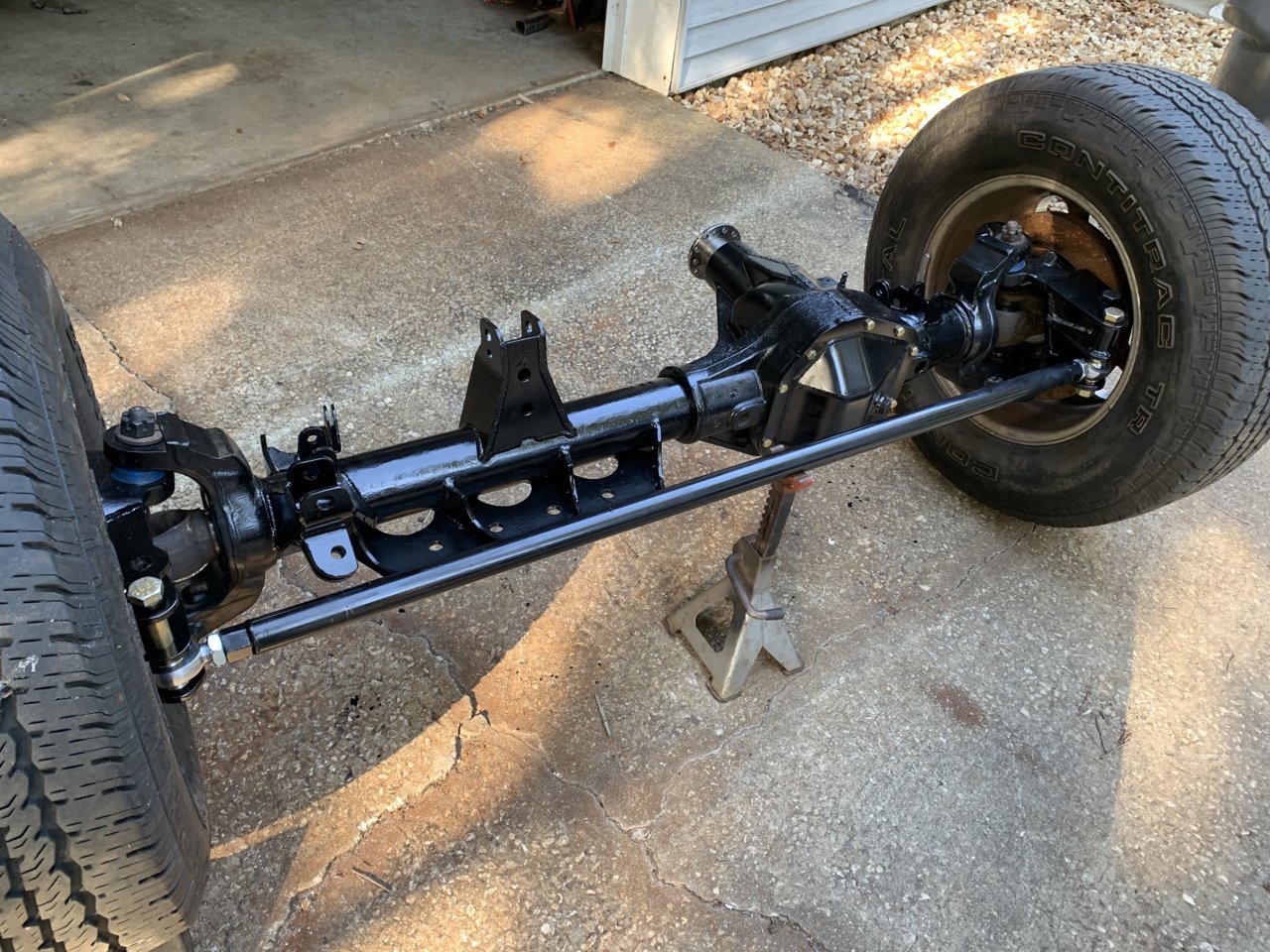

    I have no idea what I'm doing. Just wingin it...

    Should be on all fours by Monday
