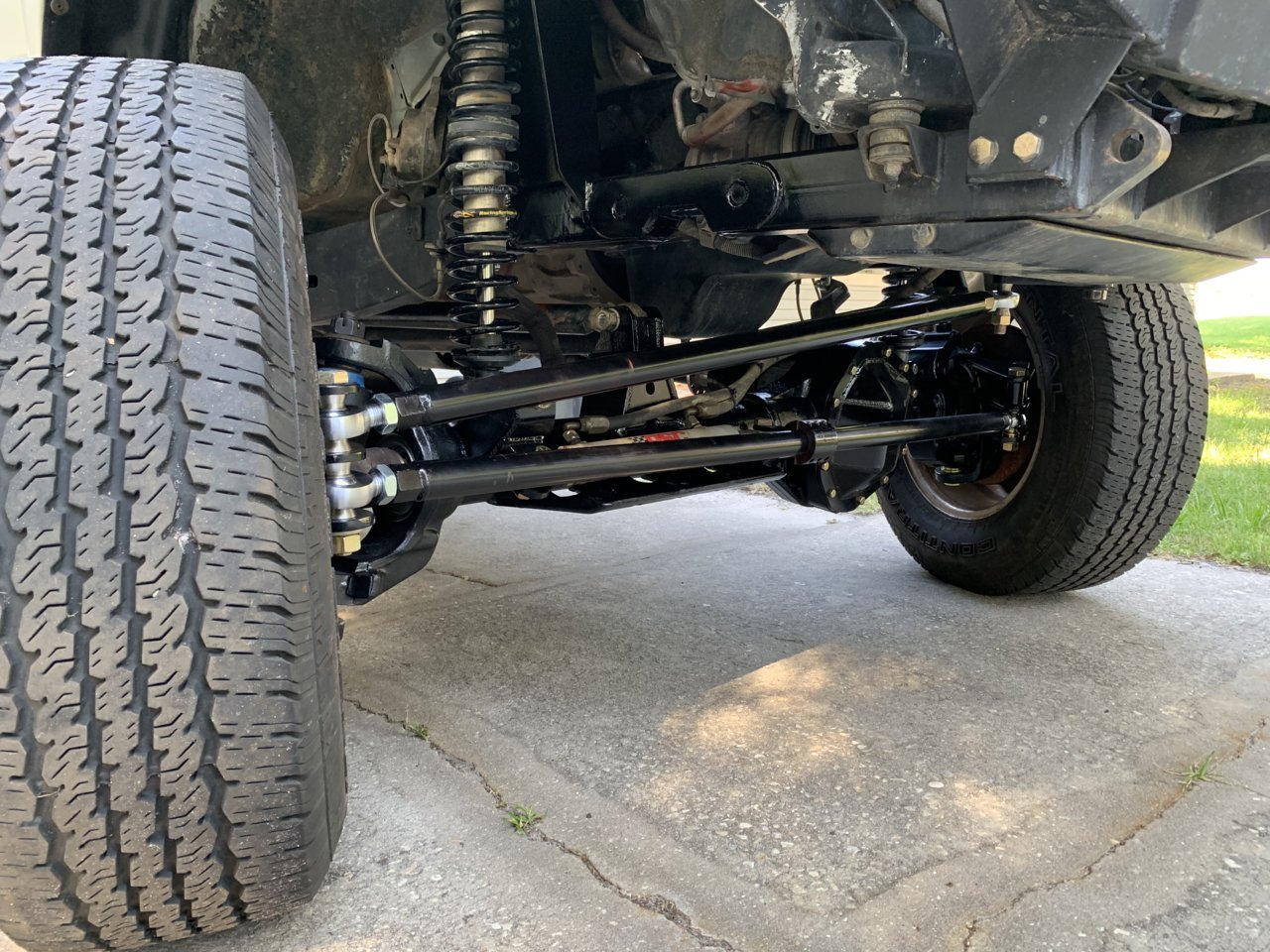

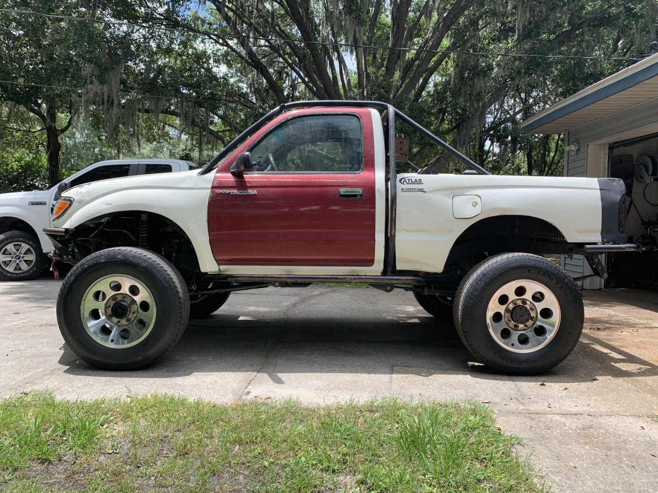

    4F01F350-683B-43EB-9C06-3C4F3F2BBBF7.jpg D3AD3373-D3D2-4FE7-AE71-8F4D76DA705B.jpg D2874AE7-D636-4AD9-A374-10A3944A37B2.jpg

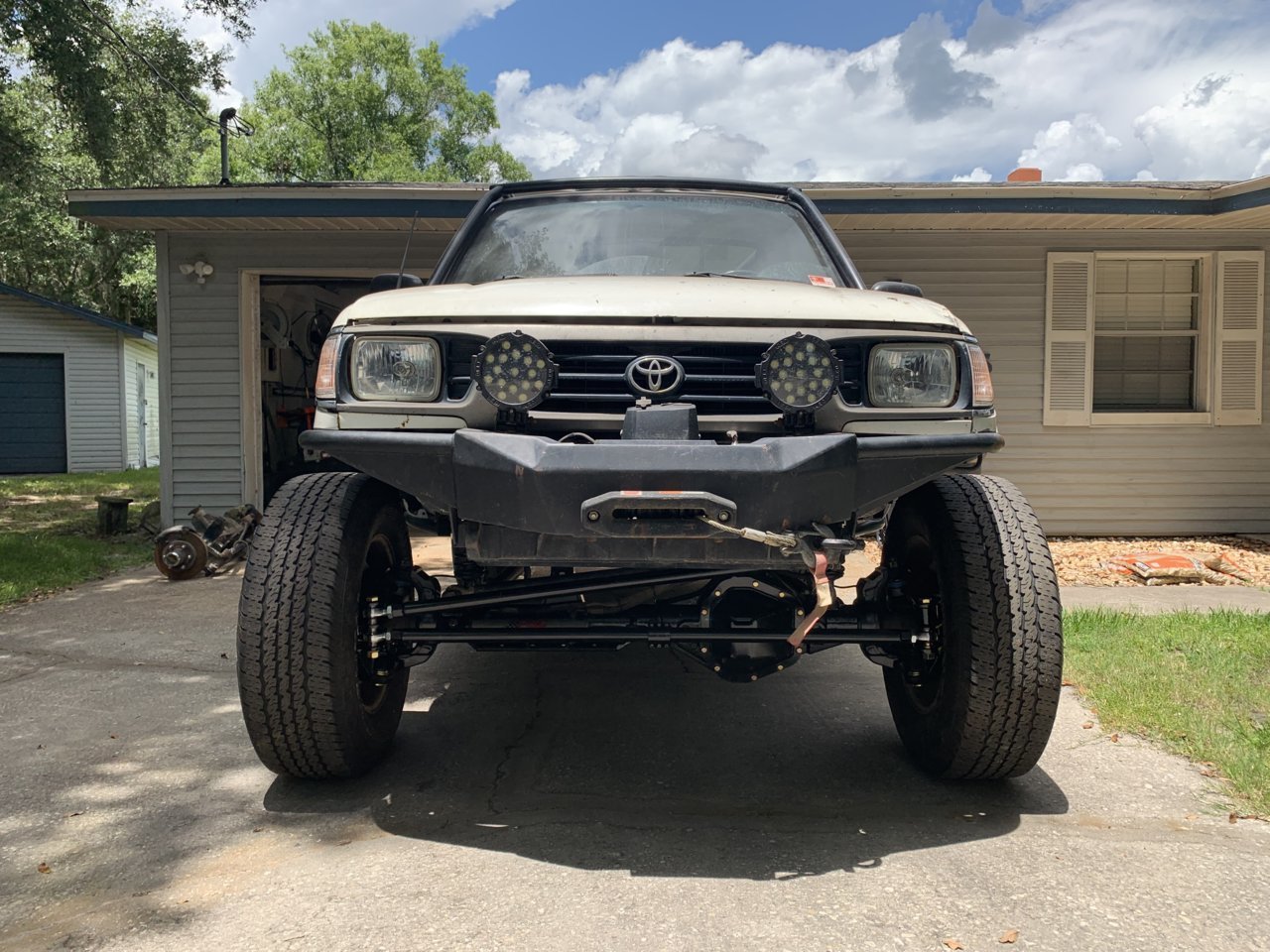

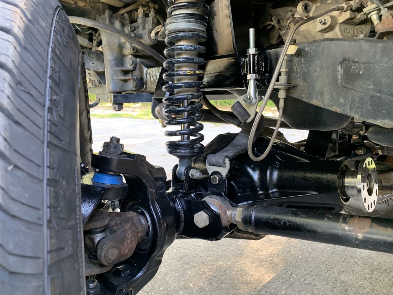

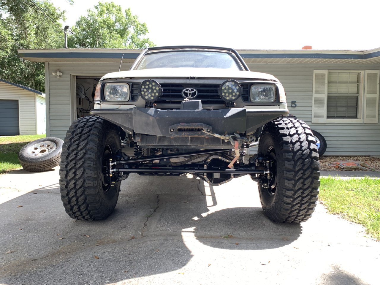

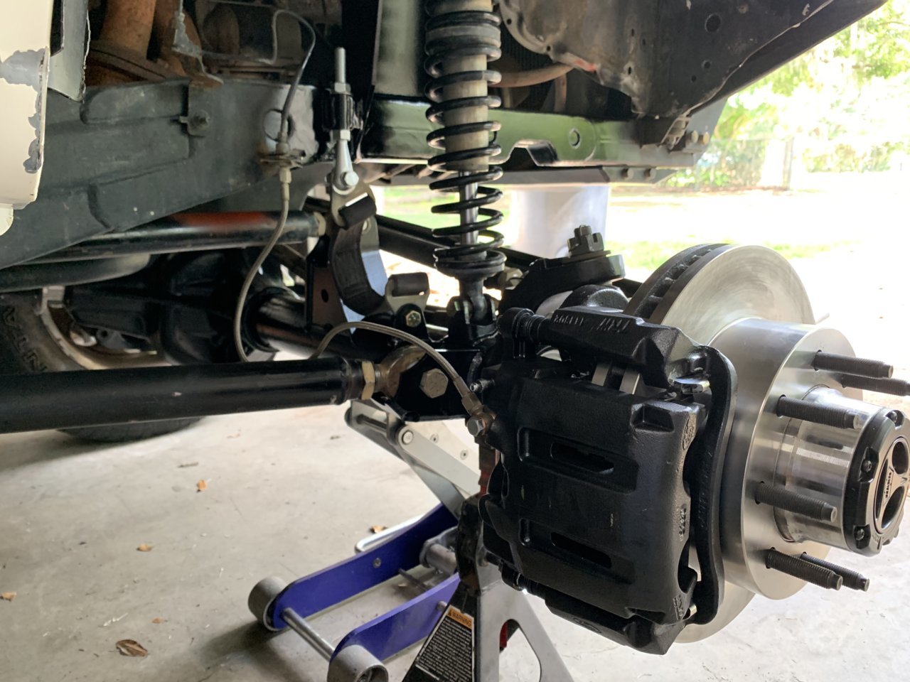

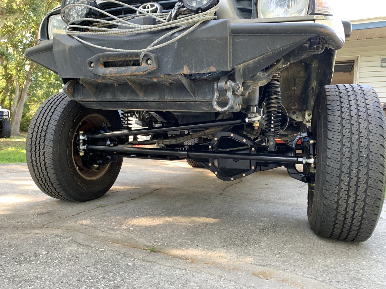

    Dropped the front driveshaft off Friday to get shortened and new joints put in and got the brakes on and bled. I knew this going in, but I'm going to need a much bigger bore master cylinder because the pedal is very soft and goes straight to the floor. No biggie though....
    C382E95D-4847-4CA5-A902-DAADACE3D45A.jpg 045F1F02-B7E6-47B7-8A72-A49BED7A656F.jpg 1D4C555A-787C-4144-A7F0-16D5D2835232.jpg D6B2941B-1462-49A0-953B-421A28F6D8EC.jpg

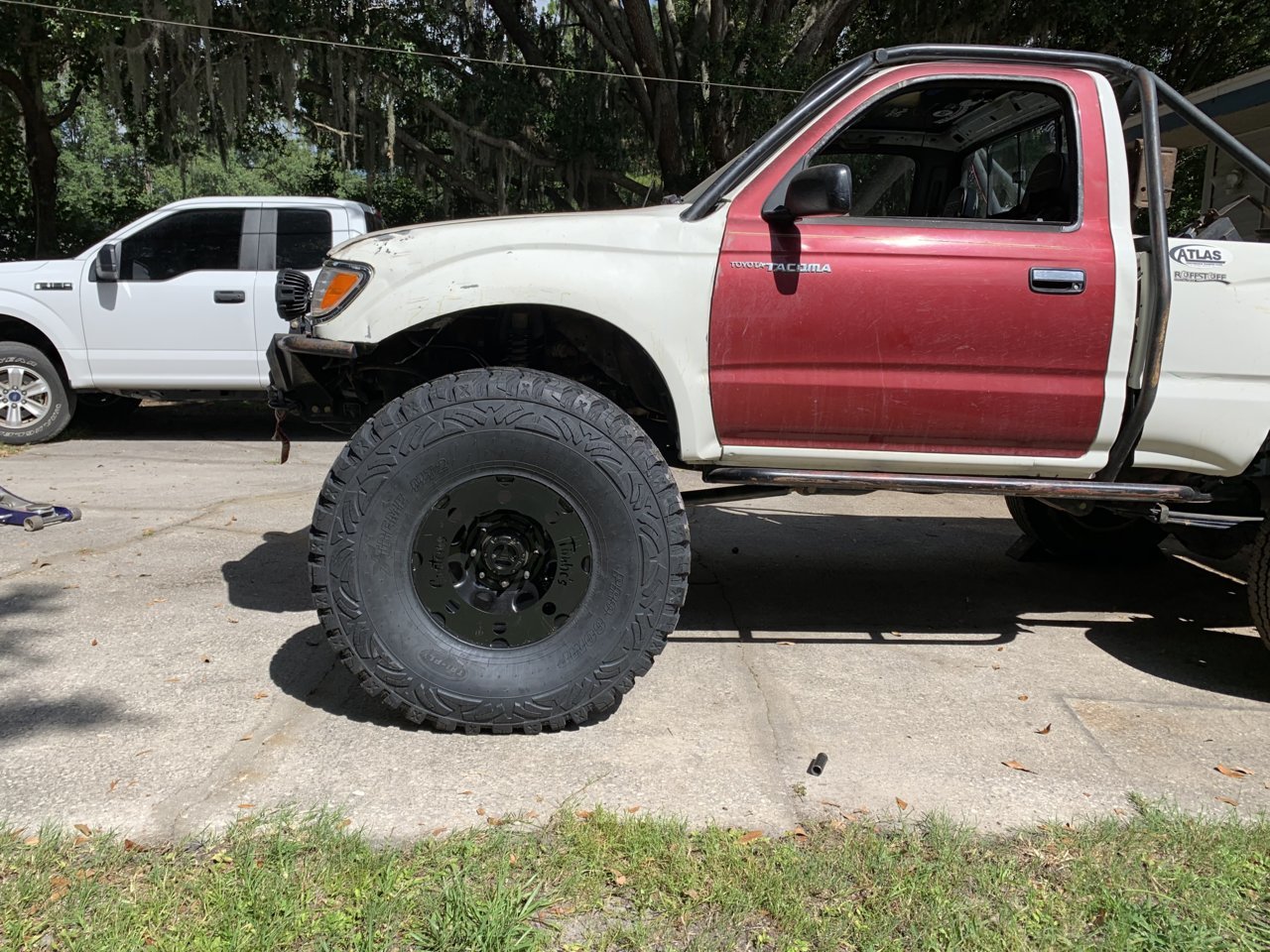

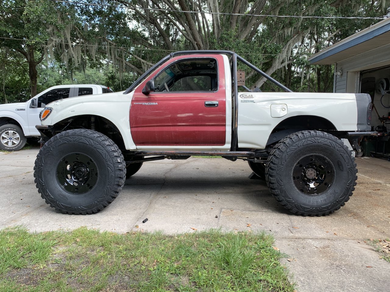

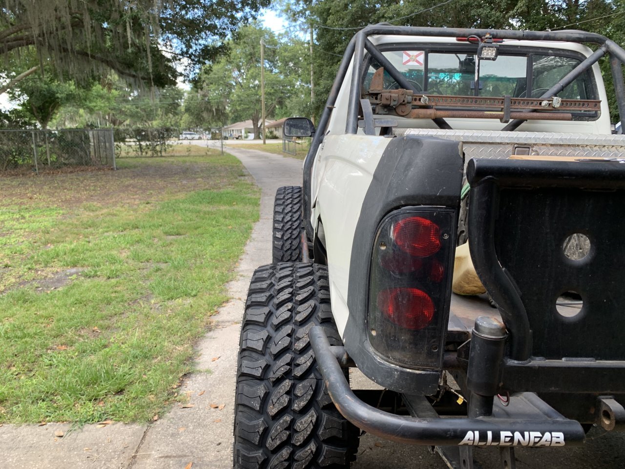

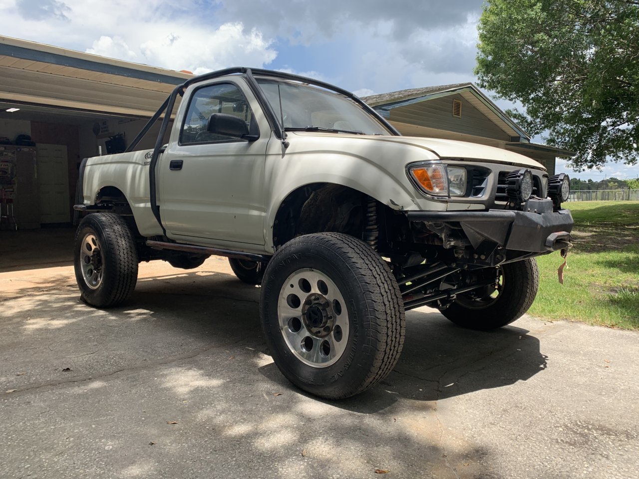

    @Timbo's Customs slid by and let me throw on his 40s just because. Def gonna stick with 37s but it looks good regardless
    E25856F2-04C8-4C9A-9AD2-045A8757D7DF.jpg C0D03AA9-8293-4A97-8597-624DCEC59AF4.jpg 2D01EC19-9282-49EB-B1D3-9C9722BACC89.jpg 1E683FBC-8940-418B-8761-07FCC91BCA12.jpg

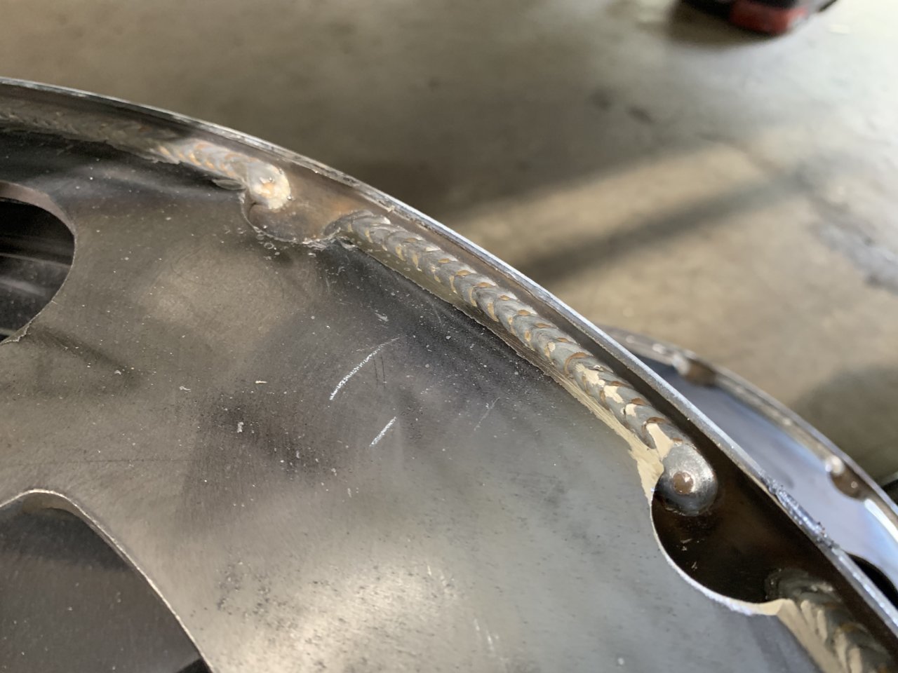

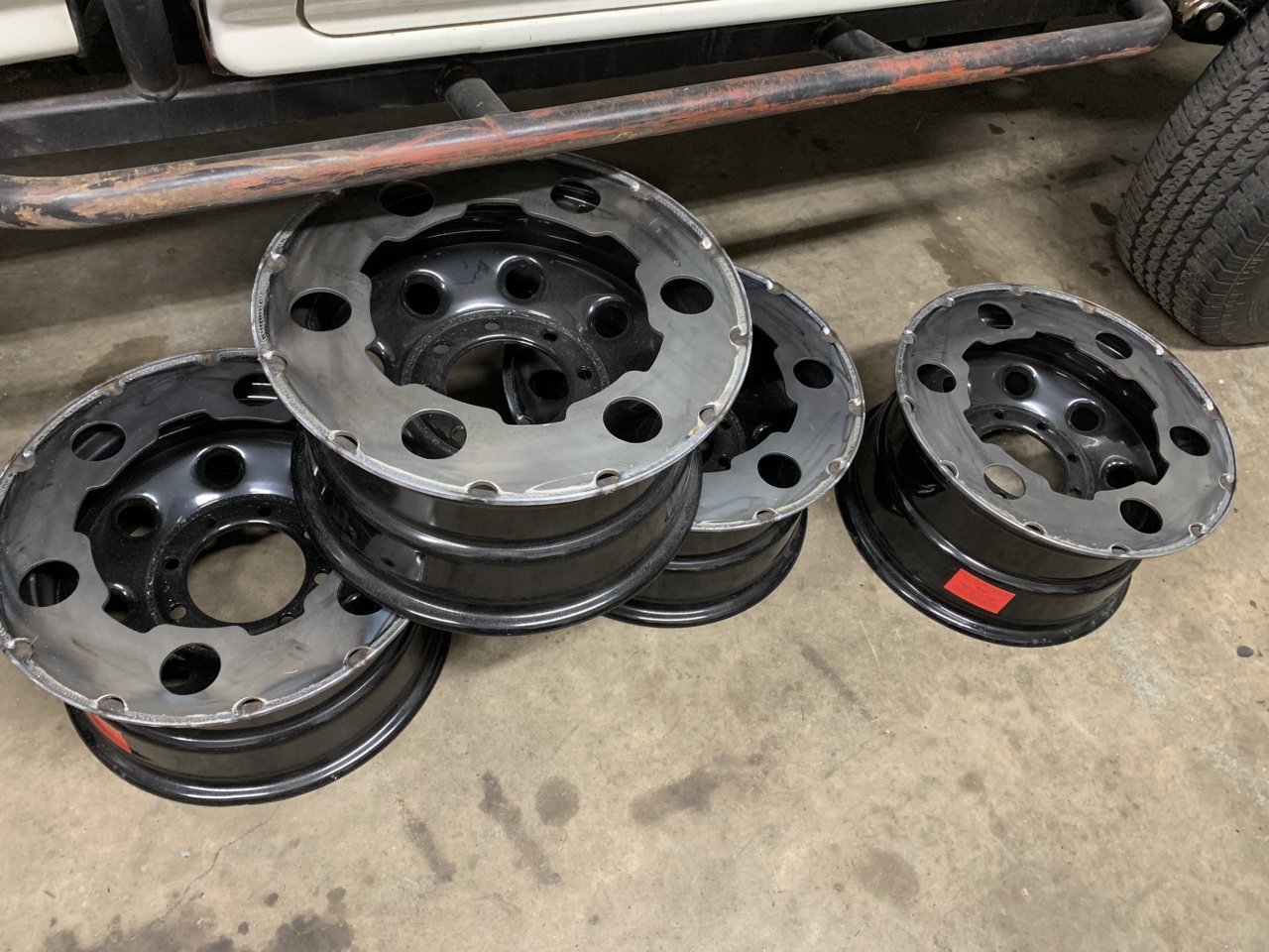

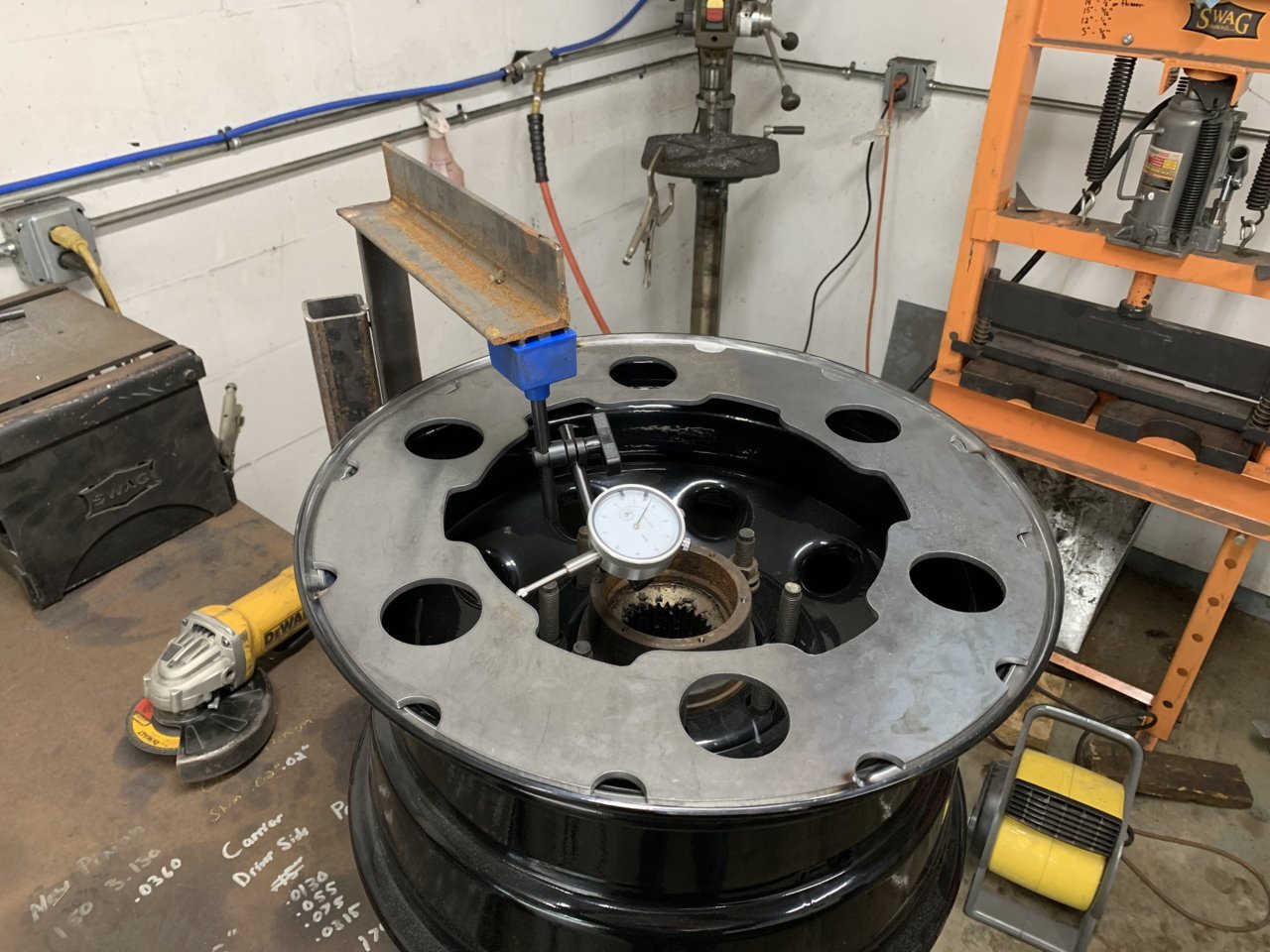

    All 5 rock rings welded on with a possibility of this thing sitting on 37s by next week
    7CB08D4D-31A3-4985-9A53-F6BCA07AB3A3.jpg FEF4CDC2-A921-4DAC-8160-8E7619BBA92E.jpg
