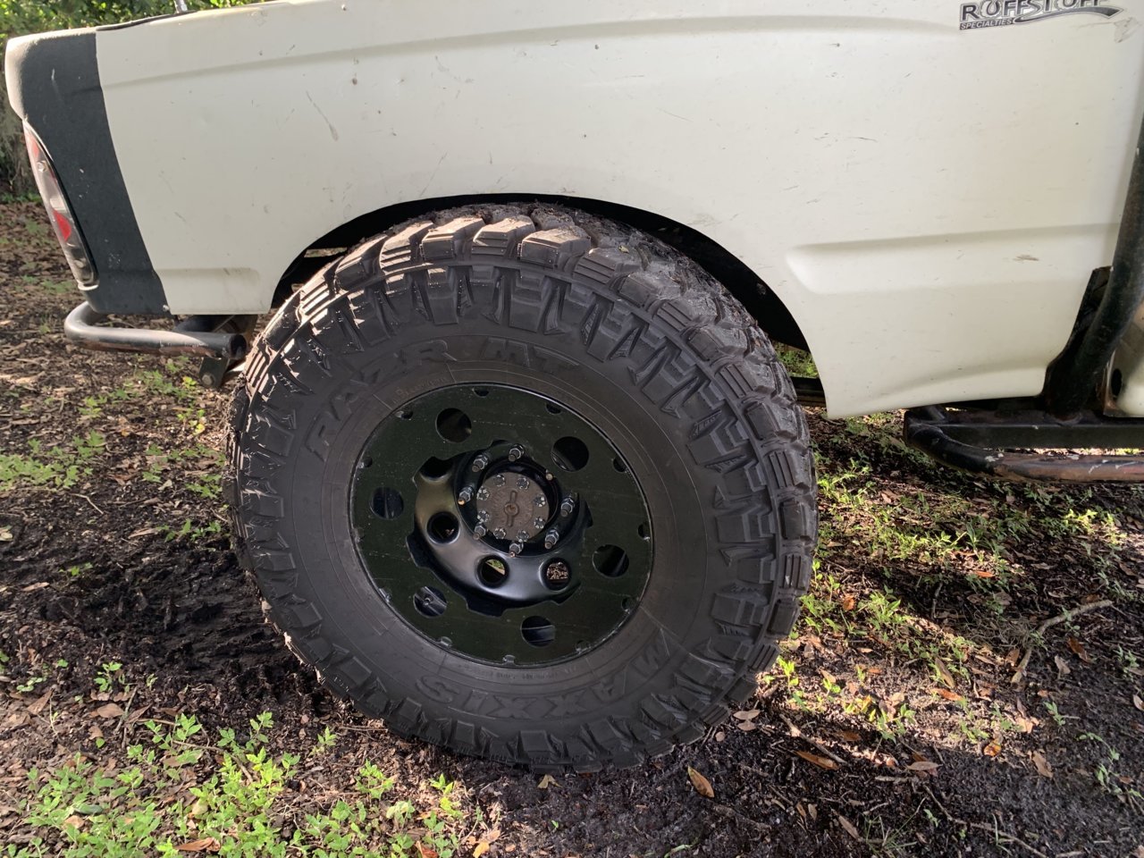

    Ordered the wrong install kit because I'm a moron, so the correct stuff will be here Monday and then I can start

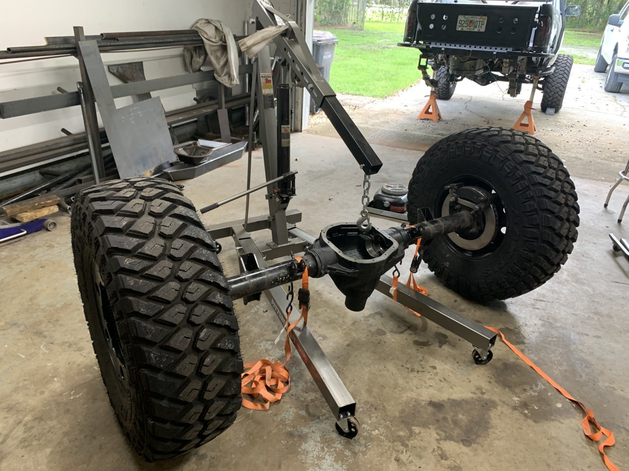

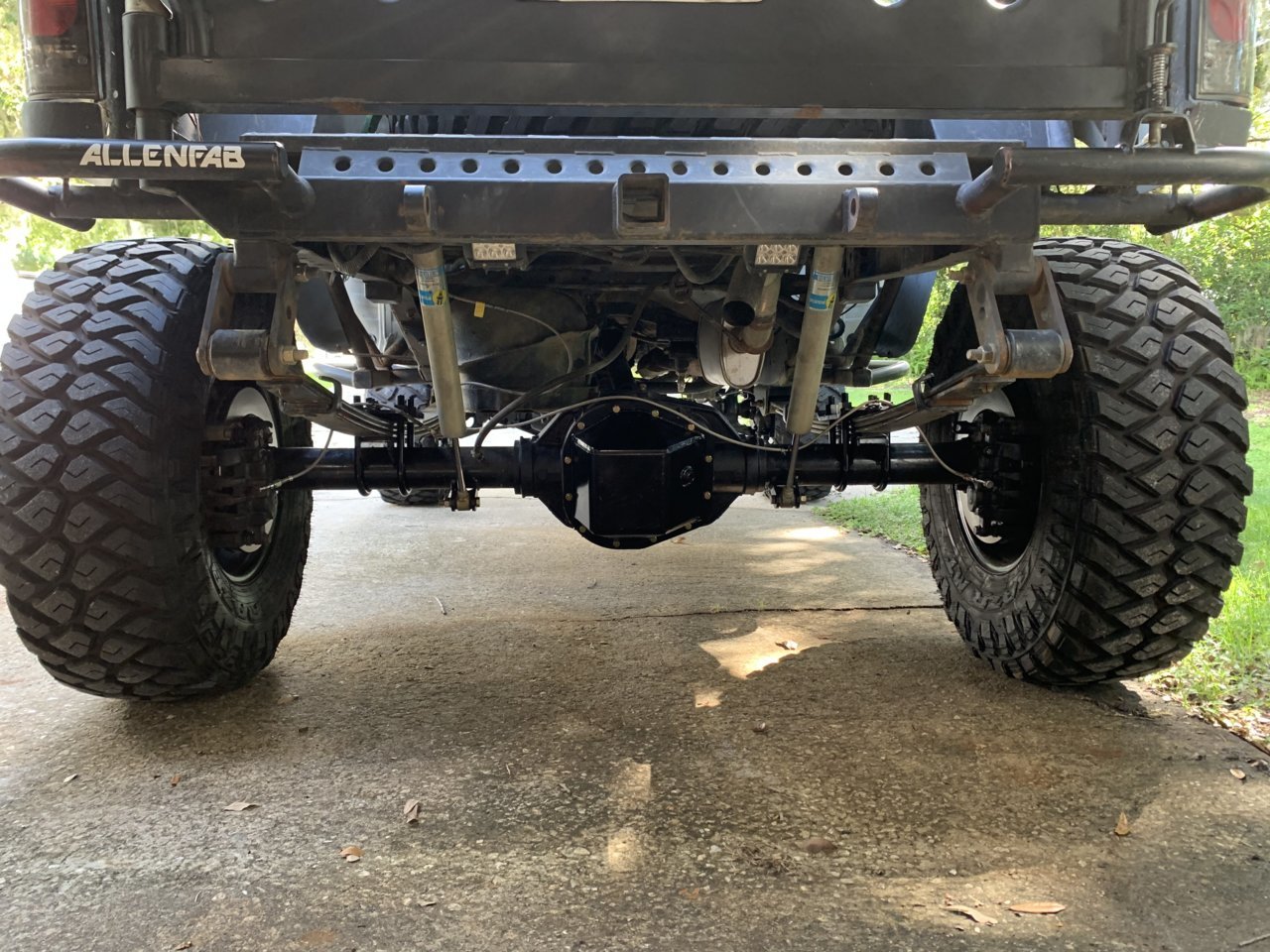

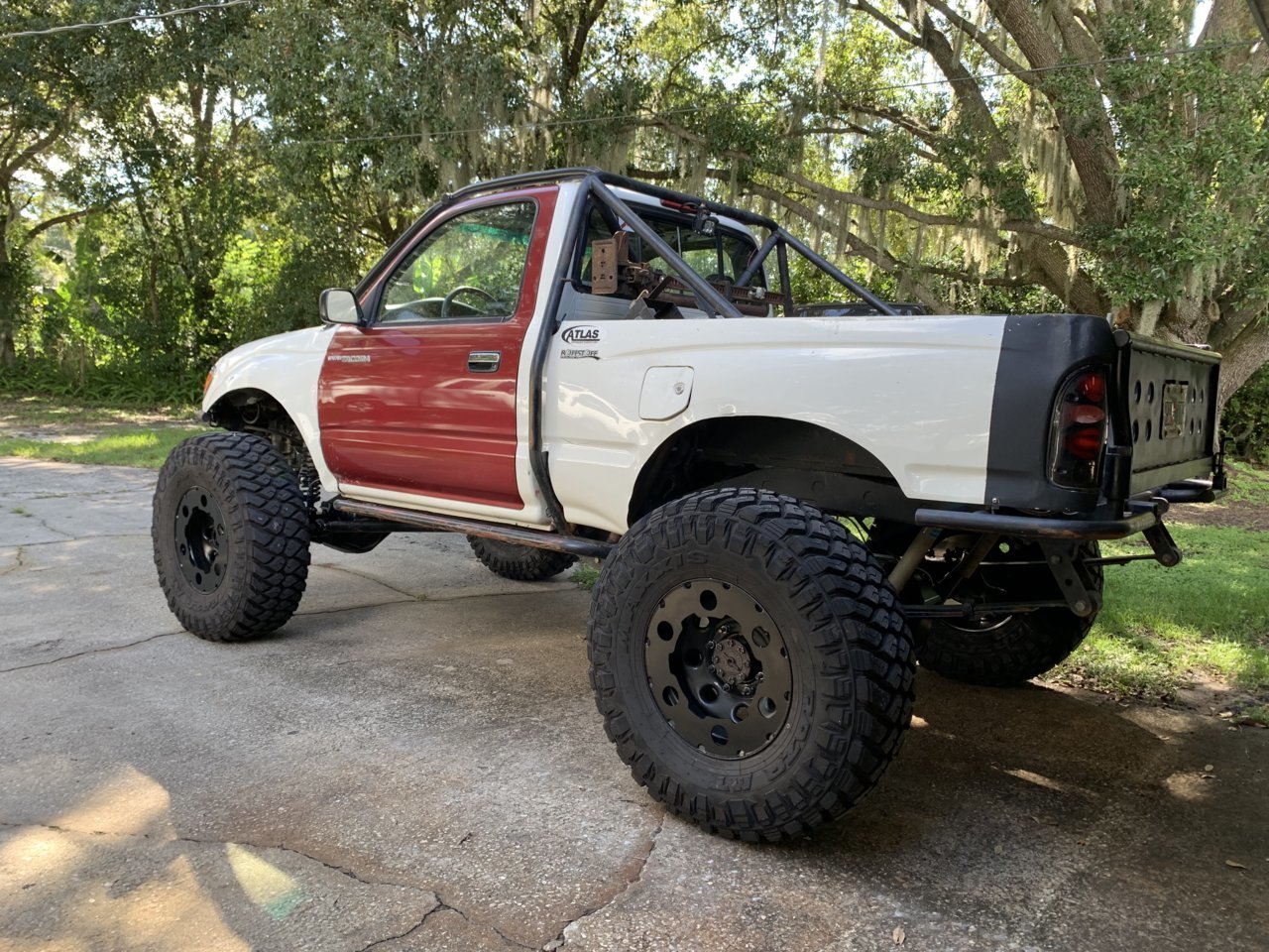

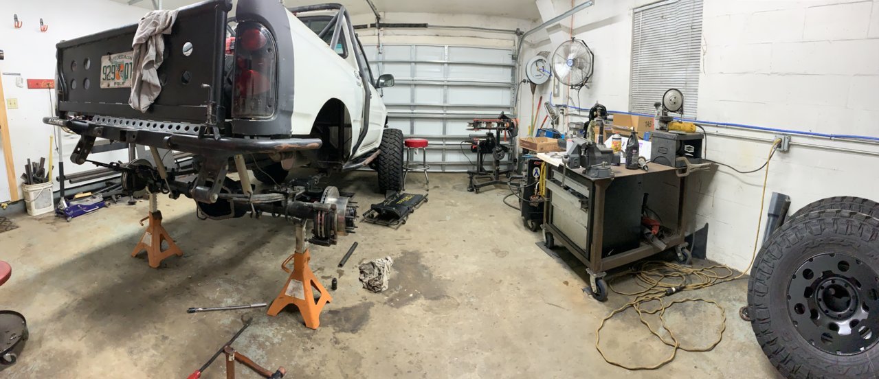

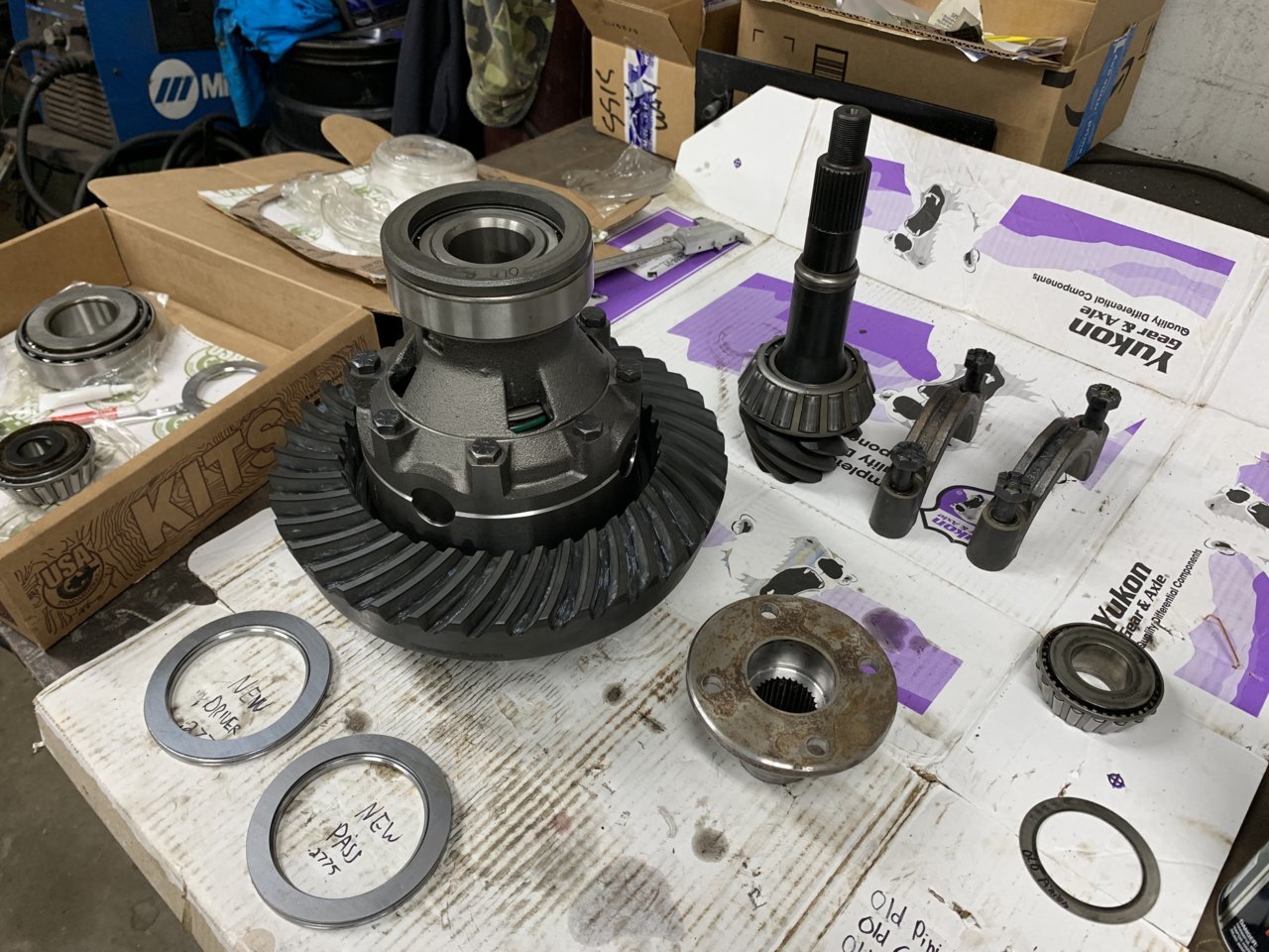

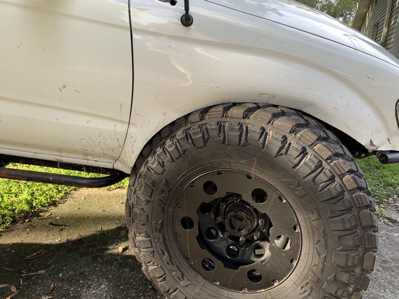

    Gears and locker done
    All suspension heims replaced
    Other than the gear break-in procedure, it's ready to wheel
    C3369CFF-550E-4ECC-9CB2-5B83AF6DF5F8.jpg CC07A8AD-A70B-4A25-B324-45DCBCF6A073.jpg

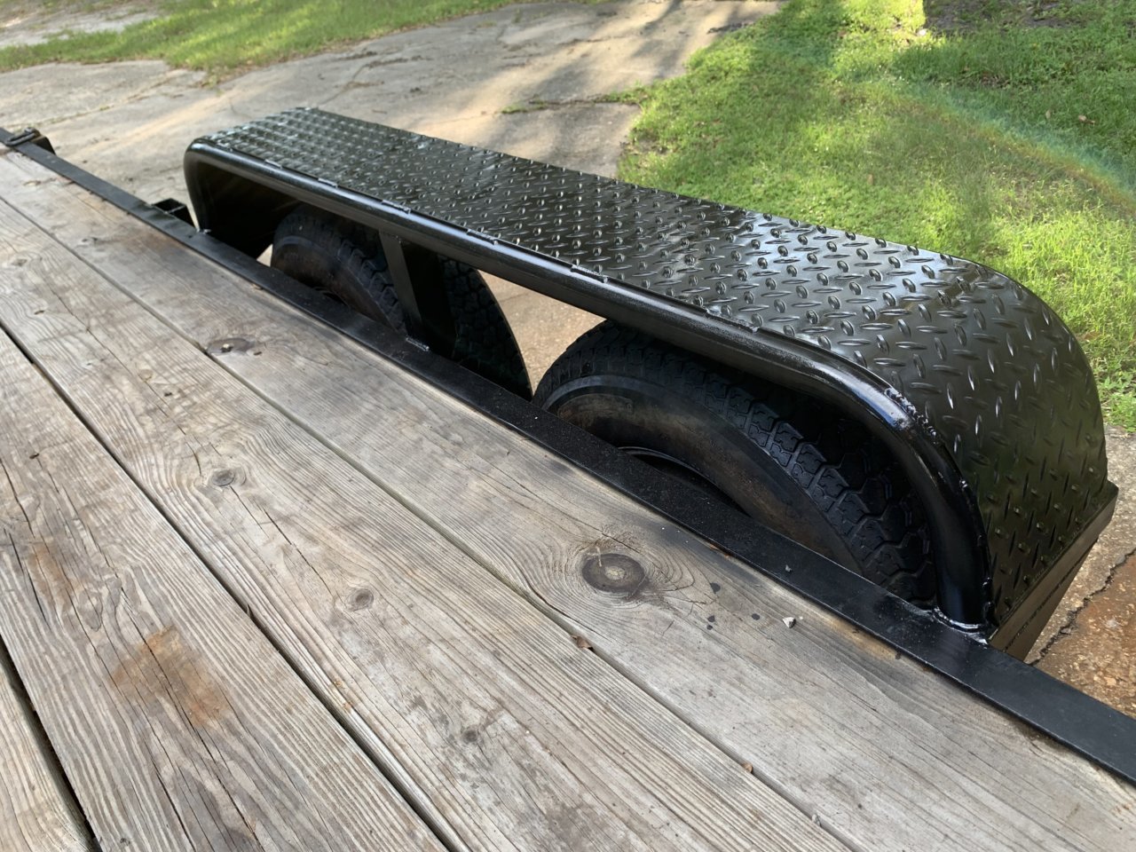

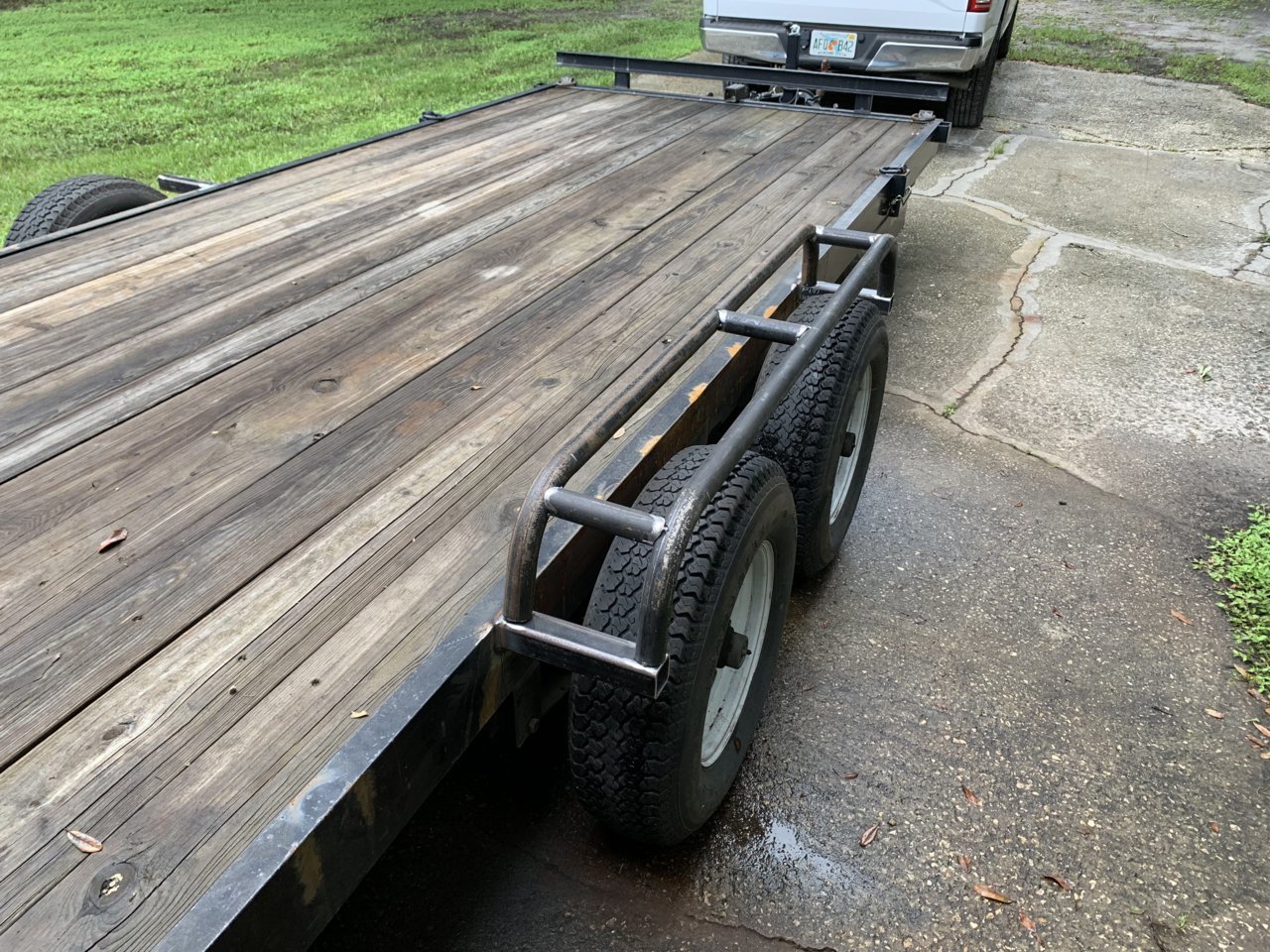

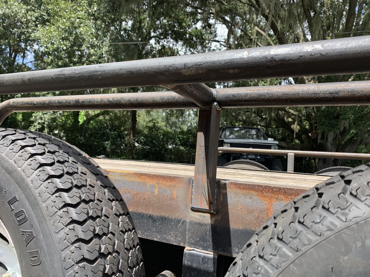

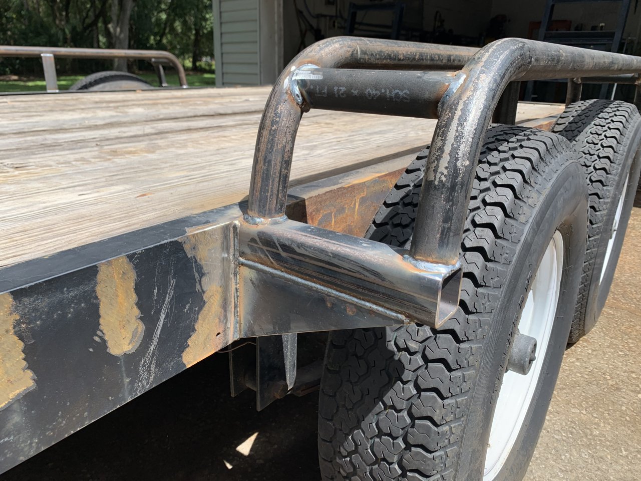

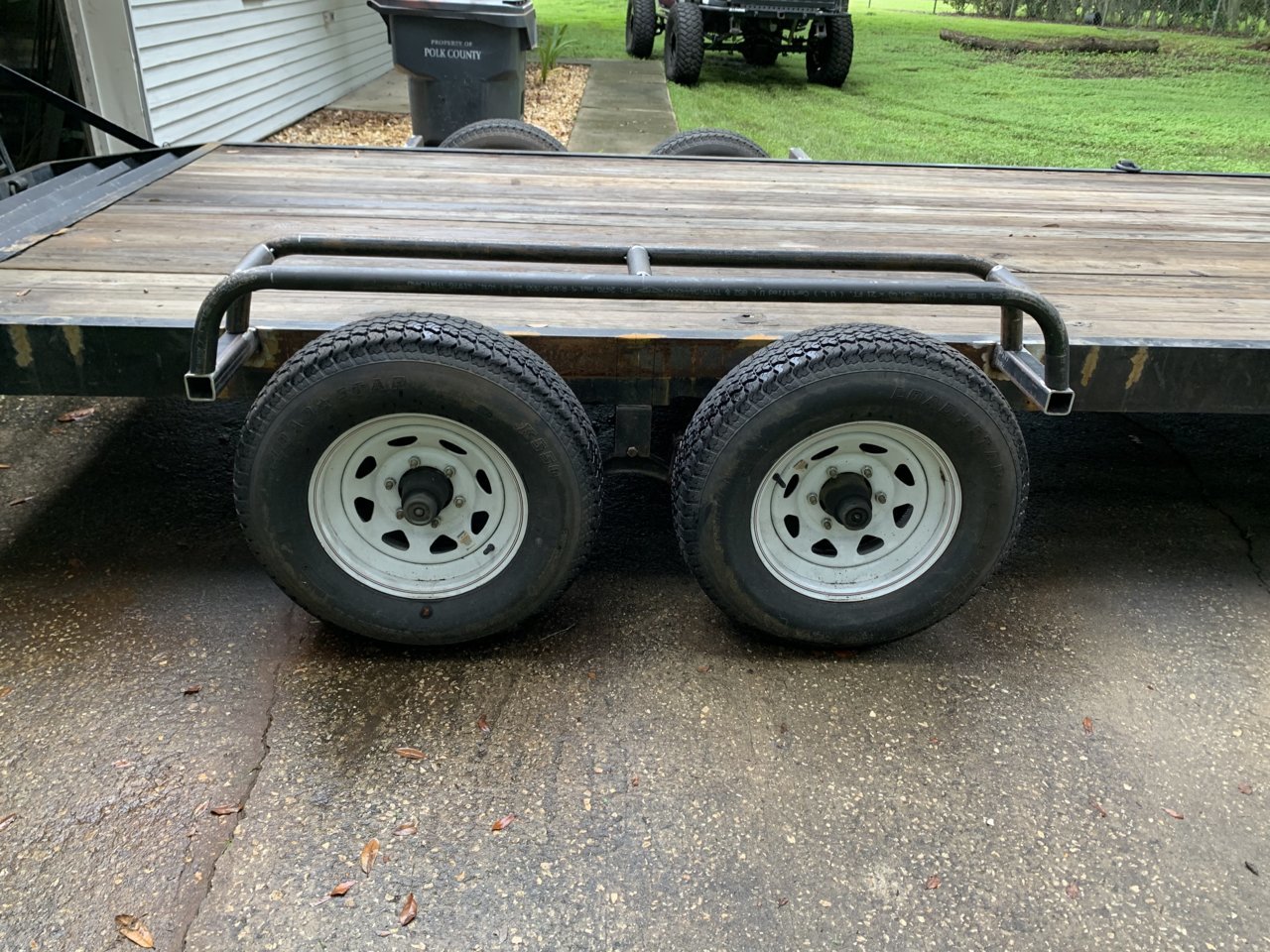

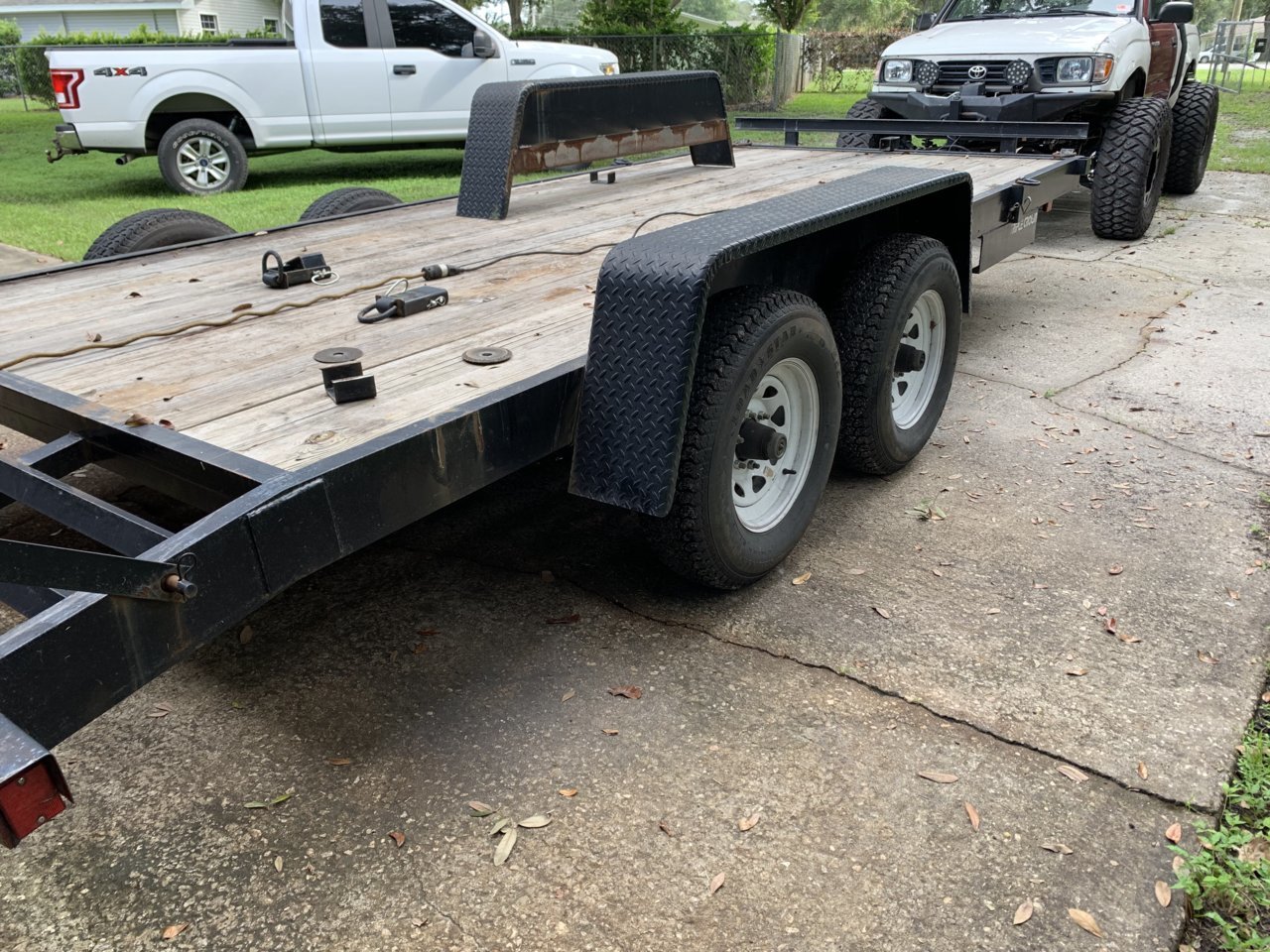

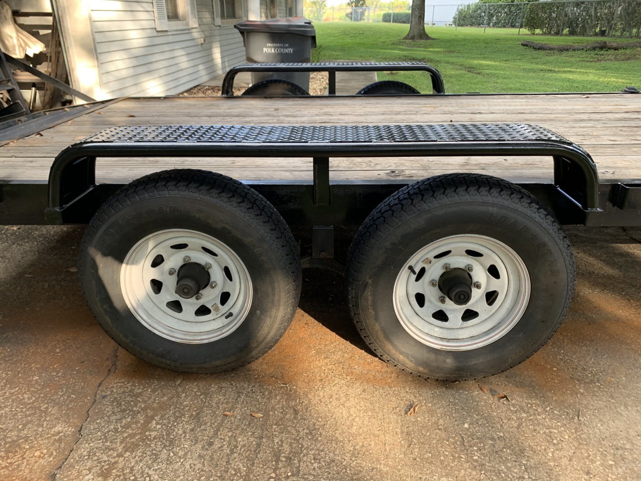

    Time for drive over fenders and widening the trailer
    BFB9BFE0-5D2C-4DC6-AAE9-CD3185624AA9.jpg C328F945-3B56-4FDA-87E3-F61CACF5AC44.jpg 33486522-91CD-4D4D-92F1-265AB3C8F5BD.jpg

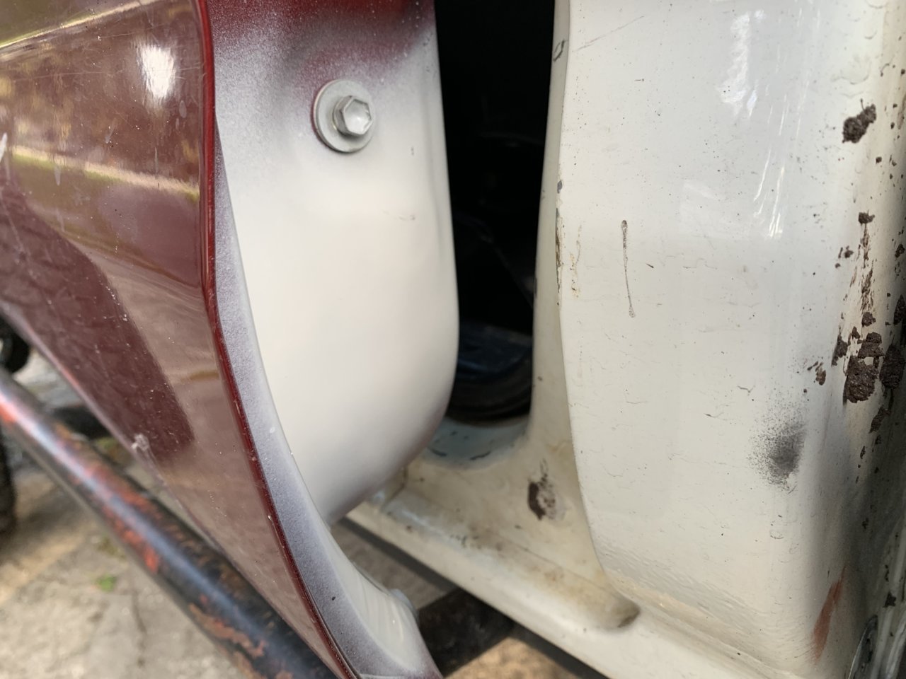

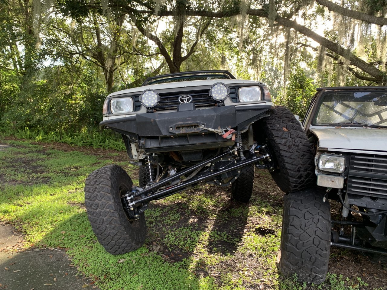

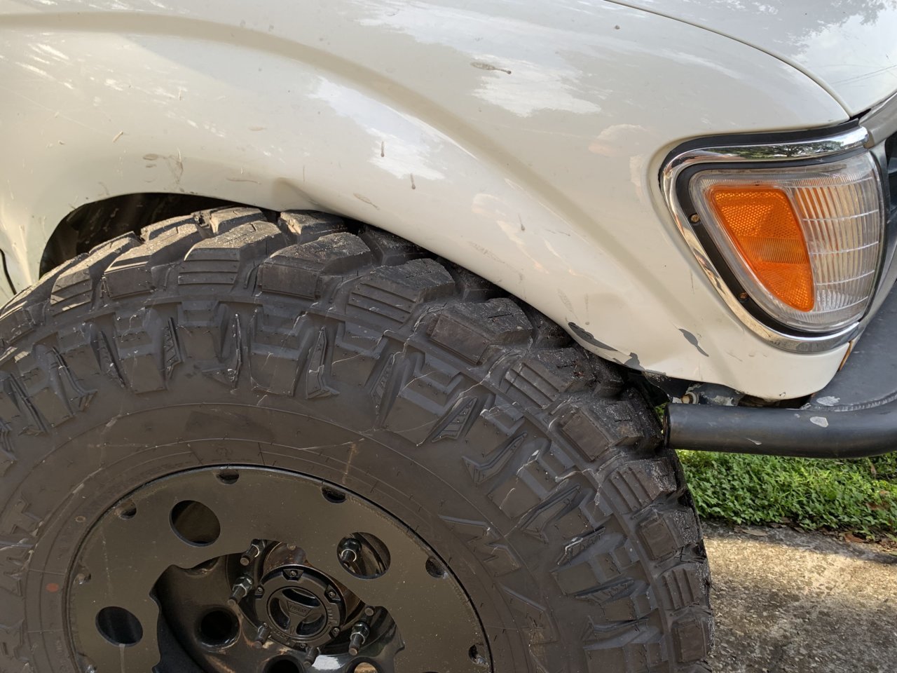

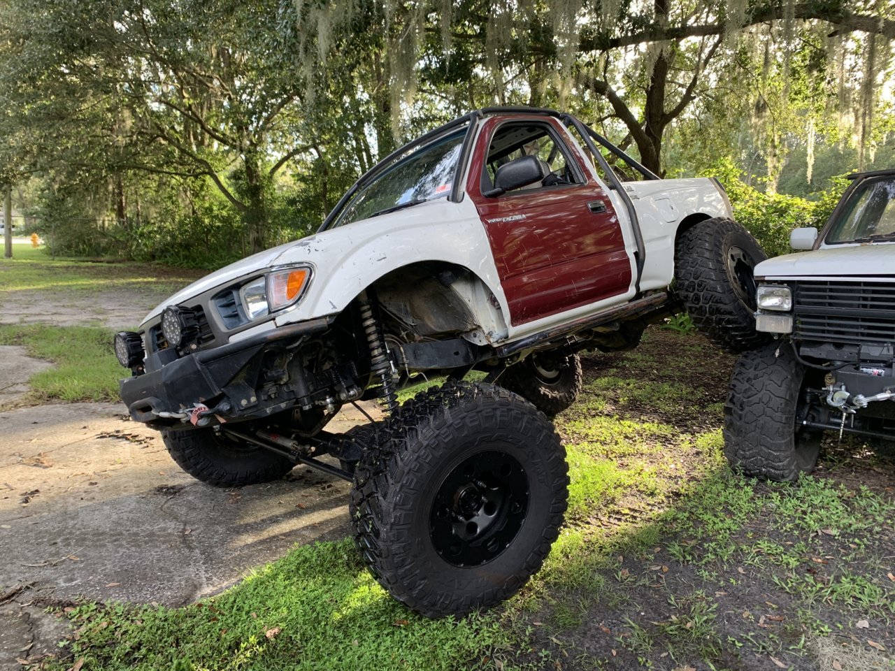

    Got around to flexing it today, and my findings are that I need a tad bit more trimming and need to get some shorter limit straps. The firewall clearance looks like it's just enough, but I'm going to beat it in a little more, and then trim the inner and outer fenders some more and I should be good there. As for the limit straps, the old 15" straps on there now are too long and are letting my coilovers extend all the way out, so I am dropping down to 11" straps to prevent that from happening and to prevent some steering heim bind that is occuring as well.

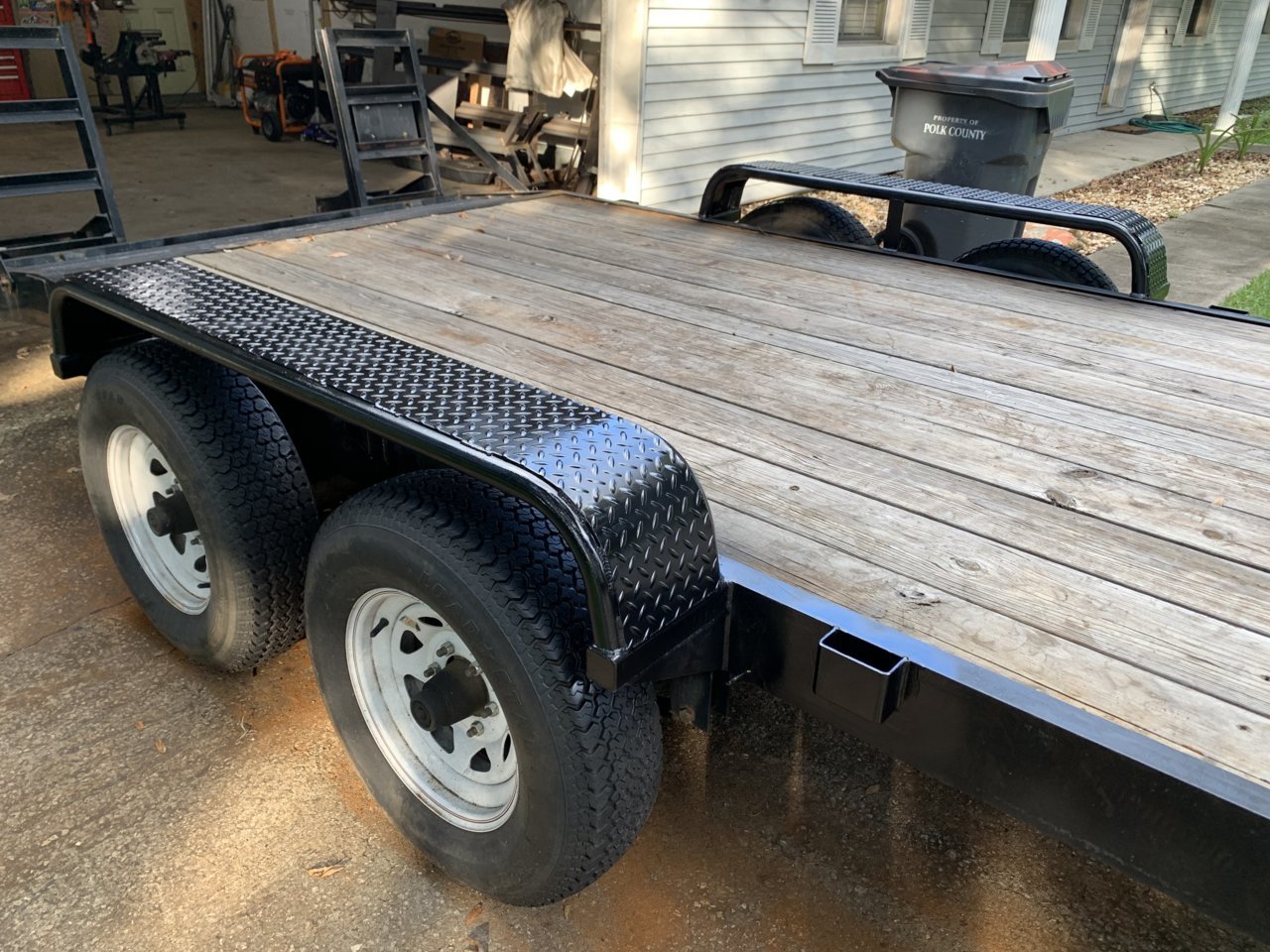

    Fenders done
    FAF7FC3B-5267-4B82-B079-574A00CEA2A8.jpg 466C17B7-0F59-480C-9EDF-41A711216048.jpg 21E5A8E9-003A-4B82-B039-5FA1762BE78D.jpg
    And maybe a little color matching
