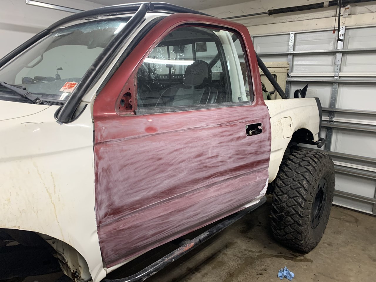

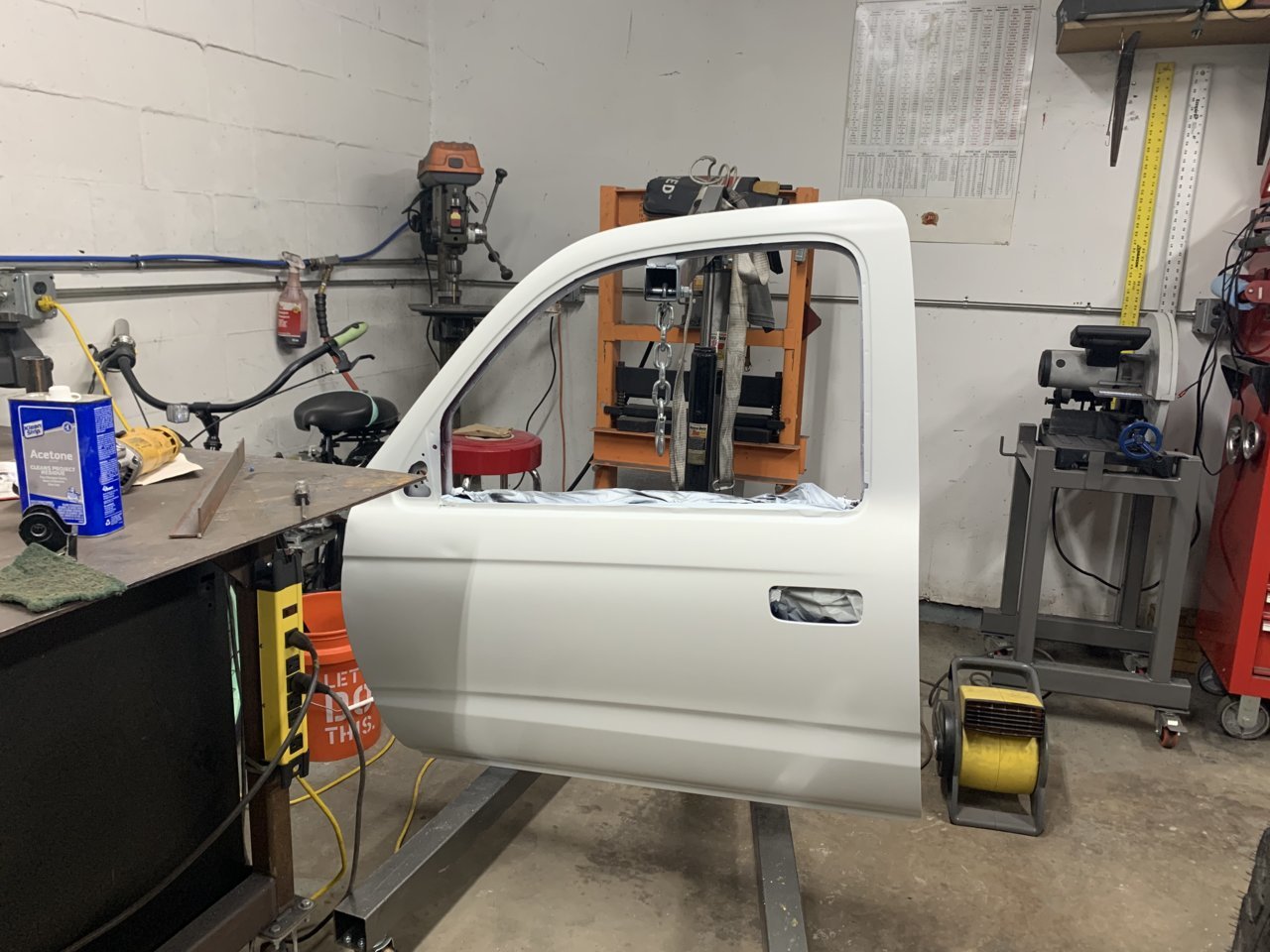

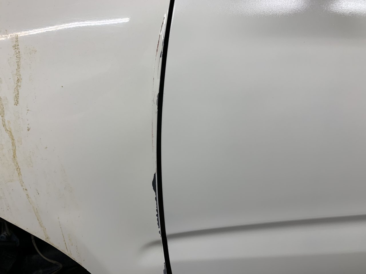

    Got around to painting the red door back in November after a year and a half having it. I used the dupli-color matched spray paint from AutoZone.... Pretty good match

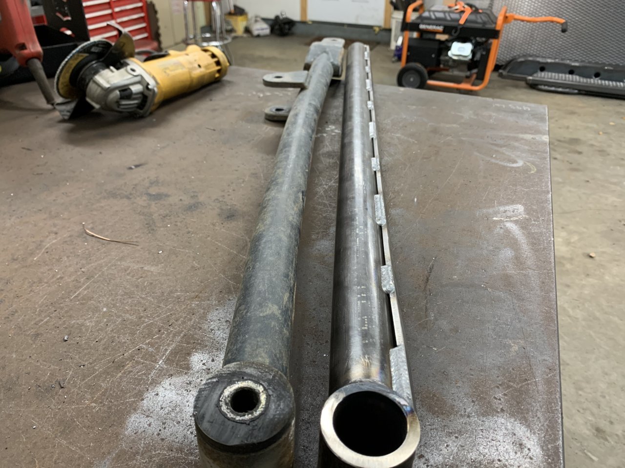

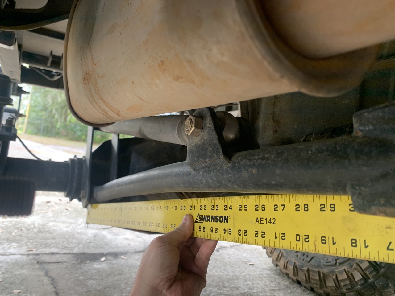

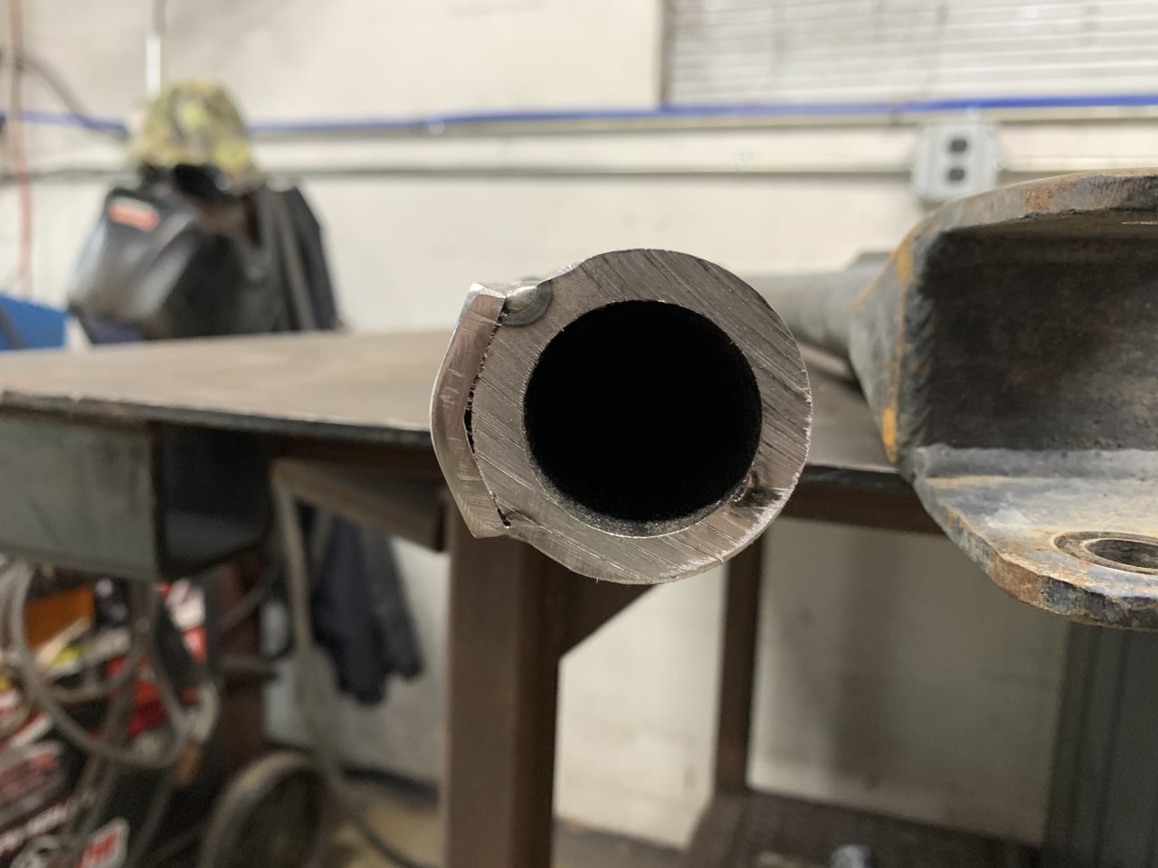

    Did this while at River Rock. Going to jump from the original bent 1.25" sch. 80 pipe on the bottom to some 2" .250" DOM

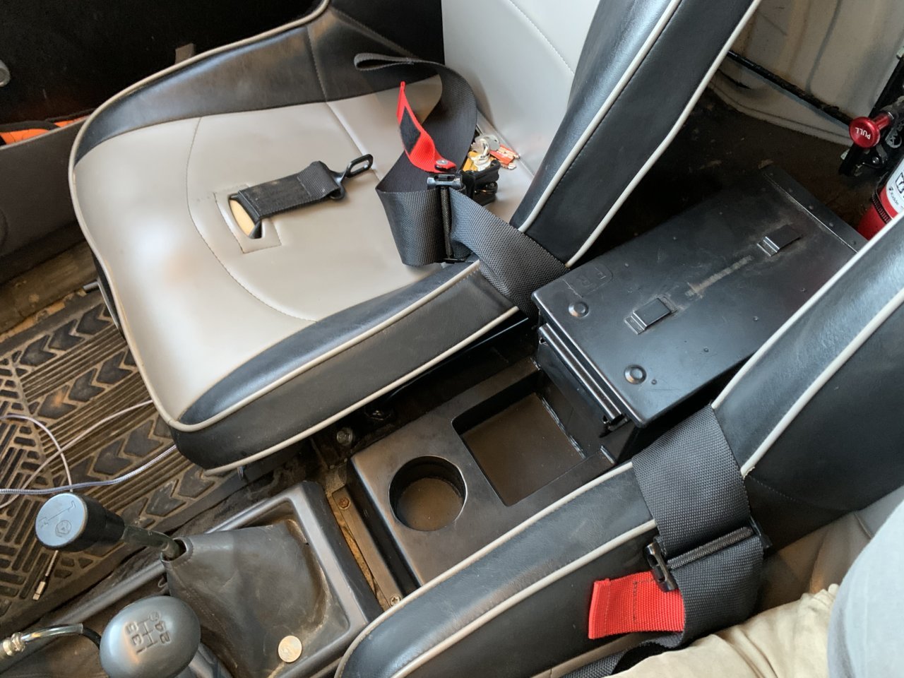

    Made the .50 Cal center console I built for the original bucket seats fit in between the new(ish) prp seats. No more phone and other shit rolling around on the floorboards constantly

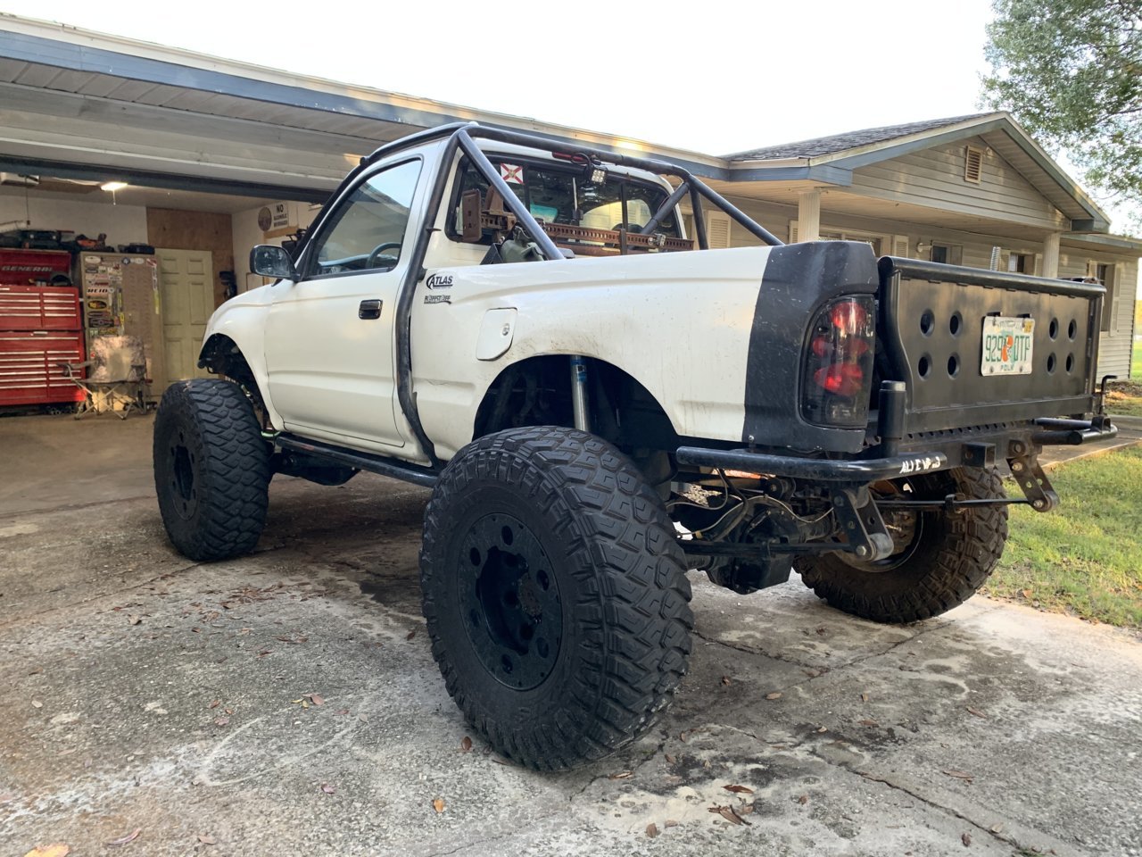

    Also got the new booster and master cylinder installed and re-ran a couple brake lines coming off of the master to the distribution tee below it with some braided stainless. Everything is fully operational again in preparation for the Alabama trip in March :D

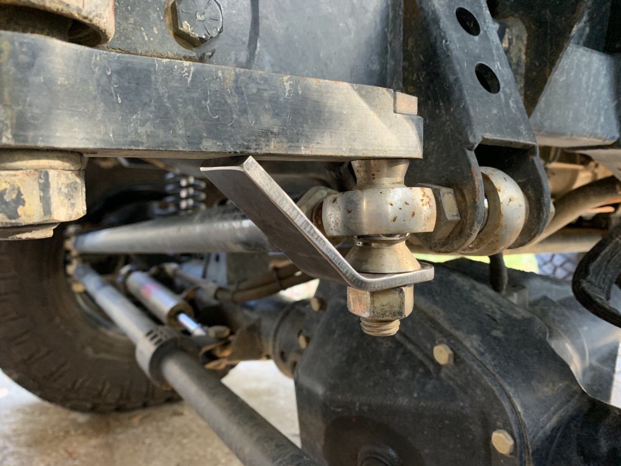

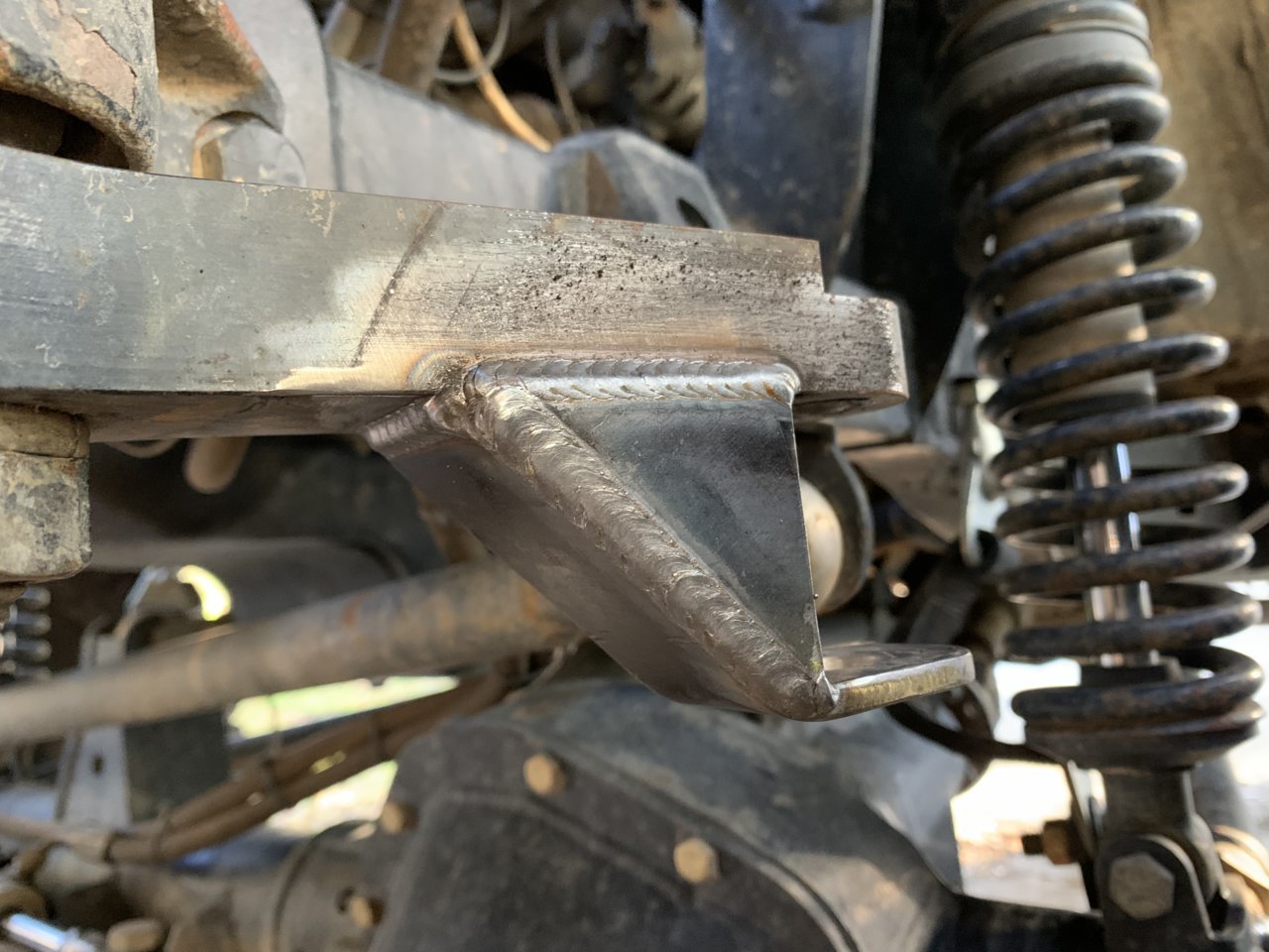

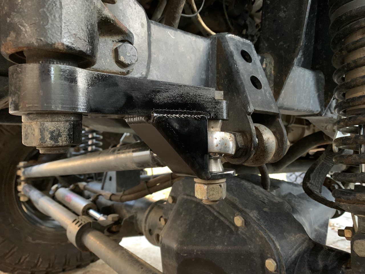

    Double shear on the pitman arm finally

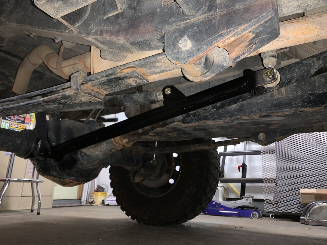

    New lower traction bar section... 1.75"x.250" DOM with a 3/16" reinforcement bar on the bottom.

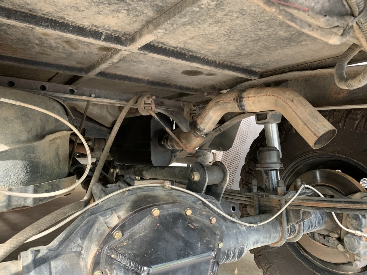

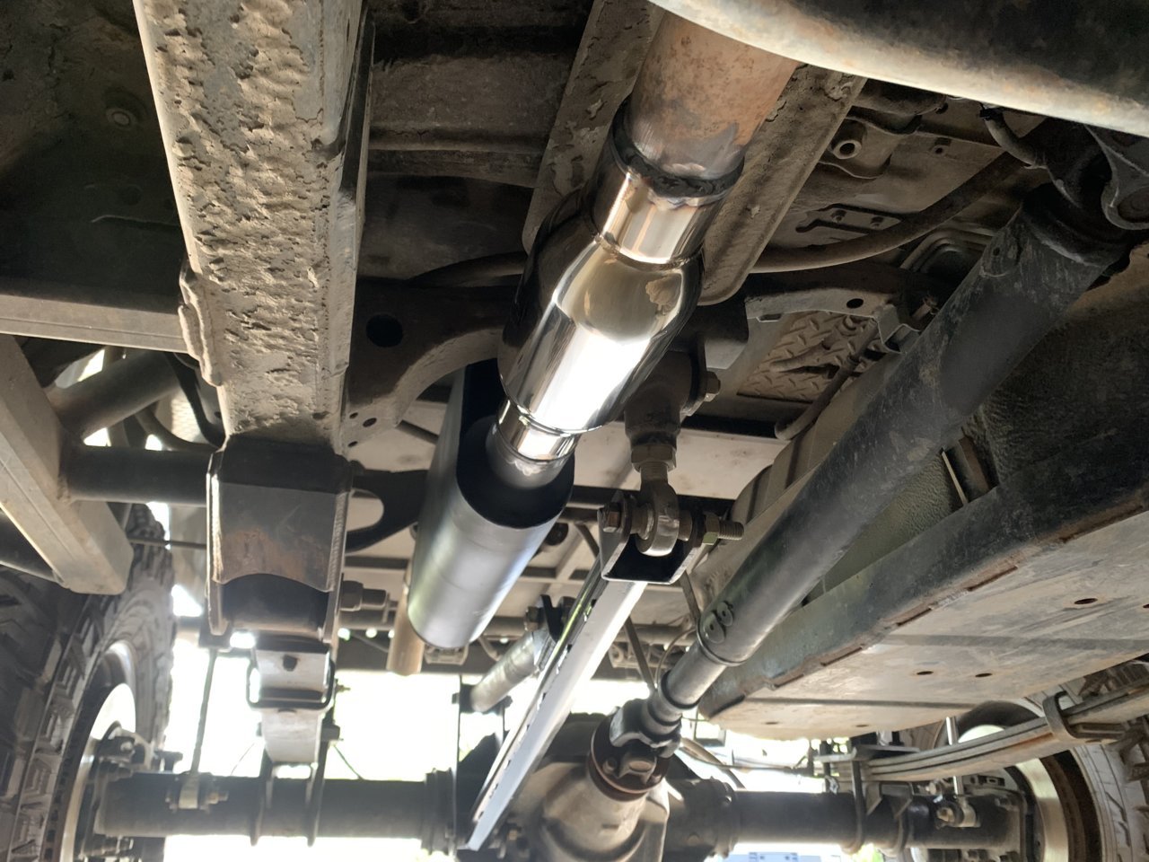

    The $40 summit racing muffler that I had literally started to fall apart after only one year... Leaked at the ends where they were crimped to the case and rattled like crazy. Decided to spend a little extra and did a resonator and flowmaster delta-flow 50 muffler. It's pretty much right where I want it sound-wise, a tad bit of a low tone but still quiet. Hopefully this is the last time I do this exhaust

    I think I need to get a resonator for the OGT to get rid of the raspy sound it has. I love the sound of the Super 50 on the T4R although it is a little louder than I had hoped it would be.

    $53 for the resonator that I bought, totally worth it. Nice stainless steel with quality welds, super easy to throw in there in front of the muffler and run

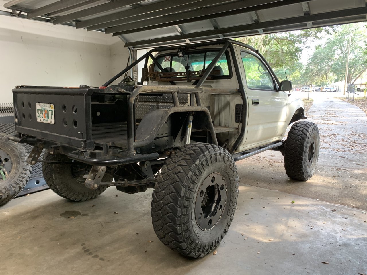

    The saga continues...

    Finally gonna build that overland cage you were talking about?

    Probably gonna put that 50 cal mount on there for when we go full-on insurgent. Toyota trucks...the insurgent's heavy machine gun mount of choice everywhere. :thumbsup:
