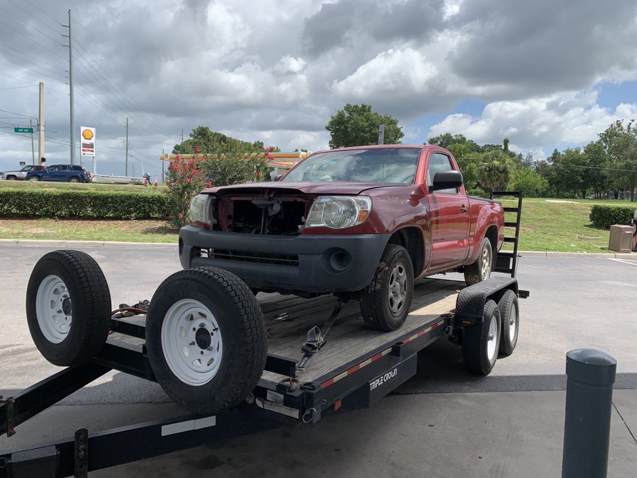

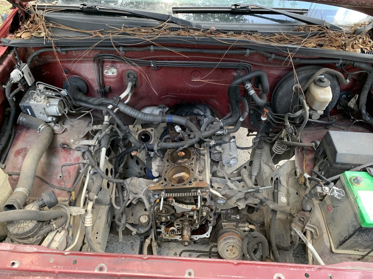

    Picked up a 2008 reg cab 5-lug with a disassembled 2.7 (bad head gasket) for $2k with 277k miles. Decided to part out most of it, keeping the body, frame, and interior for a base build. I'm going to actually keep track of costs on this one in an attempt to keep the price relatively low.

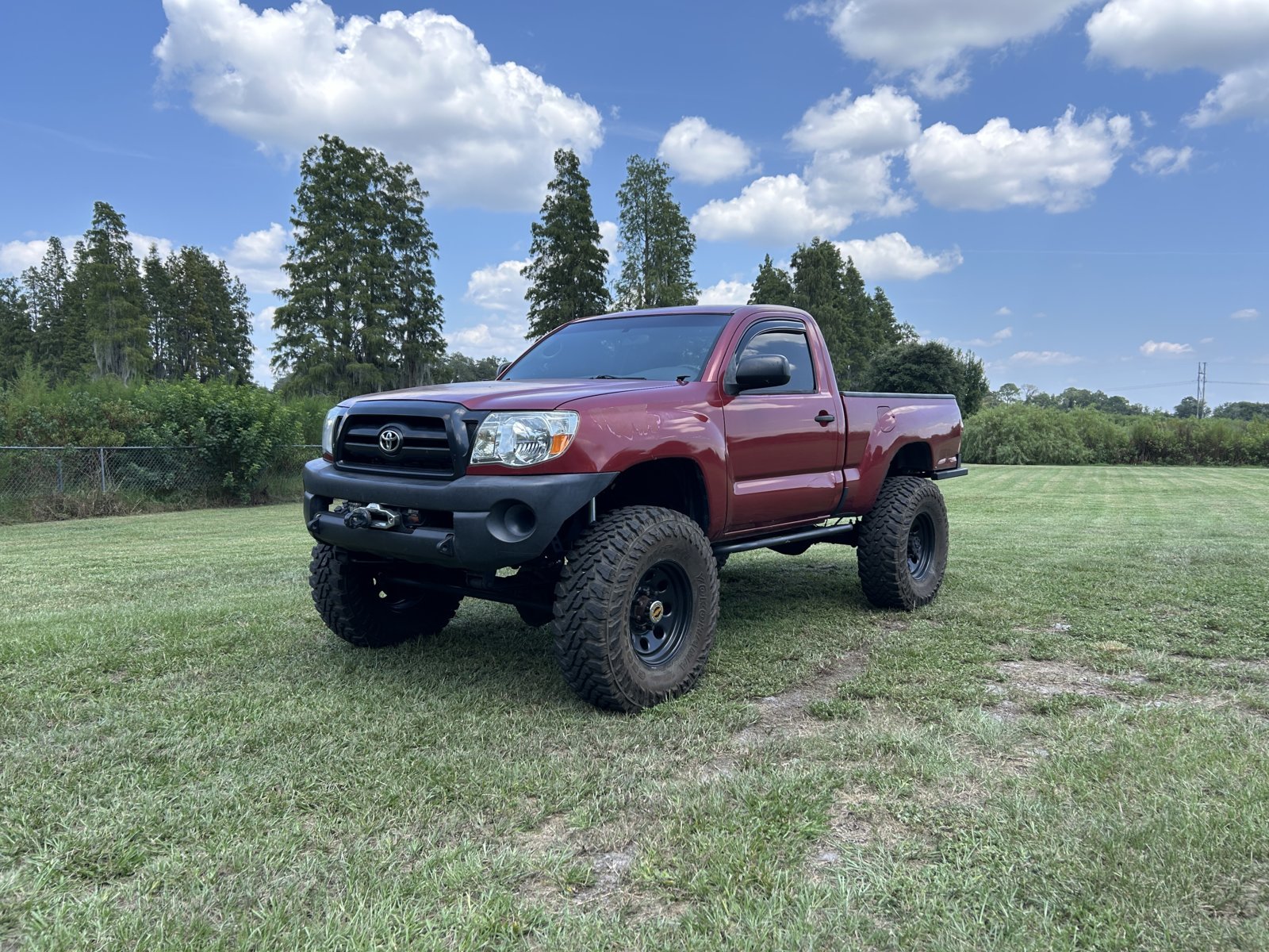

    Current Pic:
    from the Marketplace ad:
    96A59B9B-B404-4F82-977C-61413DAB0F27.jpg AFE81A6B-4DF5-4079-87BE-DCC6958AF82A.jpg

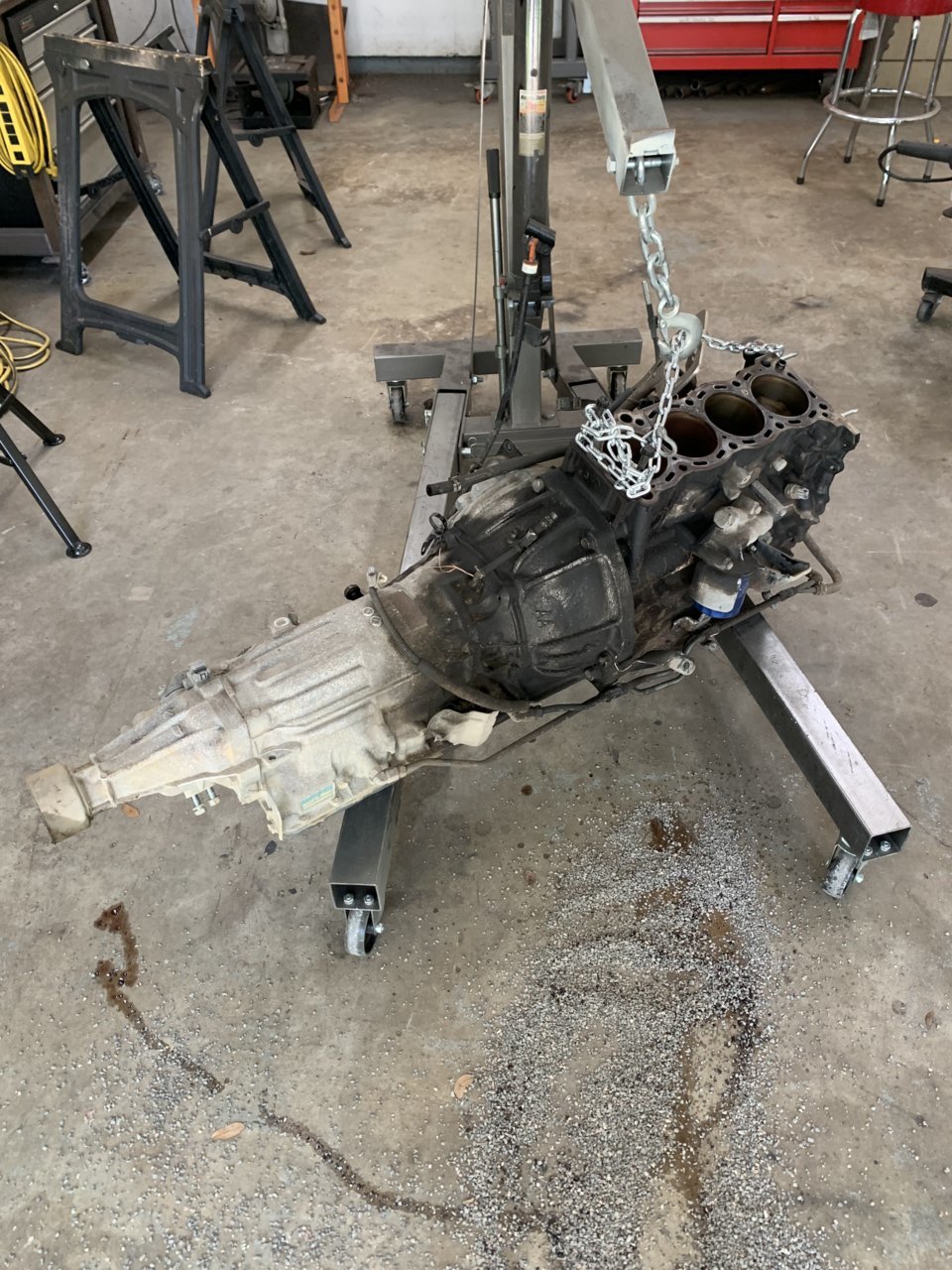

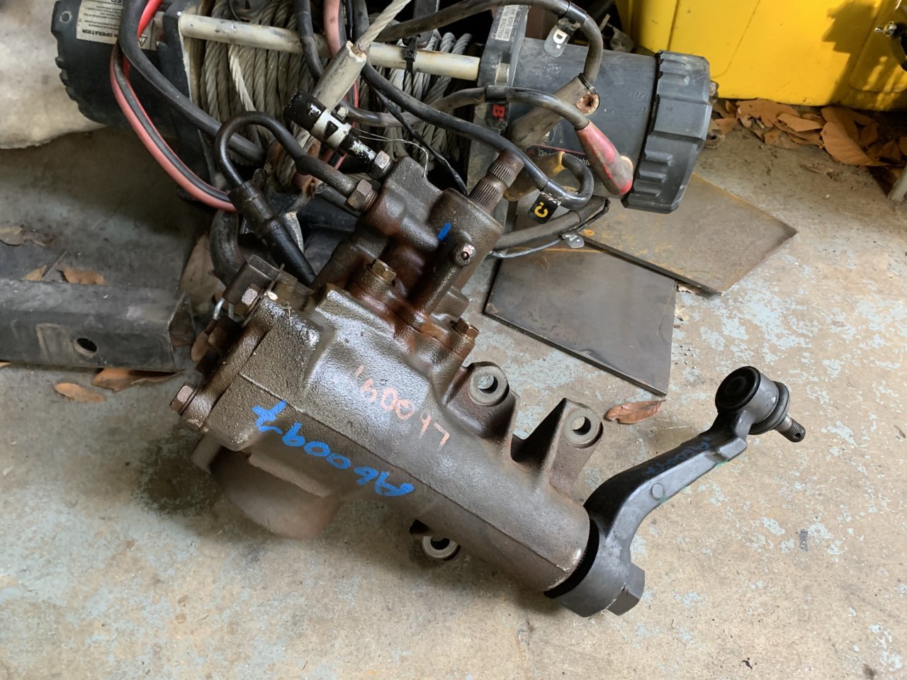

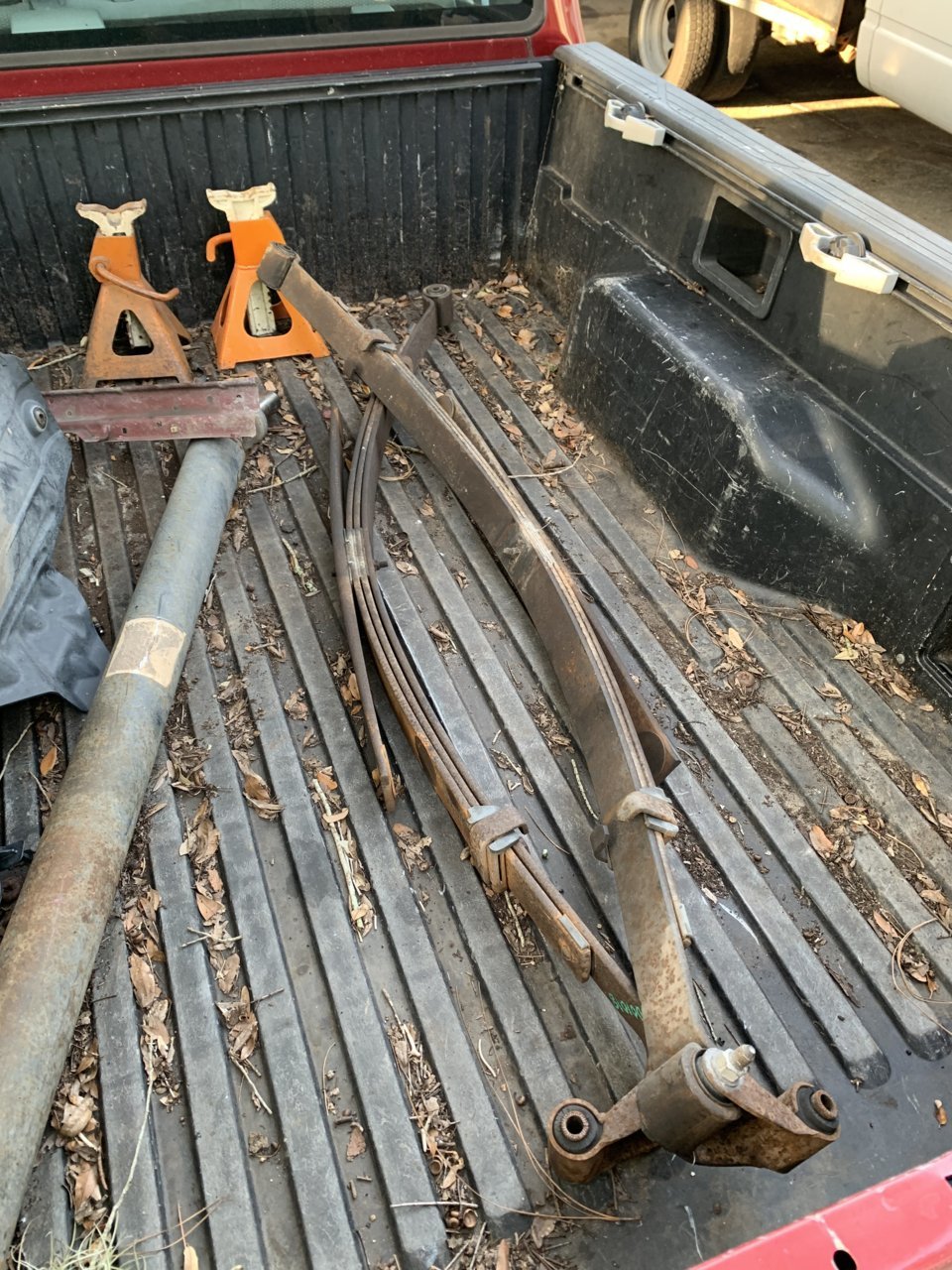

    Good riddance… sold the motor and transmission for $600, and picked up some salvage yard 63s and a IFS box
    C67FDC38-B65C-48BC-AD3A-C9175C513327.jpg 69EFD625-5C0A-469A-AB9E-05B6DC1E4A72.jpg 09892612-7B2B-442E-8353-4909BCC42533.jpg

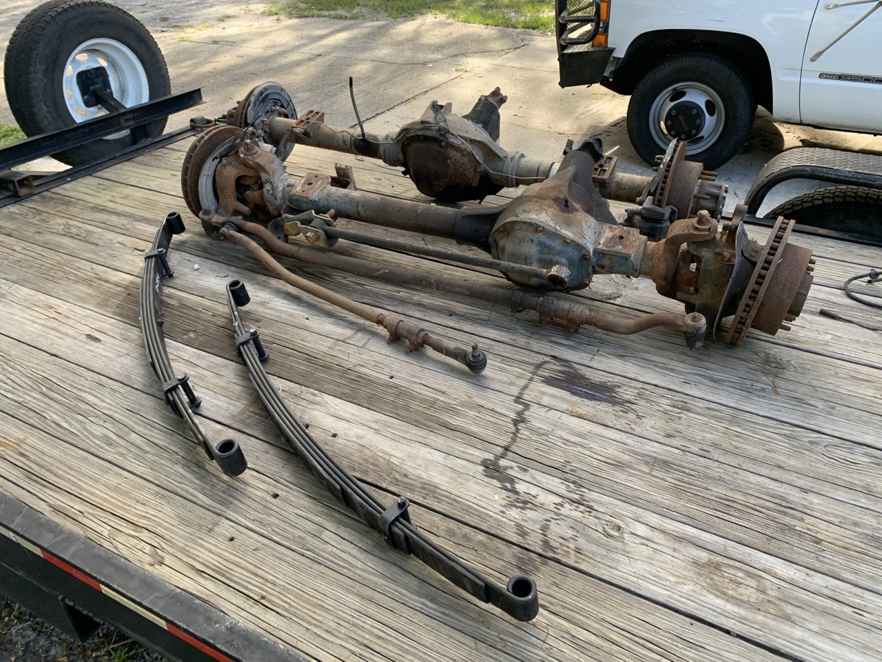

    Picked up some axles today… 60 front, sterling 10.5 rear. Decided to go with a set of superlift 2.5” lift springs for 73-88 Chevy K10’s, they have a lighter spring rate and will allow for a fairy low height.

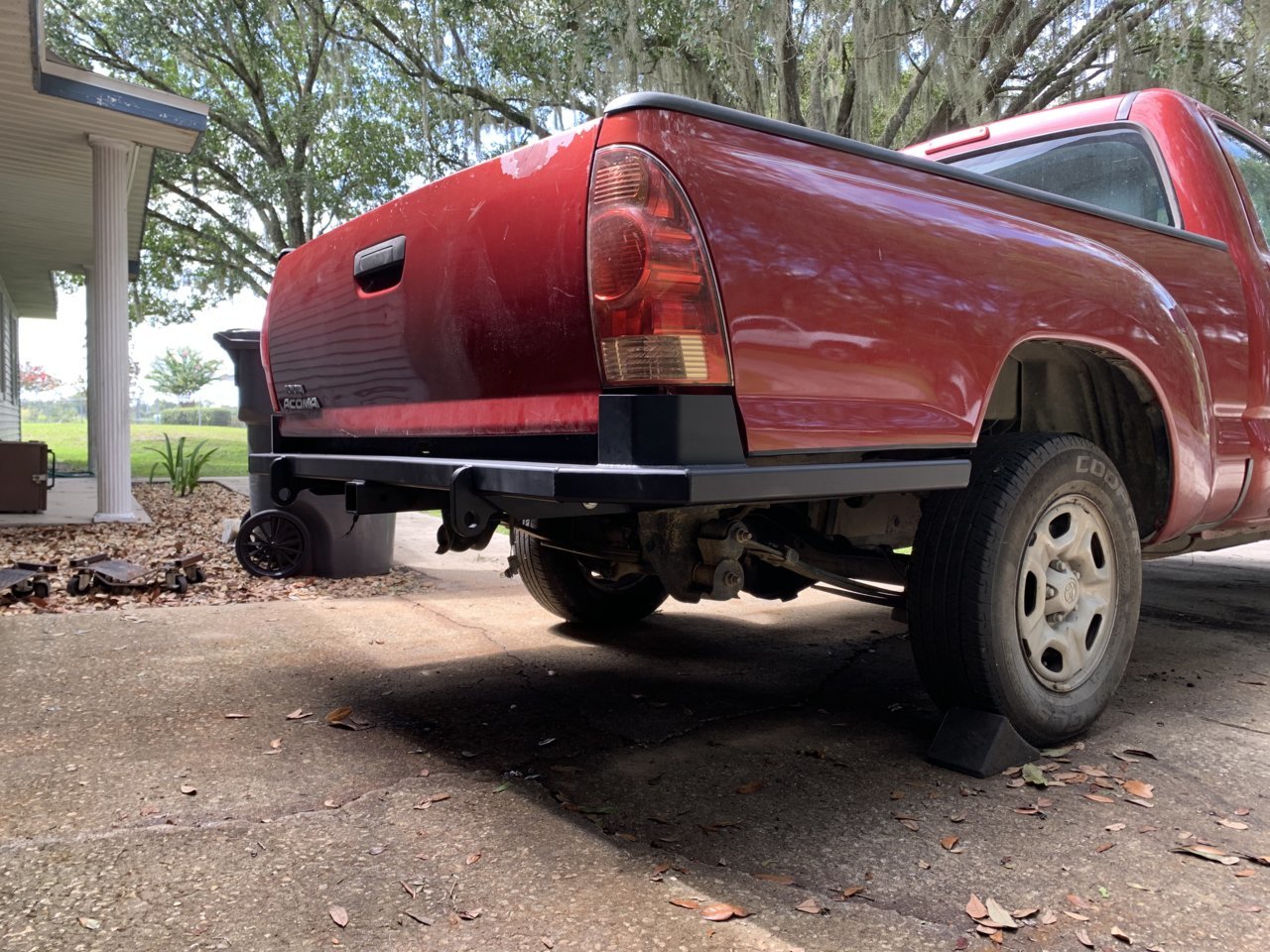

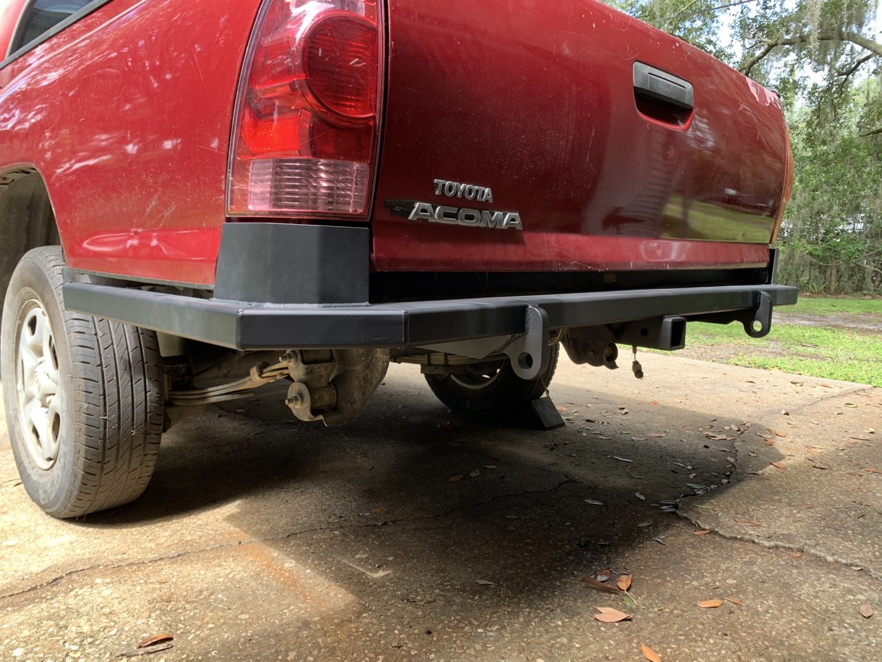

    Waiting on parts to do the suspension so decided to knock out a rear bumper. I wanted to keep it simple but useful. It’s built out of 4x2 and 2x2 3/16” rectangle and square tube that I had left over from previous jobs. Gained 9” of clearance after cutting up the bed. It’s getting d-ring mounts welded on once I get them, but other than that just needs ends capped, chain hooks, and paint.
    08F20BCD-2953-4151-9119-519F18D47546.jpg 2FEBBE2F-744F-4CE8-BA89-27376F368BF0.jpg EB16D614-44D7-4CBF-96D3-C92DD35193BB.jpg DC4B912E-252C-4EAB-86A9-2F324EEBCBB4.jpg 78EB5EBE-3097-4DDC-AF1B-6310D335DDBE.jpg

    Rear bumper done and on. I think I ended up with about $35 into it. Next up is starting the axle/suspension swap
    E25806DA-86AF-498C-89EC-2ACFE3BA8153.jpg 411C99ED-38CA-47E3-8550-E3E9C9D0E478.jpg

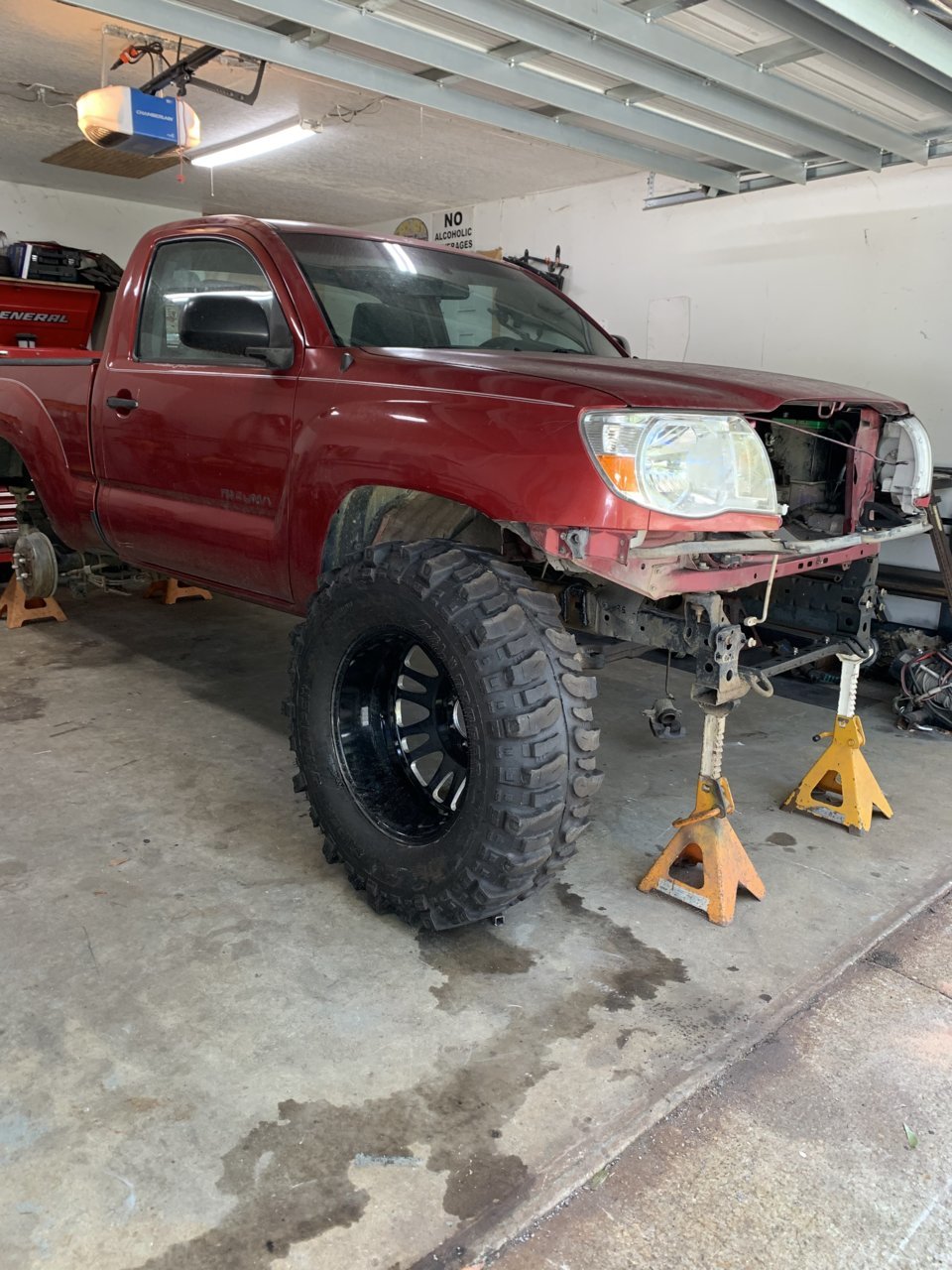

    *not my wheels and tires*
    rolled a 38.5 bogger up to the truck for shits and giggles… and this is at 20” frame height. Still can’t decide between 35s and 37s but I’m leaning 37s…
