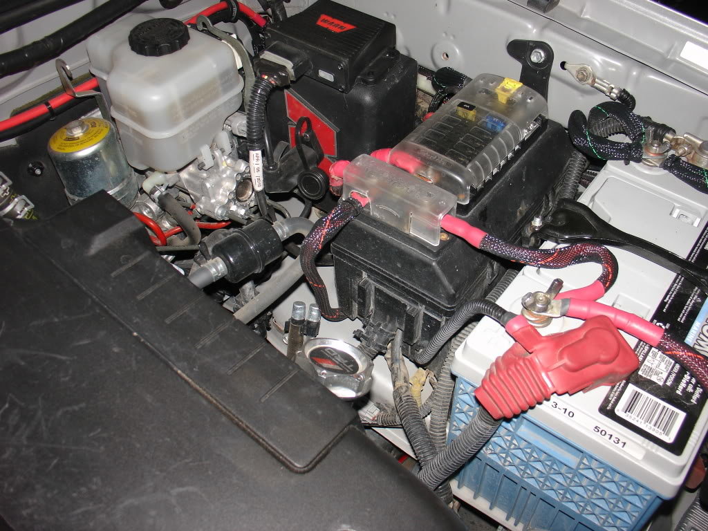

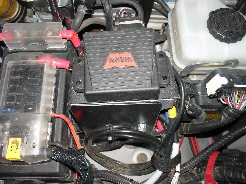

    I took mine out of the huge box and put it in this
    Then relocated the switch inside (toward the left)
    More pics in my build

    Is it straight wired from the box to your toggle or did you use an extension to a port(so you can plug the toggle in and out whenever needed?) (I believe that's what MJonAg's did..:D)

    I like the idea of a smaller box. :D Did you simply splice and extend the connector wires for the remote when you ran it to the cab? Nice truck by the way. I'll checkout your build later tonight.

    I actually ended up replacing all the wires and connectors. Thanks!
