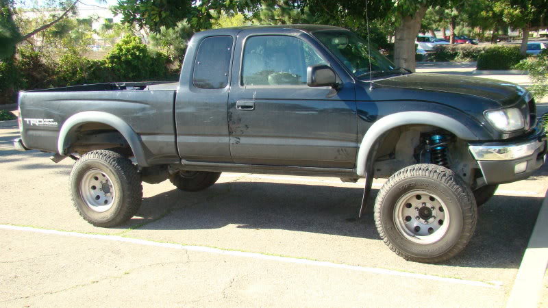

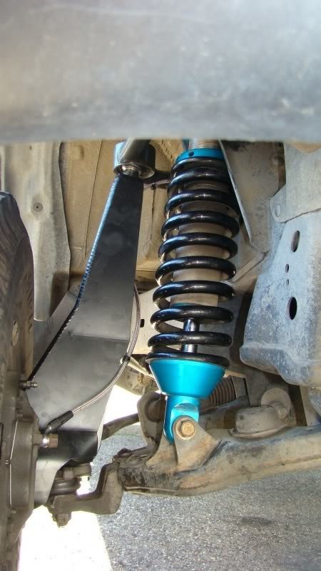

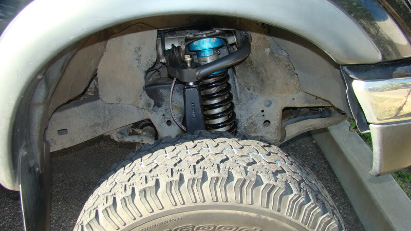

    i know im on the late train responding to this but im running the all pro expo's on my first gen love em loaded my 2 dirt bikes on them and they didnt sag much im running the 5150's with them good set up...

    Thats a sweet setup you got.
