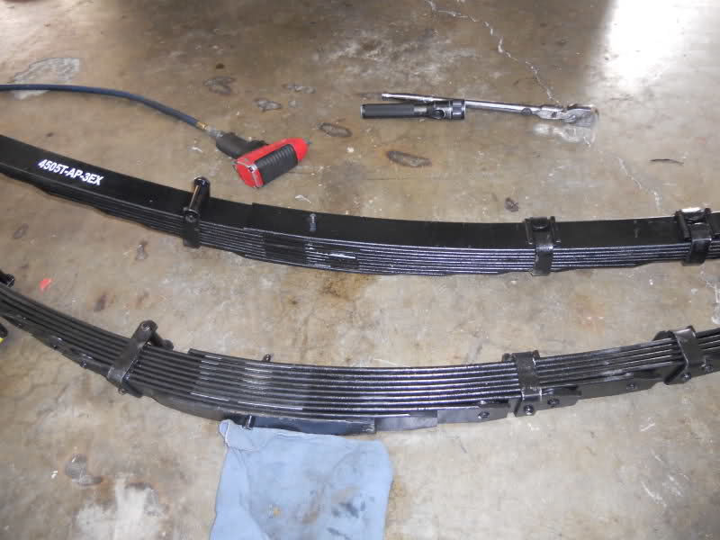

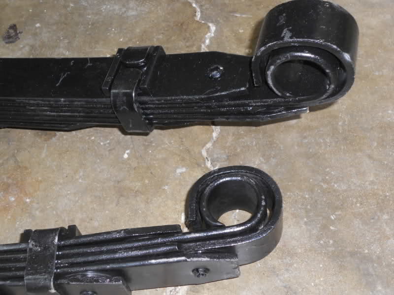

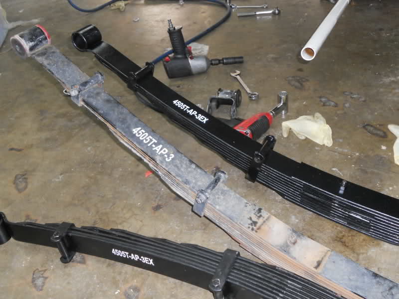

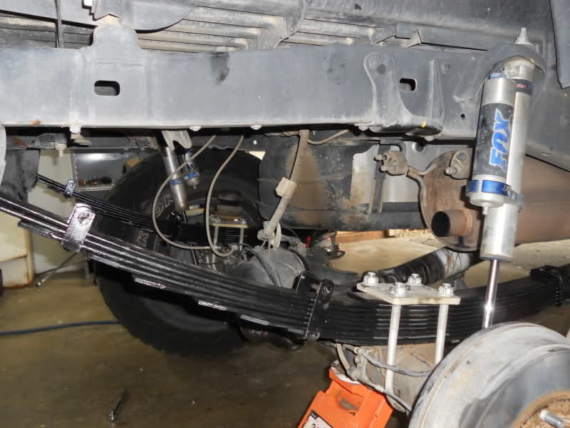

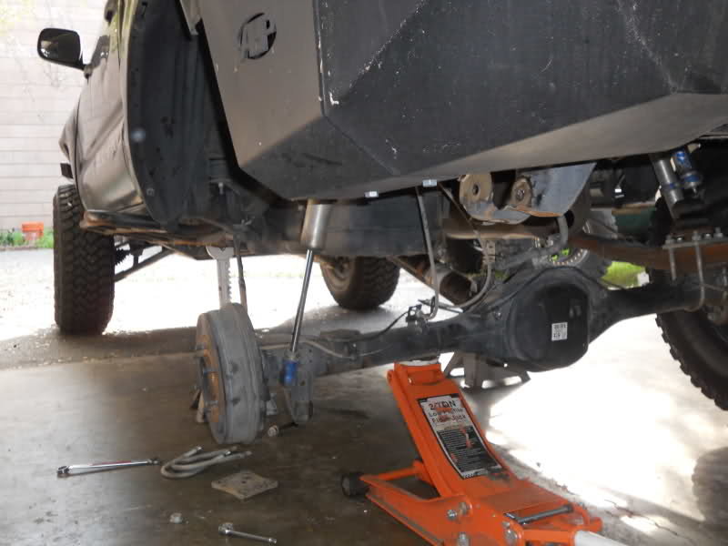

    for almost 2 years now my AllPro regular duty 3" lift leaf springs have served me well.. i can say i have put em through just about everything..from rock crawling, to pre running, and now towing the MonkeyCrawler. i cannot say enough about them and their performance. but..they weren't designed for heavy cargo applications such as towing another truck like what i have been doing recently. the regular 3" lift springs were made to have lots of flex on the trail and to have overall improved ride comfort....
    the new Heavy Duty Expedition springs were designed to carry heavier cargo while keeping the flex that's desired on the trail while maintaining ride comfort. at first i was thinking whatever, you cant have both.. the ability to have heavy loads and have a flexy spring for the trail. after being on several trail runs with Sara and watching how the prototype springs perform in person i wanted a pair. and finally after months and months of bugging Sara and the rest of the AllPro crew i finally got a pair today...
    i'm in the middle of installing them as i type all this haha...but here are a few picks. more will be posted when the installation is completed

    almost done..

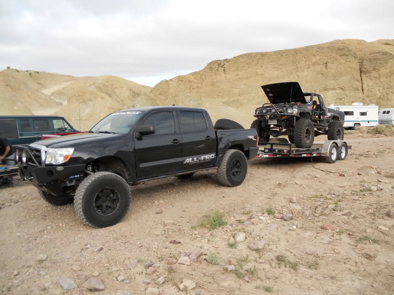

    so far i love these springs..i wish i had them a lot sooner. the overall ride is heck of a lot better both on the the highway and most significantly better in the dirt. but most importantly..towing. my truck is more level when towing as compared to the regular AllPro springs that i previously had. and the ride comfort and handling is much better since im not bottoming out any more
    pics taking this morning...
